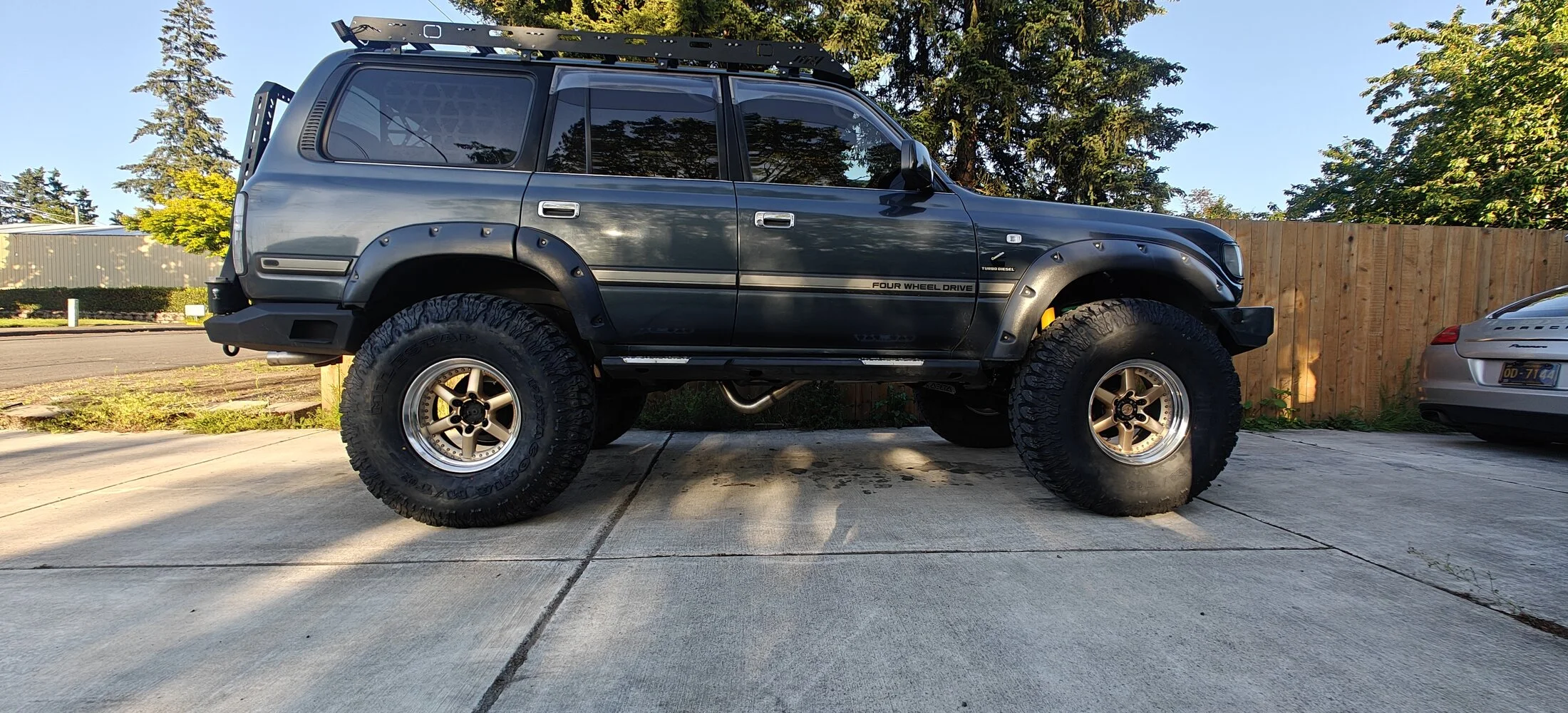

Best swap ever. 10/10 will do again. Drives like it was meant to be!

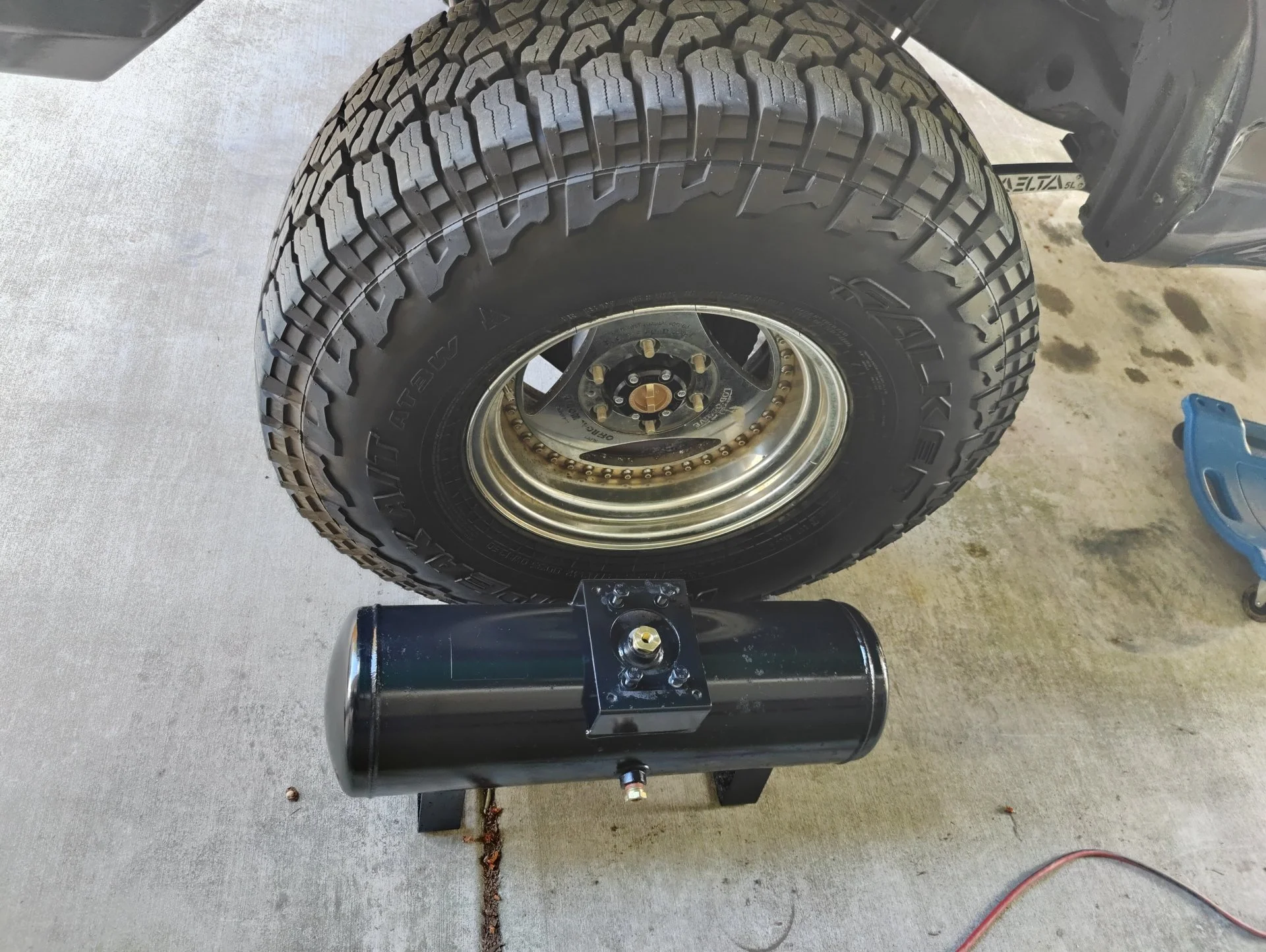

I also mounted my hi-lift jack and began searching for a spot for my air tank. It's bigger than I thought, but i think I can get it to fit on the outside of the frame behind the rear passenger wheel well.

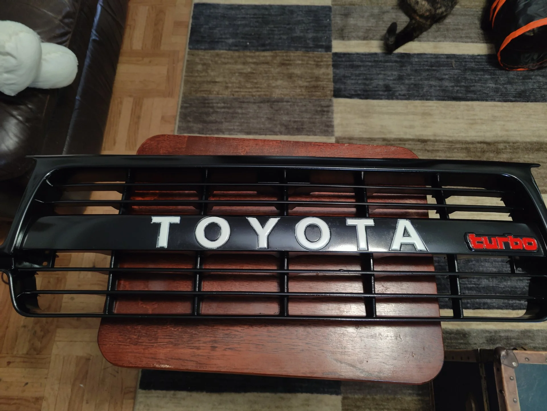

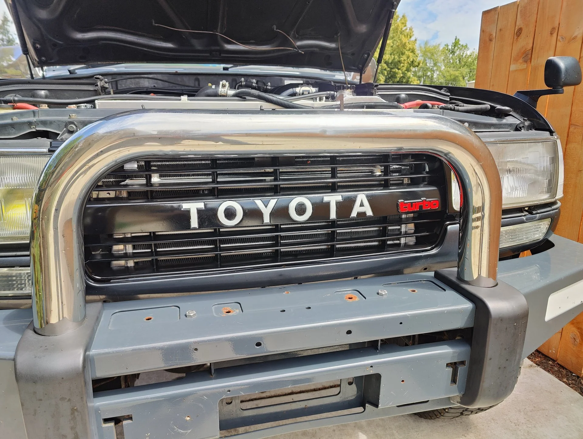

I then turned my attention to my grille! It has been flat black since I got it, and was painted poorly. I'm not a fan of chrome, so I went for gloss black. My fiancee suggested Toyota be white, and turbo be red, so I gave it a go! I like it.
If your spare isn’t under the truck that’s a good spot for tank. Plenty of threaded holes along the frame to make a mount.
It's not, but I'm hoping to put a sub tank there so I'm trying to save that space for now. Back before the 1hdt went belly up I was speaking with a local company about bringing the rig to them and installing one.

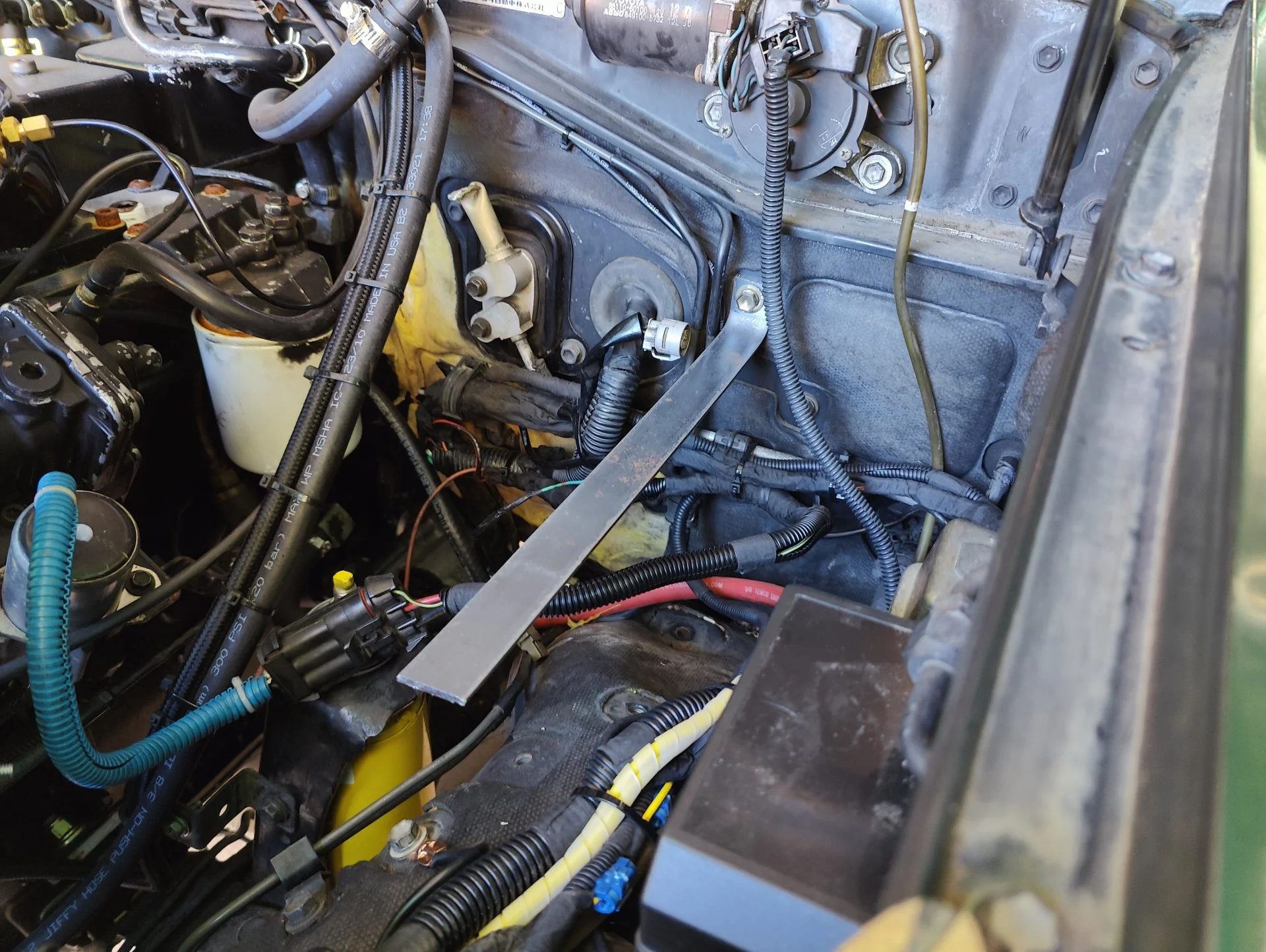

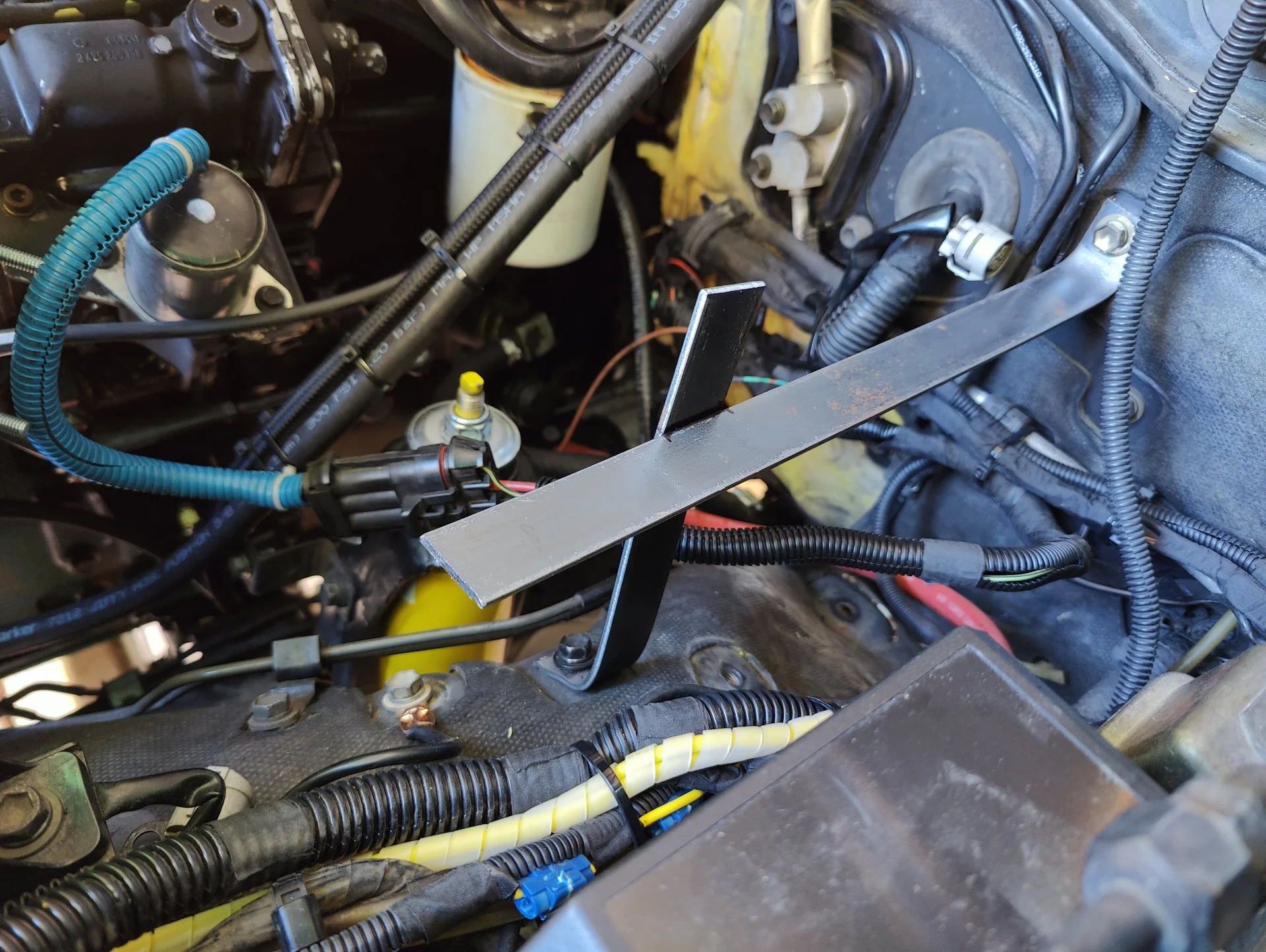

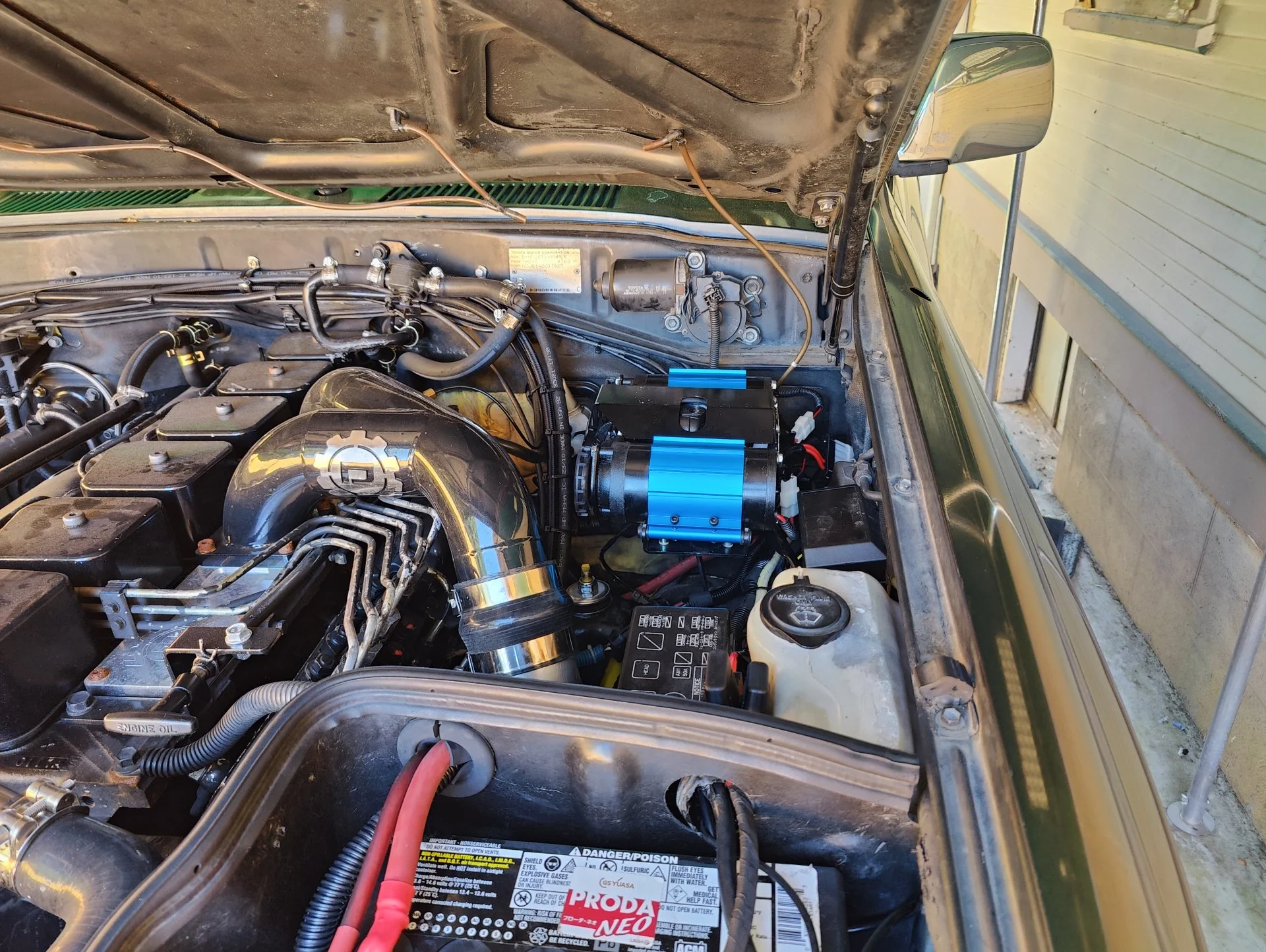

Did a little wire management, and then I mounted my air compressor. I'm running out of room! I thought about in the cabin in the rear quarter panel, but I think that's going to be a sub and amp spot. I made a simple bracket out of junk metal I had laying around. It's not the prettiest but you can't see it, so it's perfect. I welded the bracket to the bottom of the compressor mount so I can use the 8 threadserts on it for other things, lol.
This weekend I'll finish wiring the in cabin stuff, mount my tank and at the very least mount my air horn. I should have enough stuff to do a front and rear quick disconnect for filling tires but we'll see how far I get.
I think I might make another bracket under this for a positive battery terminal block so I can get rid of the excess stuff on the battery. Would much rather have one cable on it and tee off from somewhere else.

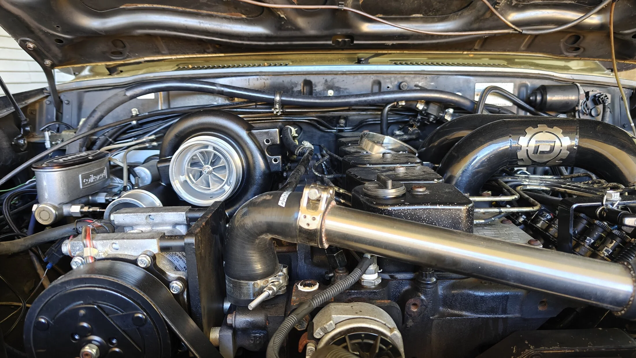

Taking a look at your intercooler piping , does it not hit the tire at full tuck/turn? I like that setup because that looks like it will work with my 4BT, what intercooler is it ? Where did you bolt it in front of the trans cooler ?
Looks similar to this Intercooler Piping BOV Kit For Land Cruiser J80 1FZ-FE Fits ARB Bumper - https://www.cxracing.com/KIT-1FZFE-LC80-OFFR-IC
It's a generic intercooler from Amazon or eBay.
Nope, I've got tons of clearance, even at full lock it's nowhere near the piping. I don't have a trans cooler due to being a manual. I thought about the CX kit but I didn't like the idea of buying a kit just to scrap half of it.
Oh I see , yea that’s what I’m leaning towards since my trans cooler would be in the way , anymore pics of it ?

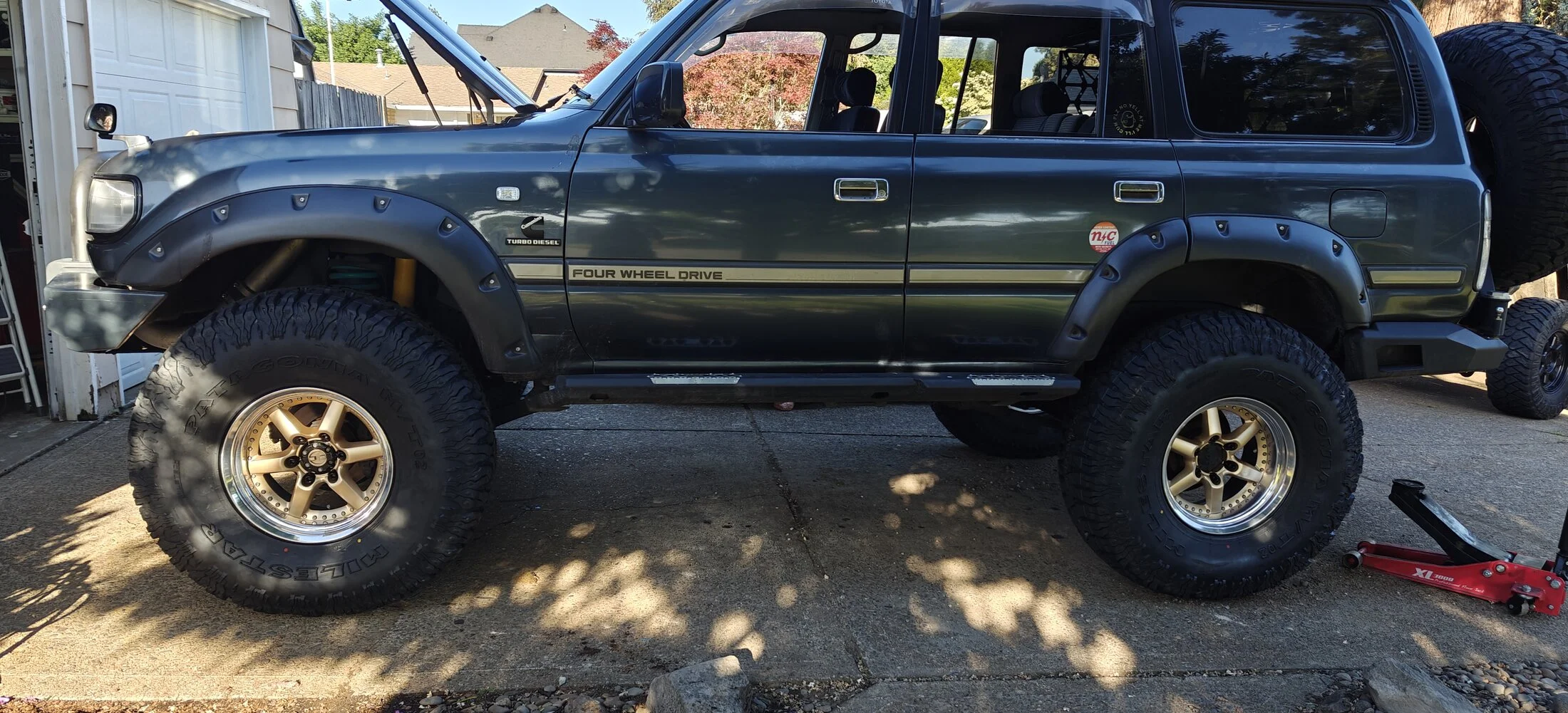

relatively problem free for the past 2 years, still haven't done my exhaust but that's partially because I was waiting to get my sliders in. Got them and my bumper on, but had to cut the exhaust even shorter. it dumps out under the drivers seat LOL. I ordered a built HE351 to replace the hx35w and I also got my hands on a steering box without the stupid auto adjusting solenoid so I can mount my turbo back up high where it belongs, I hope. Probably going to run into fitment issues with the clutch master being too close but I'll address that when it happens. So now I'll somehow fit a 4" exhaust under the pig. After that, dyno time.
Done a few other swaps since then as well, and currently working on another! I'll take photos of various aspects for LHD gassers so ya'll can get some ideas of what happens.

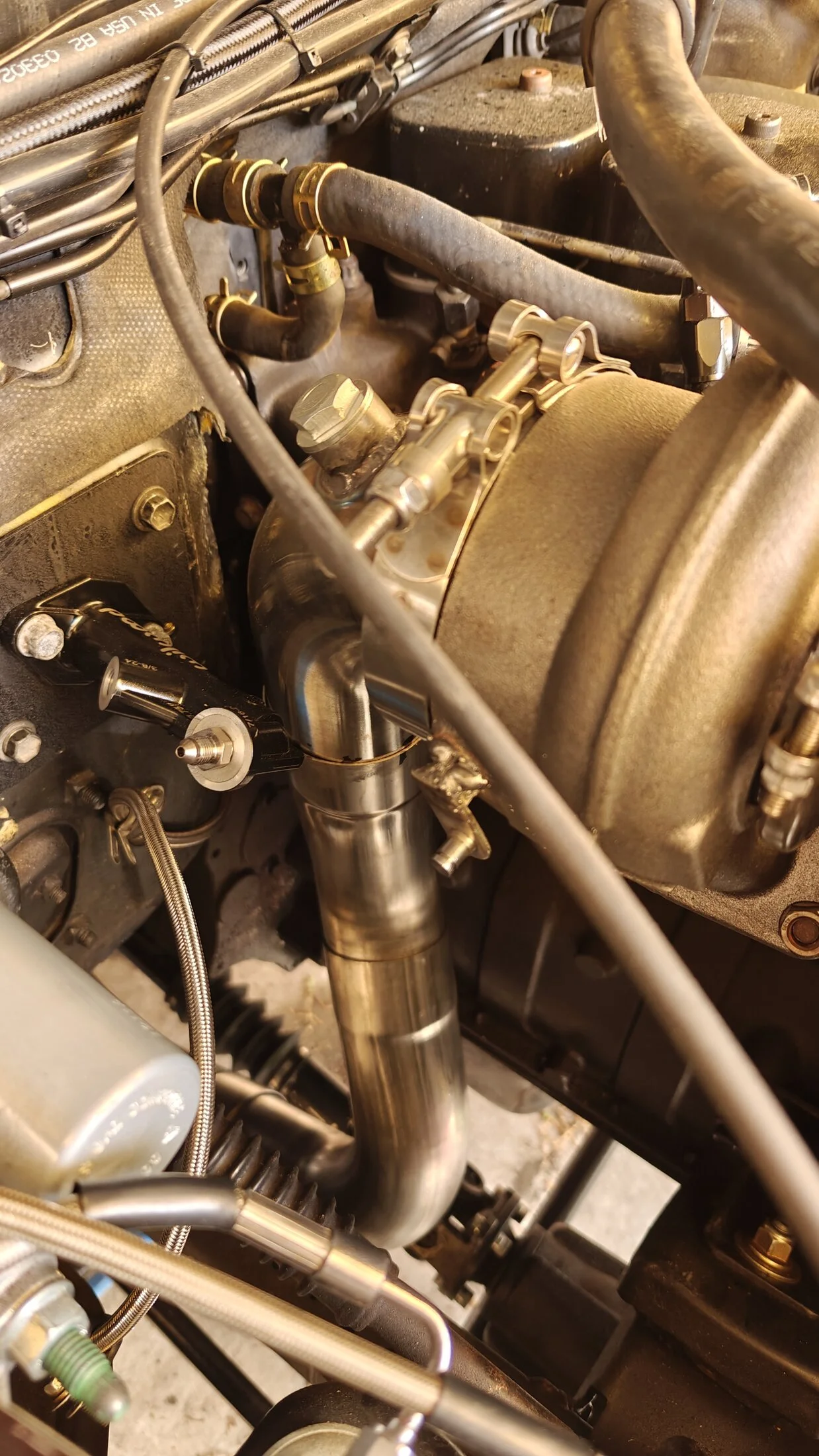

Working on the exhaust for the he351 now. 4" is not happening, so sticking with 3". Need to extend the rod on the little Wilwood clutch master so the pedal will have travel, and weld everything up. Can't wait to see how much boost it makes now!
And then once it drives again, I get to go get tires for my new wheels. At minimum I'll run 38's, but likely stepping up to 40's because I like torturing myself

That’s a cool and tidy little elbow in the last pic!
Exhaust is done, and stepped up to 40's. It's so nice having a full exhaust, with the windows up it's nice and quiet. Will definitely tuck up that spot that hangs down, but for now it's fine. I peak at 50 PSI now, which is ridiculous. need to adjust fueling a little bit as it's kinda smoky and lags a little, but that's expected after swapping to a much larger turbo. Can't even tell it's on 40's!

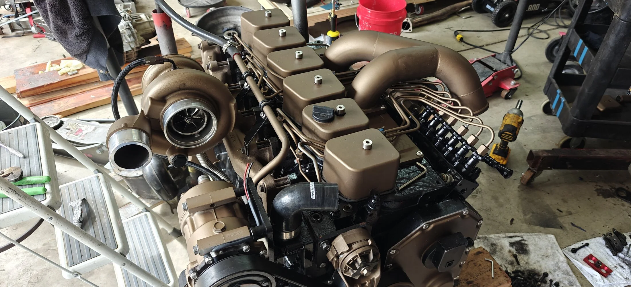

Have the engine out for a few reasons, primarily because I'm getting the nv4500 rebuilt and replacing the clutch. While it was out, I decided to make it look pretty. Cerakoted so many things, I'm really curious to see how it holds up in an engine bay. Also did a few little mods I've had on the back burner because it's easier with the engine out, like 4k governor springs and 60lb valve springs. Waiting for my top hat style valve stem seals and I'll finish the 60lbs and then it's mostly ready to go back in. More than half my stem seals had walked off the seats - probably due to my relatively high boost pressure.

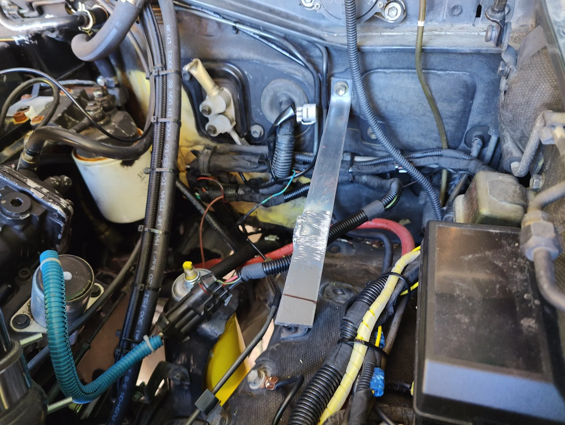

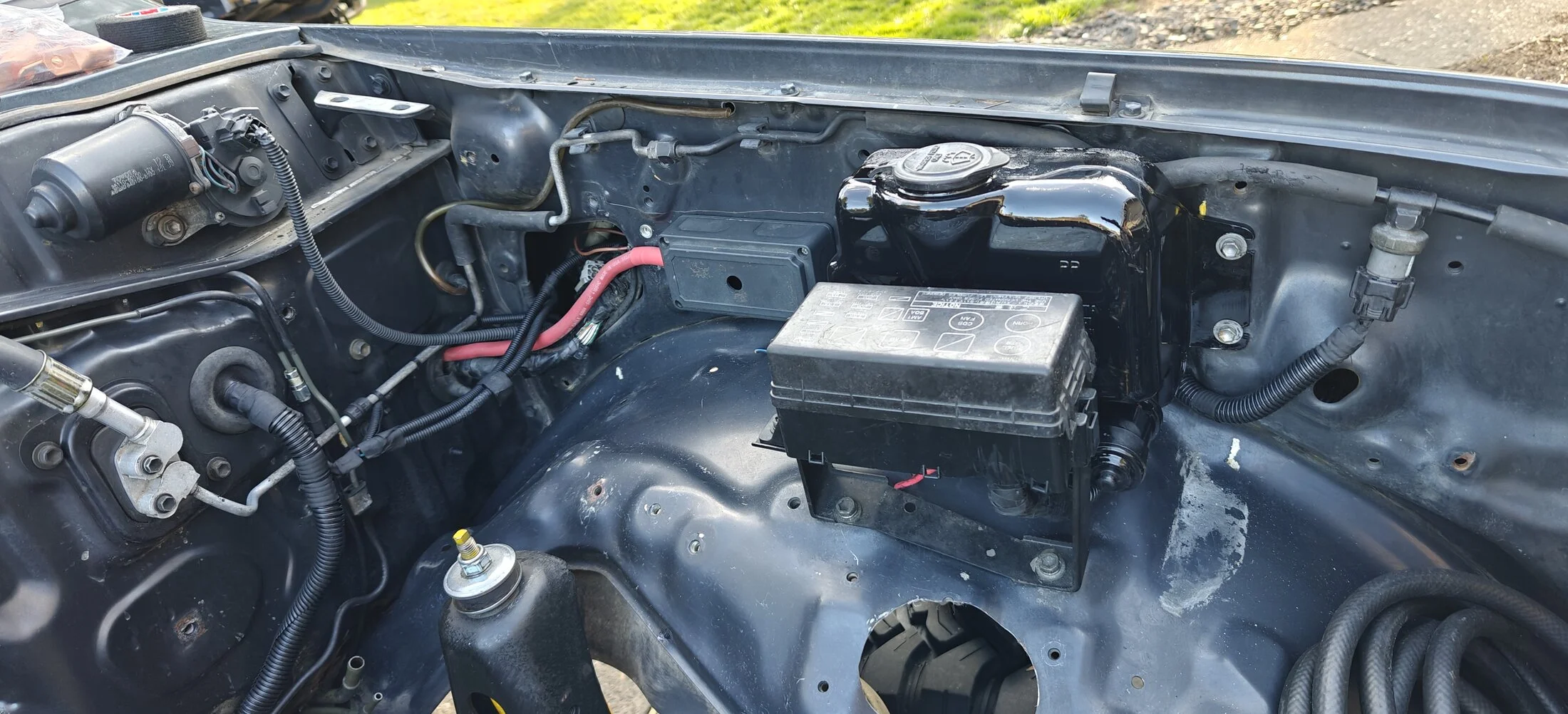

Also doing a "full" wire tuck while I'm in there. Ideally there will only be two visible harnesses, one on each side. One for the alternator, oil pressure sensor, egt probe and block heater. and one for the FSS, fan temp switch, and starter solenoid wire. Batteries will be relocated to the rear, primarily to give me some much needed engine bay space. Also planning on covering my original intercooler piping holes and re-routing said pipes in a much more tucked location. No more block mounted lift pump and fuel filter, those are going under the rig on the frame.
