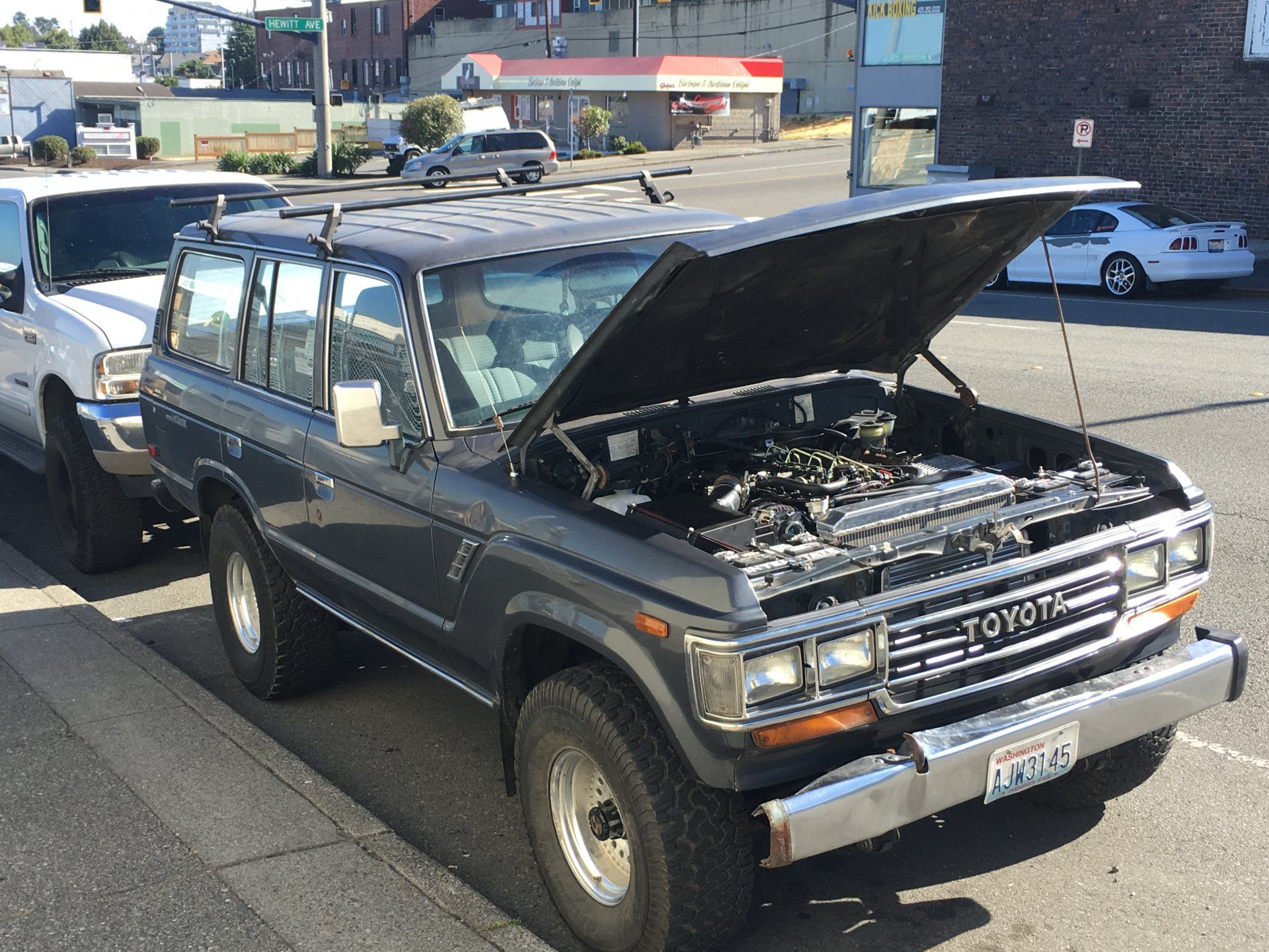

Here are some shots of the completed conversion using our larger air box instead of that little cone filter that Cummins provided.

That is a clean swap. As many have asked about future swaps, awaiting kit Pricing and availability.
Looks to be a home run.

That air box it's a beauty .. !
that would work with a safari snorkel ?
Torfab - is that air box available to purchase as a stand alone component? I have one of those "little cone" filters on my 12H-T right now.
At this time that air box is not available for purchase. We still need to work out the bugs, standardize it for multiple platforms, etc.
