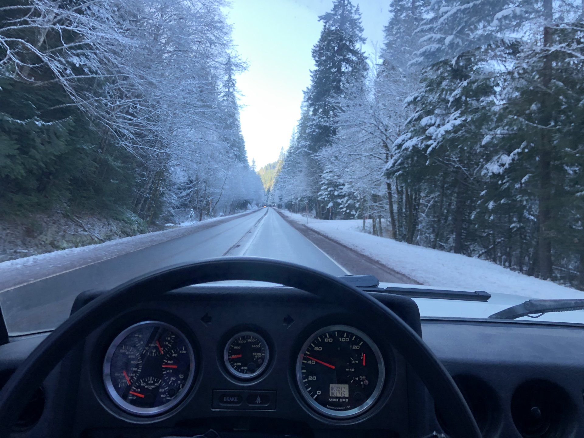

Do you have a post on the speedhut gauges? I think I have seen the cluster in a 60 but not a 62.
I would be interested to see pics of the exhaust routing, I haven't done exhaust yet but routing it avoiding the front drive shaft and shackle looks challenging.

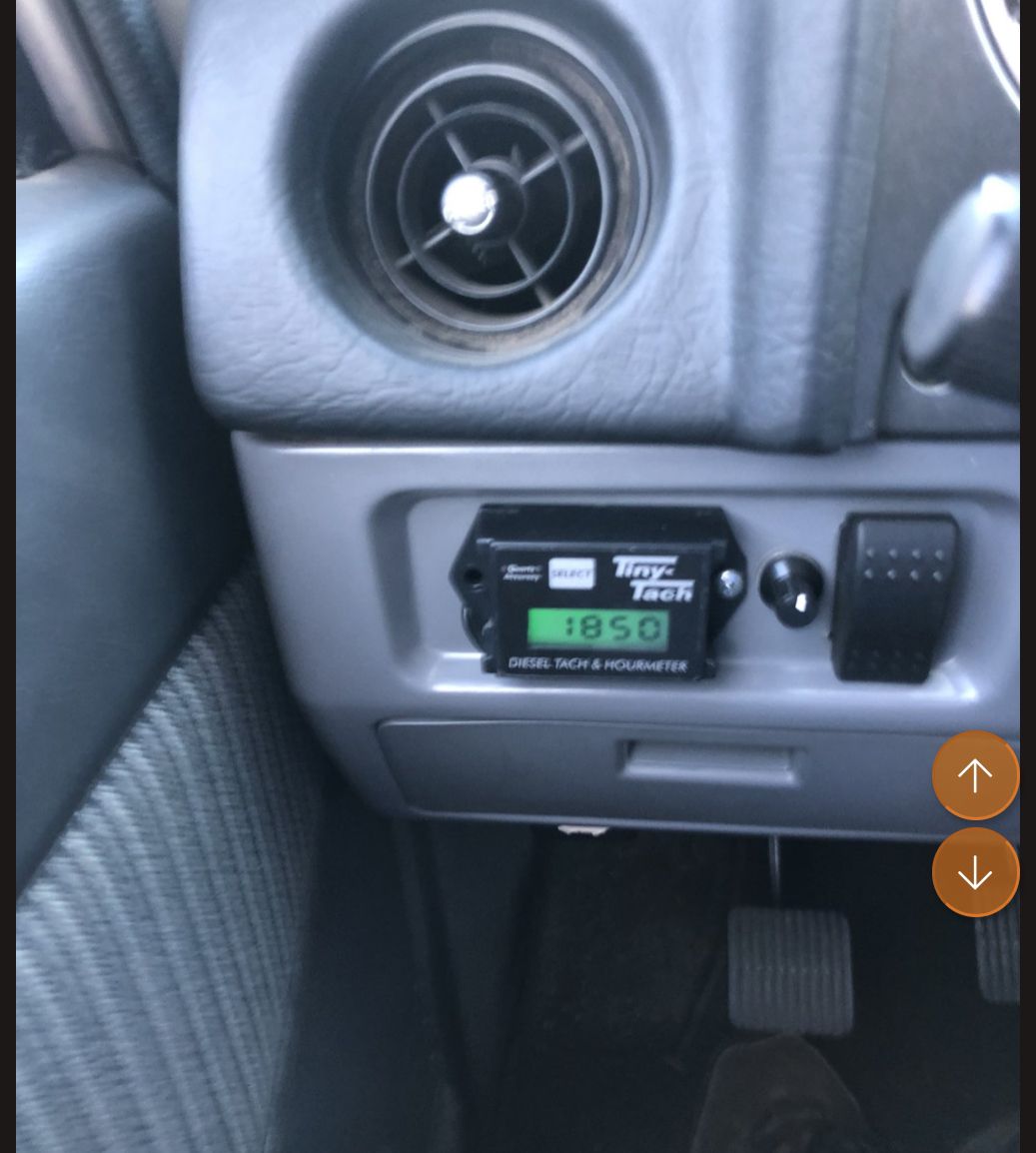

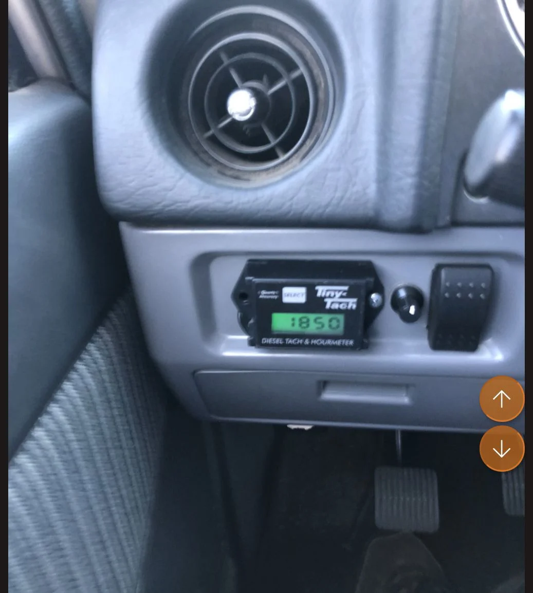

I just got a Tiny Tach that clamps on one of the fuel injector lines. Simple setup. Left me room in the Speedhut Dash cluster to have Speedometer/ Fuel combo, volts/ water temp/ oil pressure/ boost cluster and a EGT gauge.
