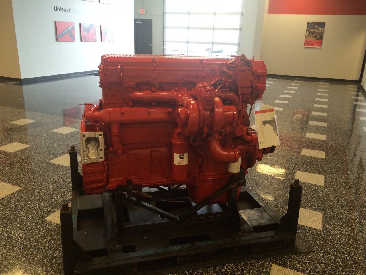

I made a trip to the local Cummins dealer today to pick up a 180 degree thermostat to replace the 192 degree off brand I had. The thermostat housing uses the Cummins 98-02 thermostat. They come in both 180 or 190. I have heard benefits on both. I don't like the fact that my electric fans kick on (185 degrees) before the thermostat opens. Since I modified the temp gauge I would notice that my temp would climb to a bit over 3/4 and hold for about a mile before it went down to the 1/2 mark. I assume it's playing catchup when it opens for that short period. Then it would stay at the 1/2 mark for the remainder of my drive no matter how far my drive would be. Was hoping to test it but my radiator is still leaking so I now have to wait a bit longer. Oh well what can you do.
Some nice clean red monsters on display. I never realized that I am lucky enough to have a dealer in town.
Cool to see it sitting on the floor but I have always hated how they just dump paint over everything. Lol
Yeah it doesn't last long. My Kabota paint is already flaking where I have used brake cleaner. Coolant doesn't help either.
Yep and when it starts flaking it looks like s***. It's harder to see details when there is no contrast, etc. It's a total shortcut and what you pay for their rebuilds it is just being cheap. Lol
Have you ever seen a Cat motor not completely painted? That's how they all roll... Makes it nice when your under a 988 Cat looking for a leak :)
