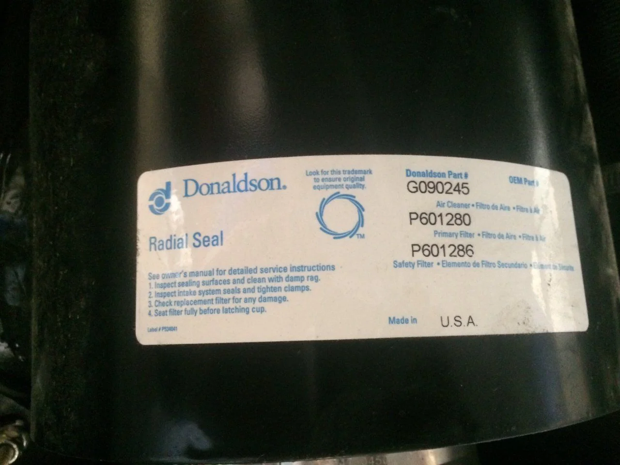

I am extremely interested in your air cleaner setup. Can you give me any details on the housing / filter application and or part numbers?
EDIT:
Should have been more clear. I've got the filter number, just not the housing information.
http://www.ebay.com/itm/DONALDSON-F...743?pt=LH_DefaultDomain_0&hash=item43d26eae2f
EDIT2:
Found the following reference from Baldwin Filter that states this filter fits the FRG09 housing series:
http://www.baldwinfilter.com/literature/english/5 Catalogs&Supplements/Form562.pdf
Found this catalog from donaldson that shows a couple variants. Can't find where to buy online though.
http://www.donaldson.com/en/catalogs/engine/033616.pdf
Looking at the pics on page 6 of this thread, you have a wingnut style endcap, so it's style A. Need to figure out where to buy these online. Any help sourcing would be appreciated :cheers:
Edit 3:
According to the donaldson catalog above, housing G090245 and G090250 are the only two that fit this element, so it has to be one of those two. Looking at the dimensions, both are the same, but the 250 model flows a bit more.
Here you go.
EDIT:
EDIT2:
Edit 3:

Yes that's what I was told as well. That was the reason the Donaldson was put in. The snorkel wouldn't cut it either so that's why the housing is open in the engine bay as well.
