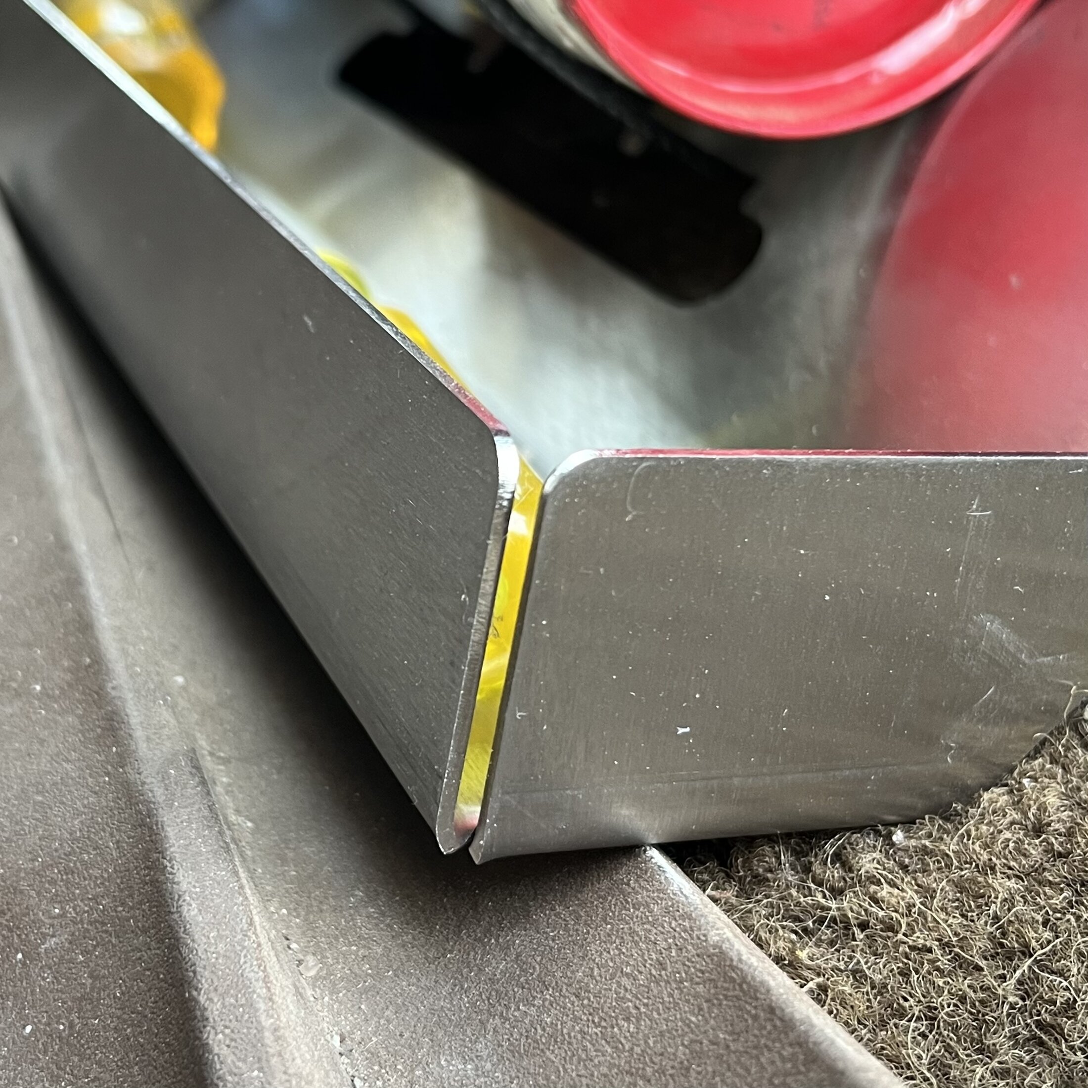

If the intention is to ever sell these welded up, would a drain hole be a noteworthy suggestion? 😅
I will not be welding them. The sidewalls of the junk drawer are plenty strong enough to not get bent, and the gap at the corners serves as a way for liquid to escape.
I don’t know if you’re like me, but it’s only a matter of time before I dump a cup of coffee into the thing. I have some cup holder ideas for the 60 … I should get back to that.

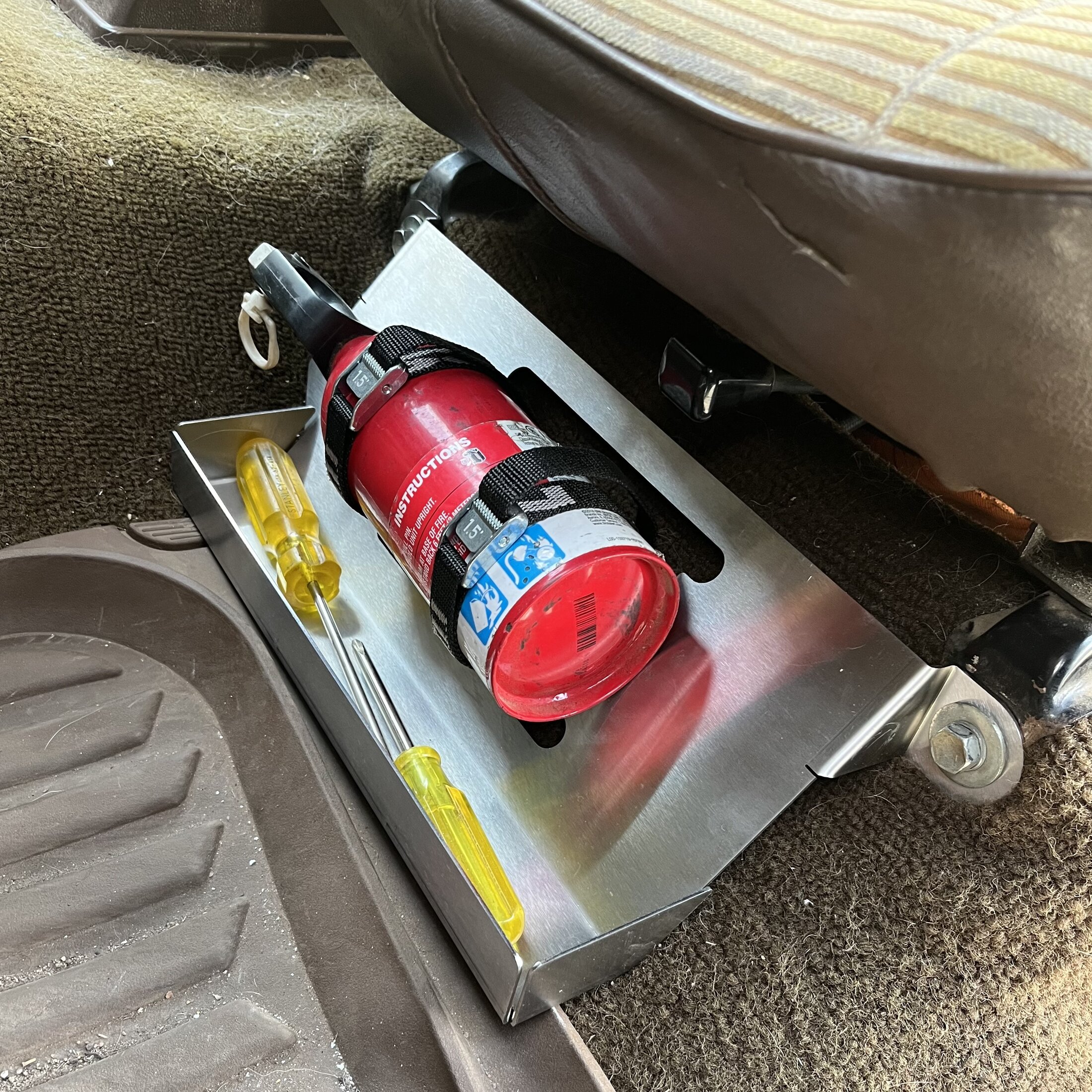

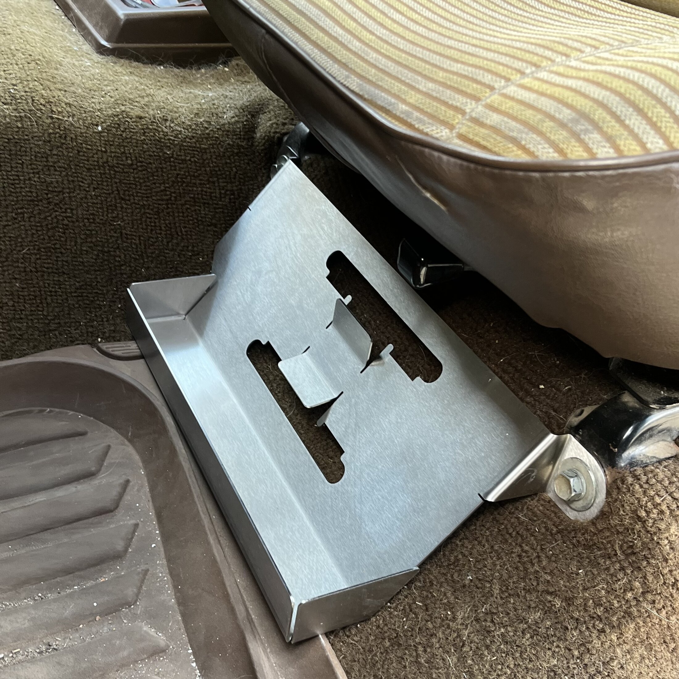

1985-1990 Fire Extinguisher Brackets are live! I sent off a run to fab today so shipping ETA is end of next week.
Important note in deciding between the 81-84 and 85-90 variants: it’s entirely dependent upon the seat bolt closest to the driver’s door. If the two front seat bolts are horizontally even with each other, that’s 81-84. If the seat bolt by the driver’s door is lower than the one next to the transmission tunnel, that’s the 85-90. By far the seat bolts align with those year ranges, but I’m already seeing a few outliers. So order based on your seat bolt arrangement - I’ve made a bit of this in the product description.
