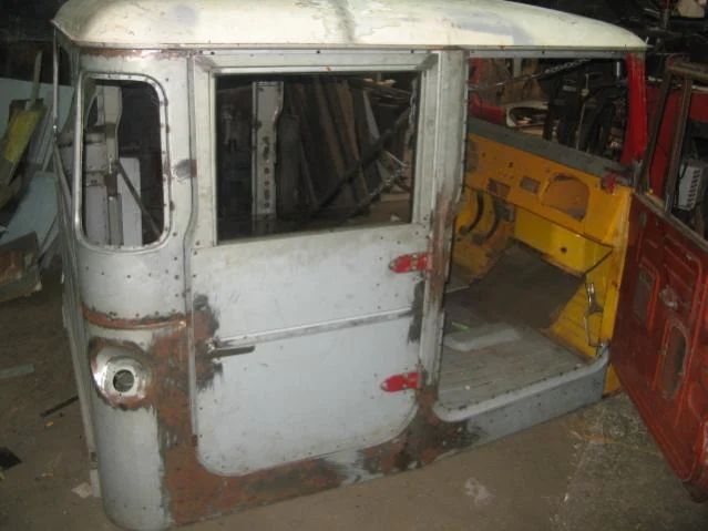

s***ty photos of a 4 door 45 we are currently building
2-3 weeks ´till finished..

4 door crew cab toyotona

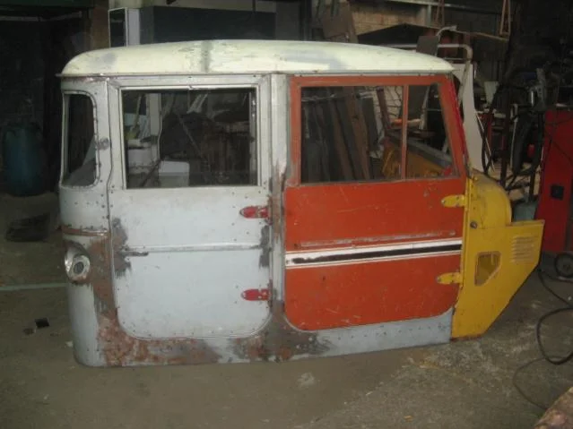

a few more s***ty photo´s.
when we´re all finished I´ll take some decent photo´s mounted on the chassis.
Paul.

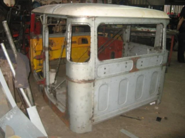

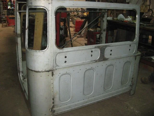

I think bull is on the right track about the removable top, but for a different reason. That B pillar is gonna need a s***LOAD of reinforcement to take the stress of being a striker for the front door AND an anchor for the second door.
That pillar is gonna TAKE OUT the rain gutter and the roof in no time unless it is HEAVILY REINFORCED.:eek: I'm thinking raingutter of at least twice the thickness of stock, along with some kind of overhead bow linking the two sides, if not triangulated to the rear of the cab as well.
Since reinforcement is a must, it would only take slightly more effort to make the top removable. Then you'll have accomplished something the FJC couldn't!

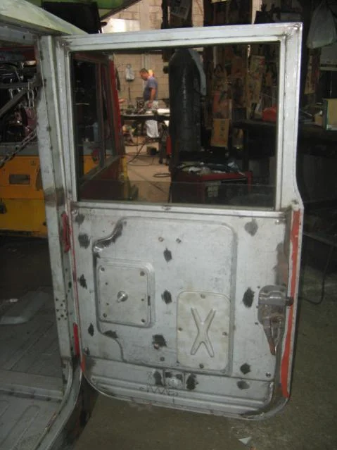

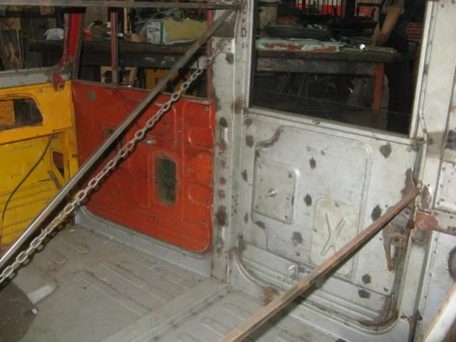

As I post some of the earlier photo´s you´ll see the support beam that runs across the floor. there is also another that runs across the bottom back of the cab,(see photo) here we changed the oe to allow for more strength.
The top supports that run above the doors are tied to that centre brace and to eech other,(removeable) again I´ll post photos
The rear cab has been changed from an original pick,up, doesn´t look like it but there is an angular difference, we reamade all the frame to accomodate that curve.Thus leaving us with a bigger rear window than any lpb,
This crew cab is built to be put on a 78 lpb frame, that has been extended 16 inches, after the rear hanger, I´ll post up some photo´s of the frame,
The reason we used the older stlye frame is that is does not have that kick up and raised floor like the later style, this makes it a load easier to get people comfortably in the back seats without smaking their heads on the roof.
