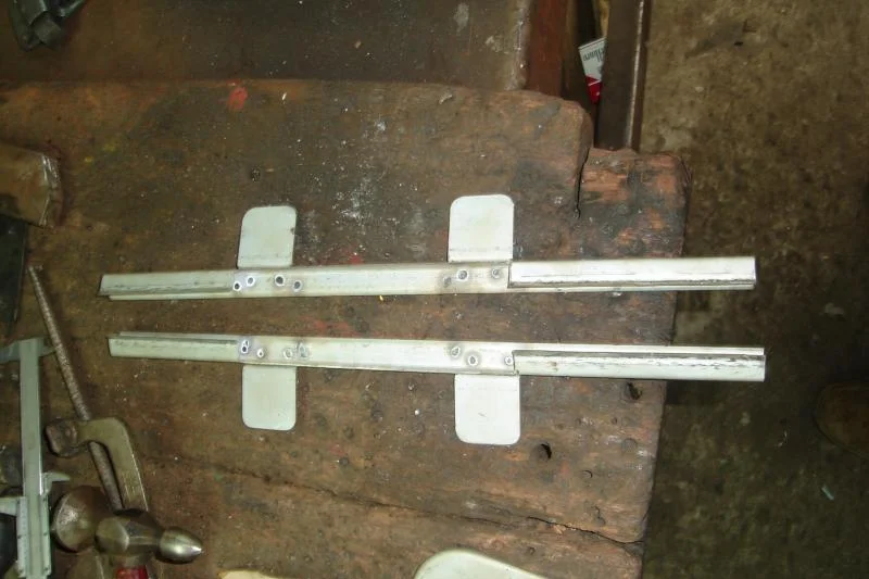

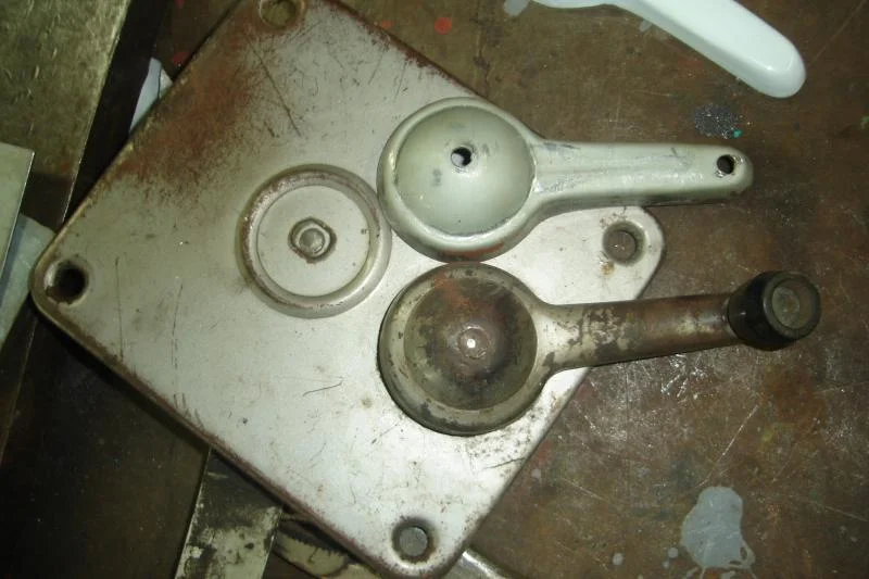

toyotona,

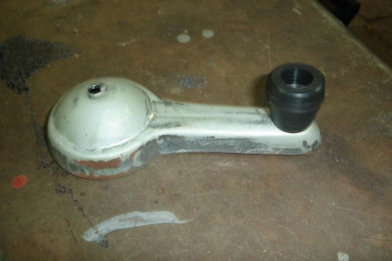

shot of the new full size doors and new handles we´re making..
The body will be reasembled and put back on the frame this week.

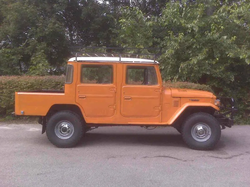

Now that is the one that I want.
me too!!! just round those rear doors to match the front and I think you got a winner!!!
toyotona
that troopy with those side doors is very doable..got me thinking..

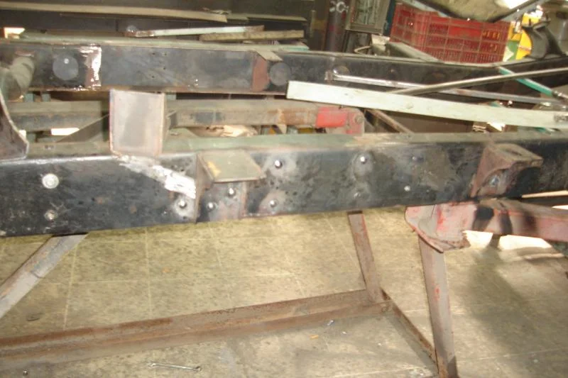

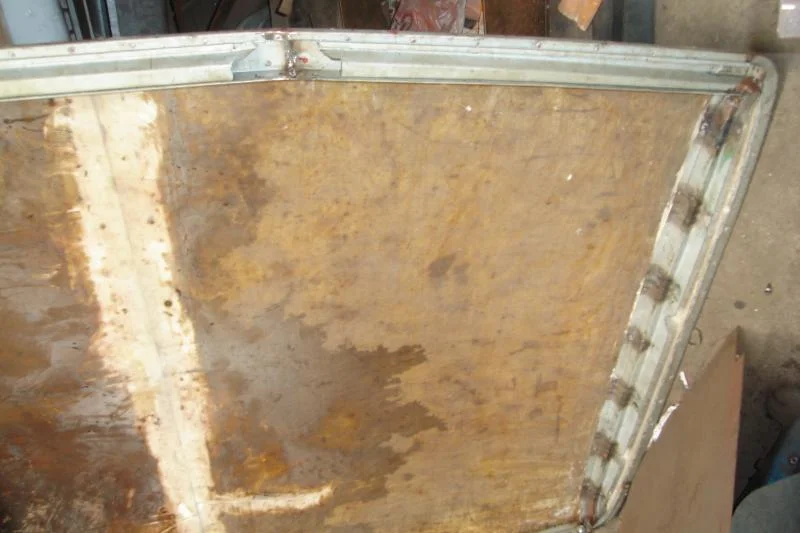

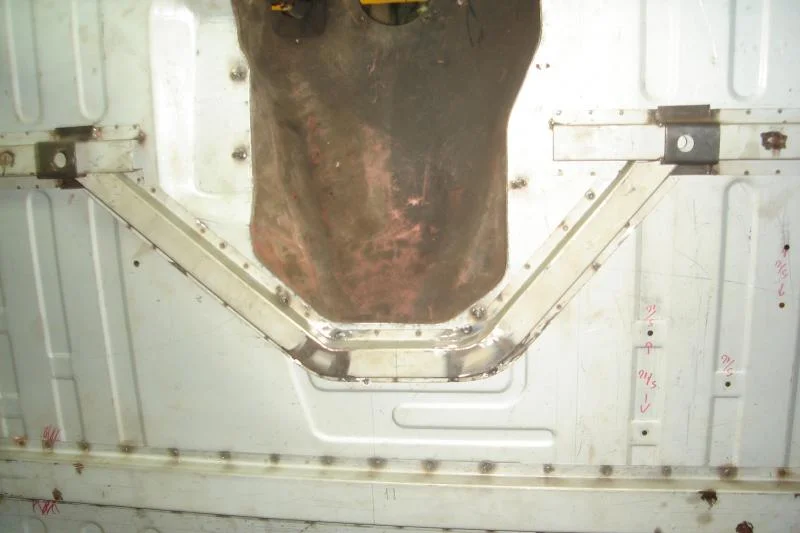

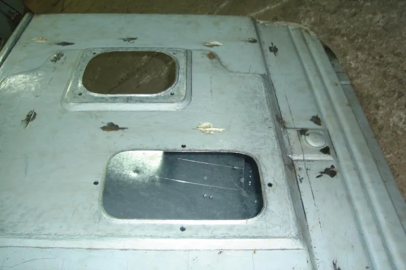

heres a few more of the new door plate,´a terrible shot of the chassis work. and the reinforced floor just after the tunnel..
Paul
