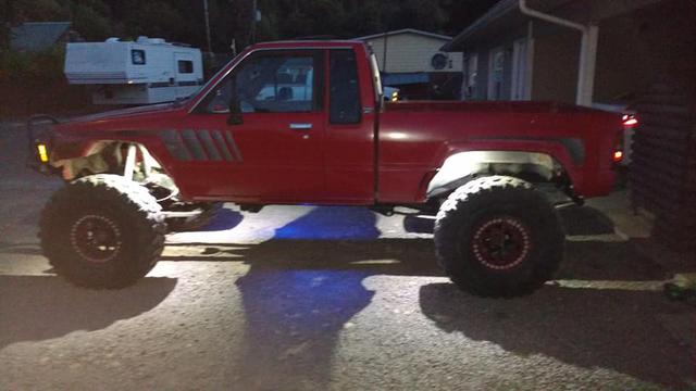

I was able to order some parts for the truck to make it a little more pleasurable. The window runs were shot, so I ordered a new set for both windows along with the inner and outer "wipers" or weatherstripping. I was also able to find a NOS full lock cylinder set, so that is being shipped to me as well. (The doors were not keyed the same as the ignition and I didn't have the door key.)
This weekend I will put the Iroks and wheels up for sale, so they can be replaced with 37x12.50r17's on my 2015 4Runner Trail Premium wheels. To make that work, I may have to move the 1.25" spacer in the front to the rear and buy 2.5" spacers for the front. I am also planning on running 10oz of DynaBeads for balancing just in case I spin a tire on the wheel up wheeling. The big decision I will need to make is what tire to run! I've had really good luck with Kanati Mud Hogs and would consider them again. I am also very intrigued by Milestar's new Patagonia M/T, but there isn't much out there on them. The last tire on my list is Cooper's STT Pros. If anyone has any insight, I would be more than happy to hear it!
Also on the to-do list this weekend is see if I can fix the dome and cargo lights, install my Ham radio, and start planning storage both in the cab and bed. I also may get working on the shifter bezel if a stock one doesn't show up for sale. My interior is clean enough that I would rather have a nice stock one, but cup holders would also be nice.... LOL!

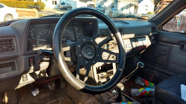

Do you have any interior pics? It looks like the seats aren't factory in the pictures you've posted.
I do have some interior pics from the POs for sale thread. Actually, I will just post all of the misc pics I have from the ad...
The seats are out of a Mini Cooper. They are super comfy and have the seat heaters hooked up.

Probably not a big deal, but that is not the original dash surround and pad. That is from a later truck. The 85's had a more angular surround on the cluster, and the "tray" in the pad went all the way across. Just an FYI...

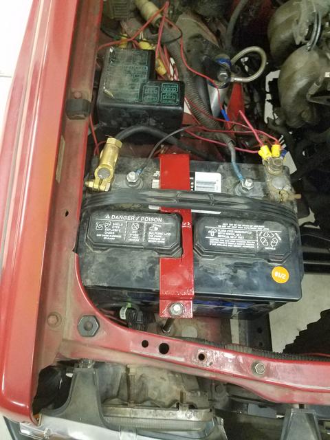

I got some work done on the truck Saturday: The tires and wheels are for sale. I fixed the dome light and the cargo light. I built a battery tie down to replace the ratchet strap. I de-stickered the interior. I added floor mats...

That thing was crying out to get rid of all the stickers! Mine came with a tire spoon drilled and turned into a battery hold down! That’s about 10% better than a ratchet strap, but I think one end is zip-tied, so that’s going to knock it back to a tie on who’s PO was more of a hillbilly! Must be a red late 80s thing?

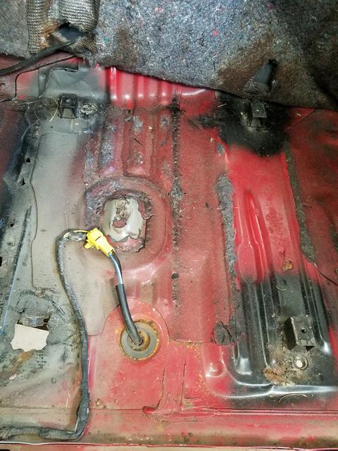

Lastly, I figured out how the PO mounted the Mini seats. He bolted the Mini sliders to 1" square tubing and welded it to the floor. Totally not the way I would have done it, but it is what it is. The problem is the left front weld punched through the floor... That is my priority fix! I think I'm going to seal everything up and brace it with angle under the floor. I will probably do that to the passenger seat too before it breaks through.

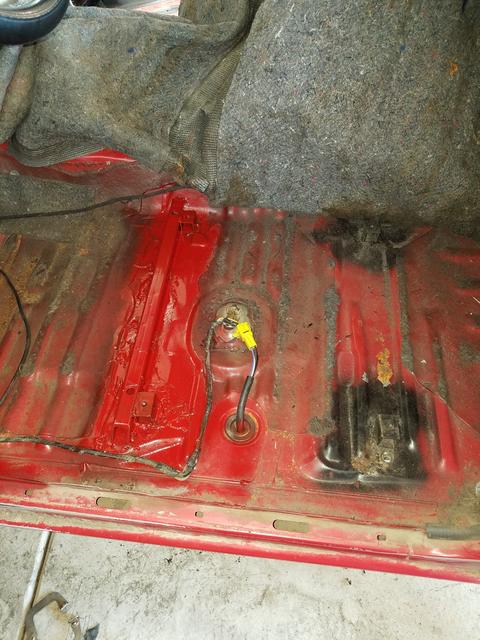

The first order of business was to see why the front left driver seat mount ripped through the floor. I pulled the seat, trim, and carpet back to find whoever installed the Mini Cooper seats cut the front support out. Then in their infinite wisdom (*sarcasm), they welded 2" chunks of 1"x1" square tube to the floor as the new seat mount. No other reinforcement at all...
Needless to say, I was not impressed... The fix was to use more square tubing to brace both front "mounts" the entire span of the floor and up onto the trans tunnel. I welded it in, then used JB Weld to seal up any holes and give it a little more strength.
It's not going to win any beauty contests, but it is nice and strong now!
