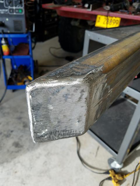

I didn't get nearly as much done on the truck as I wanted to this weekend. However, I did get the sliders sorted. I just need to finish weld them (ran out of gas in the welder) and weld them to the truck. Then it will be on to the back bumper...
Oh, and I only lit myself on fire once so that is a plus!

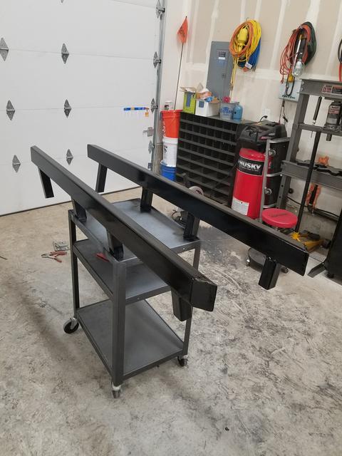

Yesterday was rough... Between juggling work, family, and truck I was exhausted! I came home from work planning on taking a night off of welding to just relax. Well, that didn't happen. LOL!
I headed out to the garage to get the sliders all welded up.
I decided that I would paint them before final fitting and welding them on the truck because I'm going to tuck them pretty close to the body and it would be hard to paint them once they are welded on. And that is when I became a victim of the 7 P's... I didn't have any primer or semi-gloss black paint...
So I drug my tired butt to Walmart at 9:30 to see what they had. I got lucky and was able to get it done around 12:30 this morning.
Now I think I deserve a restful evening and I will get them on the truck tomorrow! LOL

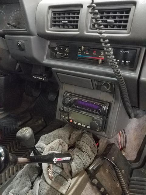

1st up was installing my stereo and 2m Ham radio. Unfortunately, the old Kenwood stereo my BIL gave me is dead, so I will need to swap that out eventually. At least it is plugging the hole in the dash for the time being. LOL! For the 2m antenna, I was going to mount a 1/2 wave on the passenger side bed rail to match the CB antenna. I know this would make for dead spots and not the best ground plane, but I thought it would look the best. However once I got it all set up, the damn mount broke and I didn't have another one. My solution was to run my mag mount on the roof with my flexible 1/4 wave antenna. I'm going to have better reception with that anyway.

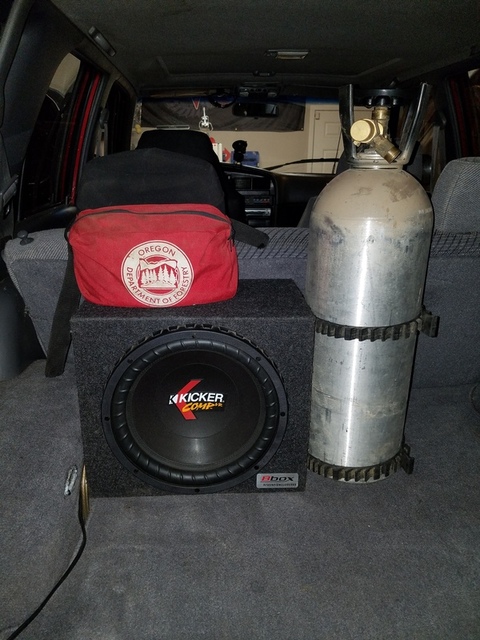

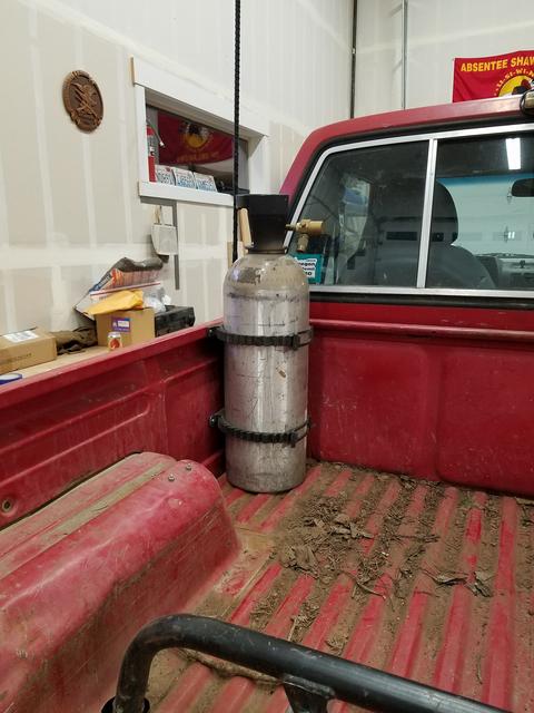

After that, I used the XL QuikFist clamps to mount my CO2 tank. I have decided on running a side box instead of a crossover toolbox in the bed, so the tank should be well protected.
