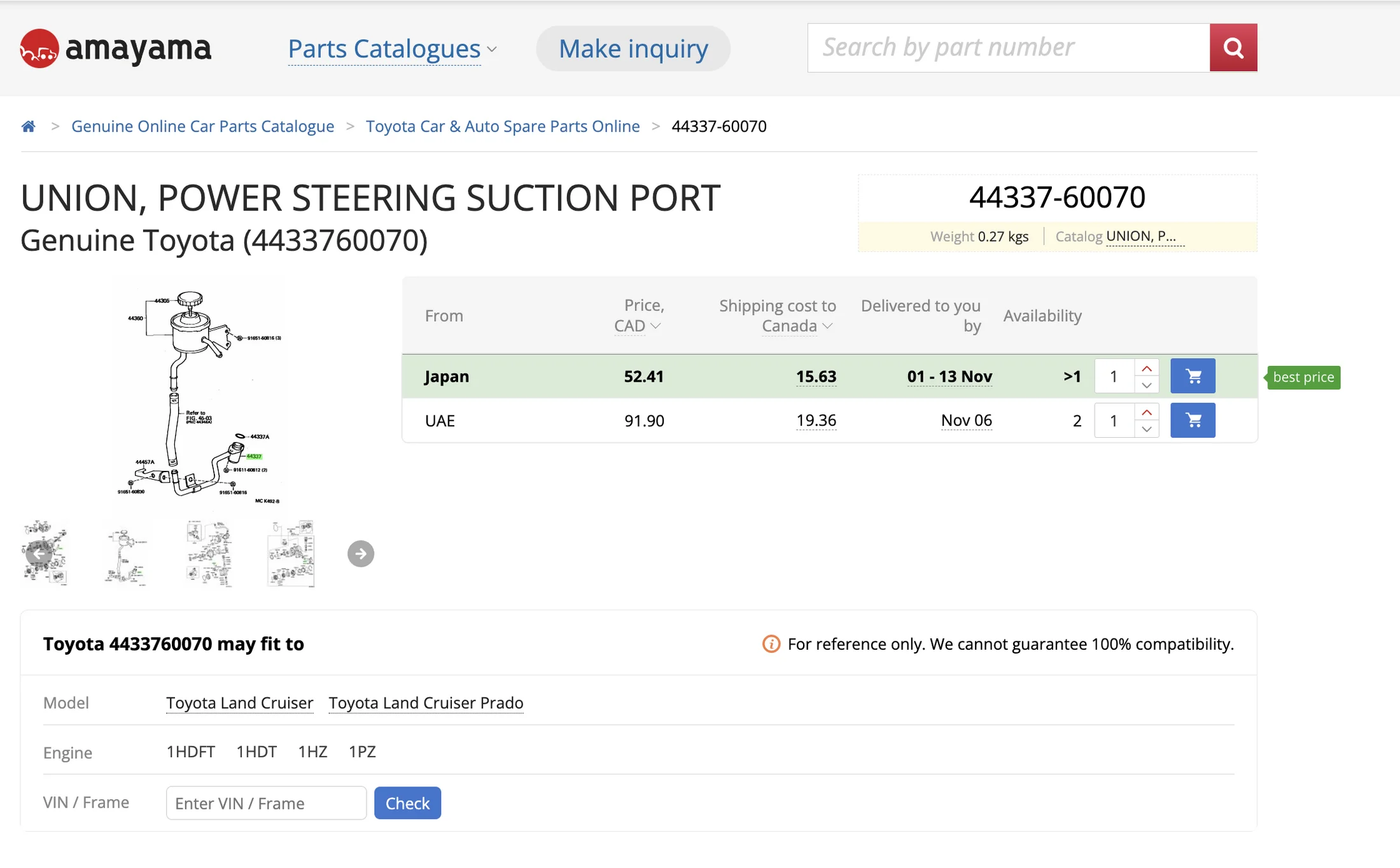

Thank you for that. Ive never ordered from Amayama but just ordered so hope it gets to my girlfriend before she heads back to Costa Rica and can bring it to me.
Well this is a Japan company sometime they let you order then refund you because they don't have it but that's more for electrical stuff .... GL Mate!

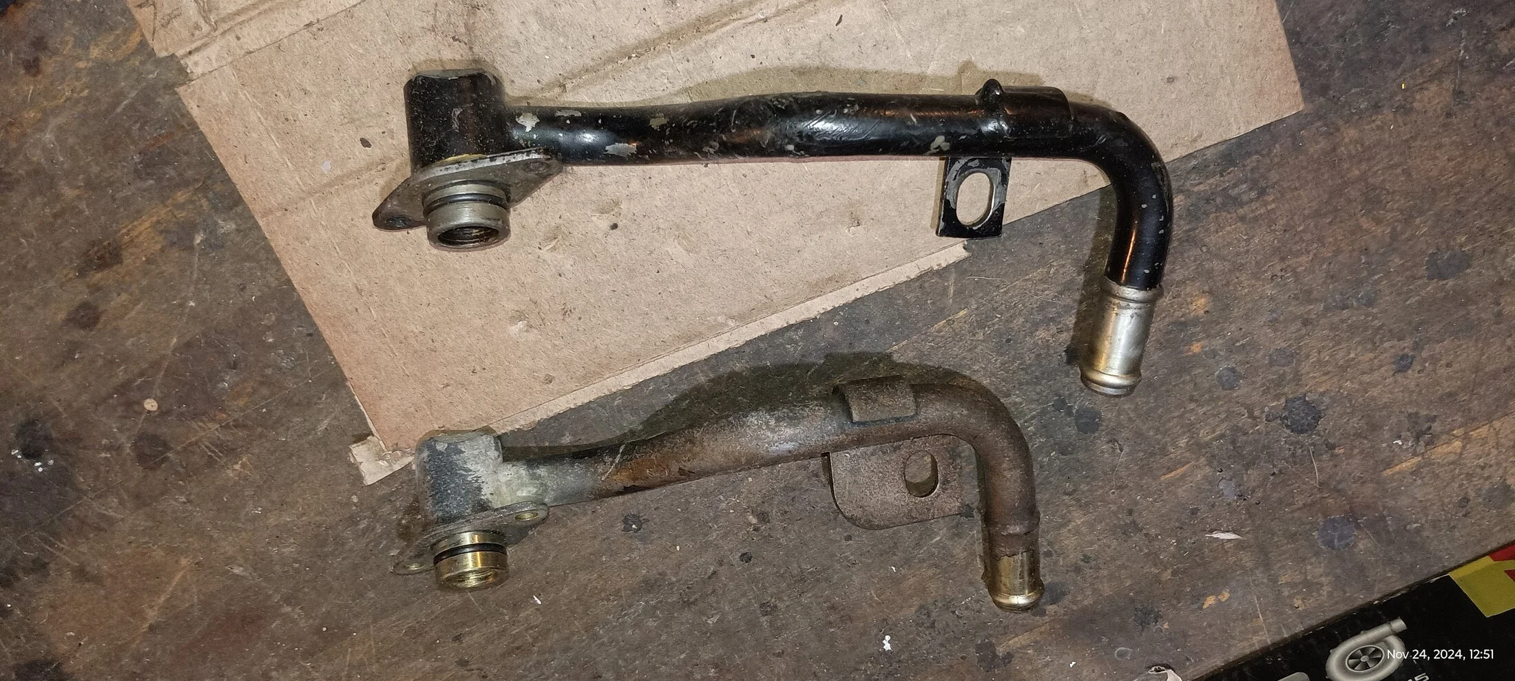

Thanks for all the help, found one used locally here in Costa Rica!! Power steering all fixed. Now need to replace the whole drive train lol
