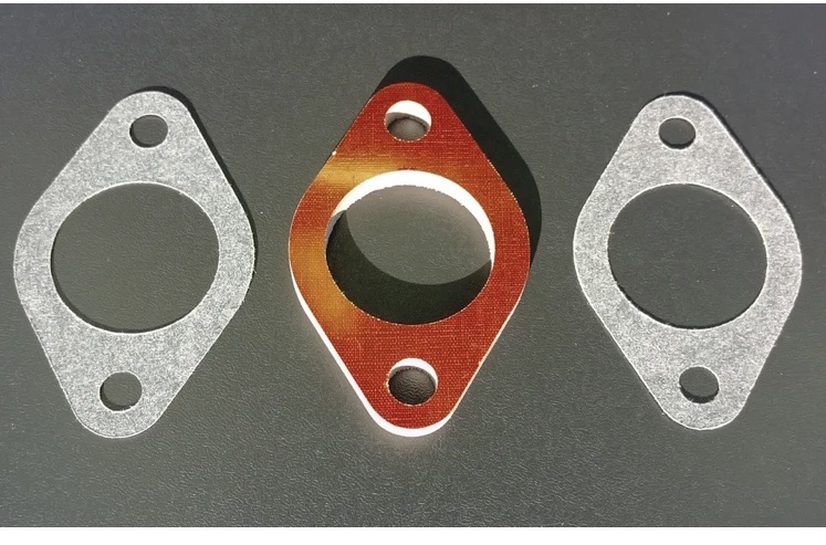

After repairing the exhaust/intake heat valve I was installing the carburetor and noticed the insulator was pretty rough looking. Does anyone know the correct insulator for a 1962 FJ40 with a stock carburetor?
Robert
I think 62 would not have a PCV system so it would be an insulator without the extra tube. Like this:
Exactly, who carries this?
The one pictured is sold by a person in AUS. Not sure if he has anymore. Let me find the eBay listing. I believe @65swb45 sells a metal version. Hopefully he can chime in and correct if I am wrong.
