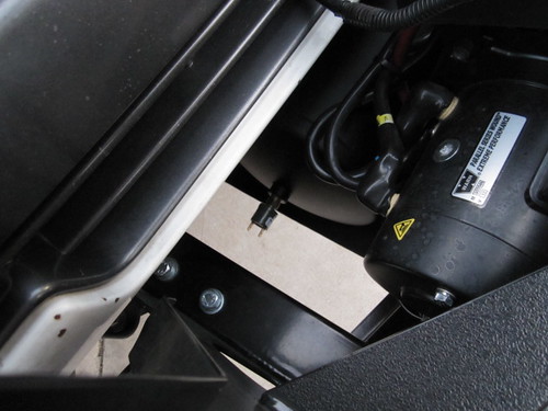

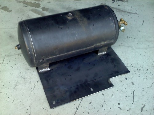

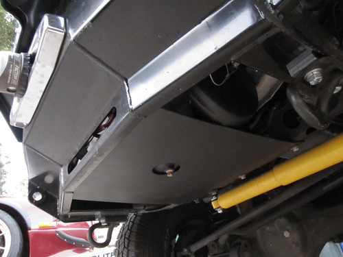

Found a little time to start on the 4lbs air tank mount, As a surprise to me it fit directly behind the winch tucked up in the front bumper with plenty of clearance. Couple photos when test fitted, now off at the powder coaters so been working on the mounting plate for the compressor (pics soon)

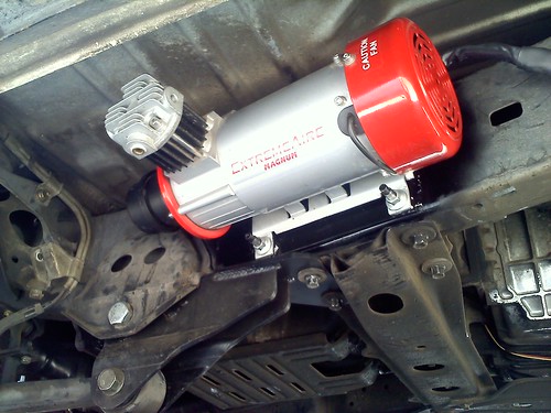

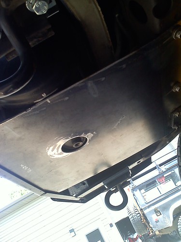

Got up early this morning so I went ahead and finished up the mounting plate for the compressor. As that the 80's frame is a enclosed type chassis I decided the compressor would be secured better by welding a studded plate to the chassis instead of drilling the chassis and using self tappers as that getting nuts on the backside was not an option. The fitment is great just back of the control arm on the driver's side. I should be getting the air tank back from the coaters in a couple days.
Any plans to protect the compressor in some type of enclosure or something? Reason I ask is because I think it will get extremely dusty and dirty in that location, also it will probably get damaged by water in river crossing or even driving in the rain.....

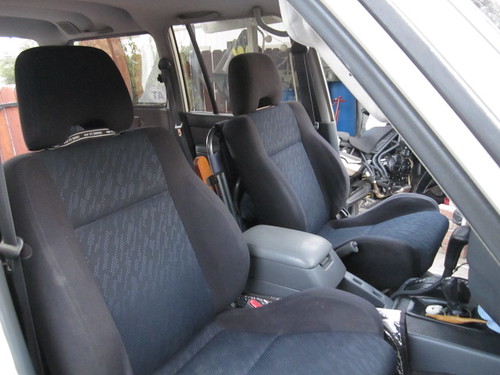

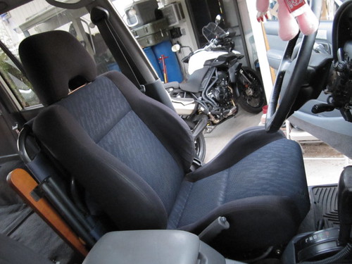

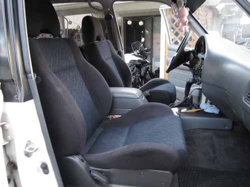

Lately I've been thinking of picking up a leather cover kit w/ new foam inserts but at a cost of over 600 and also that the passenger seat's forward/reverse motor is dead I have been looking for alternatives and I found one. This weekend we came across a pair of Subaru WRX front seats in great condition on CL asking 200obo but after all was said and done he traded me for a SO 3/8 Air Ratchet that I was looking to let go of. So Sunday morning after dropping off my wife I dove head first into getting them installed and 7 hours later... wallah new seats in the 80!

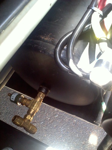

also got the air tank back from the powder coaters so bolted it in aswell, now just have to wire in the pressure switch and we'll be up and running.
Sport seats from a 02 Subaru WRX mounted in the 80
4lbs. air tank mounted up inside the front bumper behind the winch
air tank right side with pressure sensor
bottom view of the mounted tank, relief valve/drain will be installed soon
Pezpon: Yes and Thank You, I put together a shield to protect from small debris also will be installing a snorkel so the air intake can be relocated to the upper engine bay so light water crossings and heavy rain will not be an issue.

The seats didn't bolt straight in and actually it was a bit of a job. The LC seat rails/mounts are just at 13.5" spaced but these Subaru seats were 17.5" so as you can imagine there was a bit of cutting and bracket making going on. I did though only modify the seats, I did no modification of the LC's mounting holes so the original seats still fit and if I ever decide to sell the Subi seats to someone with an 80 they'll bolt right in.
