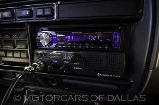

I like how you've got your 2m radio mounted. I have a Kenwood 281 with a front speaker that I'm planning on putting in the bottom half of the 2din location, and then a CB in the ash tray location for when I go out with the Cretins. Have you seen these antenna's, http://www.amazon.com/Laird-Technologies-142-160-Phantom-Antenna/dp/B00794VPBI/ref=pd_sim_sbs_e_1#productDetails , they're zero gain, but apparently work well and I dig the low profile, and my thought is to carry a 5/8w whip if I need to get more range.

Not trying to thread jack you here but the po on my truck put the cb on the bottom of the double din which I like because the mic wire doesn't hang over the radio
