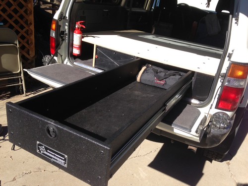

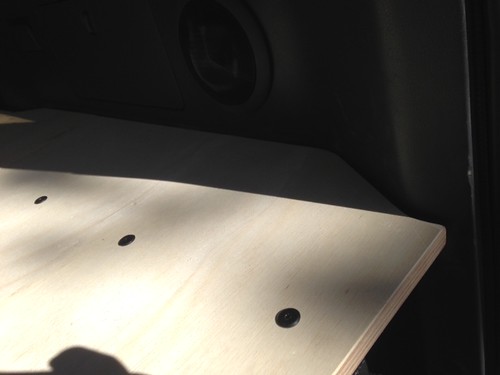

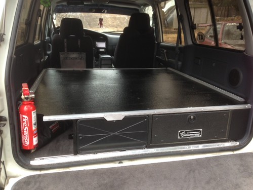

The most recent project that I am working on is the Sleeping platform that includes a 54" pull out storage box a 27 gallon fresh water tank and Logistic Aluminum tie down tracks. The basics are complete on the rear section just have a couple hours left of finishing work and mounting of the tie rails then the front storage box/platform construction begins.
More to come soon
.75" sanded ply for the base floor and right suport

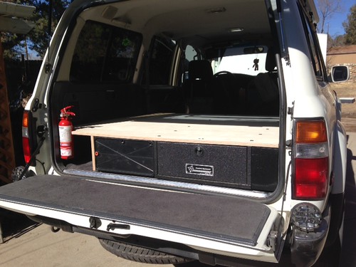

54" heavy duty pull out box with plenty of storage space

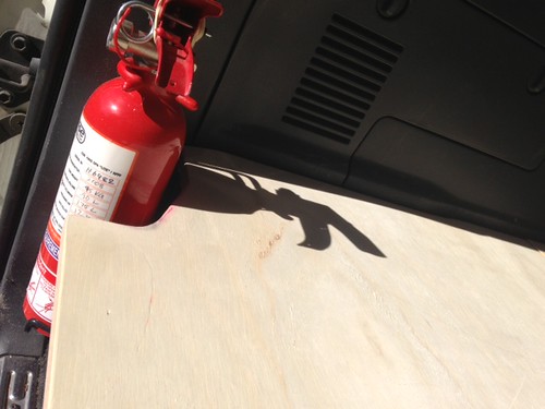

Cut out for easy removal or the Fire Extinguisher with tail either closed or open.

Yes the seam runs across the vehicle (drivers to passenger) at the halfway point of the storage box at 27". each piece is approximatly 27" x 59" with the 59" length trimmed to contour the interior panels

Question on you rear platform. Is there a seam in the top somewhere? When I was building mine a while back, I couldn't get it cut to fit in one piece.

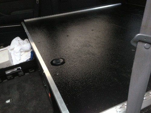

Coated the platform with a rubberized coating his weekend as well as installing the water tank fill neck. The coating turned out a little on the glossy side but hopefully should scuff up and loose that glare.

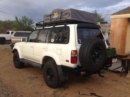

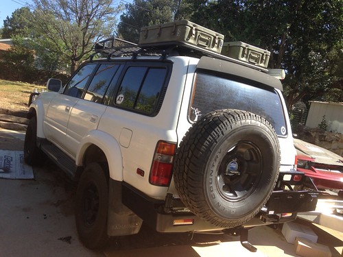

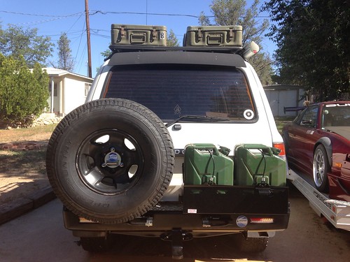

Installed a Kaymar rear bumper with swing outs this past weekend the installation was simple and went together in just a couple hours. First we removed the oe bumper side caps, mud flaps along with the aluminum top plate and the bumper's left and right under structure so all that was left was the fame (pic). From there the mud flaps were reinstalled then the bar was lifted into place and bolted down. Then both swing outs installed by placing them over the spindles then dropping in the top barring, flat washer and tightening the castle nut followed by a cotter pin and dust cap. Wiring was quick and easy as well since the harness was equipped with plugs that tapped into the existing oe harness located right side rear area of the spare tyre.
Rear bar complete including rear flood light mounted center of the spare tyre and license plate/light

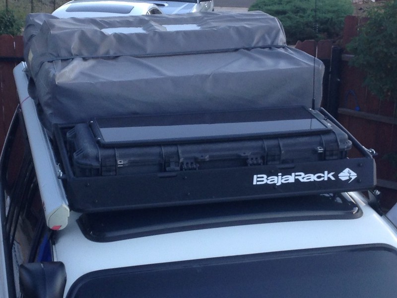

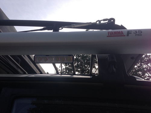

Picked up a couple small LED work/flood lamps for the Landcruiser last week and found some extra time to mount them this morning. Simple install mounting them with rubber isolated steel loop rings to the roof rack. I also came across a lightly used Camping Lab RTT and had a couple friends help me get it mounted up on the rack. Only fall back is the storage chests on the rack were removed so I'm now looking into constructing a loft shelf to house the extras if necessary.
Drive's side LED mounting
Passenger side LED mounting under the awning
Camping Lab roof top tent

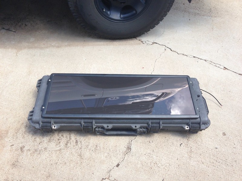

Picked up a used Pelican 1720 from a friend the other day so I decided to put together a simple roof mounted solar charging system to help maintain battery health.

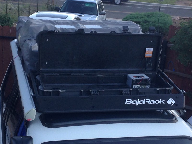

Started with a Pelican 1720 case then mounted a 15 watt aluminum framed solar panel to the top lid of the case using 6mm button head bolts, .5" nylon spacers, flat washers and nylock nuts. On the inside I installed a solar charging regulator as well as a Deka ETX16L and two marine sockets so we could plug in accessories right into the case's sides without having to open the front bonnet or a door to access power. Once it was completed the entire unit was mounted to the roof rack with U bolts, plates and nylock nuts. I tested the output once all was said and done in good sun light but not direct light and was putting out 14.2 watts.
I may add some dividers to protect/separate the battery side from items that may be stored up top.
