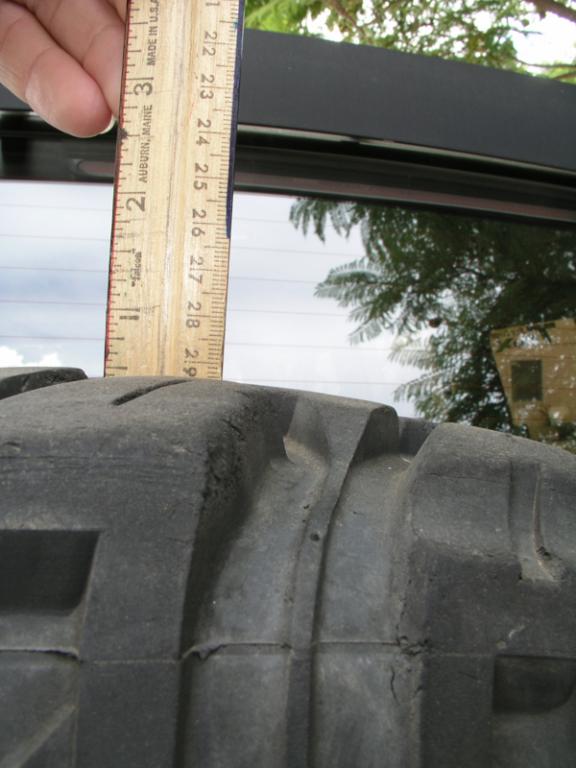

OK so here is my 2yr. 25,000 mile review.
I have (5) 285/75/R16, I have rotated them approximately every 5,000 miles although I have been slacking lately and have not rotated them in 8,000 right now.
I still have quite a bit of tread life on them (7/16"), have not lost any chunks or had any sidewall issues. I have had them on all types of terrain from sand at Superstition Hill in Plaster City and out in the Oyster Shell Beds in Ocotillo. I have also had them out on the natural slate in Death Valley as well as the beaches of Baja. These tires have done the job on everything although I try not to aid down past 18 PSI and normally air down to 21 due to the known weaker sidewall.
So that is my update so far and feel free to ask me any questions. Here are the pics below, and to see the full album showing how much lift the 285's gave me click here: Cooper Album
