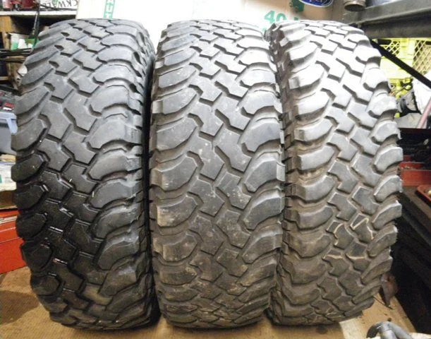

From the Tall and skinnys tire thread in Expedition Forum - See Below:
"Left to right they are: a 33x10.5r15, a 285/75/16, and a 255/85/16. Each of these tires are BFG m/t km. Tread patch width unmounted is: 8.25", 8.75", and 8". The 255 is tallest, but it has the deepest tread remaining. So not as big of a difference as one might expect from the nominal dimensions.
