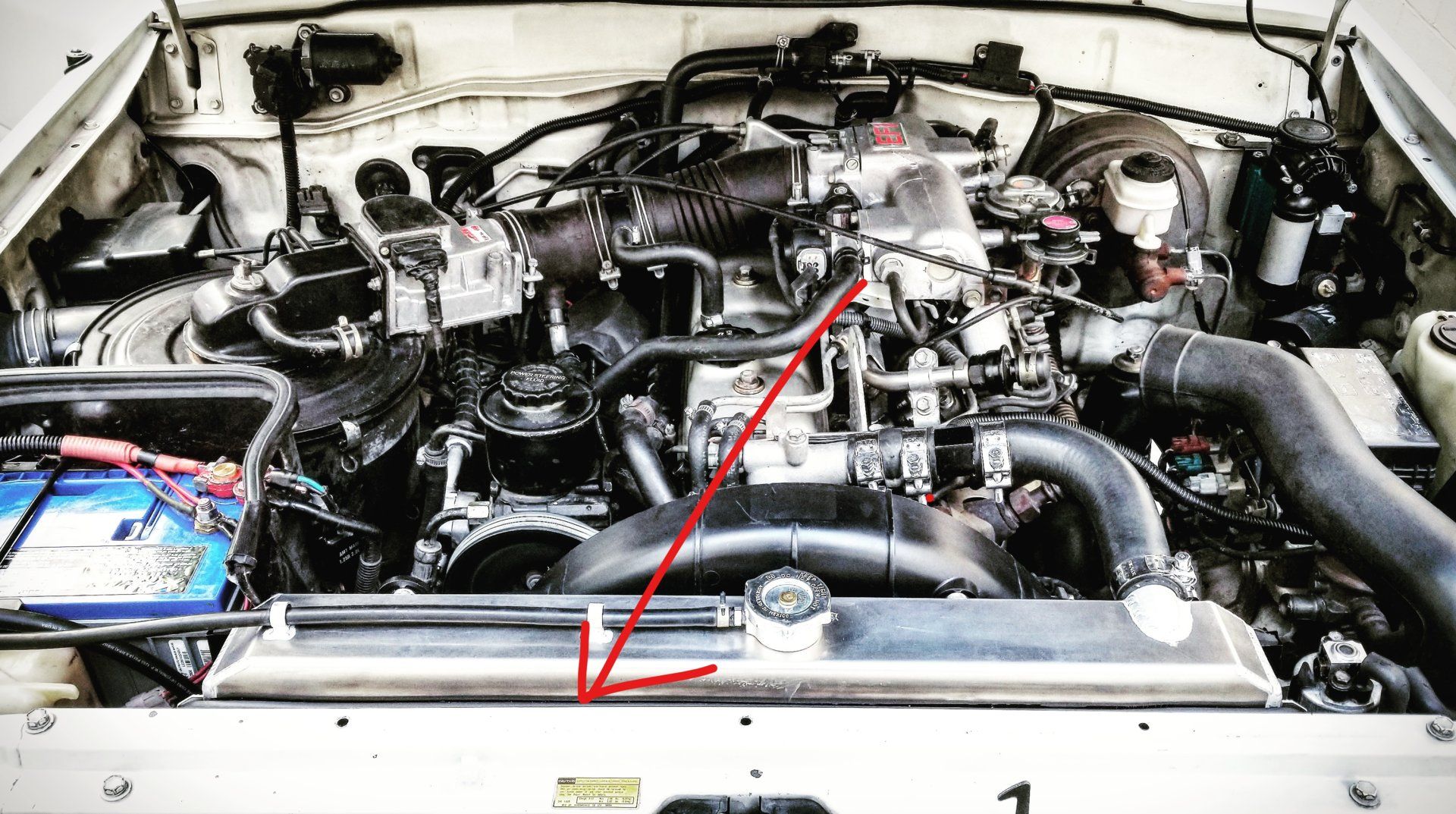

you meant the gap between the cross bar in front of the radiator to the ac condensor?
yeah, that gap is sealed, spent alot of time sealing up the gap between the radiator and the front core support as well as modifying the shroud for a good seal, the fit and finish on the RD radiator is top notch.
