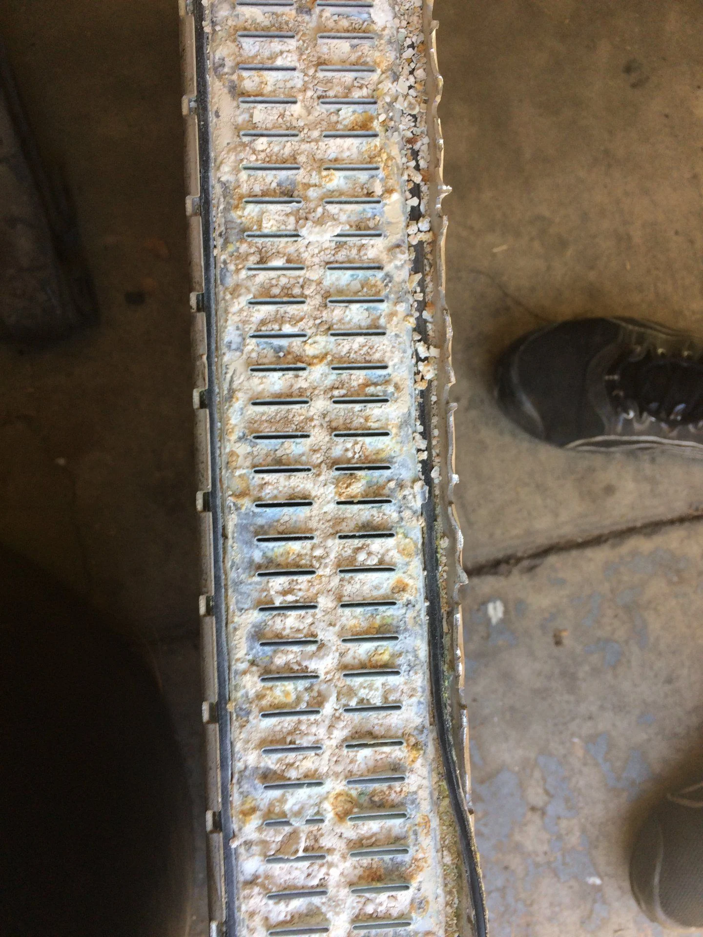

FYI - UPDATE. Many thanks to @brianh699 for getting that radiator to me. Not sure whats special about mine but the damage in his rad that he passed on to me just happens to have been damaged in the perfect way to allow it to fit without modification. I ordered a KOYO and an APDI that didn't fit because the 2 front holes were 1/4 inch to wide center to center. The bent one fit perfectly (30 inches 1/4 center to center). Weird. Anyway. here are some pictures and video of the results
As you can see there is something funky on the inlet side. All the paint had be heated away. Yes its behind the trans cooler but there is certainly something more than a little extra heat. Methinks my CSF had a block there, despite a flush. Factory damage? Who knows.
CSF exactly 30 and 1/4 center to center. Which fits perfectly in my 97
damaged TYC...30 1/4 inches center to center. Interdasting.
Anyway, it worked. Hottest temps now are 194 full high hot (going up a canyon with AC on in 95 degree heat. I did the same run with my CSF and it got to well over 226 and climbing.

But I maintain there is 'something' amiss with the 2517 that you have. Mine does not have any trouble cooling my 97 (albeit different conditions) and others don't report the 'wild' and rapid heating that you have experienced either.
I would expect an aluminum radiator to perform better (marginally) but not 27° F. better. Something is wrong with the 2517 you have.

That's all we're saying: Some of us apparently received f*cked up CSF's.

thinking on it I think its just that the entire rad was hot and the extra heat from the trans cooler would have done that discoloration.
I wouldn't read anything into the paint. About 220F isn't going to do much, if anything. The paint isn't needed, works as insulation, but customers want them black, so they put as little as possible.
