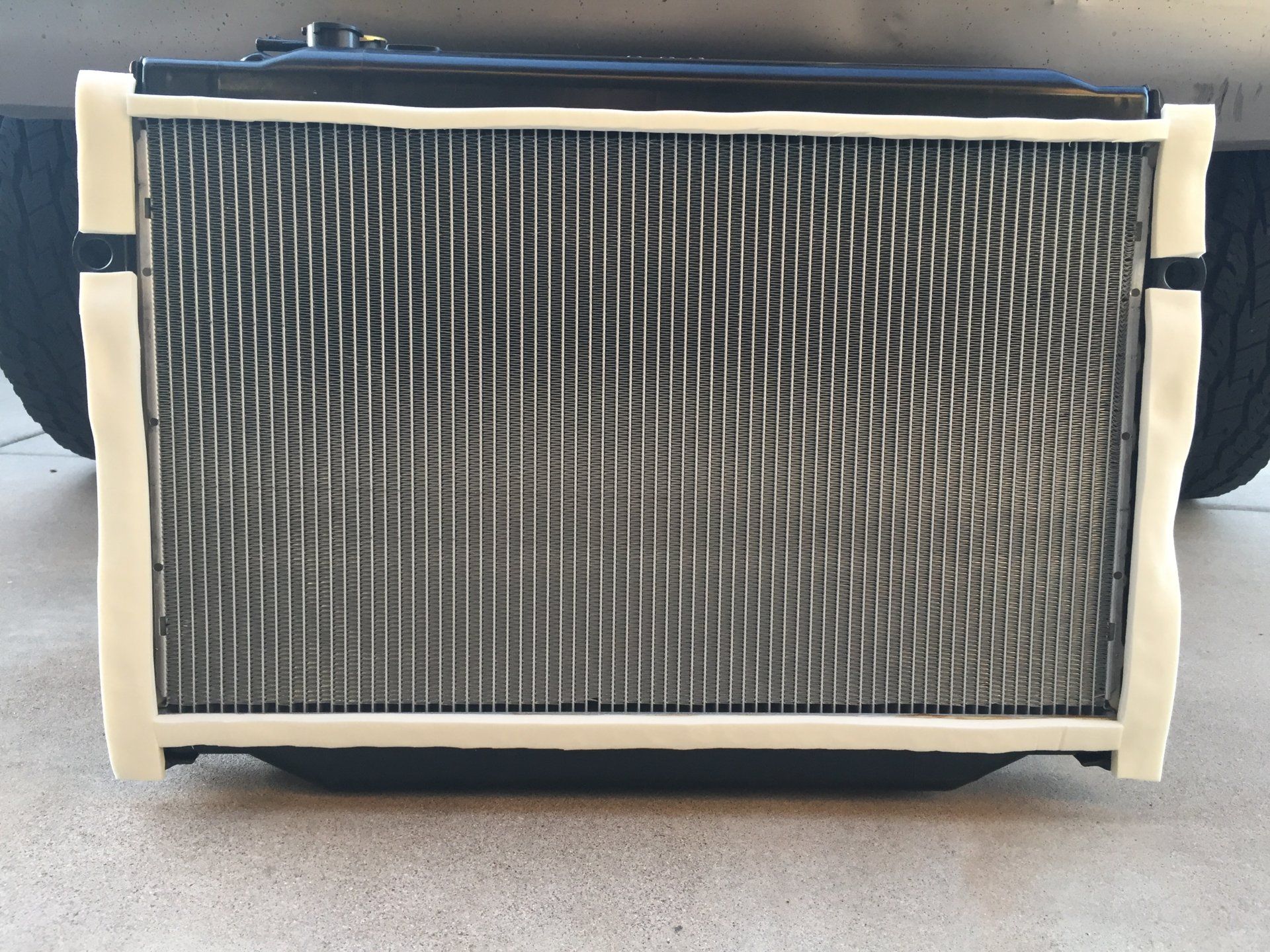

Radiator removal:
Remove battery box - Yes, do this.
Remove grill- Yes, do this.
Remove passenger side headlight and side marker light - Yes, do this.
I was able to reach the drivers side front radiator nut (barely) with a wobbly deep socket, without headlight removal. Not so on PS.
Maybe the 80's headlight shape is a little easier to clear with a socket extension than LX450?
Radiator install:
Glue sealing foam to front 4 edges with contact cement. Stays in place perfectly during install. No hassles.
Put a strip under the side brackets too. There's a gap.
Foam seal used is "md" brand (from Home Depot), 1/2" x 1 3/8" x 42" Premium AIR CONDITIONER WEATHERSEAL.
It's white closed cell foam.
You need 3 packages.
Mechanical fit was good. No issues.
Transmission fluid nipple can be loosened, rotated to fit, re-tightened. No leaks.
