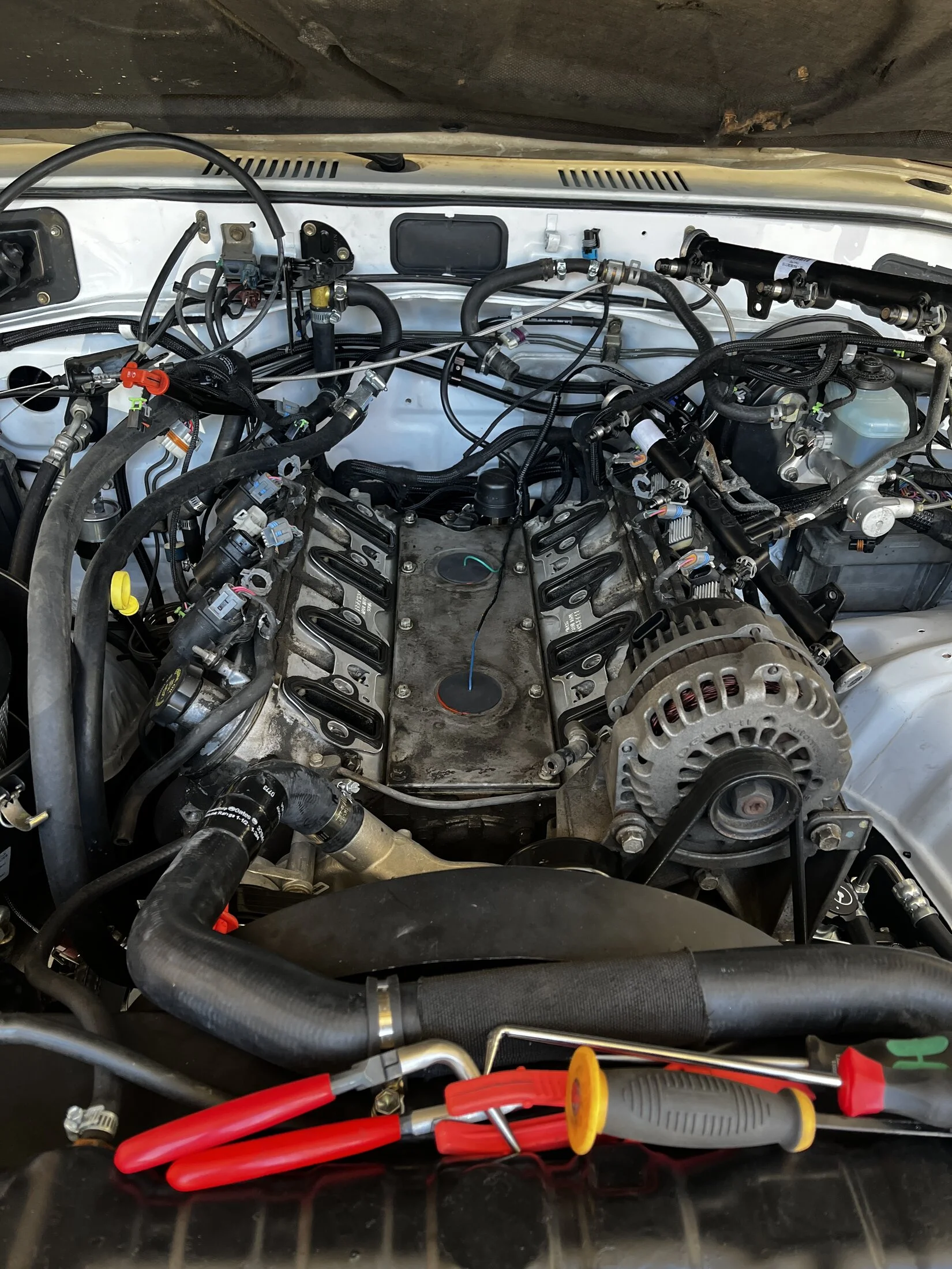

Also got the knock sensor replaced, and swapped in a new PS pump with filter. Lesson learned with the knock sensors – bench test before install. New pump is completely silent, thankfully.

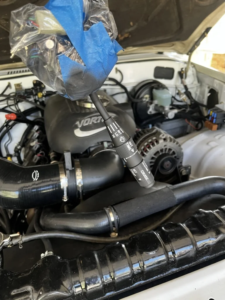

Now to get my cruise control working.

side note, did you paint your cruise stalk black? Mine is grey on the end. Yours looks really good

Yeah I did all black on the stalks, with the flat clear coat. Turned out better than I expected to be honest. I went back and forth on keeping the grey, but went black in the end.

ICT Billett sells a knock sensor relocation kit that moves them out of the valley so you don't have to take your intake off to change them. LS Gen III Knock Sensor Relocation Brackets LS1 LM7 LR4 LQ4 LS6 L59 LQ9 LM4 Valley - https://www.ictbillet.com/ls-gen-iii-knock-sensor-relocation-brackets-ls1-lm7-lr4-lq4-ls6-l59-lq9-lm4.html
Great find! Thanks for sharing. If I have one go bad again will definitely be utilizing that part. Pulling the intake does indeed suck.

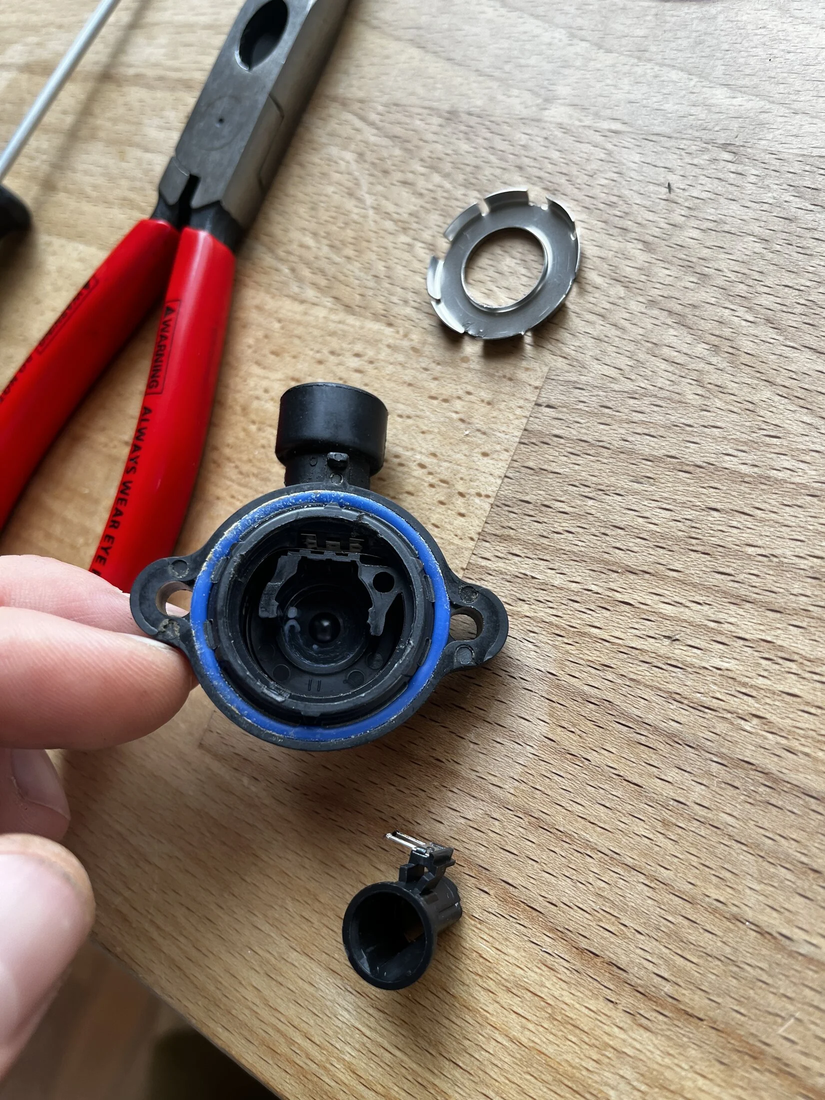

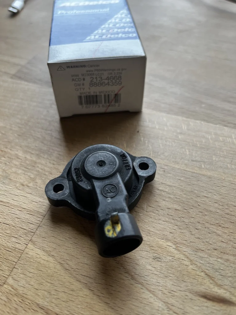

Got the new TPS swapped in. Pretty sure that was the root of the idle surging problem. Comparing the old and new, there was zero "return" pressure on the original, whereas the new one would spring back if I spun the center. Nothing obviously broken on the inside. Who knows.
I did an idle relearn based on this and this and this, and from what I have read on the various GM forums the computer will take a few cycles to settle things out. I'd also like to chat with the tuner about this, but am waiting until I have time to get the intake pipe modified to a larger diameter before I schedule that.

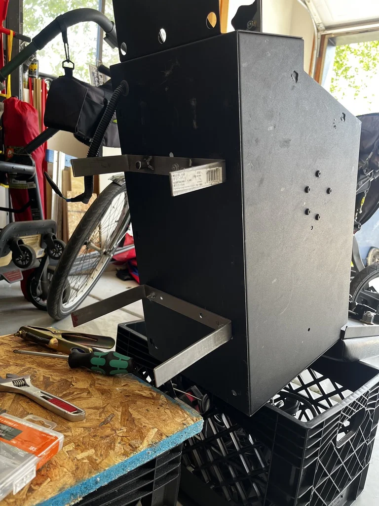

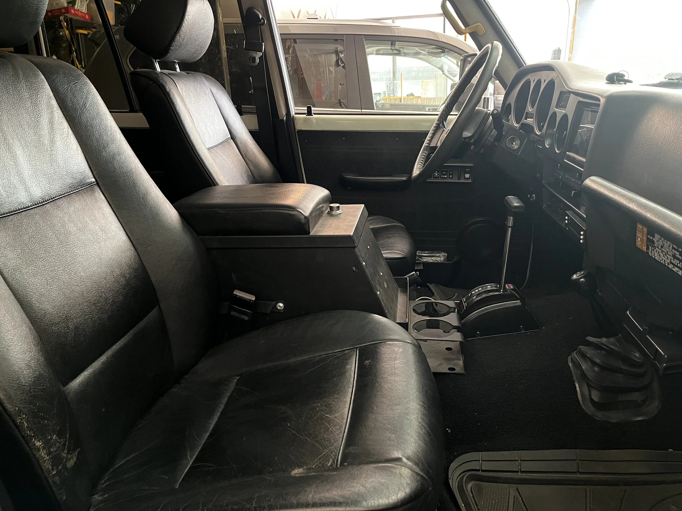

Finally got my center console mounted over the rear heater using nutserts and a couple of brackets.
I've got 2 very small kids, so rear heater will be a must in the coming years. I still need to build a heater surround, and cut some holes for car play wiring and rear seat power, but glad to have it solidly mounted for the first time in a year.

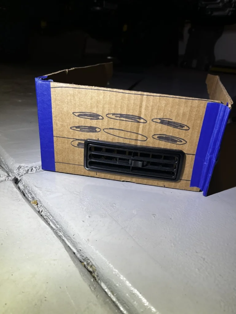

What are you planning for the heater switch? I have mine tucked around near the level lever and it looks like crap

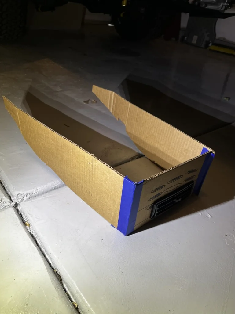

Ha. Exactly where my switch is now as well. I've got grand plans of putting something like this cardboard mock up together. I think the same shop that built my radiator fan shroud box will be able to bend it up for me pretty easily and then find the closest powder coating to the tuffy finish I can. I'll notch the switch into it somewhere. I'd like to avoid having to extend it into the actual center console if possible.
Other challenge will be the coolant flow lever. I have it bent down right now, but am puzzling a way to either extend it into the console, or make a clean spot for it to come out towards the rear. This thread, and this thread have a few well done solutions, but I don't have the original hot or hotter "box" unfortunately.

I say leave it cardboard dubs! Lol
