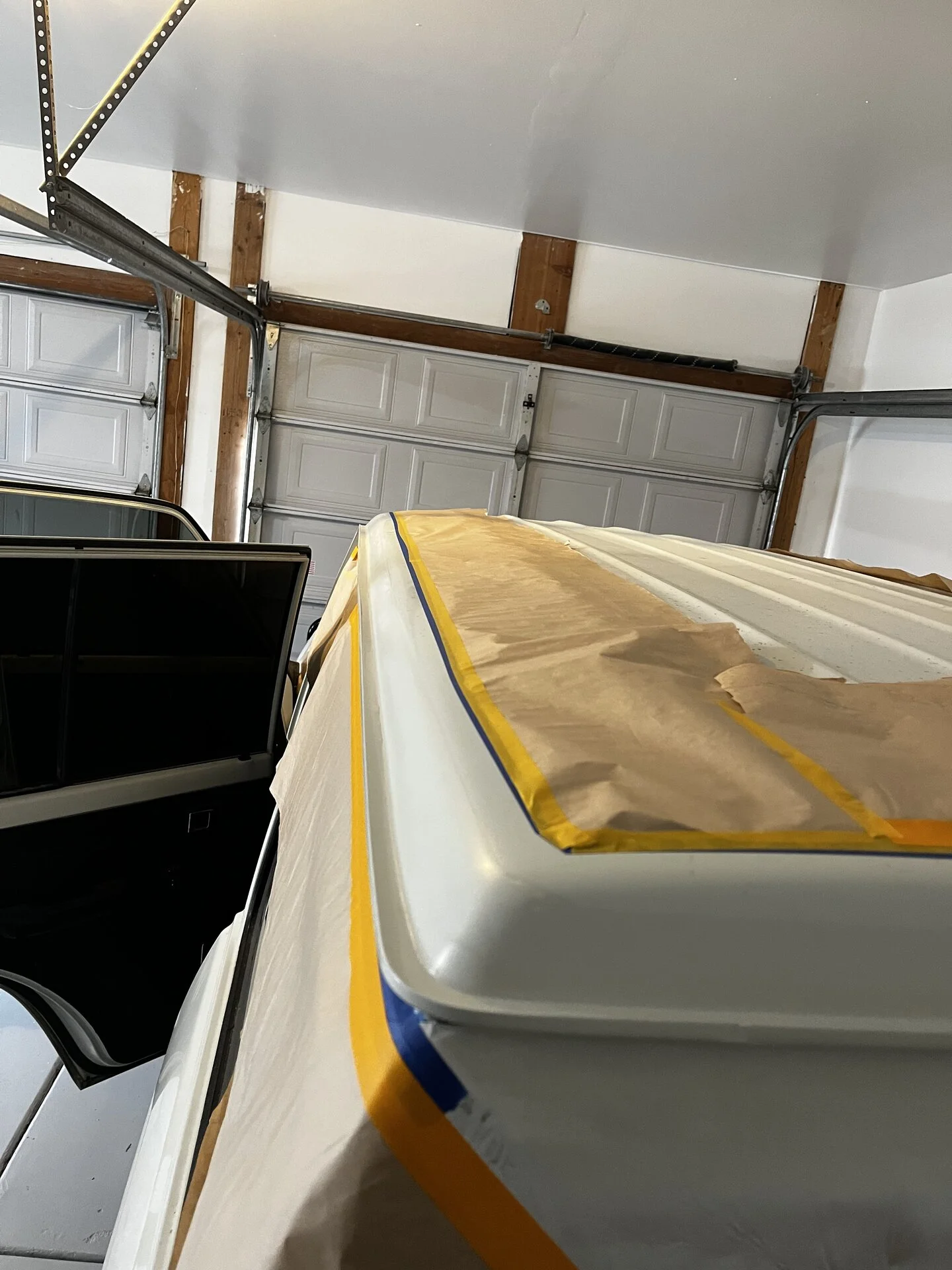

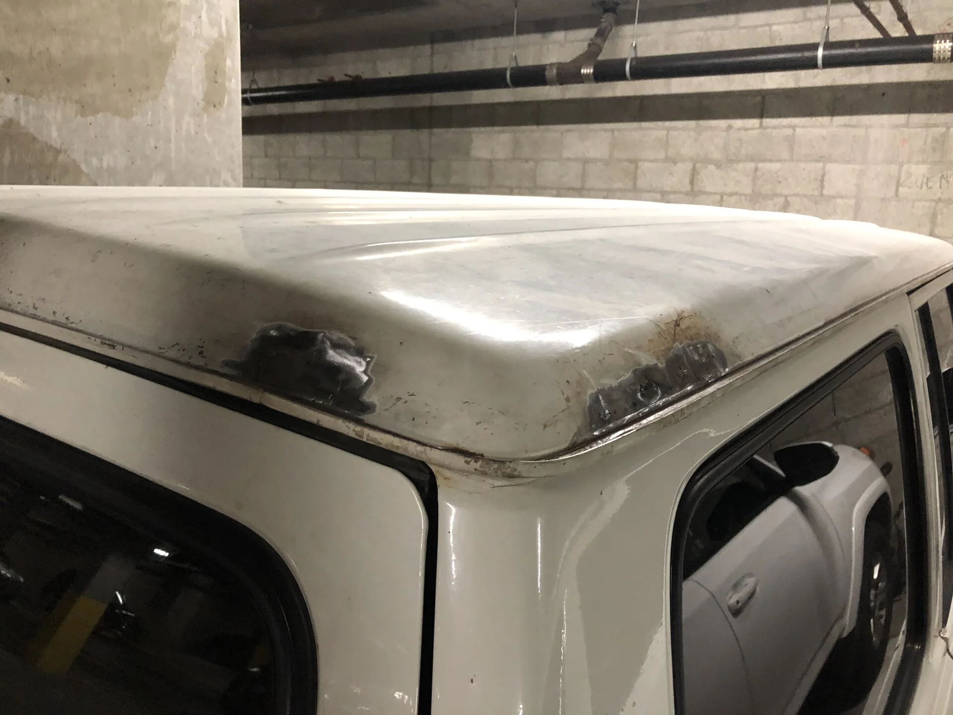

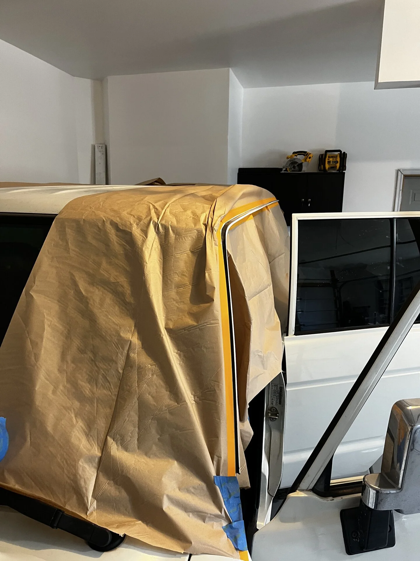

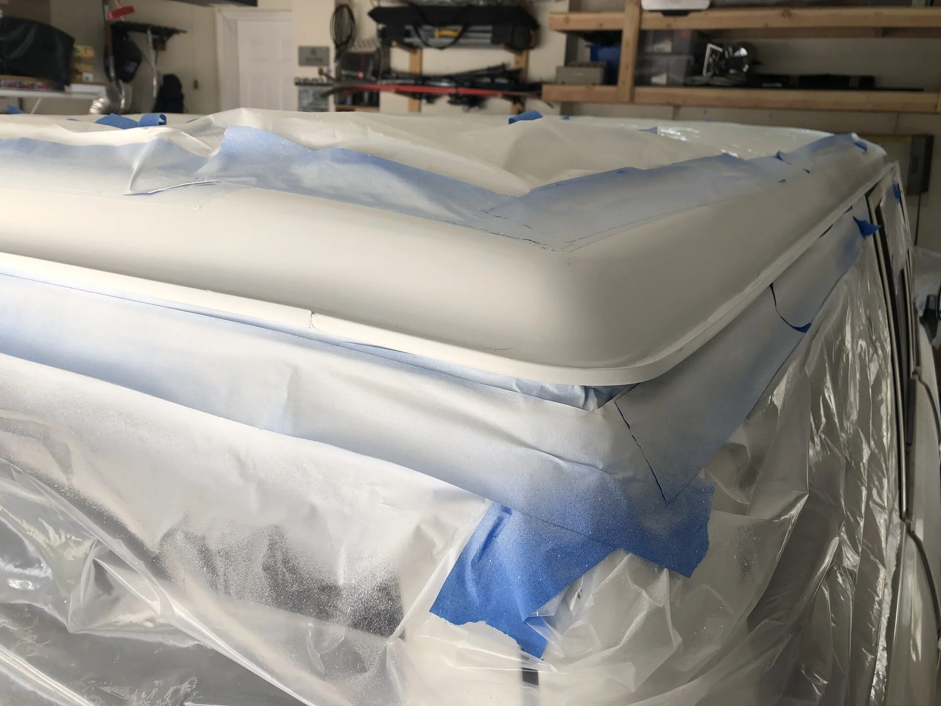

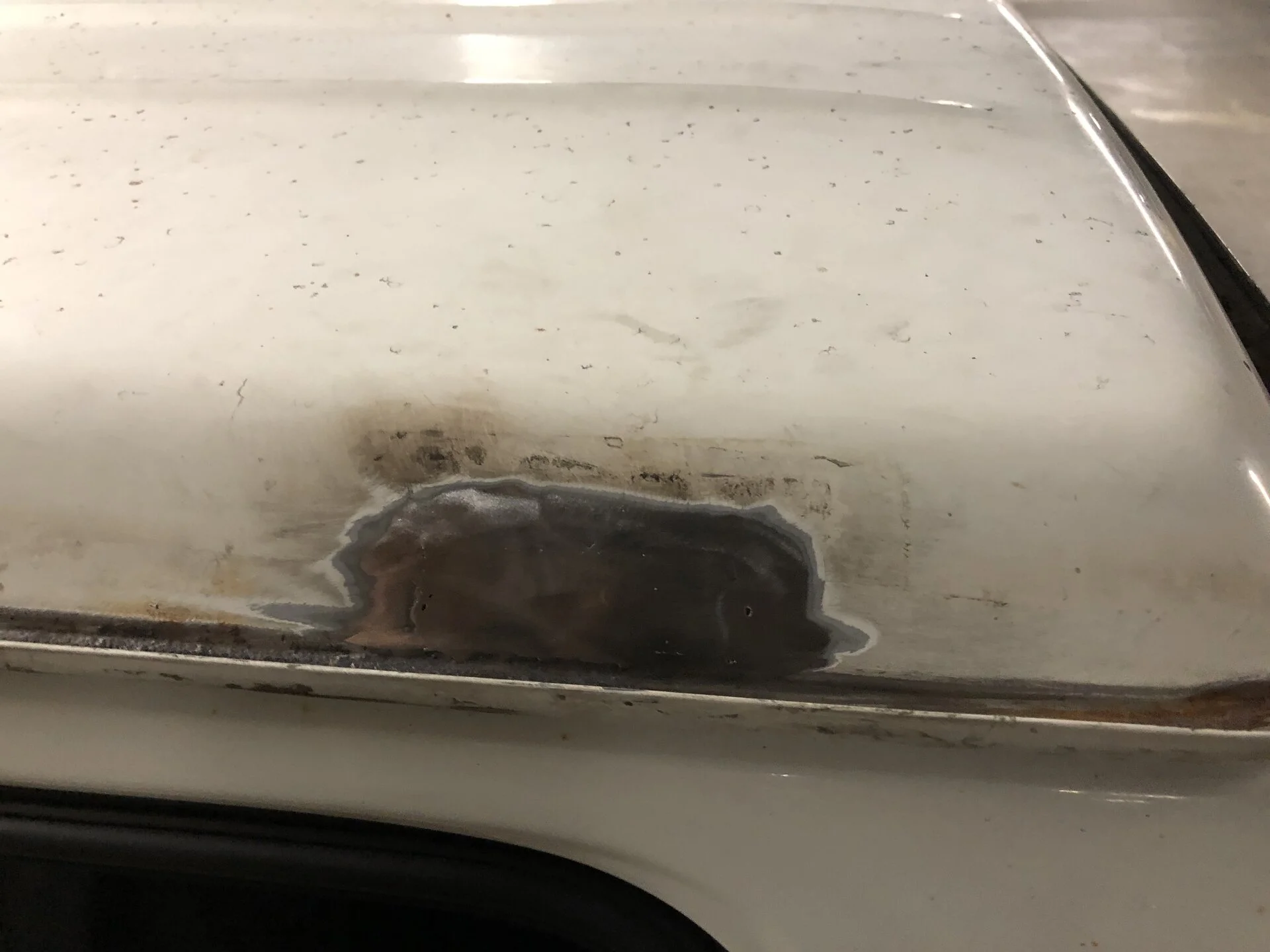

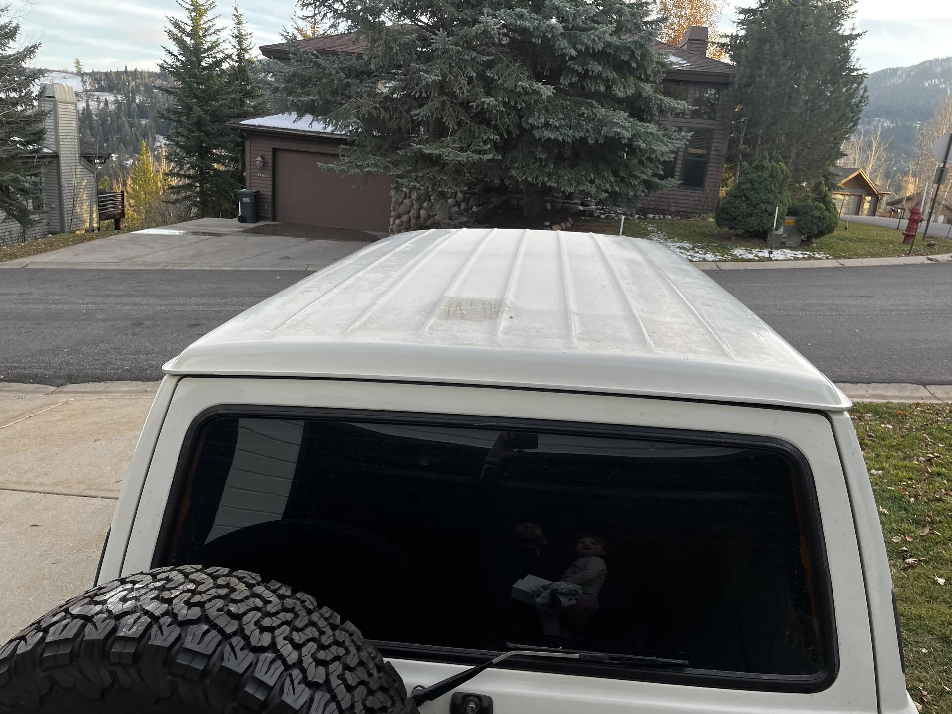

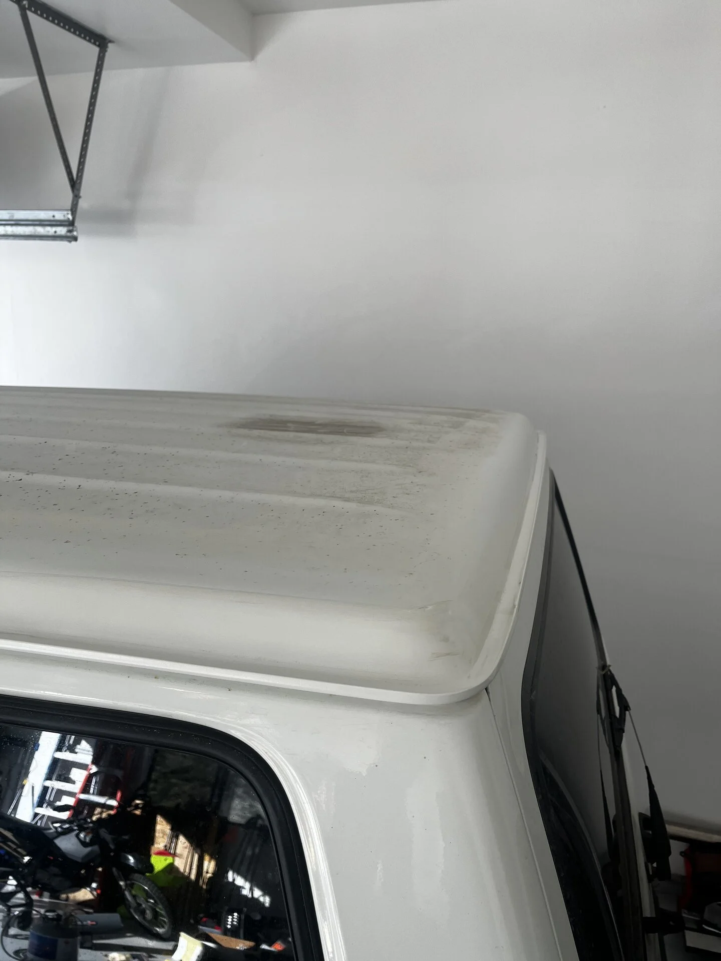

Haven’t had much garage time lately, but finally got my gutters resealed and painted before winter hits in earnest. I had a few small rust spots coming through, and that combined with water dripping off of my drivers side a-pillar grab handle while in the rain prompted a patch and gutter reseal.

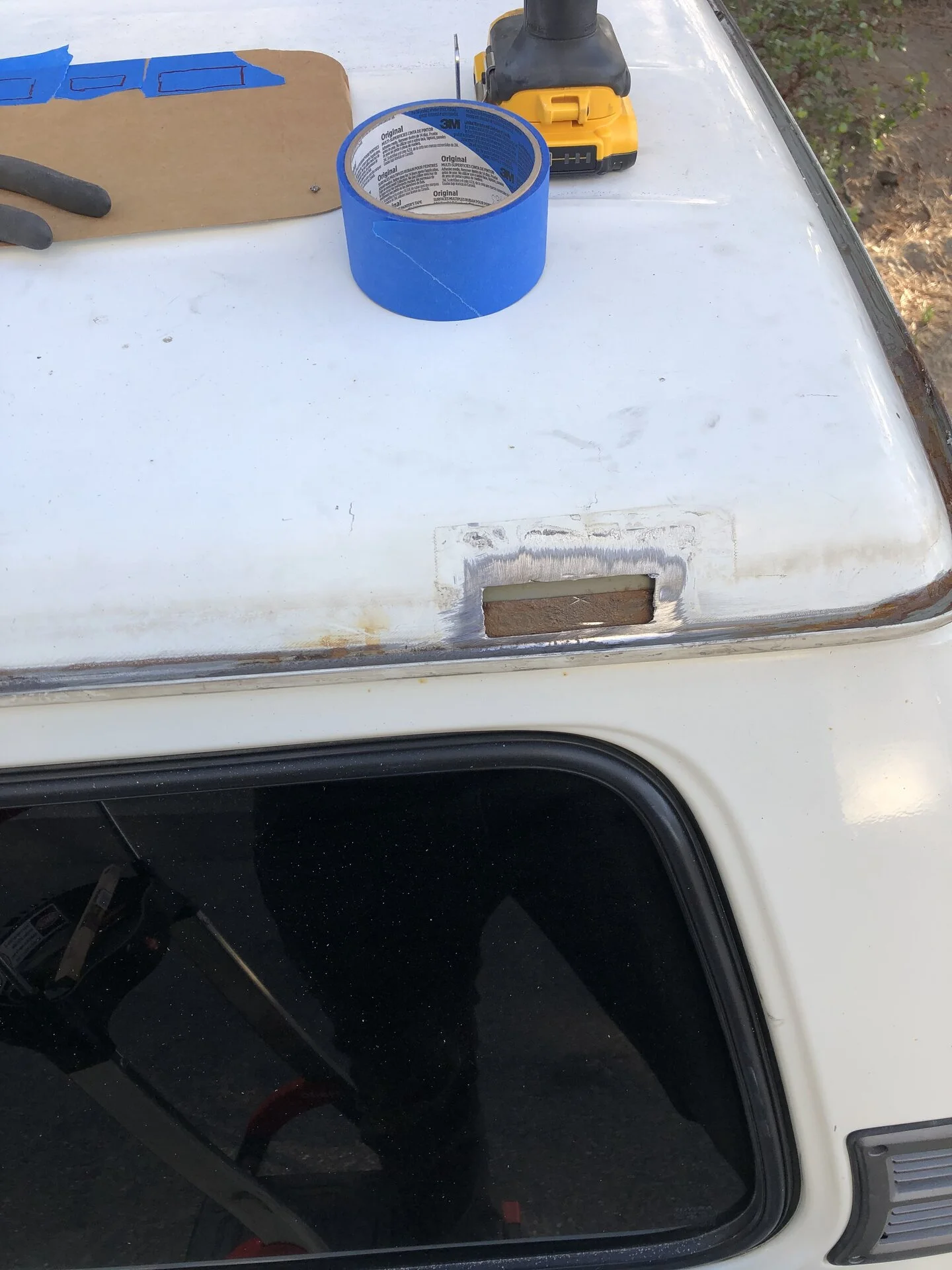

Welded patches in, primed, sealed, primed, paint, clear. Lots of useful threads here regarding gutters.

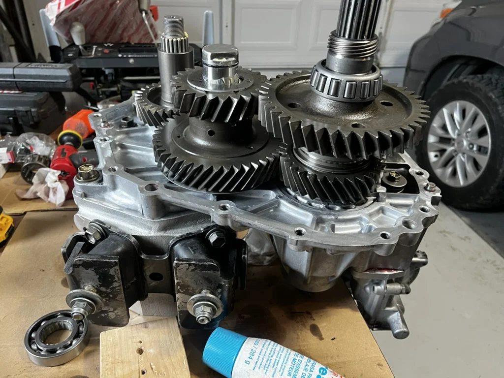

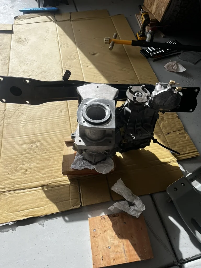

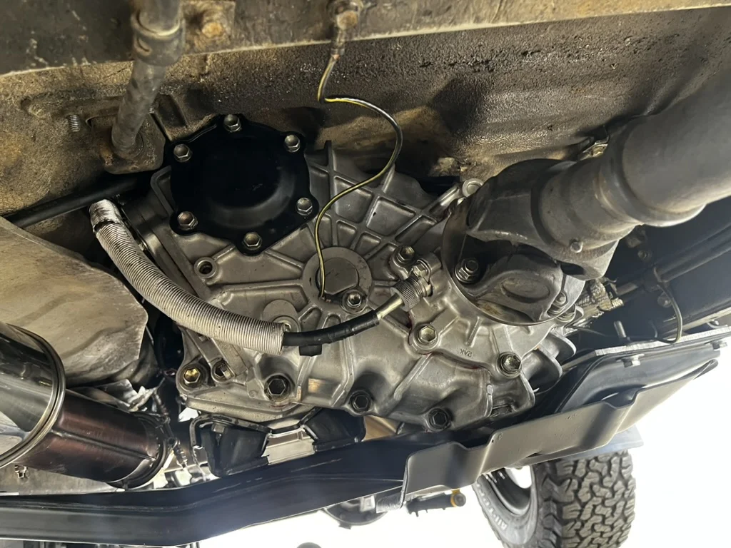

Got the t-case back together, and thankfully the whine is massively reduced. I ended up rebuilding everything on the bench, and with some help was able to get it mounted under the truck. Puzzling that I didn't find anything amiss when I took it apart. While I had everything apart I swapped in a new transmission dipstick tube and made sure the full mark was very slightly above the pan mating surface. I also swapped in a corvette servo, which everyone says is a great improvement over stock. It certainly shifts fast and firm, though I did not put enough miles on the stock unit to have a good comparison tbh.

Thats a bummer you couldnt find the whine. I had similar results. I think ive taken apart and put my split case back together about 8 times now trying to figure it out. I swear to god it has to be some kind of deflection or ever so slight misalignment or something on the idler shaft. That is the only thing that has any change or wear marks at all when i inspect it. I even threw a brand new in box transfer case at it hoping the new gears would whine less but its exactly the same.

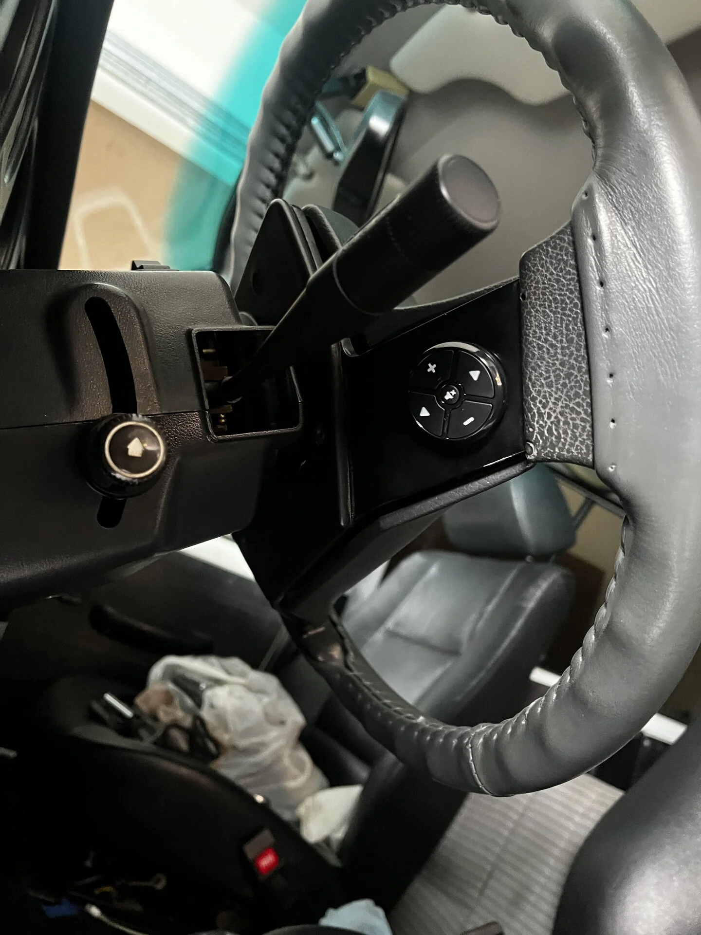

And ha, nothing too fancy. I put a head unit in that has a "remote" female on the back, so I picked up one of these direct from china thingys and wired it in. Attached one of the little pucks on the backside of the wheel spoke (didn't bother with the other one). Can't see it unless you're looking for it, and now I have next/back, volume up/down, and play/pause. Programmed it today and it works great.

As far as the tcase sealant I used the Anaerobic and a paper gasket every. Single. Time. It never leaked. I used orange FIPG on the splines of the output shafts and that stuff though. I think I used the loctite anaerobic the first two times and then blue threebond 1133e, and I’m back to the loctite. The threebond is too hard to get. I’ve never had a single leak
Yeah the button was pretty straightforward. I used one of these to plug in the unit that I got. We'll see how long it lasts. The reviews aren't promising...

Great to know about the anaerobic sealer. Not leaking ever is a good benchmark. It was slightly concerning when I broke mine down that I could wipe some of the uncured stuff off with a rag since it wasn't in a metal-to-metal and no air scenario.

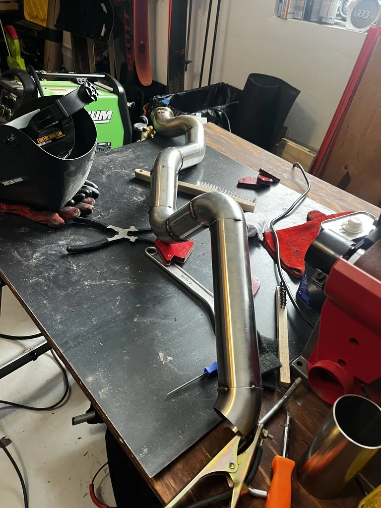

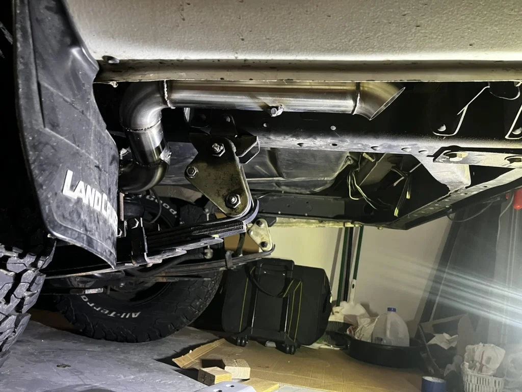

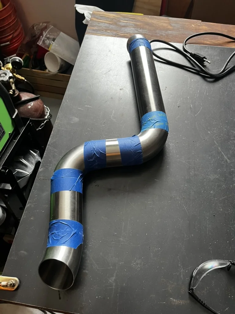

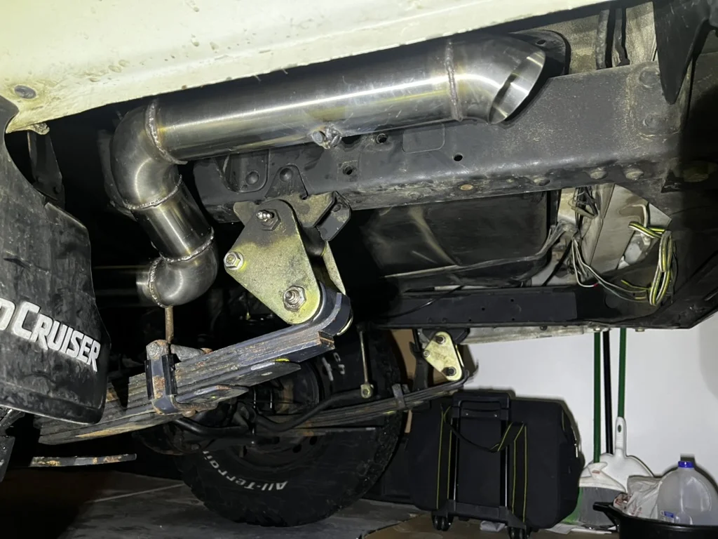

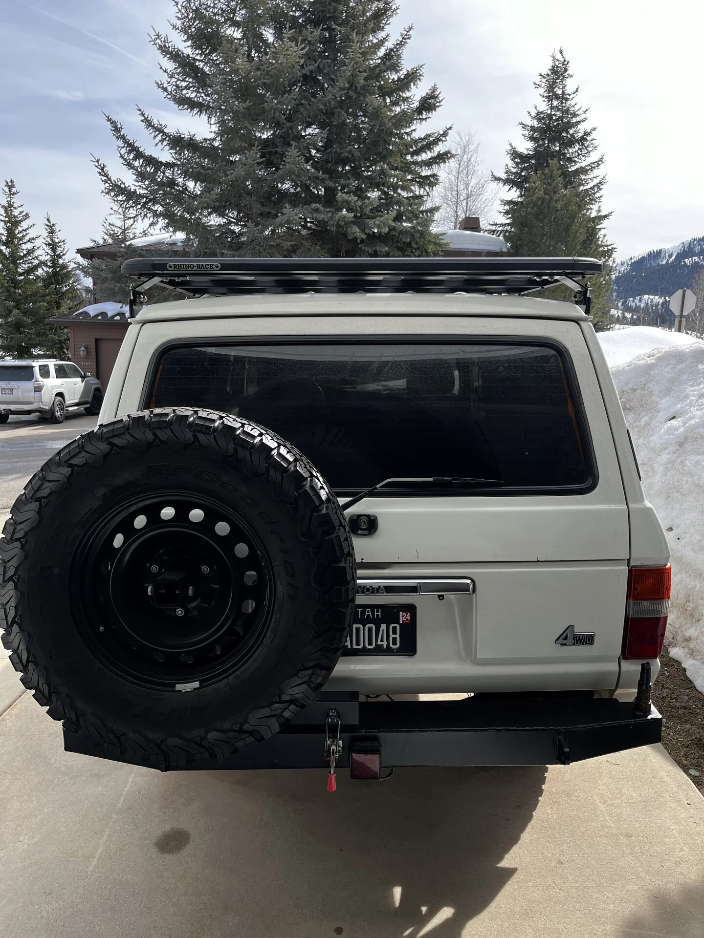

Had a chance to get the tail pipe finished up. Was in a hurry, so the welds certainly could have been cleaner. It tucks up into the quarter panel very well. Only place that might be an issue I think is the sway bar linkage. We'll see if it starts clanging on me.

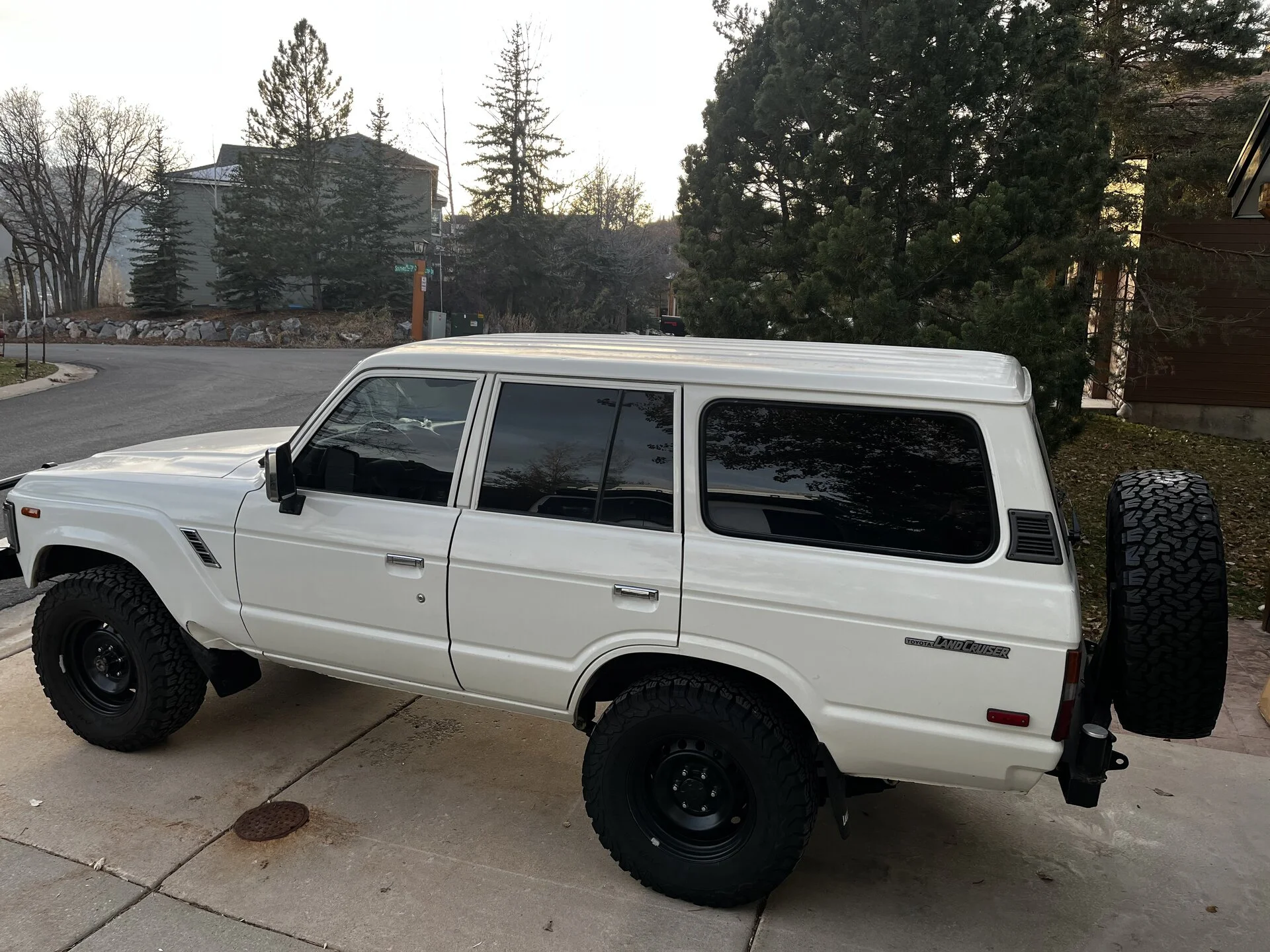

Putting some more miles on the rig between snowstorms and the magnesium chloride applications on the roads. I haven't had time to treat my frame and undercarriage yet, so trying to keep exposure to a minimum.

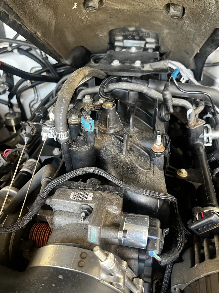

Couple items added to the list unfortunately... I keep popping a PO332 code (knock sensor bank 2). I replaced both sensors and the harness with AC Delco units when I cleaned the intake manifold, and both sensors read ~100 ohms to ground (in spec). I am going to find time to pull my intake off again and inspect the wires. Fingers crossed it's a kinked wire.

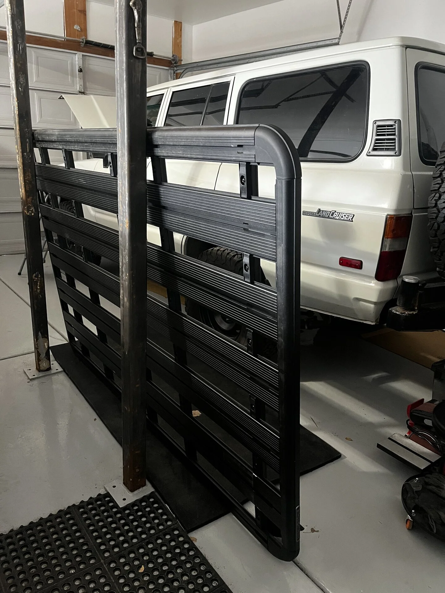

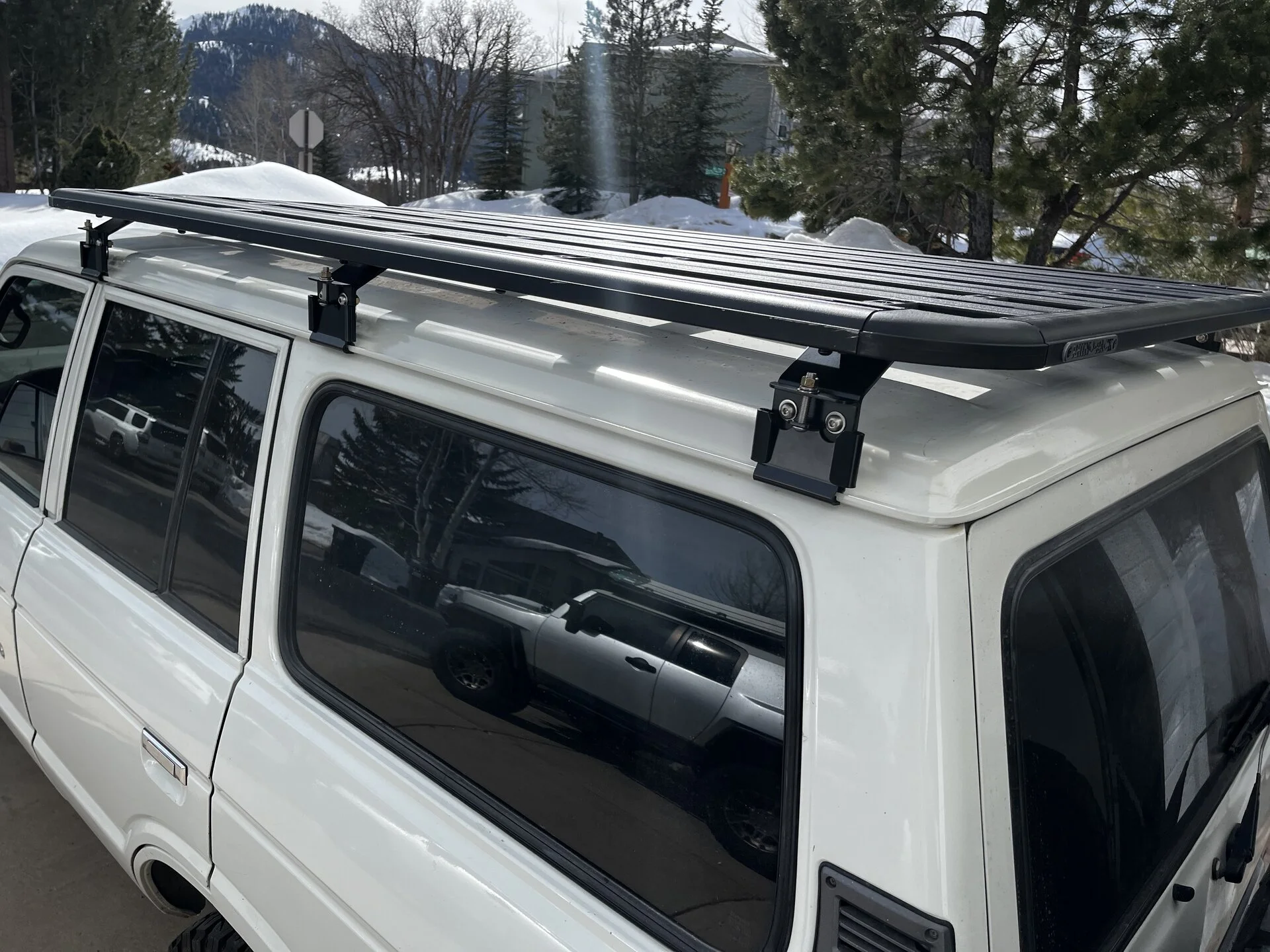

Had a chance to get the Rhino Rack Pioneer Platform put together that has been in the corner of the garage for too many years waiting for my gutters and roof to get fixed. Not a fan of the way the gutter mounts are lining up, so ordered some 30/60 mounts from Gramaviti to use instead. If I didn't already have the Rhino Rack platform, I'd order his rack as well. Oh well.
The Gramaviti mounts arrived quickly and I had a chance to get them mounted. Sturdy product for sure. They mount up to the pioneer platform perfectly.
Putting more miles on. Feels good. I also swapped the knock sensor plug wires on the PCM side of the plug and sure enough the code moved from rear to front. So, either a bad sensor, a bad ground through the block, or a bad wire from the plug to the sensor. Thinking I'll find some time to do the PS pump and intake removal at the same time. In the meantime, going to continue driving it.
Damn, your truck has thrown me a curveball. I had convinced myself I was going to paint my 62 a different color, now I kind of want to keep it white. I plan to do the same wheels as yours, so it's swaying me to stay white.

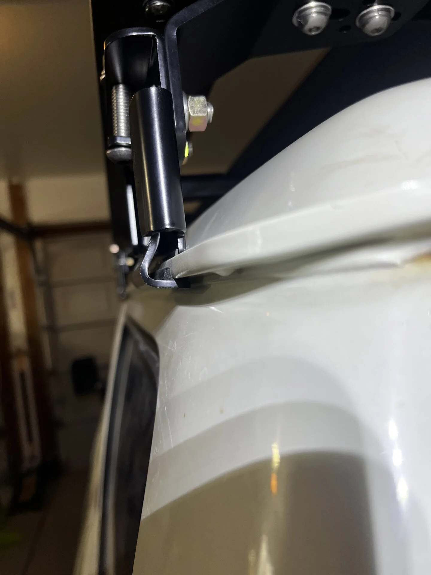

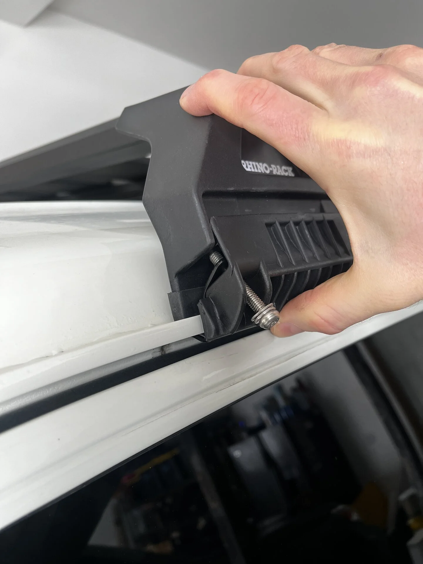

What was it that you didn't like about the Rhino Rack gutter mounts? I plan to do the same platform but hadn't considered using different gutter mounts.

Keep it white! White is the best toyota color, especially the cool ones like 60 series and supras and stuff

Haha I still haven't seen a color I didn't like on a 60, but have to say I am partial to the white after owning it. It always looks great imo, especially with the black fj steelies and bumpers.

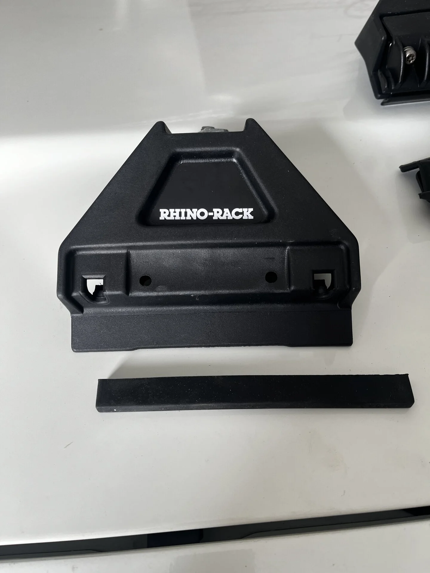

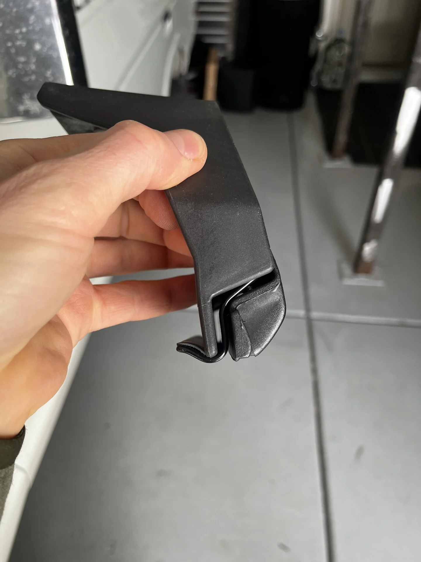

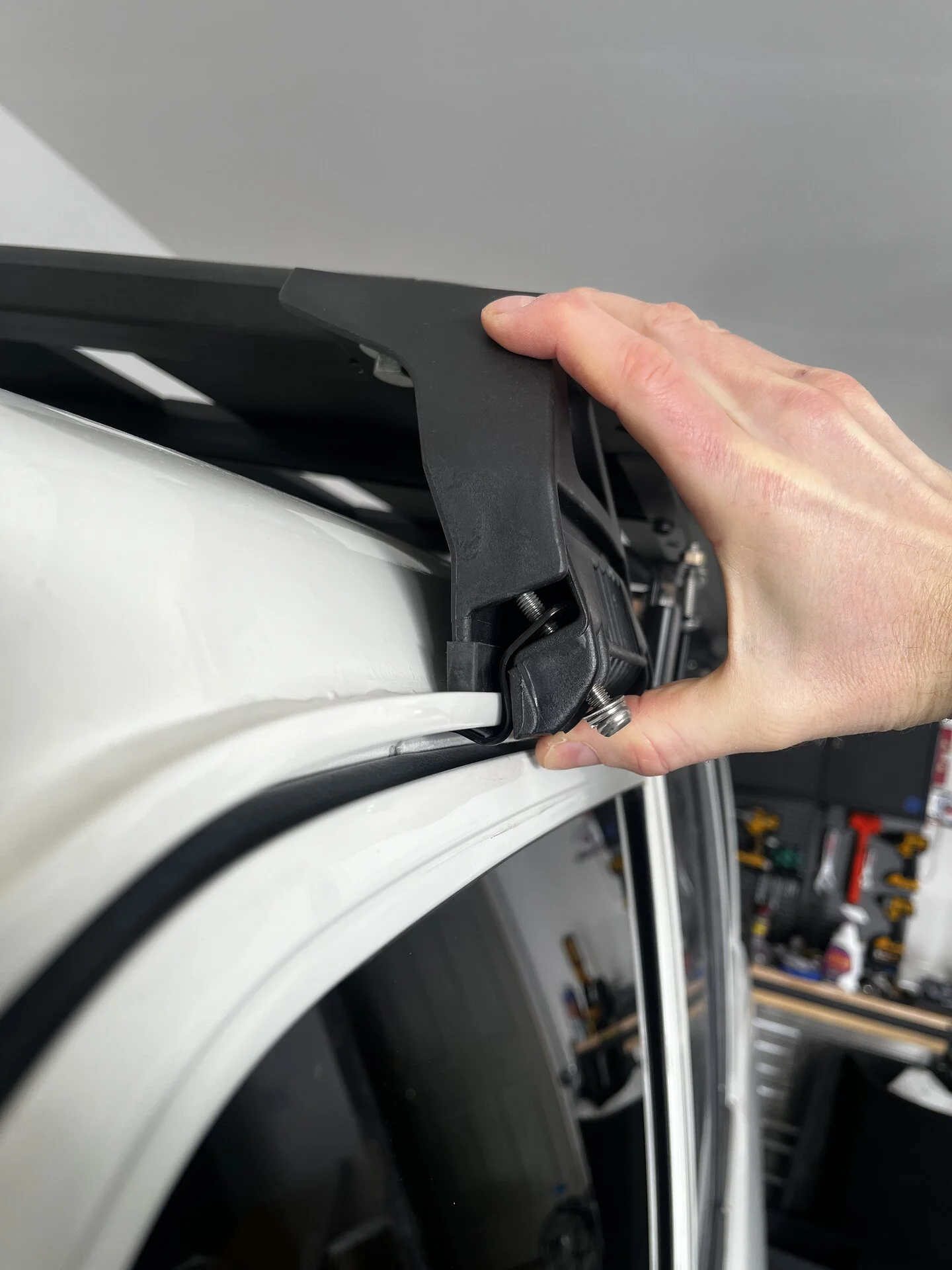

The RR gutter mounts didn't work great for me, BUT, totally could have had something to do with the fact that I just resealed my gutters and filled them up quite a bit. They basically didn't have a good fit with the curve and depth of my gutters. I'll snap some pics of them side by side with the Gramiviti mounts to give some perspective if that helps.
I've got 6 of them with spacers if you want them. Happy to sell them to you for a good deal - I was going to throw them on Ebay.
@matmattmatthew here are a few more pics of the Gramiviti 30/60 mounts along with the Rhino Rack RL110S2 gutter mounts for comparison.
I also considered trying the Rhino Rack Backbone mount that they make for the 80 series but was concerned that I might run into the same issues.
I considered trimming the part of this that goes down into the gutter to essentially make it ride lower. It is plastic, so would be a quick mod.
Here you can see the difference in the clamp shape of the Gramiviti version.

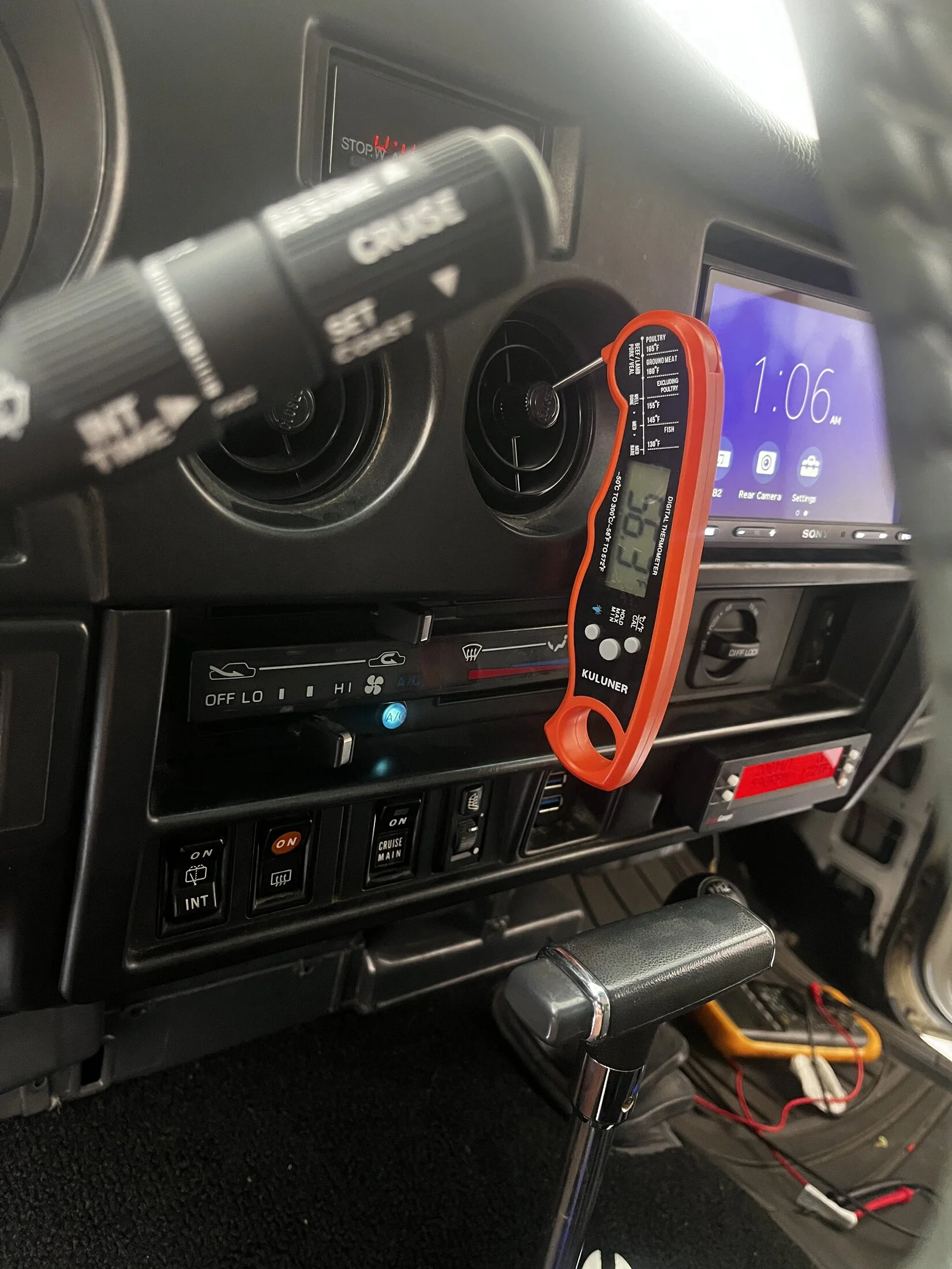

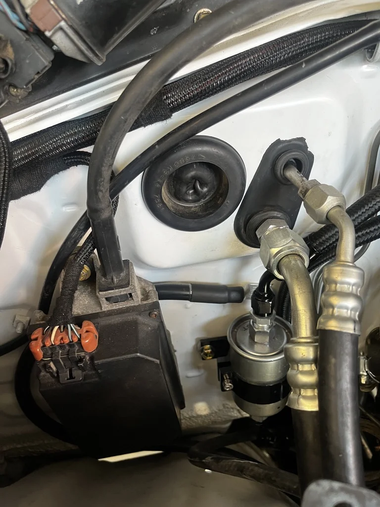

Now that summer is in full force here in Utah I found some time to get my AC running. I wired it through the GM ECU with a binary switch interrupting the ground side of the compressor harness. Got it charged today. Was about 90 degrees in the garage, so am ok with a ~35 degree drop through the system at standstill.

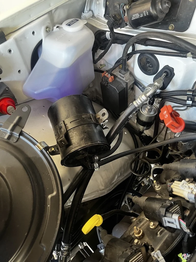

Also was chatting with @dbbowen about the purge solenoid and charcoal canister to try to manage the fuel system venting. I bought a new purge solendoid, and dug the vortec harness out of storage to get the plug. Wired it into C2:34 and pink to ign hot. Still had my charcoal canister and bracket from the 3FE so bolted it to some open fender space. Hoping this clears up the fuel smell and tank boiling issues I have had in hot weather.
And the biggest update of all... When I had the harness tub out I grabbed the firewall gasket off of the 3fe harness to finally plug this large hole in my firewall.
