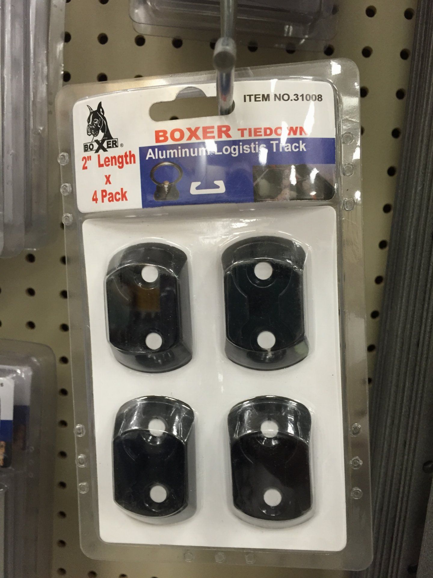

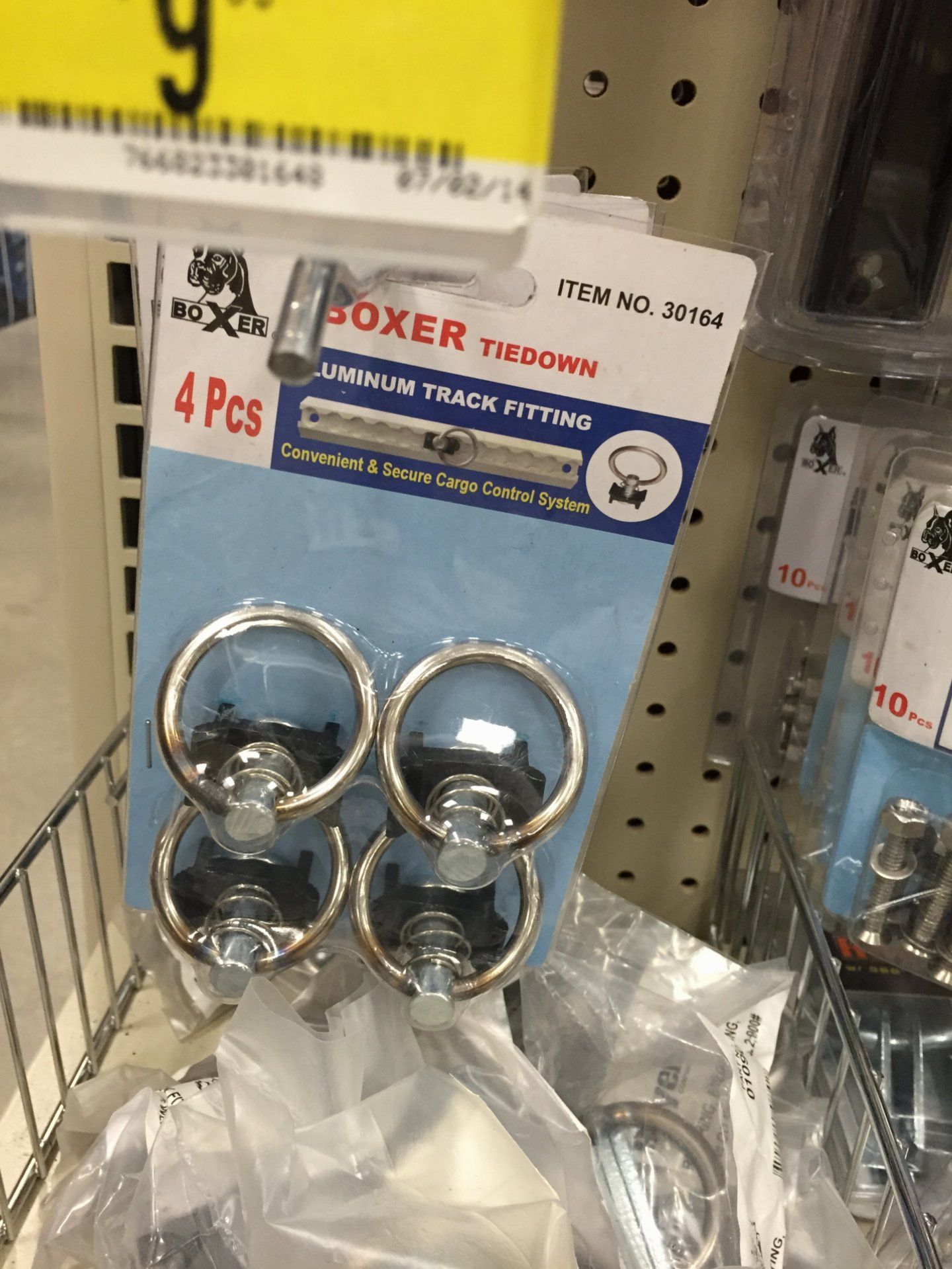

You might want to rethink the bolts coming up from below. You'll need to slide something in the bed at some point and will want a smooth surface, especially if it's a cardboard box or furniture. There are plenty of ways to still accommodate tie downs. Northern Tool has some that ride inside a track (various sizes offered) that can be recessed into the wood.
View attachment 1410274 View attachment 1410275
Or if I take the bed liner out, maybe these are low profile enough I can keep them in and put them in the recessed parts of the bed without even needing the plywood? Just pull the track ties out when needed to use for stuff that would catch on it.
I just hate to drill a bunch of holes in the bed. I think I have to go the plywood route - need to decide if I should take out the bed liner out or not. . .
