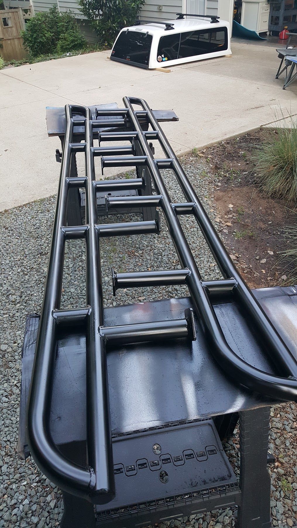

Got the sliders sanded, primered and painted in Satin Black this weekend. :) 95" of sliders . . . whew.

Well . . . . I noticed my sliders lost a bunch of paint on the way to be welded on. Found out that I had PAINTED what I thought was primer on the initial painting and nothing was sticking as it should. Found the grey primer I had bought and was like WTH did this come from :) - dug through my trash in the garage and found I had used grey paint on accident :(
So . . . I had to go back and get the sliders media blasted and am starting over again :(
Round 2 - - this time taped the mounting points unlike the first.
@weejub I generally paint down each leg to within an inch or so of the base plate. Once welded I then paint down the leg, base plate and surrounding frame. Pint on the feet will most likely melt and can also gas off and might effect the weld.
