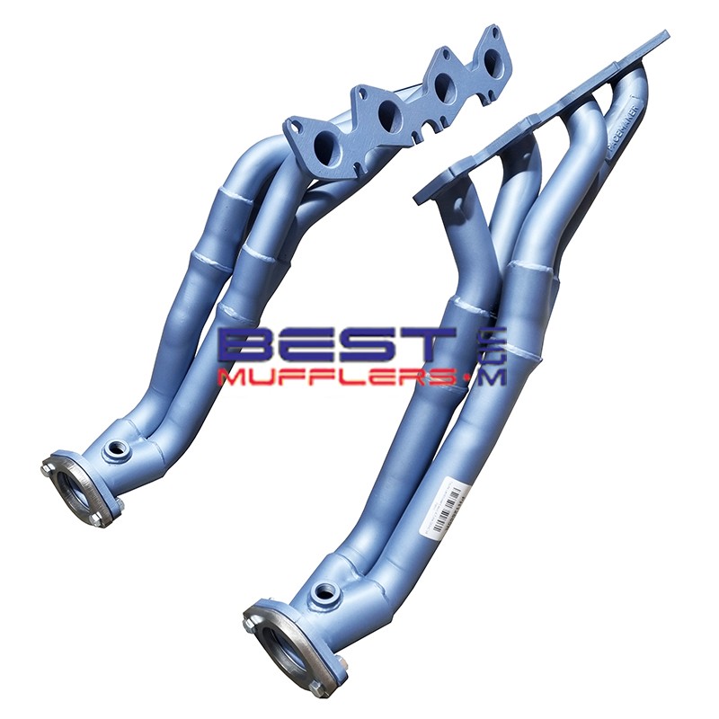

Australian long tube headers. Yeah baby. Only work on non-VVT (no SAI) 2UZs but they should be the best available.
They also have a full 3" exhaust with cats of you are baller: Toyota Landcruiser UZJ100 4.7ltr V8 Pacemaker King Brown Exhaust System - https://bestmufflers.com/bshop/index.php?id_product=7934&id_product_attribute=0&rewrite=toyota-landcruiser-100-series-45ltr-fzj105-pacemaker-headers-pacemaker-king-brown-performance-exhaust-system-ph12650-tl100kit-&controller=product
that's awesome, now how to get this stateside...?
Someone in here mentioned they were for RHD... I have not idea if that's relevant. But you would think it is... Dunno.
Yeah they definitely are intended for RHD but I had some correspondence with a salesman there at bestmufflers and he was pretty sure it would work on LHD because they are basically identical left to right. The only reason I do not own them myself is because they don't support SAI so it would take some effort to make them work either adapting SAI or welding up the ports on the cylinder heads. Apparently they have 2UZs with VVT in Australia that don't have SAI!
