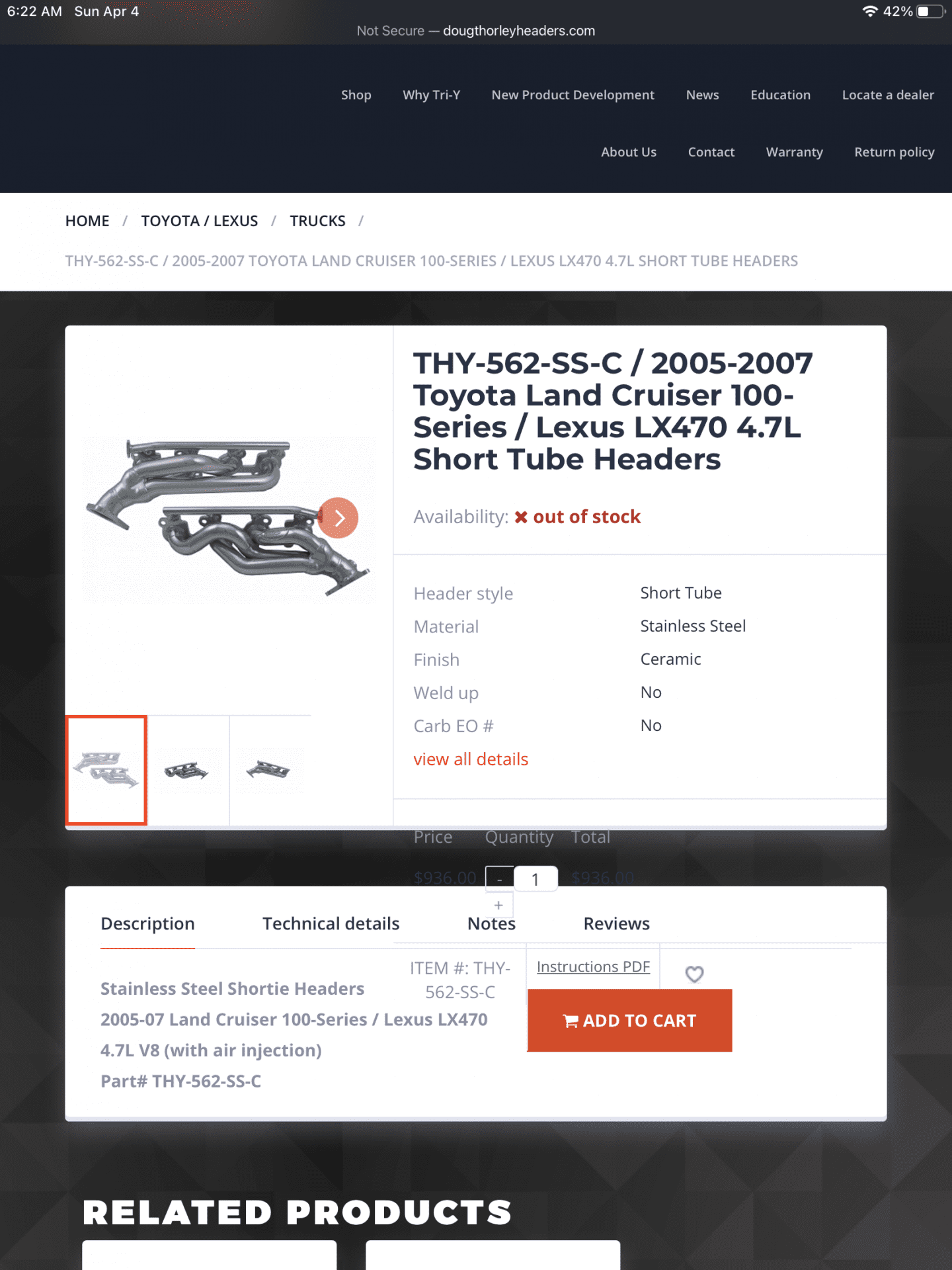

looks like it’s the correct part?
Yup, that’s correct. Just FYI, if you haven’t seen the other threads, Doug Thorley takes orders for these but doesn’t do a production run until they hit a certain number of orders. Some folks have had orders in for months waiting. I proposed in another thread that someone reach out to ask about a group buy to see if they can recruit enough orders to get them to do another run. Just an idea.
