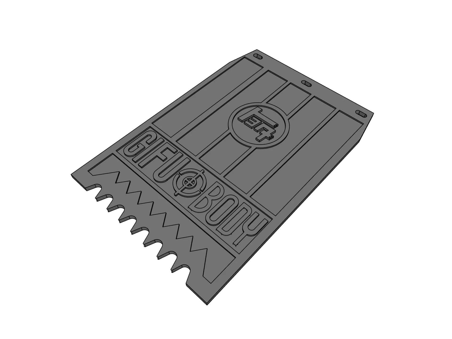

My render of the flap...
Still need to tweak the font. Anyone know if this font is out there?

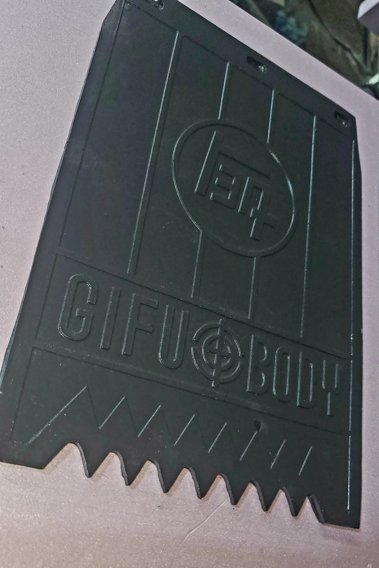

Ok folks...
The first couple are hot off the press!
Some minor flaws but fixable. These are 50% thicker than the master that was provided and a bit heavier. Perfect in my opinion! Now I need to figure out the grommet reinforcement or just offer as is and let the buyer add them..
I do have two additional rubbers coming in tomorrow that I will test out. So it may get even better!! 😀

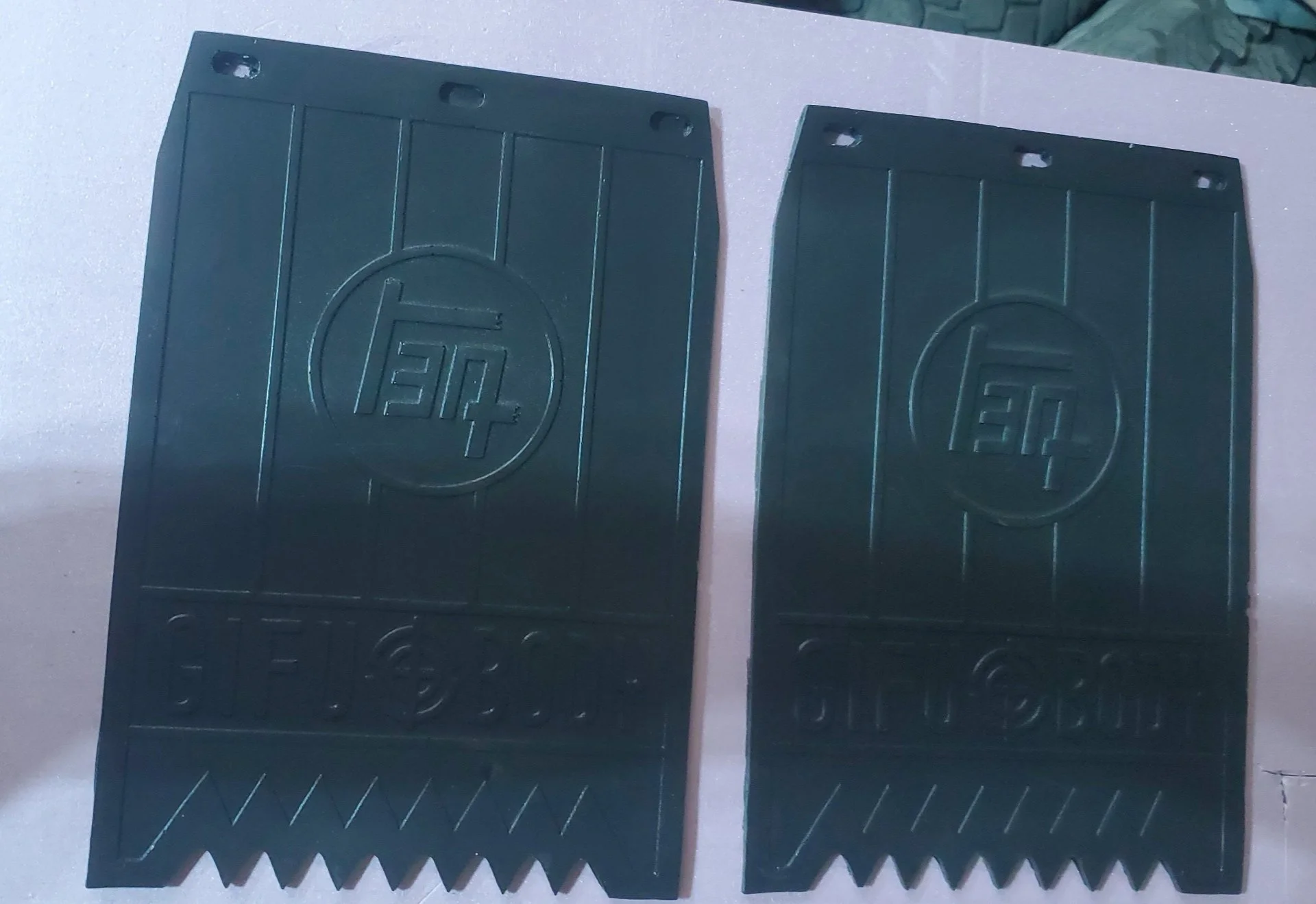

I am happy to report after trying 5 different rubber compounds, I have settled on one that is just perfect for this project!
It's nice and stiff, (not too stiff) super durable and should take a beating very well. It's used in factory machinery like conveyer belts and Industrial sorting machines etc... The blackness is on point as well. No sdded dyes in this one. Pics soon..

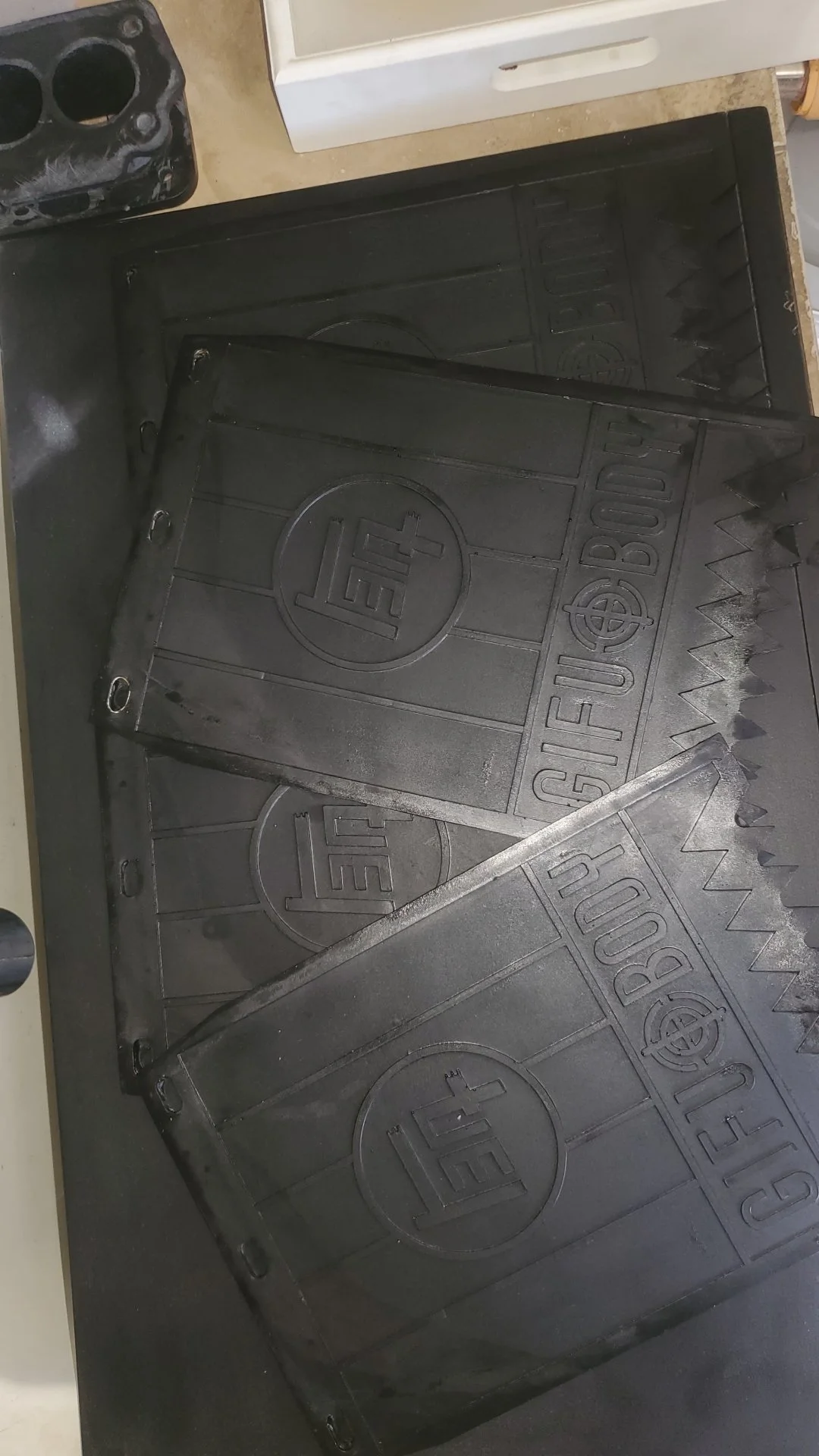

Just to let you know, I have been experimenting and trying various ways of adding the grommets. I think I will end up having them inside the rubber. At least for now.

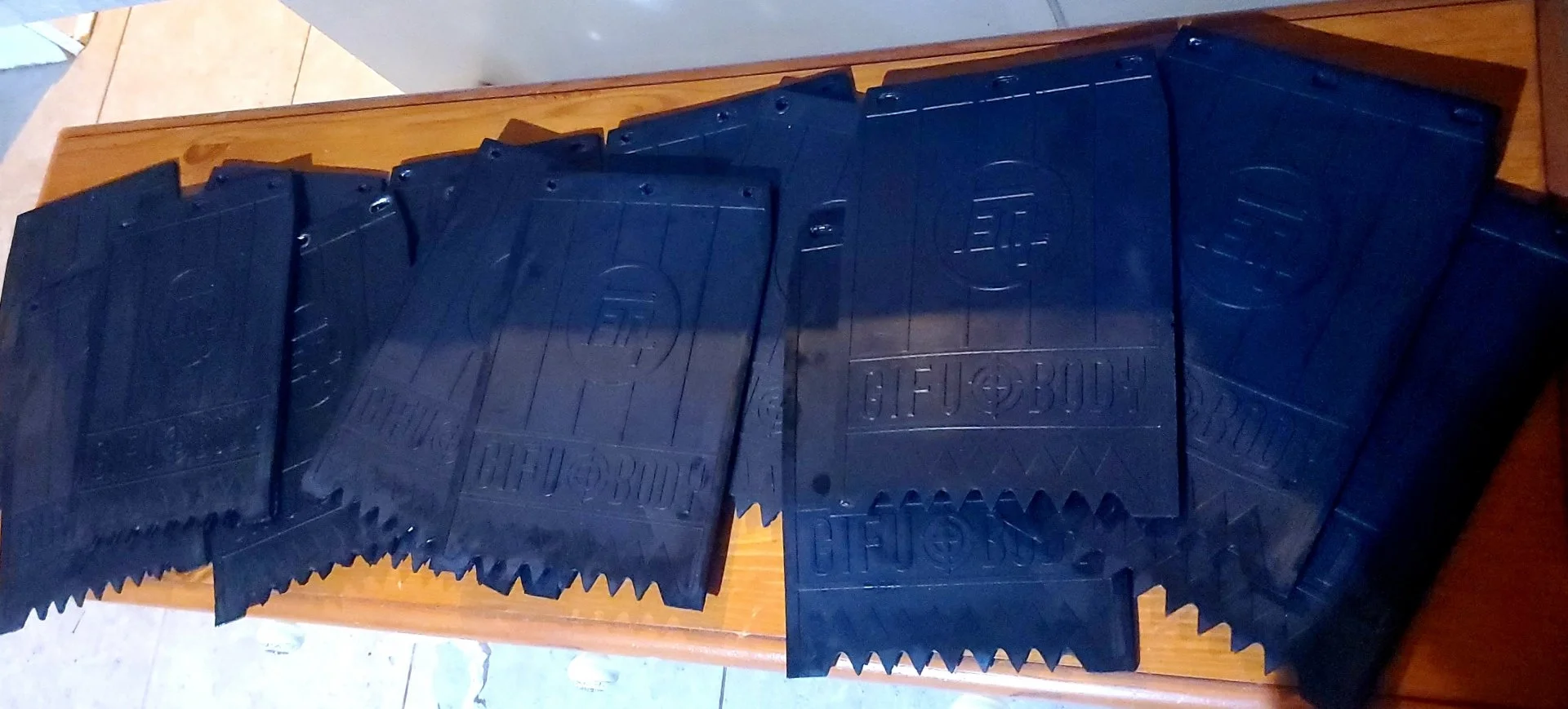

Btw... heres a pile of flaps representing my "ideas" along the way... :)
They all have this oily residue on them. It does wipe off, but I think it has to do with the rubber as it goes through the curing process. Seems to stop after a few days.
