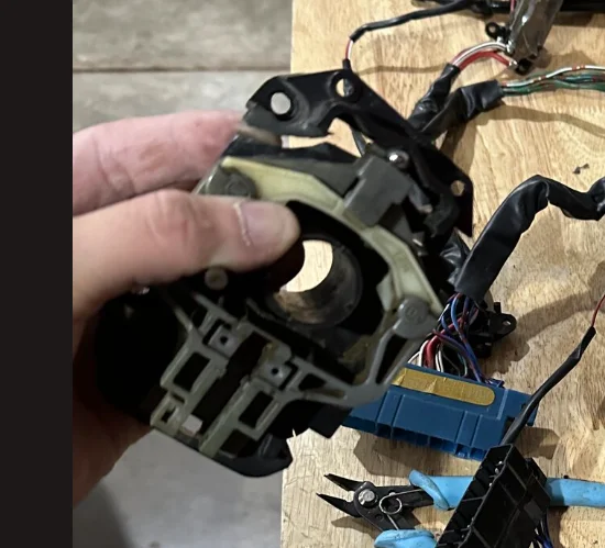

This is my old stripped base. As you can see it was completely cracked and i had JB weld holding it together.
Just unscrew all of your old stuff off the back of your old combo switch and screw it to the back of the new one. It all perfectly matches up.
Be careful of your turn signal switch arm as its got a spring inside of it and a ball bearing thats very easy to lose. #3 on the photo below.
The way the arm attaches to the base is slightly different as well. Youll just drill out the push pin in #5 below and reuse the threaded bolt (#2) from your old combo switch base. There is a tiny hex bolt that youll reuse from your old base and slide into the little hole (#1) to hold the threaded bolt on the arm. You have to get the threaded bolt in before the spring, as it will use that bolt to put pressure on the ball on the end (#3). Lastly the little metal bracket thing (#4) is what gives you your indent feeling and hold the stalk in place when you push your high beams on. You HAVE to use the old one from your old switch for this. Its different and the grooves are different between the two. Its like the mirror opposite, if you use the new bracket, your brights will be on in normal position and when you push the stalk forward they will be low beams.

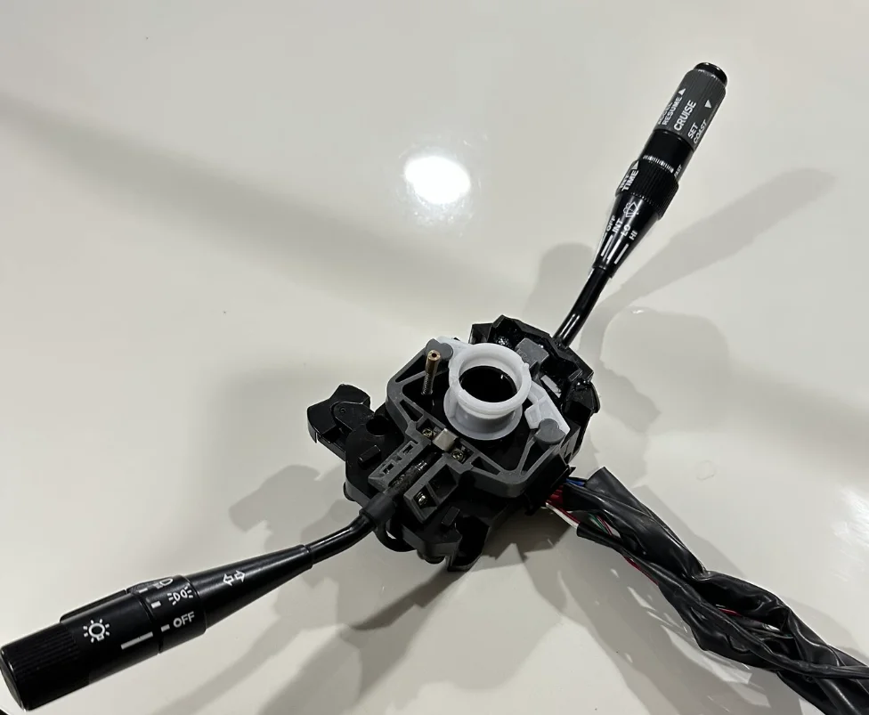

One step further is using the Wiper stalk from an 86-89 pickup and 4runner and you can have cruise control switches as well as 4 speed intermittent wipers as well. Youll need cruise control to do this so like a ls swap or dakota digital cruise box or those weird dealer add on cruise boxes. Keep in mind, the LS and i think the dakota box need to receive a power signal to activate the cruise functions, and the toyota switch sends ground, so youll need to use two relays.

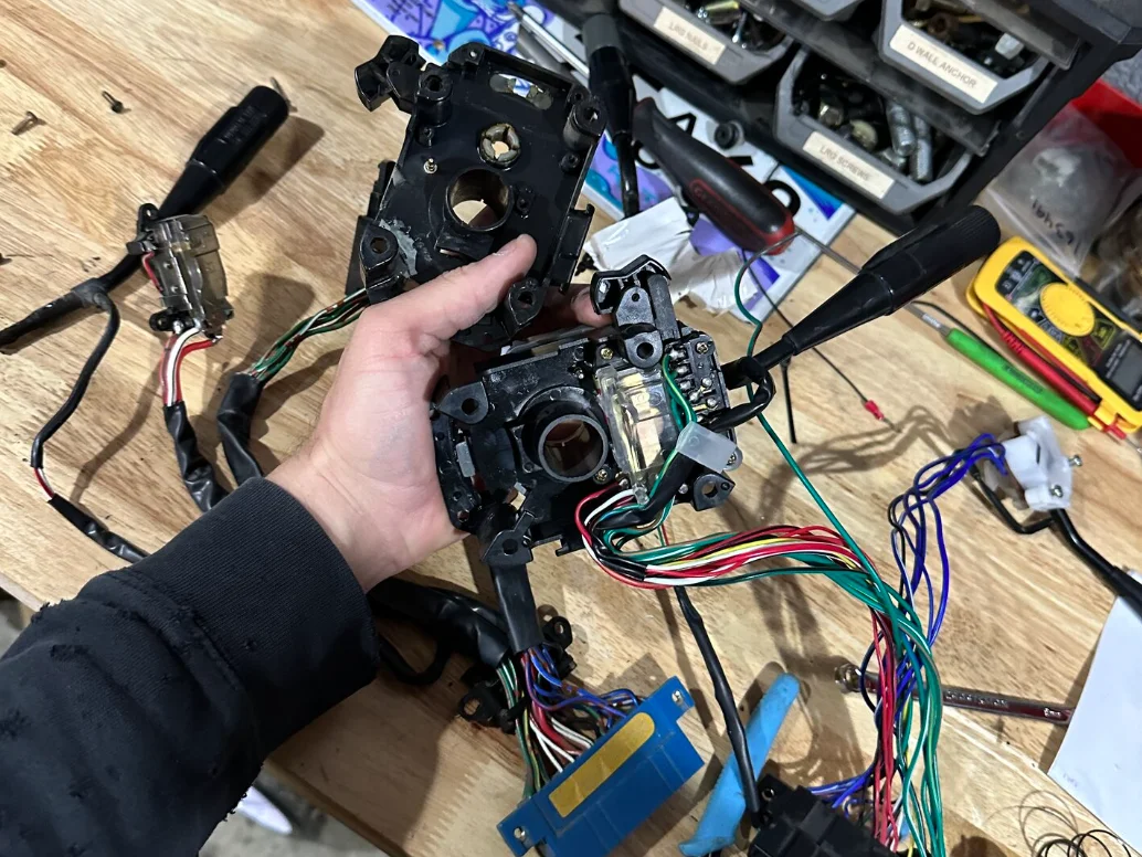

This is a pic of transferring the modules from the old base to the new one, this is the back of the bases.
