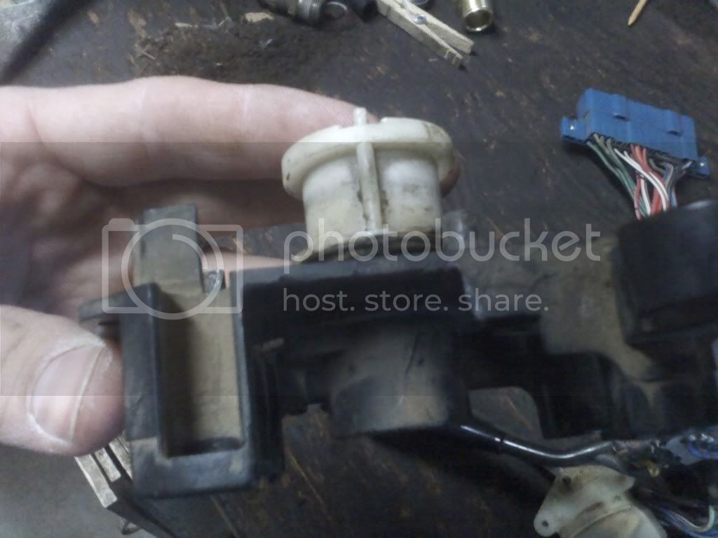

Mine is the 4 speed control. I took just the switch off the center plate and notched out my Land Cruiser plate to fit the larger switch. Moved one wire at a time so I wouldn't get them mixed up. The screw holes between the two switches were different so I used small zip ties to hold it down.
First picture is of the zip tie's. Second is the size of the circuit board and the third is where I had to notch my center plate so the new switch would fit. Sorry about the crappy cell pictures. I will get some of the switch installed later and how much clearance I have.

I THINK I see now. You took the 2 apart and recombined in order to keep the cruiser hazard switch?
Yup I kept my Land Cruiser hazard switch and moved the wiper control portion only. Just had to make room for it on the center plate that everything bolts to. Now you cant tell the difference from the factory.
For lack of a better term the center plate is the the black part in the third picture.
Well if I had to do it again I think I'd still opt for the cut top cover for the hazard switch vs all of the work you did... My truck ain't pretty enough to worry about a little cut in the column cover... I have MUCH bigger fish to fry in dealing with the wheeling dents and rust :crybaby:
