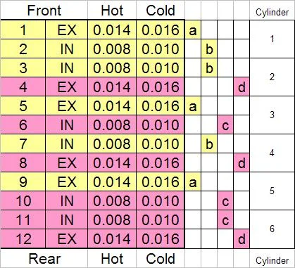

People over think this like oil. Set it to spec cold, run it, break it in. Then when it’s operating temp after driving 10-15min, pop valve cover off and send the feeler through while running to check each valve, note the tight/loose valves and readjust or use this chart when it’s cold. Both result with the same, either way you have to check when it’s hot.

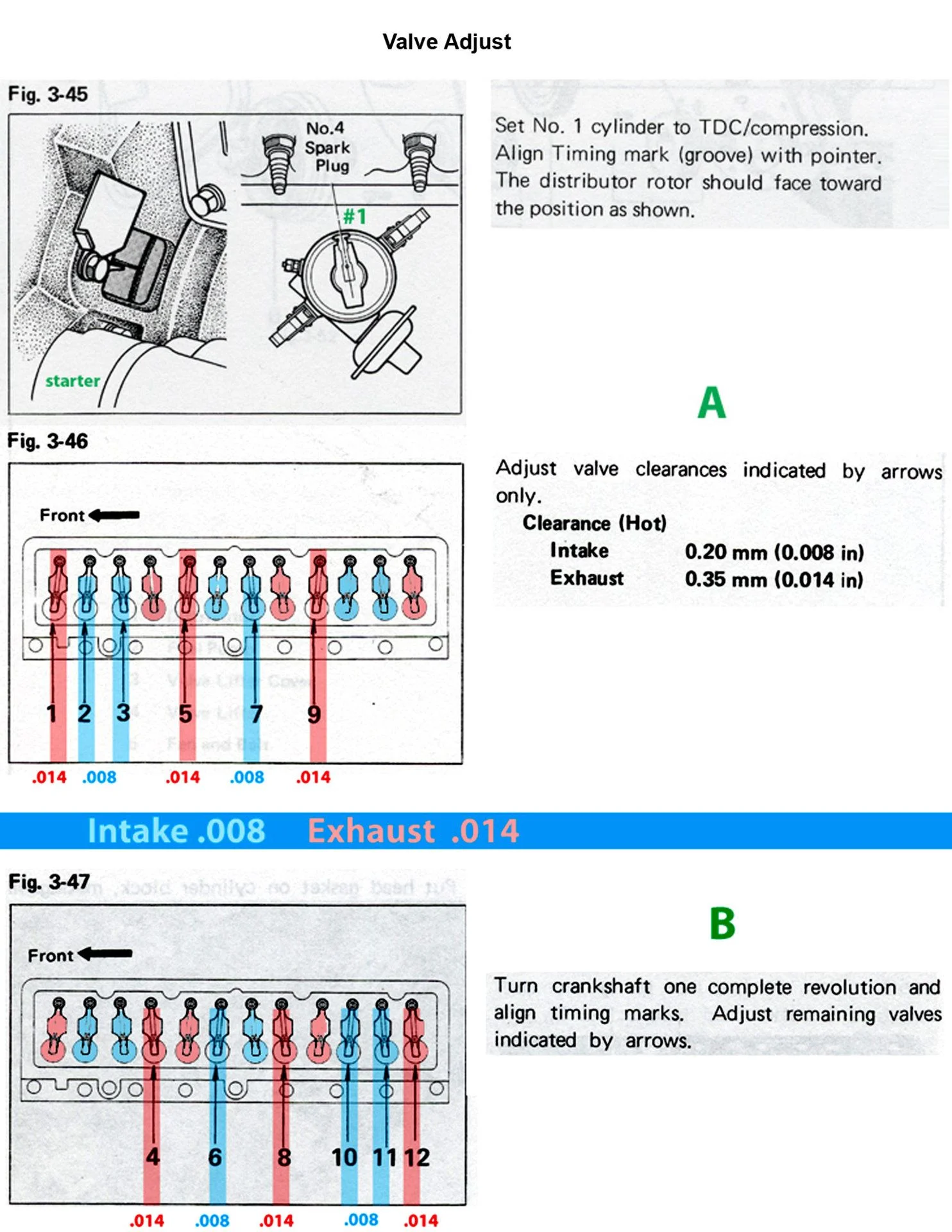

Thanks a ton for the chart. I “figured” I’d add maybe a couple of thousandths to the hot tapped clearances to compensate for the cold, remembering Charlie said they’d tighten up a bit after running. This chart adds 0.002 to compensate and makes it pretty easy sequence to do. Put #1 TDC, set exhausts in (a), set intakes in (b), rotate engine 360 degrees, set intakes in (c), then exhausts in (d).
Even more clear than my existing diagram. Between the two, I’ve got this. Thank you all for your kind references and assistance.

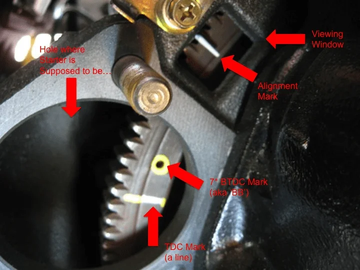

It’s a new build. I don’t want to start it for the very first time “hoping” the valve clearances are OK without checking. It’s in the build pre-start instructions. Plugs are out, I’m turning the engine over by hand, and my TDC and BB are clearly marked on my flywheel. Just want to be sure it is safe to crank for the first time before doing the warm or running valve train adjustment.
After first start, I don’t want to put the valve cover back on until I’m happy with the valve lash, and that I’ve verified that the distributor shaft is fully engaged with the oil pump. I assume I should be able to see oil making its way to the valves somehow.
To be clear. TDC on the compression stroke.
