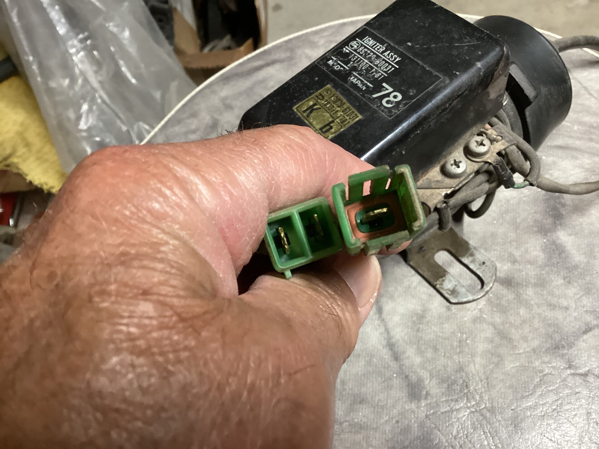

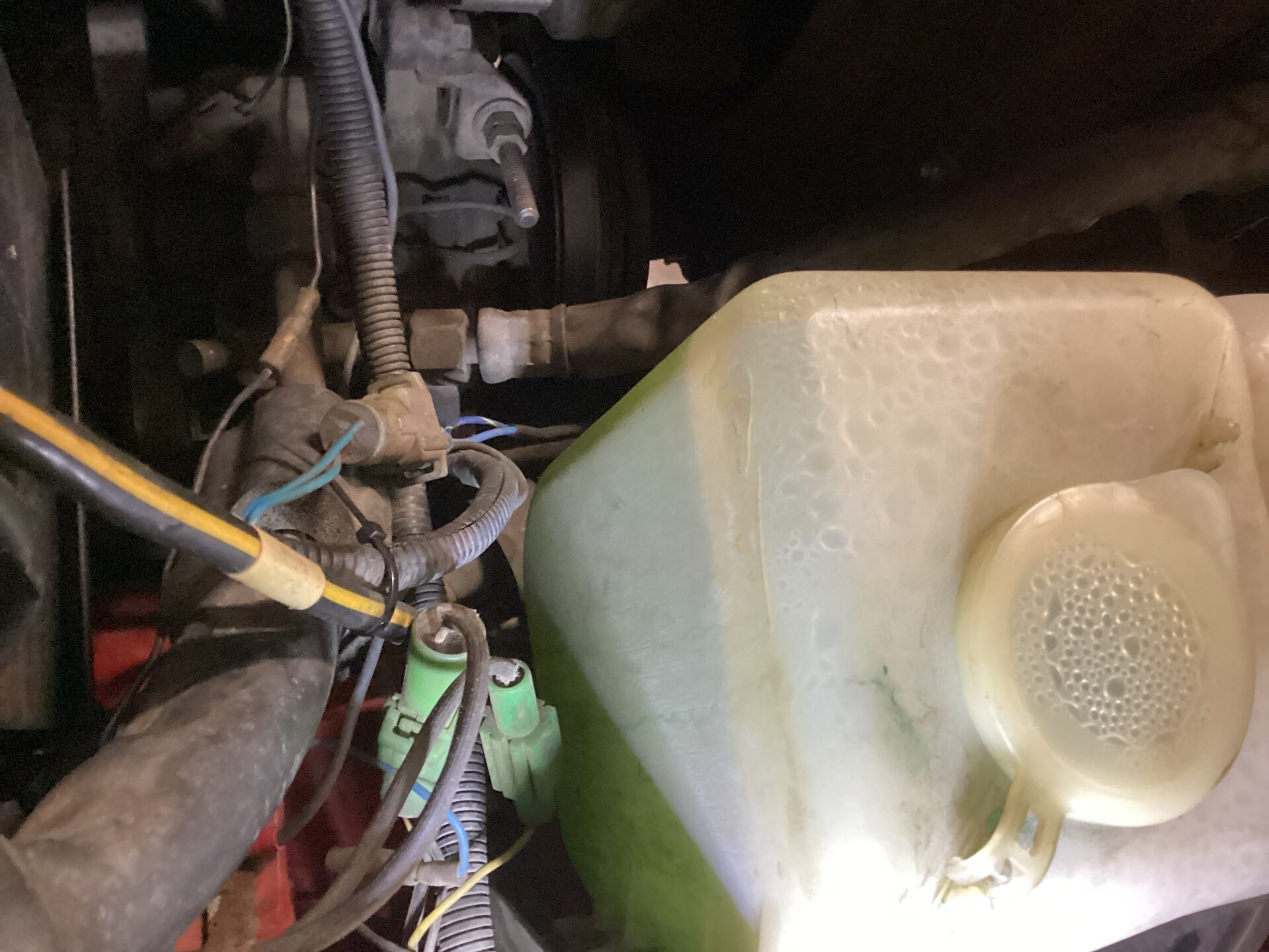

I looked at my 5/79 40 and I also, am running a ”big cap” distributor. Looks like B to 3 works, the problem is A to 2. They are the same female side plug connector. #1 is where a interference capacitor would connect. You need the other half of the connector for A as in the second picture. Apparently the 60s were terminated backwards. Do you have a 78-79 igniter? It will work with that distributor and have the right connector.
I looked at my 5/79 40 and I also, am running a ”big cap” distributor. Looks like B to 3 works, the problem is A to 2. They are the same female side plug connector. #1 is where a interference capacitor would connect. You need the other half of the connector for A as in the second picture. Apparently the 60s were terminated backwards. Do you have a 78-79 igniter? It will work with that distributor and have the right connector.View attachment 3379148View attachment 3379149
I do have a ‘79 coil/igniter - well one that was purported to be a 79. I think it’s plugs were also different, I’ll double check. I thought I’d read the 60 dizzy required a 60 series igniter, but sounds like that’s not the case if you’re running it with 79 igniter.
