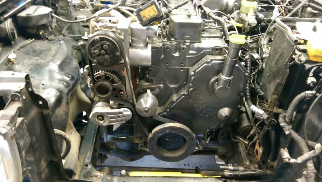

just got home and looking at my piece I think there is a good chance the failures are starting from a sharp machined edge... See pic... From the end mill that made the angled easy start for the cam lock...
I am a maintenance welder fabricator for a profession... Cracks in metal (& repairing them) are something I see a lot of. I'll be using a tiny (fine) round file and some Emory cloth to radius and smooth the transitions... No sharp edges is key. Vibration + sharp abrupt edges & corners will almost always end up cracking...
Just my opinion...
I'm sure the manufacturer has a few ideas too...

So the thermostat housing has me really bummed. I don't have the original stock housing but do you think something else would work? When I get back in town I may pull it off and see what a machine shop thinks. I will at least do what jvoight suggested. At this point I would feel more comfortable having something that will bolt to the engine rather than the present way. I like the design but two failures isn't promising for long term.

Yea kinda bummed me out too considering I have not had this running very long. I got a hold of Dustin today and he is going to ship me a new one and a label to send him this on back for inspection. he asked if I dropped it before in installed it o_O Really?! He gave me the "we designed it in solid works and it should be way strong enough", but who knows.

Yea it just fits in there between the block and ac bracket. The ac bracket has one bolt that goes into the t stat housing. It works as the upper bracket support. See pic attached

I asked about you getting your part and he said it has been sent... For what that is worth... He also said there have been over 100 of those parts made and sold... Not just a dozen or so... Puts the failure % a lot better. I still feel like the failures are connected to the machining error I mentioned.
