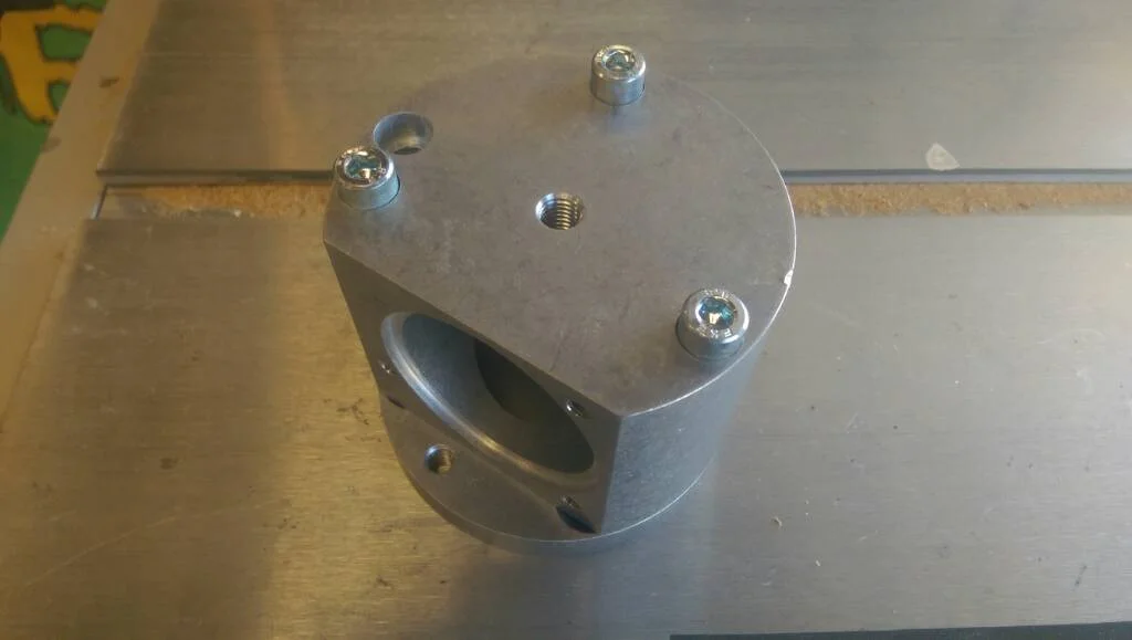

So I got my updated t stat housing from Dustin. Pretty much the same idea as @Jvoight but with three bolts and no more twist lock. Has 3 possible positions.
That looks like a much better design. I calling him tomorrow.
If i am not mistaken spring down toward the block
Yes its spring down. You can see where the housing is machined to allow the spring to be there.

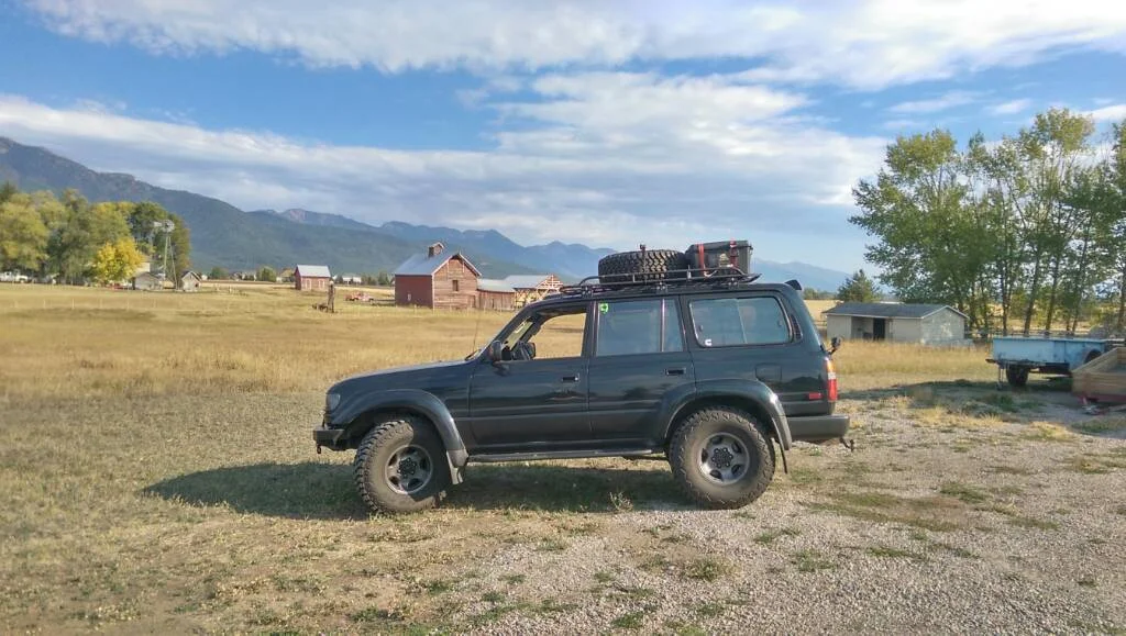

I have made my own roof rack. It's pretty good except I made it to small and for some reason and the paint guy at NAPA steered me completely wrong on the steps required to get a good bedliner adhesion. I can peel it off easier than tape. So I will have to re-do that..... Or just sell it and build a new one the size I want!
I also built my own sliders that turned out pretty good.
And I built a front bumper. The hoop for the light bar will be redone possibly like the slee short bus style but not totally sure yet. I was just trying to get it done before I went on vacation.

Just took it on a fam vacation to seaside Oregon. There was 4 adults and 2 toddlers in there. I pulled a little trailer with all our stuff in it and I had my spare, tools, and spare parts up on the rack. I discovered the day we left that the mechanical supply pump was leaking when I was idling so who knows how much diesel I was pissing away while under load. So in combination of trailer , crap on the roof, and leaky fuel pump I got about 15mpg. Not great but eh.
The trip was around 1400 miles and she did great! With this trip I am over 10,000 miles on this conversion and I gotta say I don't regret it one bit!
