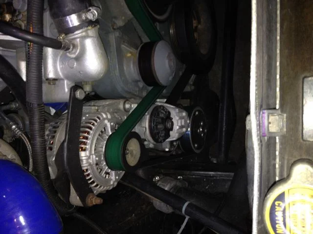

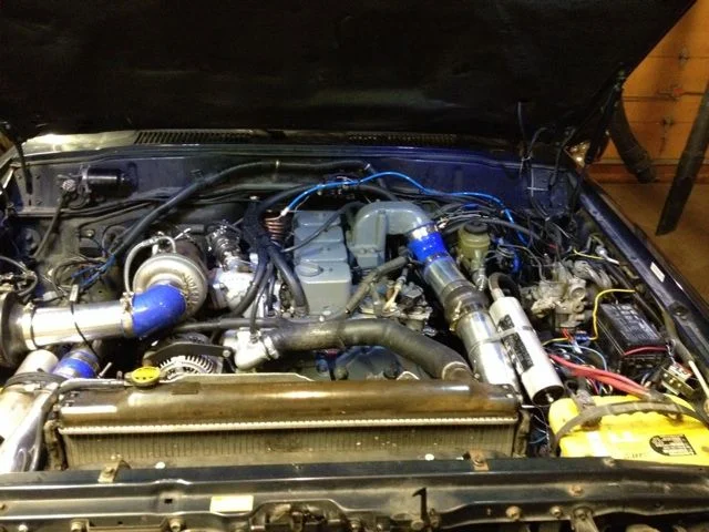

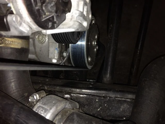

Can you post a photo of it. Especially of the thermostat housing in relation to the bracket?
Just left town for a long weekend. These are the best photos I have on my phone. The first you can see the bolts sticking out where the mounting plate would bolt on the thermostat housing is black and points toward the driver side.
I can get better pics next week
This is the 1998 12v dodge I know they have some variation. I believe this one to be the same 98-02 maybe older would need to verify.

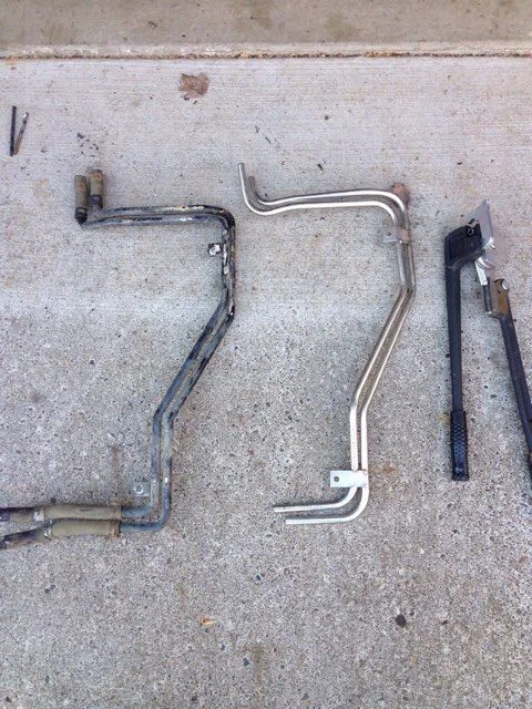

Does anyone know if the rear heater hard lines (upper section) can be left? I will be replacing them with new ones (s.steel) I made as long as they will actually fit... Seems like they will.
Here are the lower ones remade @ home, garage style... Pretty close, meh...
Man that sucks... I feel for u guys, it seems to be an unfair advantage i coincidently have... 1.5hrs away is a real good thing dealing with him...
Here are the lower ones remade @ home, garage style... Pretty close, meh... View attachment 1051785
Nice lines
I just used Napa gold stripe hose the whole way and used a couple clamps I don't see why they wouldn't fit though
Mine were left even though I removed rear heat. I finally cut them out about 2 months ago with a sawsall. It was easy with a 1" body lift but may be tight to snake the pipes through with engine and trans in there.

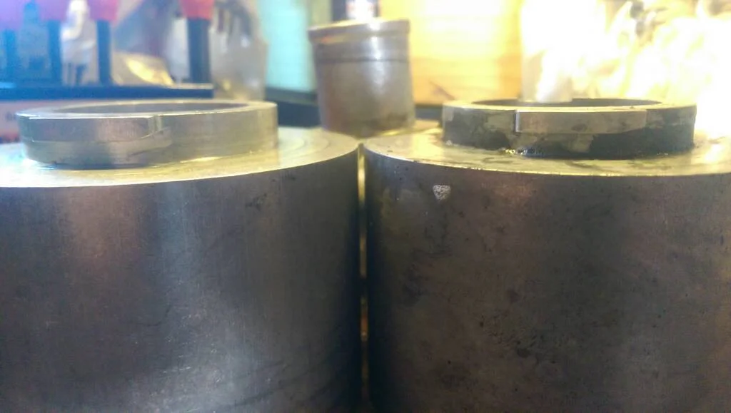

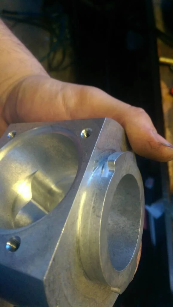

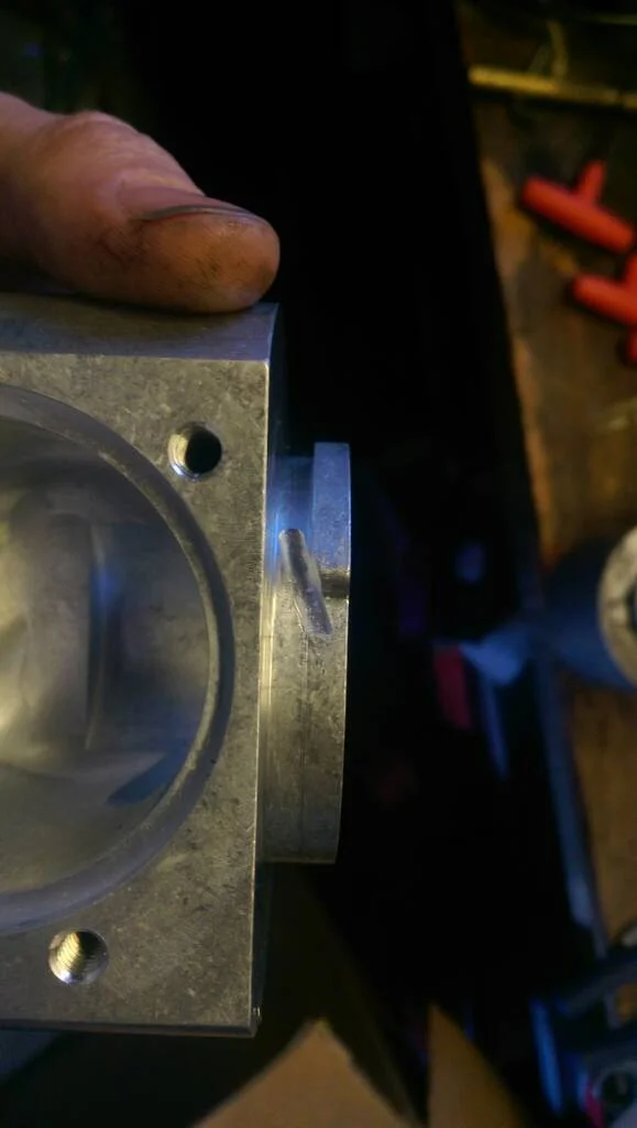

If u do how do the machining marks look on the angled camlock area?
When I was getting the last of my parts I shared my theory with Dustin... Wondering if he just left it sharp edged...
Cnorm u up and running again? At least got your part I hope?
Got my part about 20 min before I had to leave town Friday. have not had time to get it up and running. just a quick look when I got it Friday it looks the same but I will be hopefully working on it tonight after work so I will let you know.
Let me know if your looking for something more spicific
I'm assuming your trying to see if this housing could be used in conjunction with the rest of the plate. Maybe but it would be tight. I think the alternator mount that is cast I to it is about 1/4" into the mounting plain of the accessory bracket lower on the block

I would almost want to get the cracked one welded and keep as a spare. I wonder what he would charge just for that piece? I wouldn't mind having a spare. Wish I would have kept mine. Looking at it earlier it seems you could run a brace from the bracket to the head on the front but nothing on the rear side.
Even if he sold 100 housings and 2 failed it may seem like a small percentage but if you add up the miles for all of them it probably isn't good. I was around 7-8K when mine failed.
