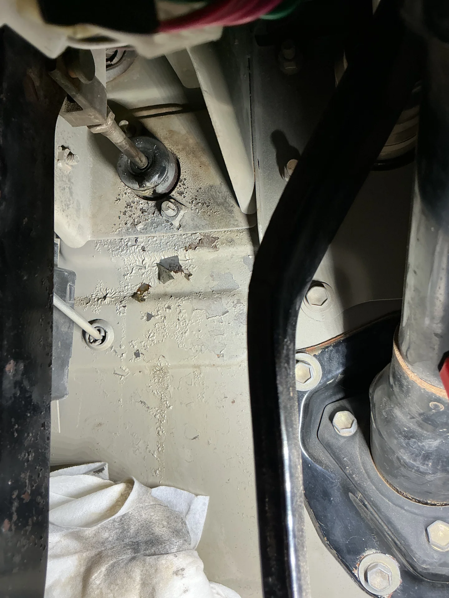

So behind my clutch pedal there is a slight leak. Question is why? And is it drivable until I get the part
B. What is the part lol

Maybe, the clutch master cylinder is starting to leak. Theres no telling how long it will last. Over time they fail. Have you ever driven a stick without a clutch? It can be done. It's a good learning experience.
You can put a clutch master kit easy enough. Or just get a new master. When you go to put the master back in, take a hacksaw and cut a screw driver slot in the bolt that is behind the vacuum booster - much easier to to r/r in the future.
year/model/market.
A few years back 6/23 I got master, slave and stainless steel hose from joetlc on eboy $130. Had an extra long hose, correct length was $50 more. Works great. Screw hose in slave then install it.
Replace the master and slave at the same time...when one goes, the other isn't far behind.
This…do this for sure.
