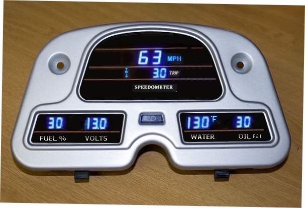

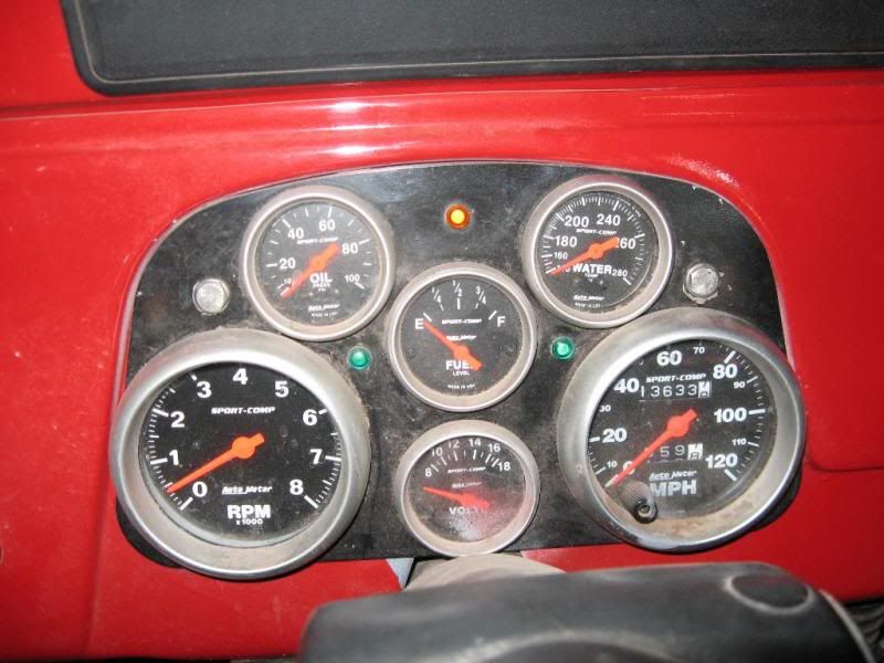

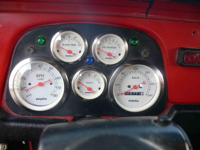

Thanks for the kind words. I'm very curious about your plans for your PHANTOM cluster.
In case you go away (which I hope not) from the OEM cluster............ here are some pics
[URL="http://i1112.photobucket.com/albums/k490/ruud_coco/Toyota%2040%20series%20clusters%20custom%20build/guage-panel-2-9-12.jpg"][URL="http://i1112.photobucket.com/albums/k490/ruud_coco/Toyota%2040%20series%20clusters%20custom%20build/guage-panel-2-9-12.jpg"][URL="http://i1112.photobucket.com/albums/k490/ruud_coco/Toyota%2040%20series%20clusters%20custom%20build/guage-panel-2-9-12.jpg"][URL="http://i1112.photobucket.com/albums/k490/ruud_coco/Toyota%2040%20series%20clusters%20custom%20build/guage-panel-2-9-12.jpg"][/URL][/URL][/URL][/URL]
[URL="http://i1112.photobucket.com/albums/k490/ruud_coco/Toyota%2040%20series%20clusters%20custom%20build/DSCN0139-gauge.jpg"][URL="http://i1112.photobucket.com/albums/k490/ruud_coco/Toyota%2040%20series%20clusters%20custom%20build/DSCN0139-gauge.jpg"][URL="http://i1112.photobucket.com/albums/k490/ruud_coco/Toyota%2040%20series%20clusters%20custom%20build/DSCN0139-gauge.jpg"][URL="http://i1112.photobucket.com/albums/k490/ruud_coco/Toyota%2040%20series%20clusters%20custom%20build/DSCN0139-gauge.jpg"][/URL][/URL][/URL][/URL]
[URL="http://i1112.photobucket.com/albums/k490/ruud_coco/Toyota%2040%20series%20clusters%20custom%20build/DSC04438.jpg"][URL="http://i1112.photobucket.com/albums/k490/ruud_coco/Toyota%2040%20series%20clusters%20custom%20build/DSC04438.jpg"][URL="http://i1112.photobucket.com/albums/k490/ruud_coco/Toyota%2040%20series%20clusters%20custom%20build/DSC04438.jpg"][/URL][/URL][/URL]
[URL="http://i1112.photobucket.com/albums/k490/ruud_coco/Toyota%2040%20series%20clusters%20custom%20build/cluster600.jpg"][URL="http://i1112.photobucket.com/albums/k490/ruud_coco/Toyota%2040%20series%20clusters%20custom%20build/cluster600.jpg"][URL="http://i1112.photobucket.com/albums/k490/ruud_coco/Toyota%2040%20series%20clusters%20custom%20build/cluster600.jpg"][/URL][/URL][/URL]
[URL="http://i1112.photobucket.com/albums/k490/ruud_coco/Toyota%2040%20series%20clusters%20custom%20build/IMG_2333.jpg"][URL="http://i1112.photobucket.com/albums/k490/ruud_coco/Toyota%2040%20series%20clusters%20custom%20build/IMG_2333.jpg"][URL="http://i1112.photobucket.com/albums/k490/ruud_coco/Toyota%2040%20series%20clusters%20custom%20build/IMG_2333.jpg"][/URL][/URL][/URL]
[URL="http://i1112.photobucket.com/albums/k490/ruud_coco/Toyota%2040%20series%20clusters%20custom%20build/P1080765_resize.jpg"][URL="http://i1112.photobucket.com/albums/k490/ruud_coco/Toyota%2040%20series%20clusters%20custom%20build/P1080765_resize.jpg"][URL="http://i1112.photobucket.com/albums/k490/ruud_coco/Toyota%2040%20series%20clusters%20custom%20build/P1080765_resize.jpg"][/URL][/URL][/URL]
[URL="http://i1112.photobucket.com/albums/k490/ruud_coco/Toyota%2040%20series%20clusters%20custom%20build/img_0417a.jpg"][URL="http://i1112.photobucket.com/albums/k490/ruud_coco/Toyota%2040%20series%20clusters%20custom%20build/img_0417a.jpg"][URL="http://i1112.photobucket.com/albums/k490/ruud_coco/Toyota%2040%20series%20clusters%20custom%20build/img_0417a.jpg"][/URL][/URL][/URL]
[URL="http://i1112.photobucket.com/albums/k490/ruud_coco/Toyota%2040%20series%20clusters%20custom%20build/vendor1.jpg"][URL="http://i1112.photobucket.com/albums/k490/ruud_coco/Toyota%2040%20series%20clusters%20custom%20build/vendor1.jpg"][URL="http://i1112.photobucket.com/albums/k490/ruud_coco/Toyota%2040%20series%20clusters%20custom%20build/vendor1.jpg"][/URL][/URL][/URL]

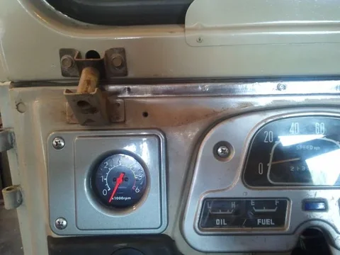

In case you want to put in a OEM style tacho meter......
here is a link: -► https://forum.ih8mud.com/merchandis...ters-your-40-series-landcruiser-fj-bj-hj.html
