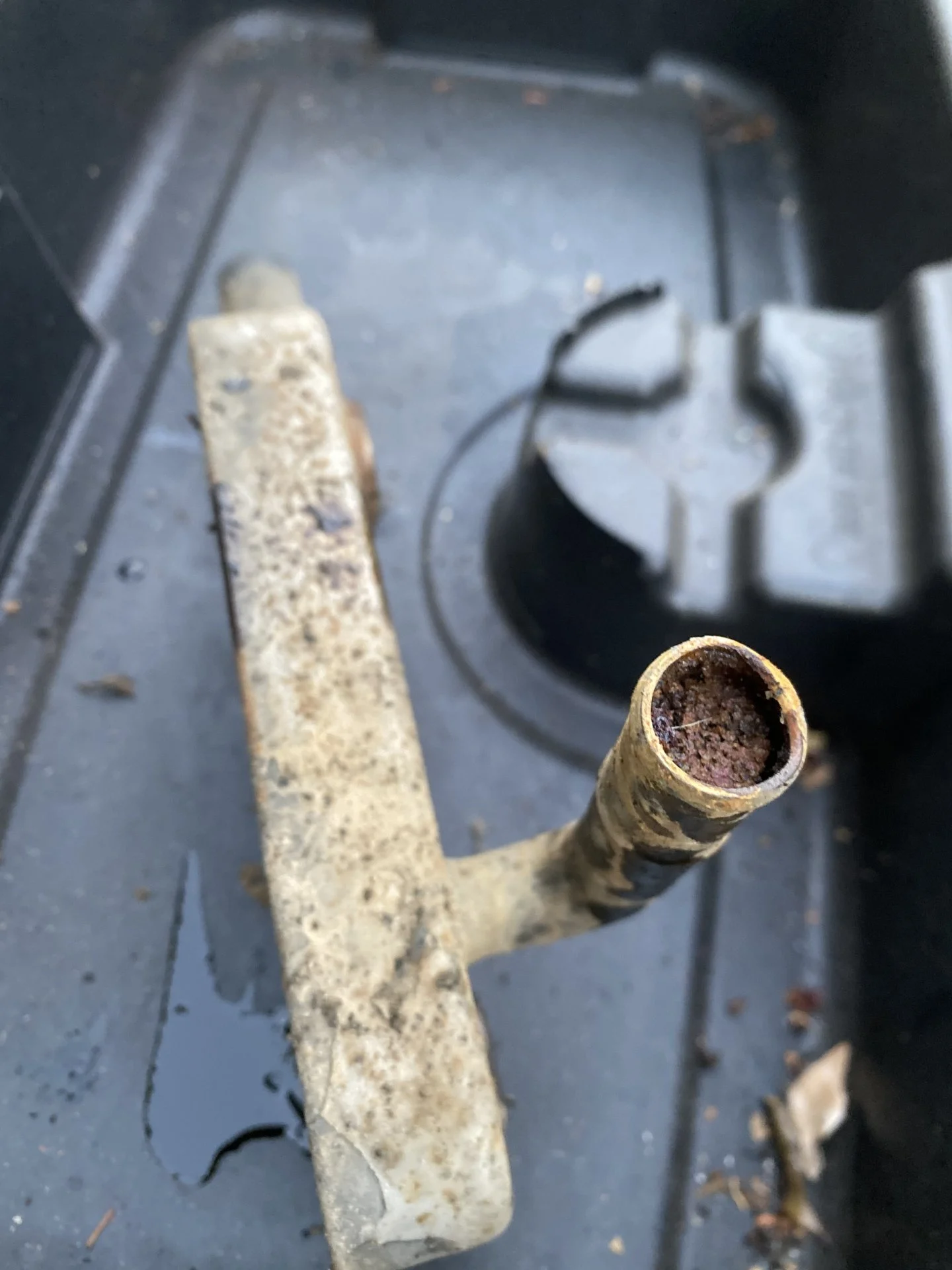

This 60 had been sitting for 15 years or so. While rehabbing and flushing the coolant system I noticed the lines going from the t stat to the oil cooler were clogged with an alien substance. Probably a mixture of deteriorating hose, gasket and crystallized coolant. Pulled the oil cooler today to flush it and boom.
Blasted and probed a bit. Currently filled with white vinegar. Time will tell

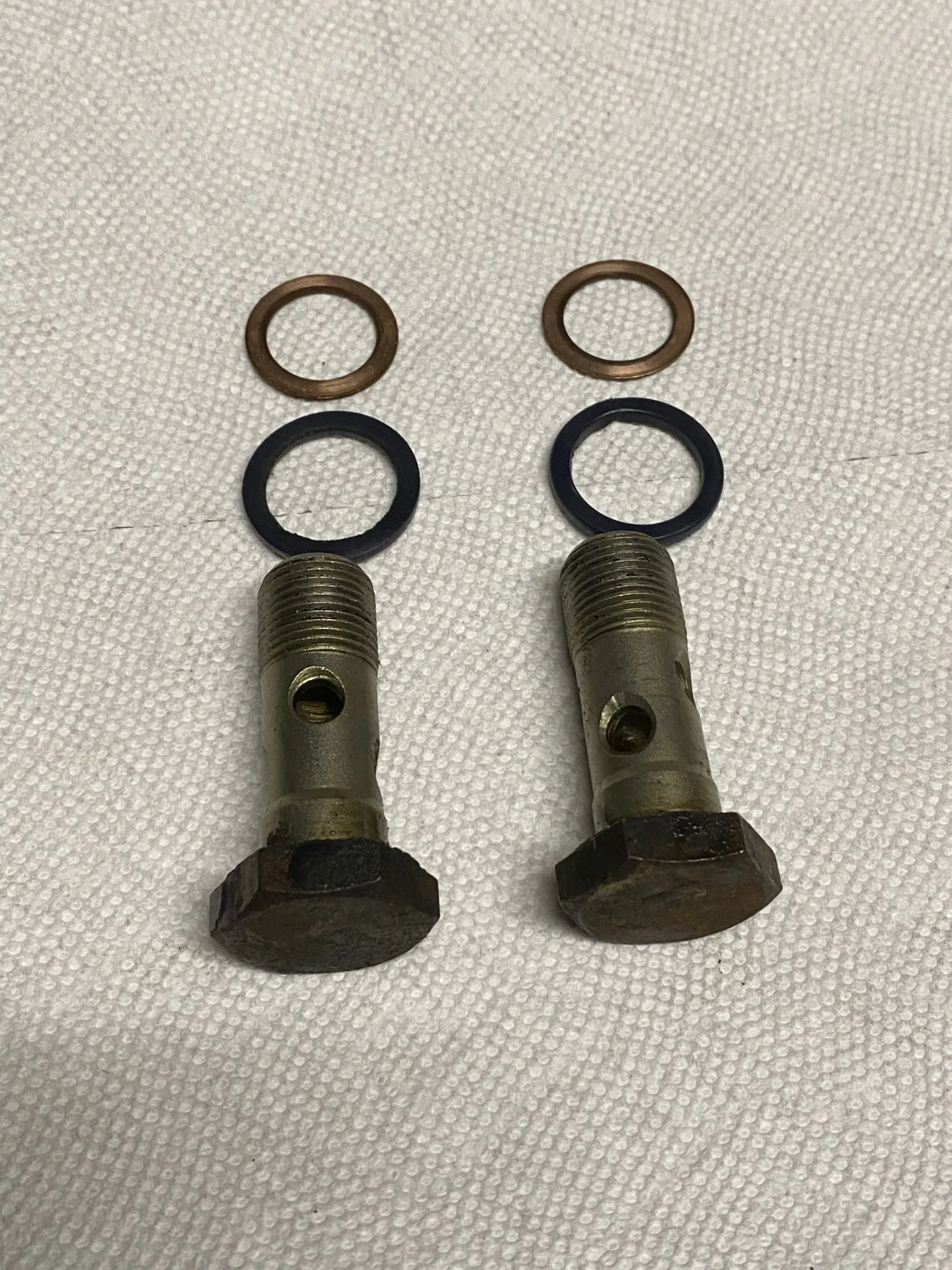

Anyone got part numbers on hand for the washer and grommets?

Edit: this evening I was able to get the cooler de-clogged by using a thick tie wire. Once the clog was breached it cleared right up but did cause a bit of concern after reading the earlier comments about the head coolant passages. Is flushing going to be something that’ll even be helpful at this point?
For a point of reference the oil cooler had soaked over night in white vinegar and all day in a diluted clr mix as well, to no avail.

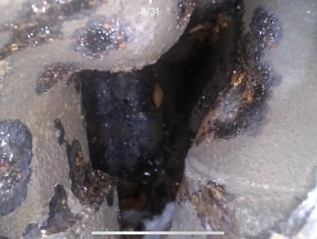

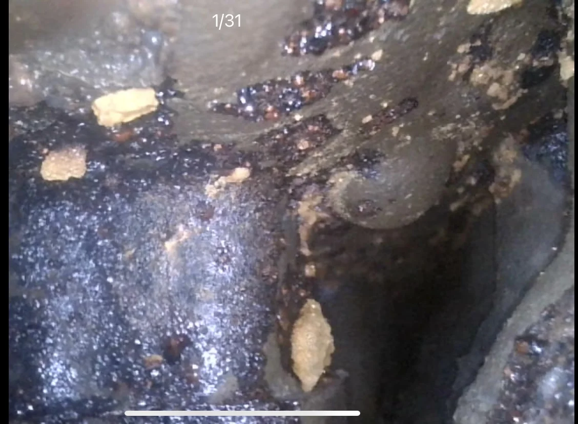

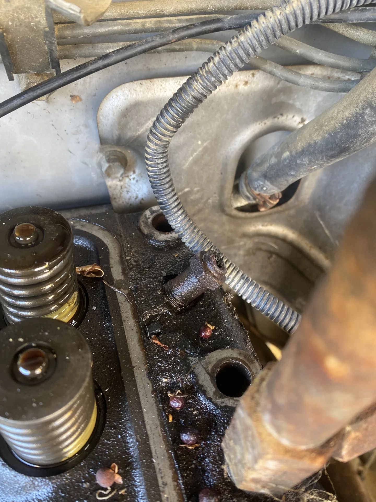

Looks crispy inside the head. I’ll get picts in a bit.
Removed block drain. It was damned up. Cleared that with a screwdriver.

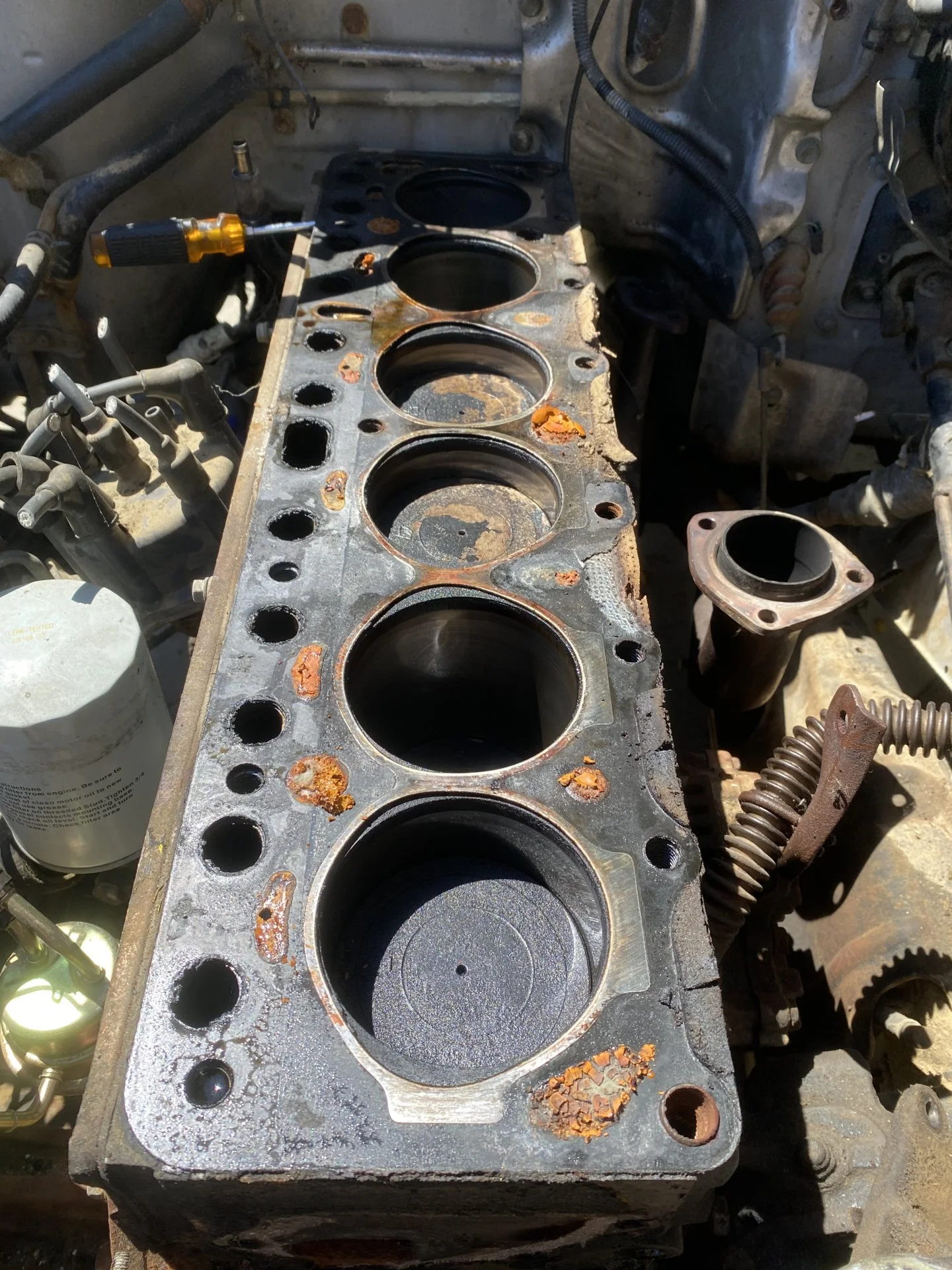

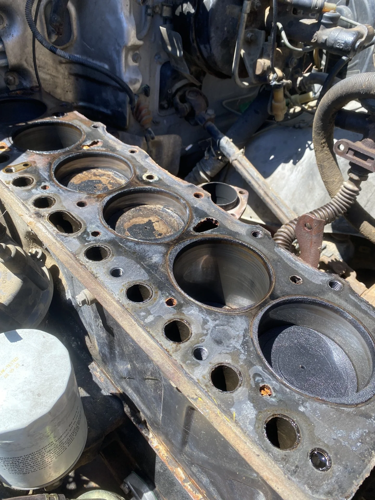

I just ordered a new head gasket and bolts so I’m now committing to pulling the head for the coolant passages. It’ll haunt me if not. New territory though I’ll be researching it while the parts ship.
Thanks @Spook50

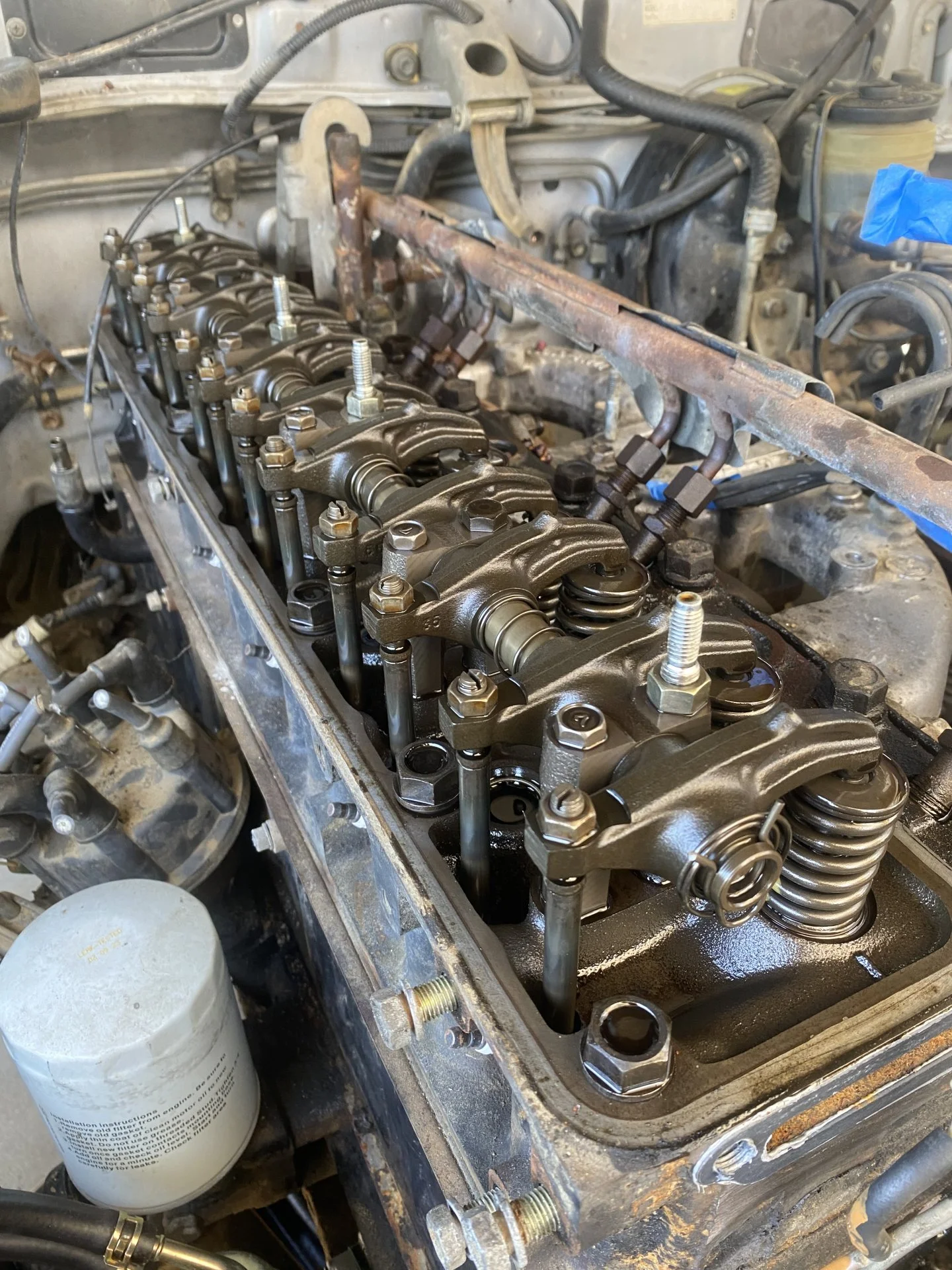

@RodrigzCrzr came over today to Hold my hand through pulling the head. All and all is went well.
Snapped the rear most air rail leg off but glad the head bolts all came out with out a casualty.
Valves looked surprisingly clean. Very glad we pulled the head because the water passages were very mucked up
