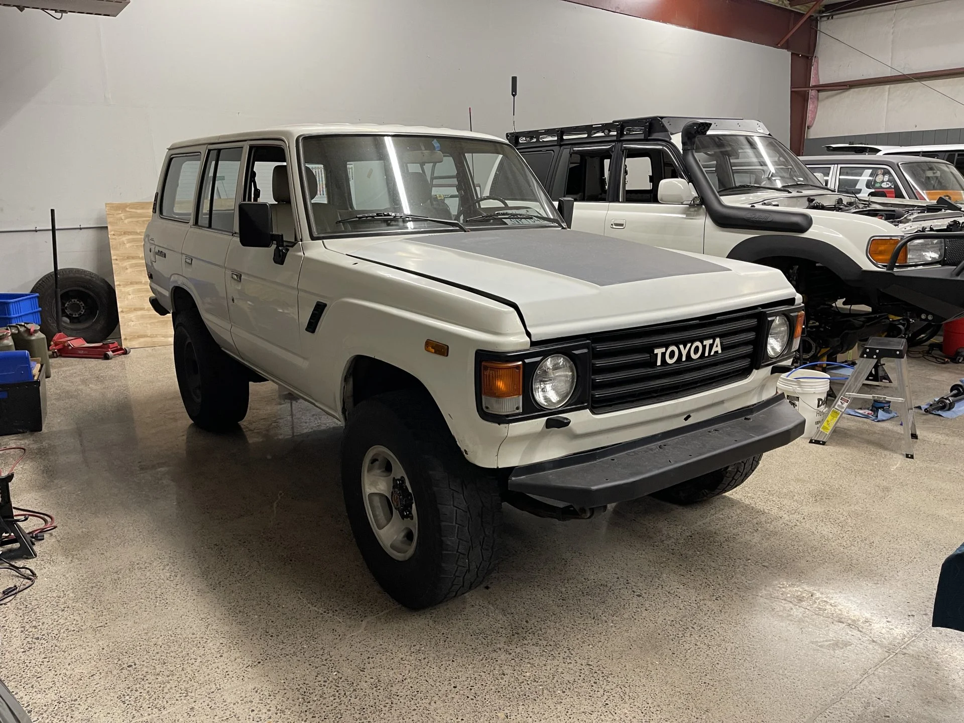

The past year has kicked my ass. Between moving to another state, the fires, my wife’s horrible health ordeal and other nonsense…I’ve decided to sell the 60. Unfortunately the medical bills are preventing Wits’ End from moving forward. I have a few vehicles and right now I think it’s best to let the 60 go to someone else who would be able to enjoy it more than I will.
I have a bunch of stuff I want to do to it to make it as complete as possible for the next owner. Sure it’ll cost me more to do so but whatever, It’ll just make my asking price climb 😜
I’ll be posting the status and what I’ve been doing to it before it gets handed to the new owner. Whoever that winds up being.

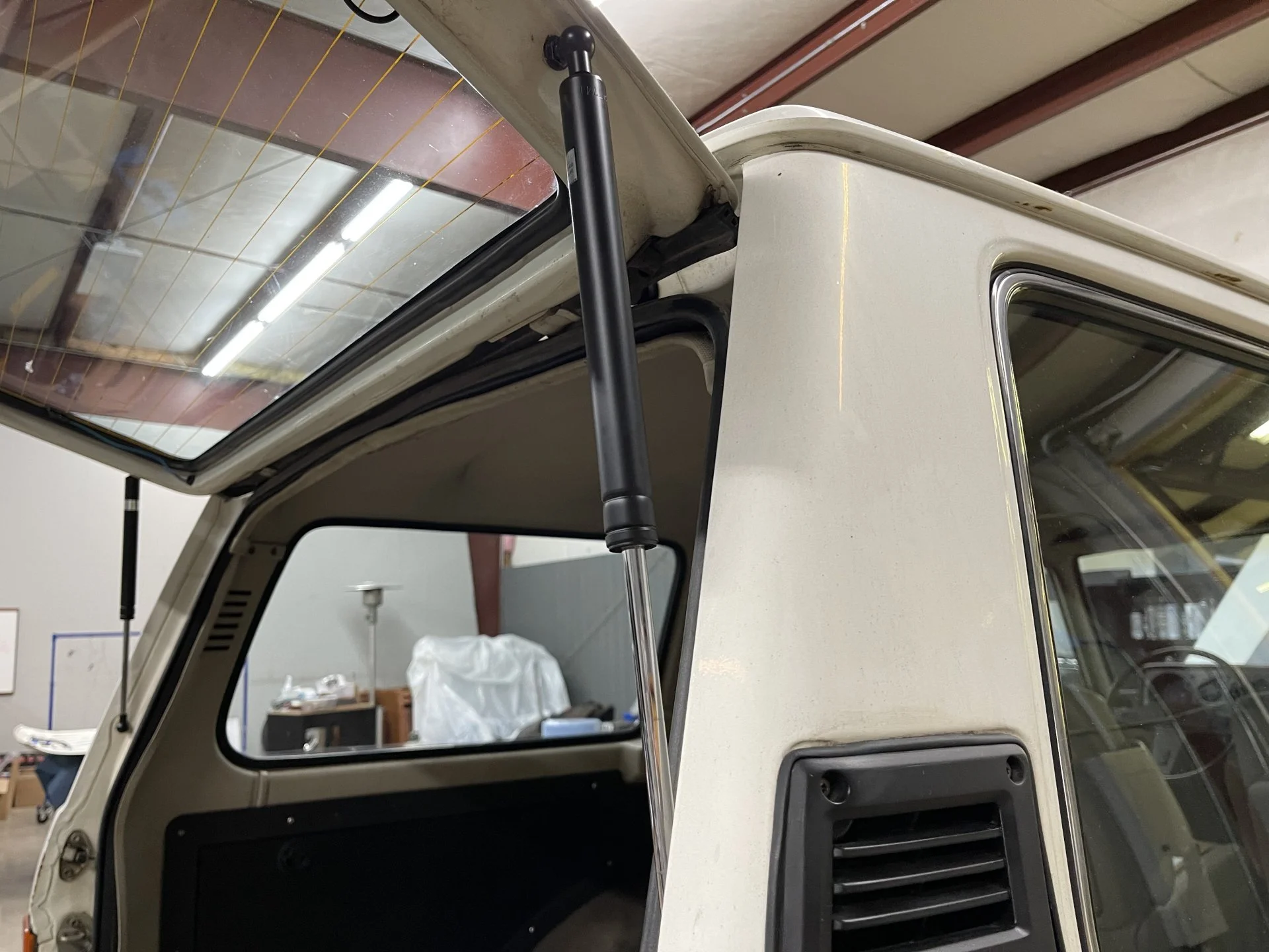

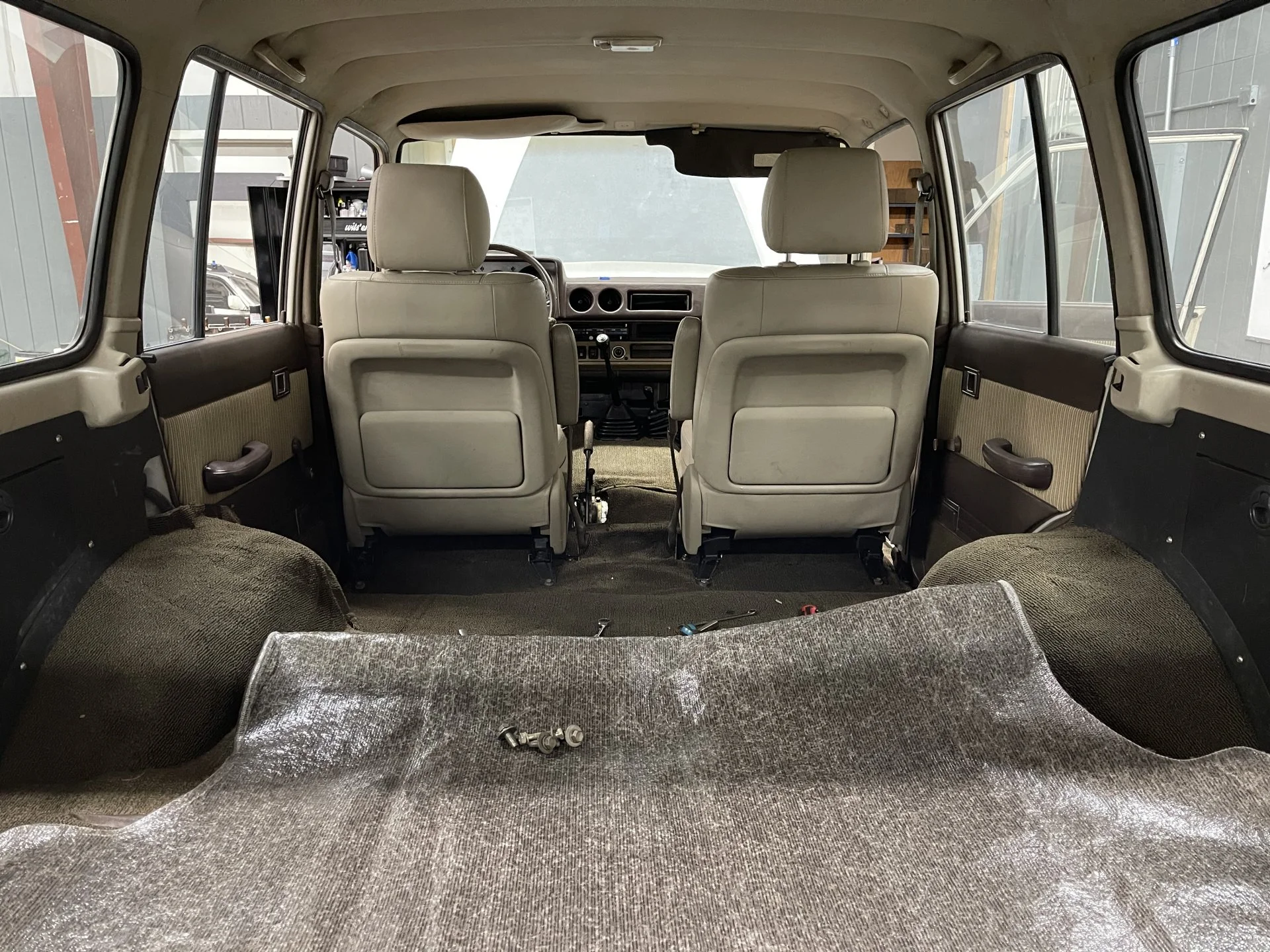

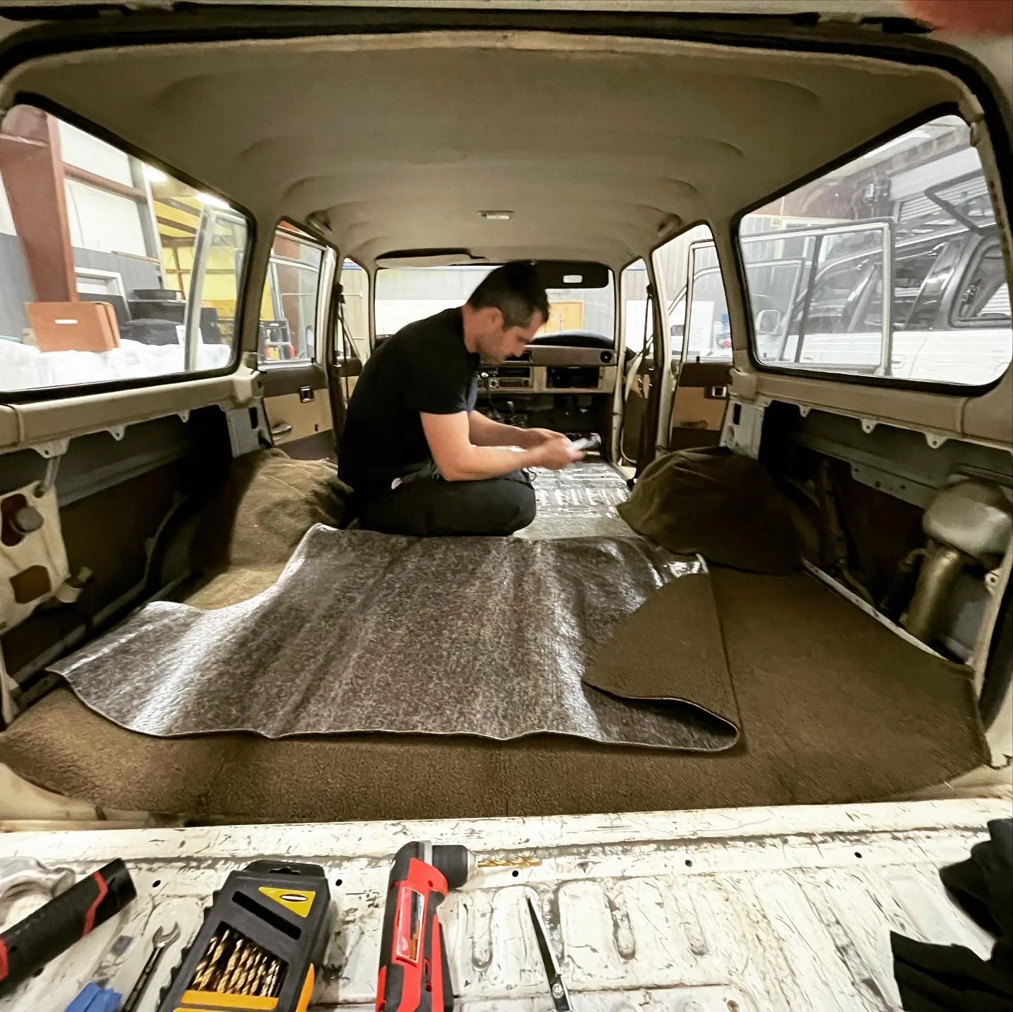

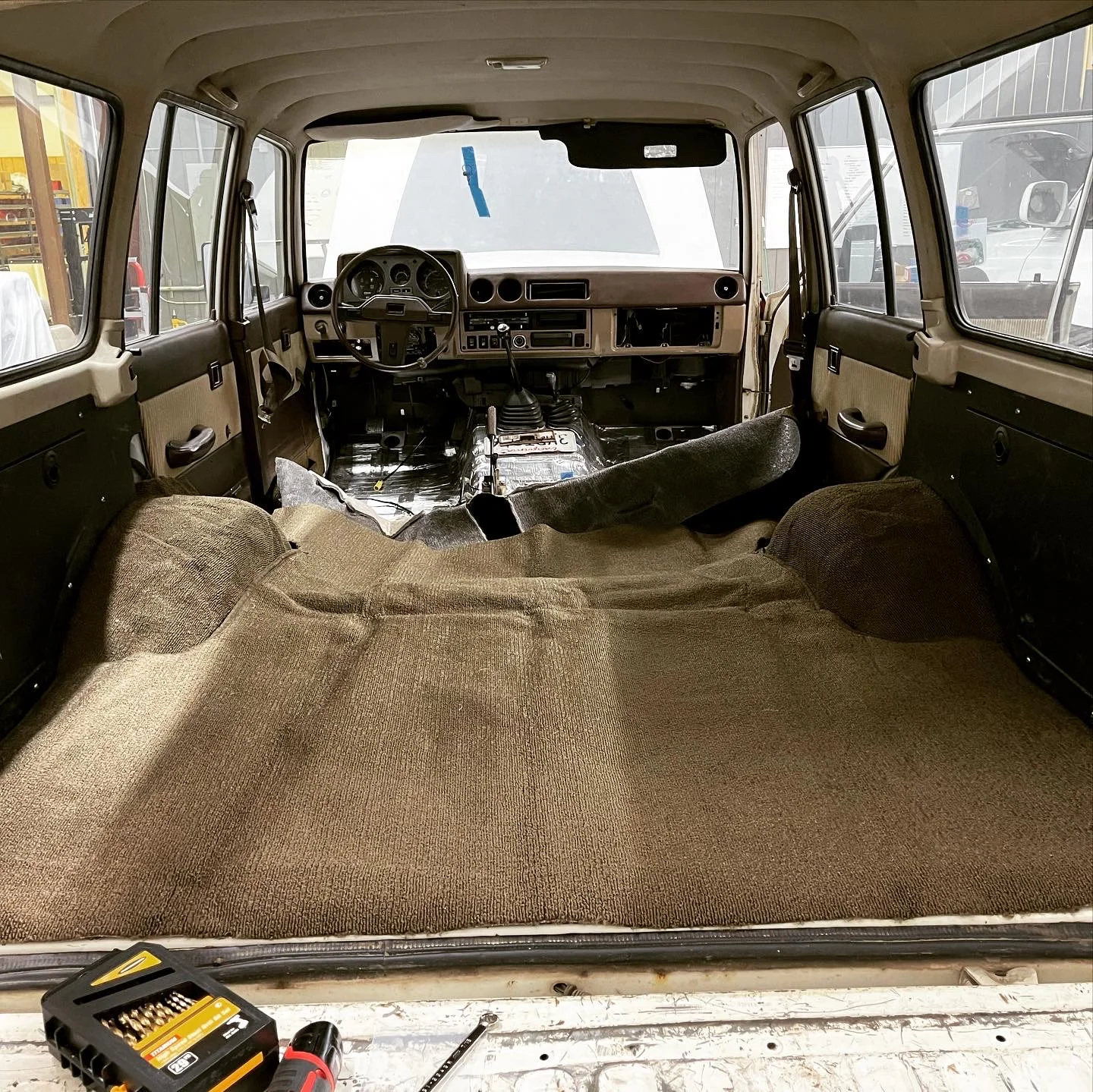

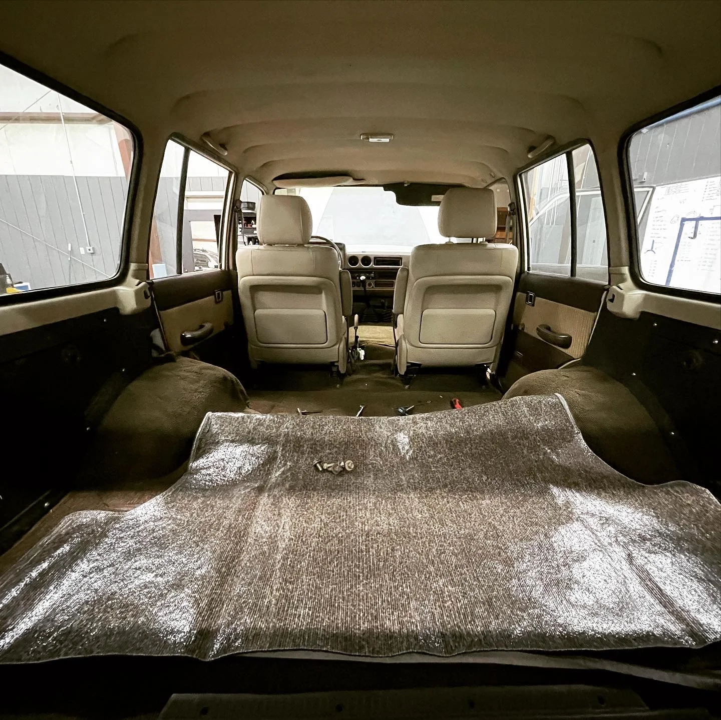

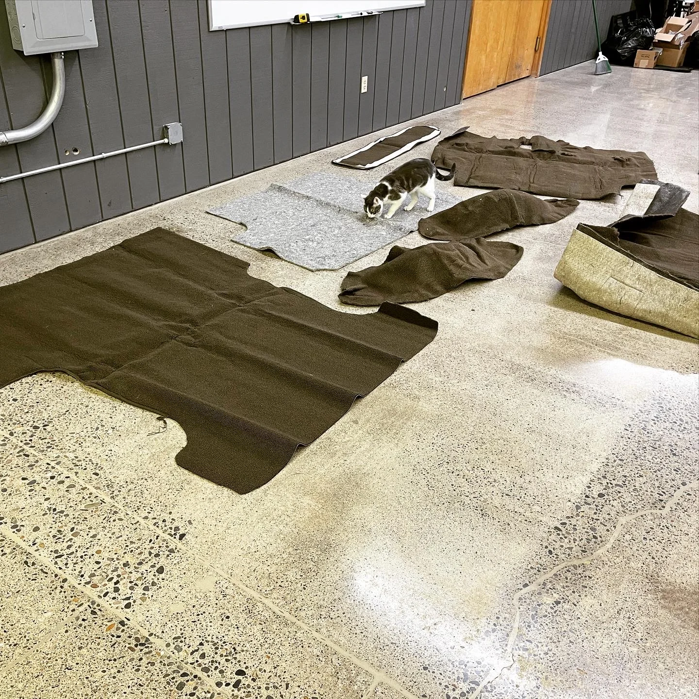

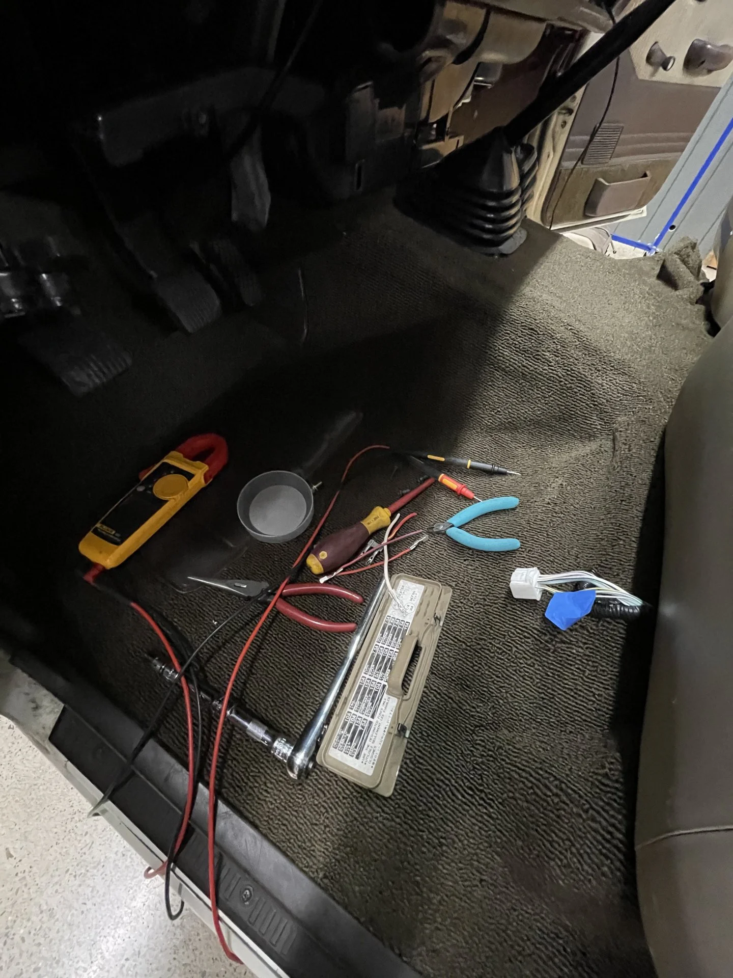

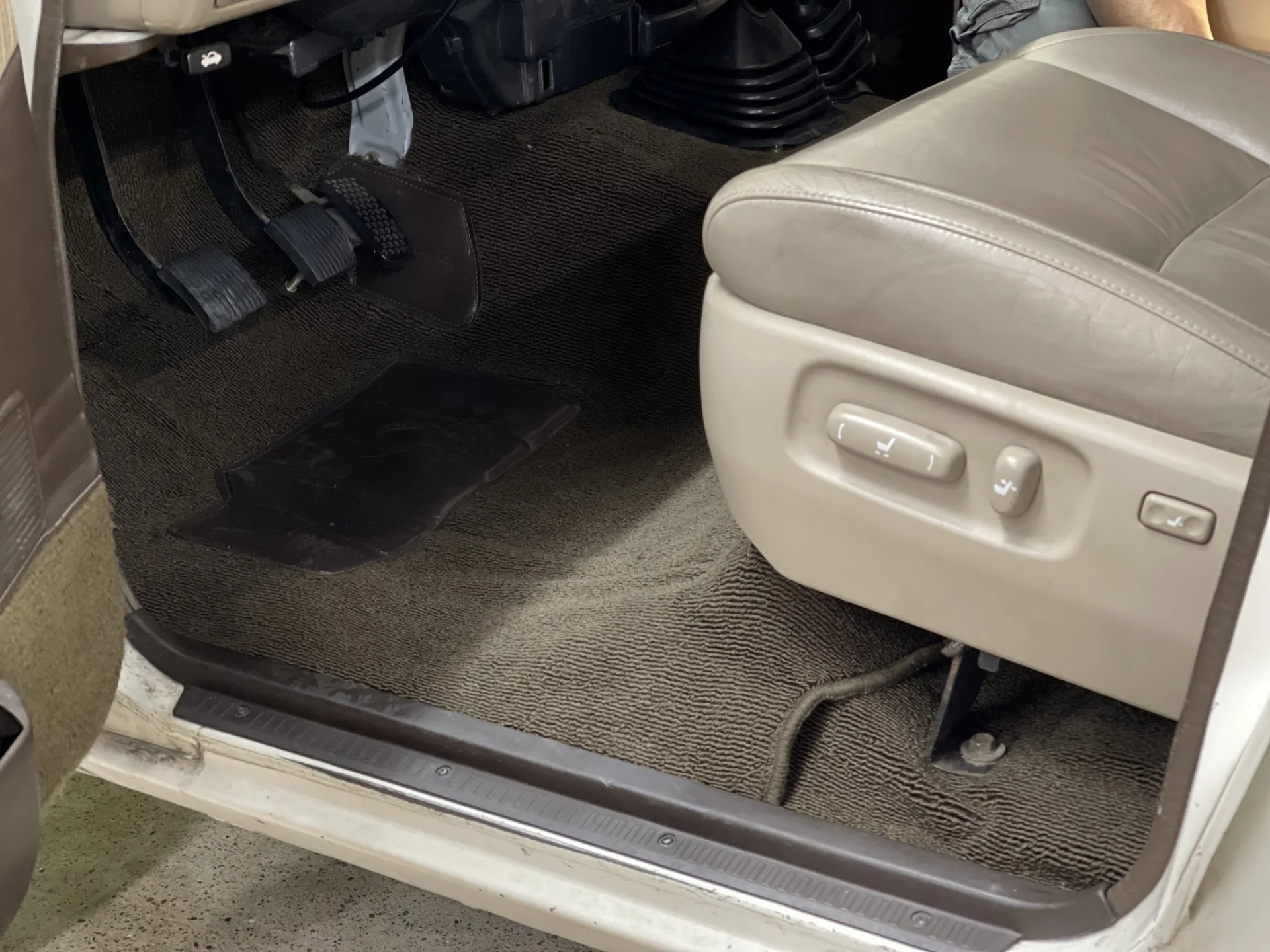

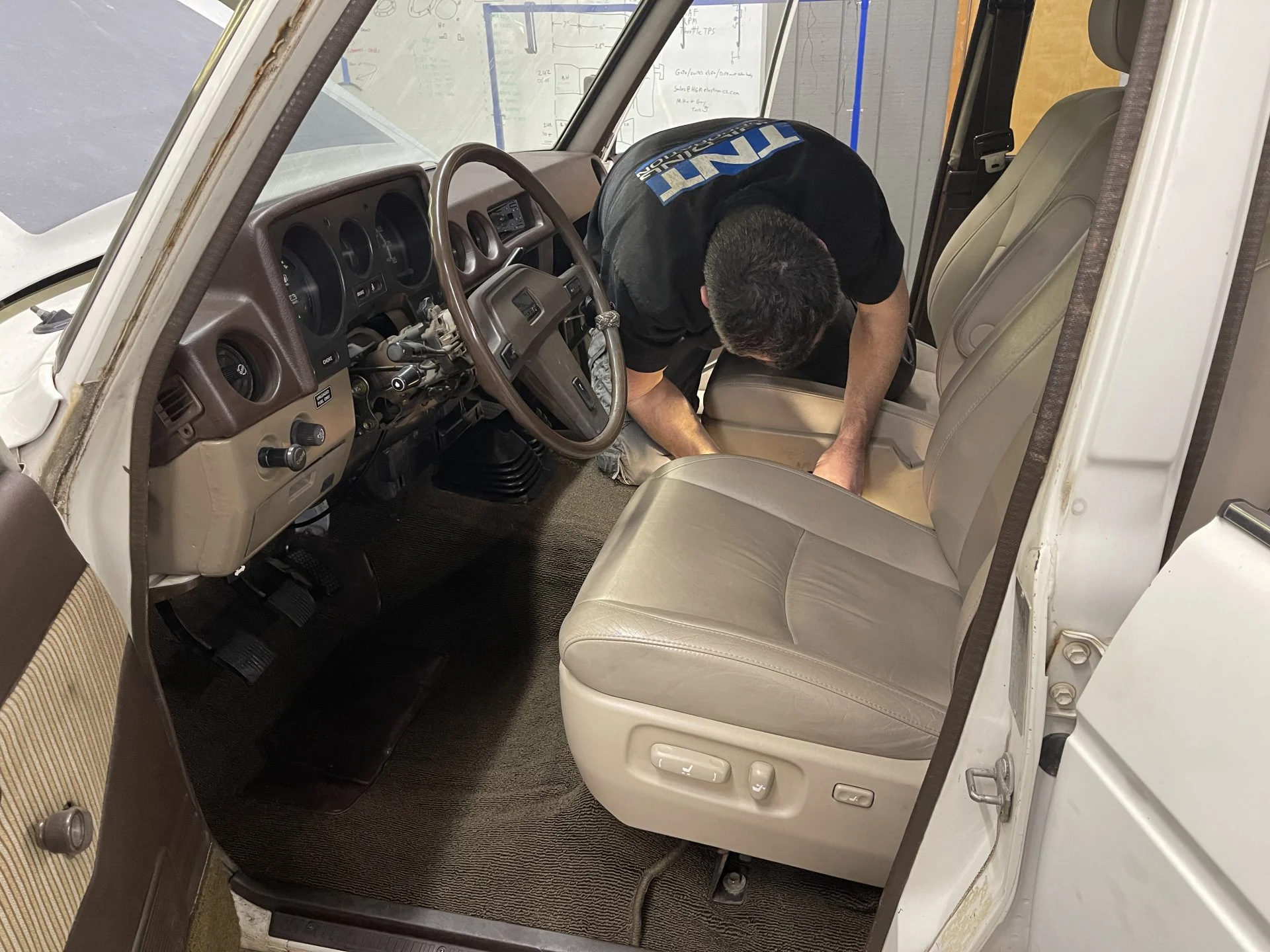

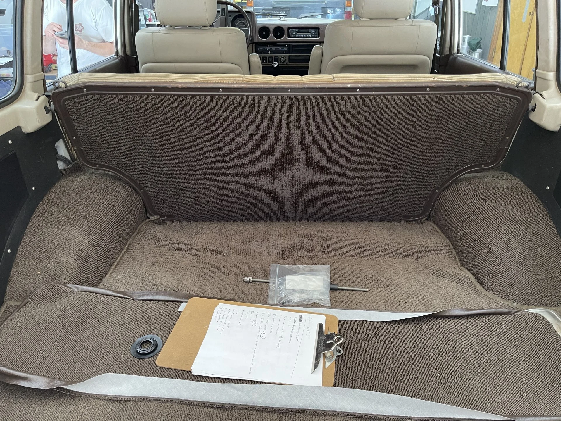

This was done way back in Feb it figured I should update this thread. New brown carpet installed. Only thing waiting is a good tailgate board for the tailgate carpet.

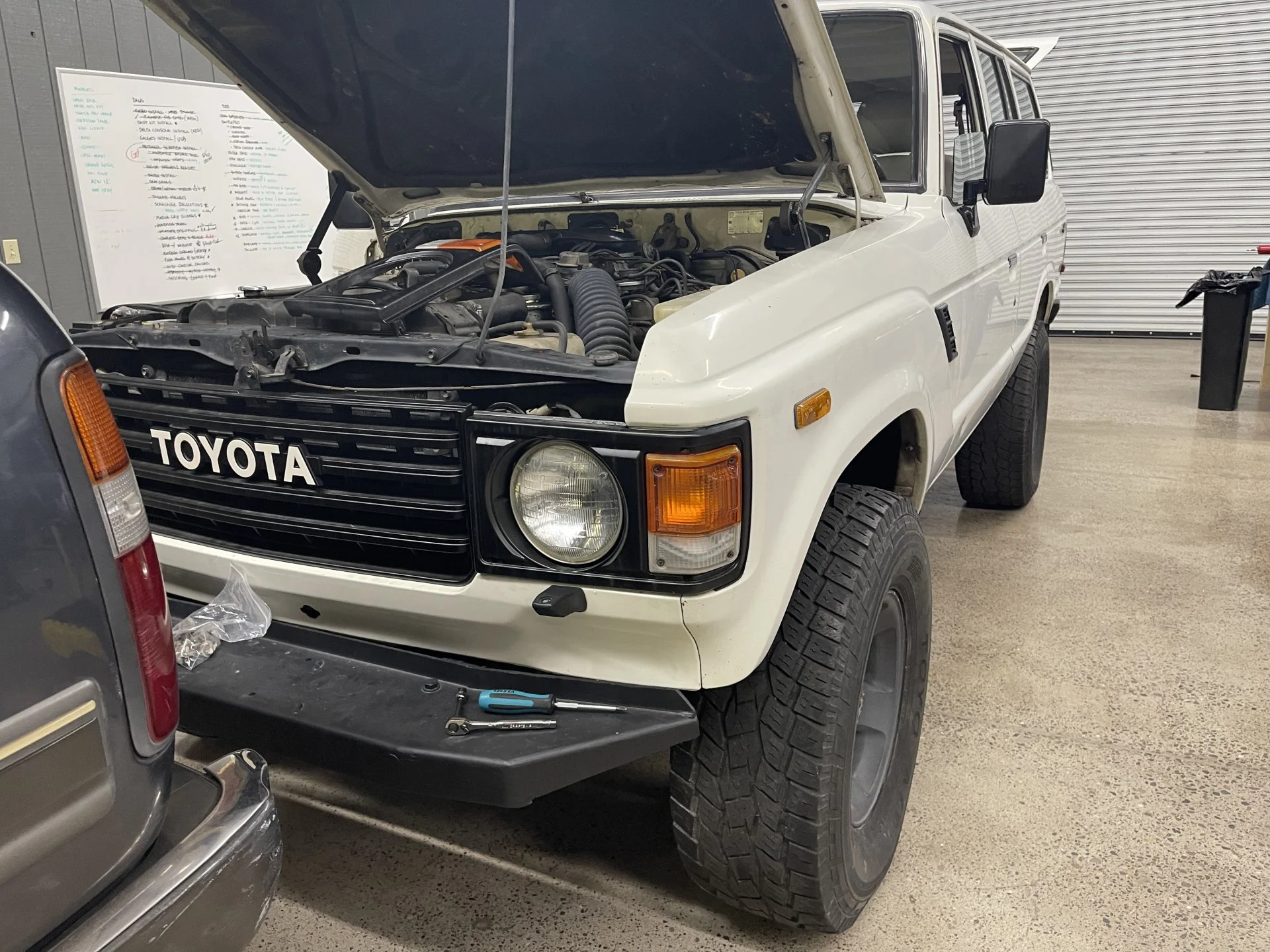

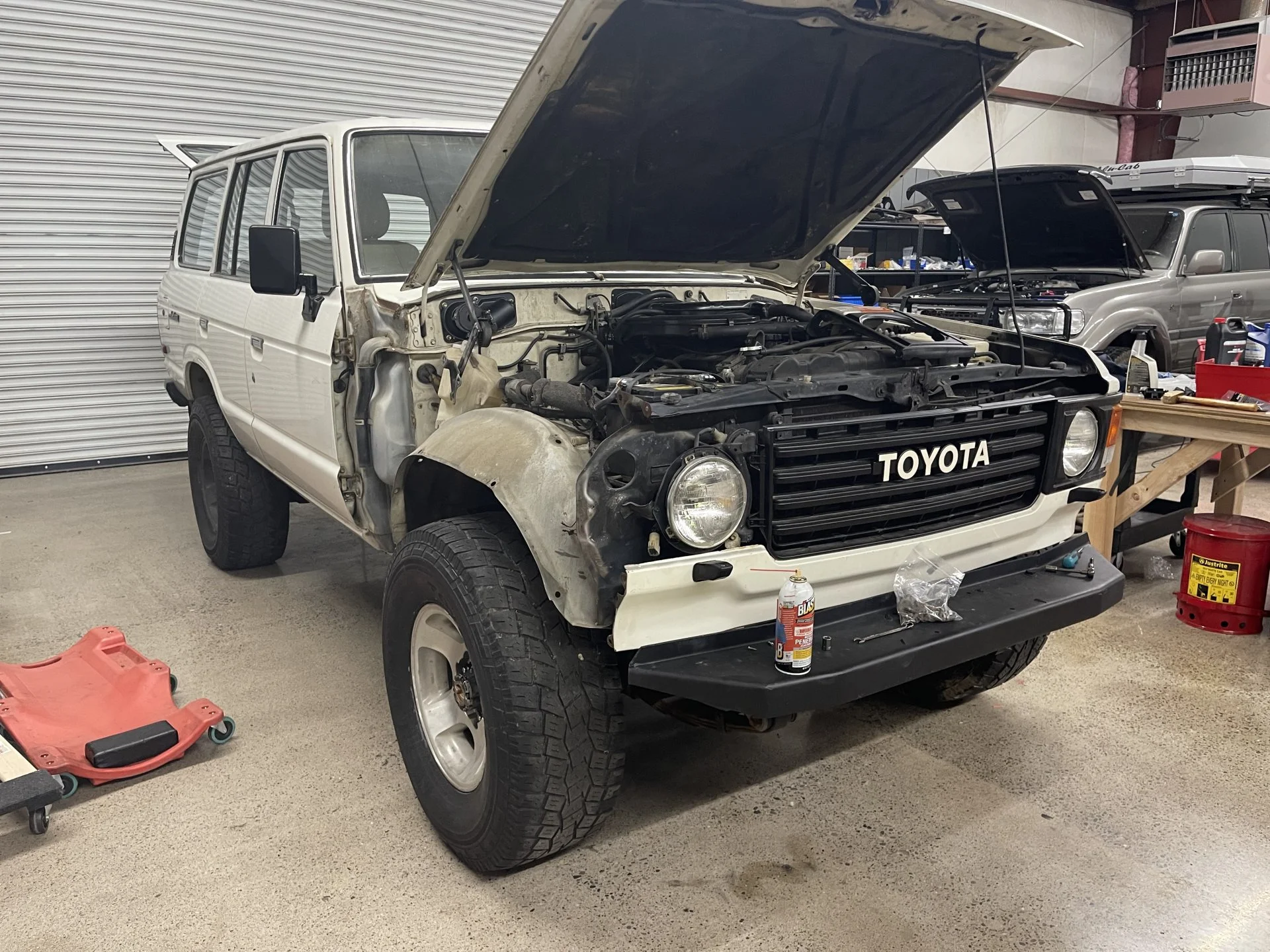

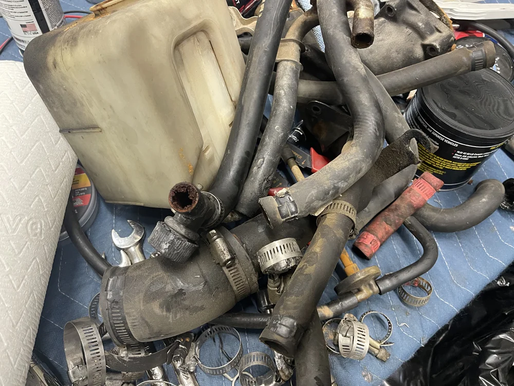

Well, I was just about to start writing the "for sale" listing. But I went for a drive and got some gas and on the way back the truck was getting a little warm. Thats odd because its NEVER EVER gotten above "warm". Got back to the shop and noticed some wetness around the tank. Welp my guilt would destroy me if this thing overheated after handing it over to the new owner. So the decision was made to completely redo the entire cooling system. The rear heater was already removed and the under dash heater core was inspected and looked fine with no leaks. Everything else is getting replace including:
• Water pump
• All heater hoses
• All radiator hoses
• All drive belts
• Thermostat AND housing
• Block drain
• Radiator
Everything will be OEM except obviously the radiator which I will be going CSF 2708.

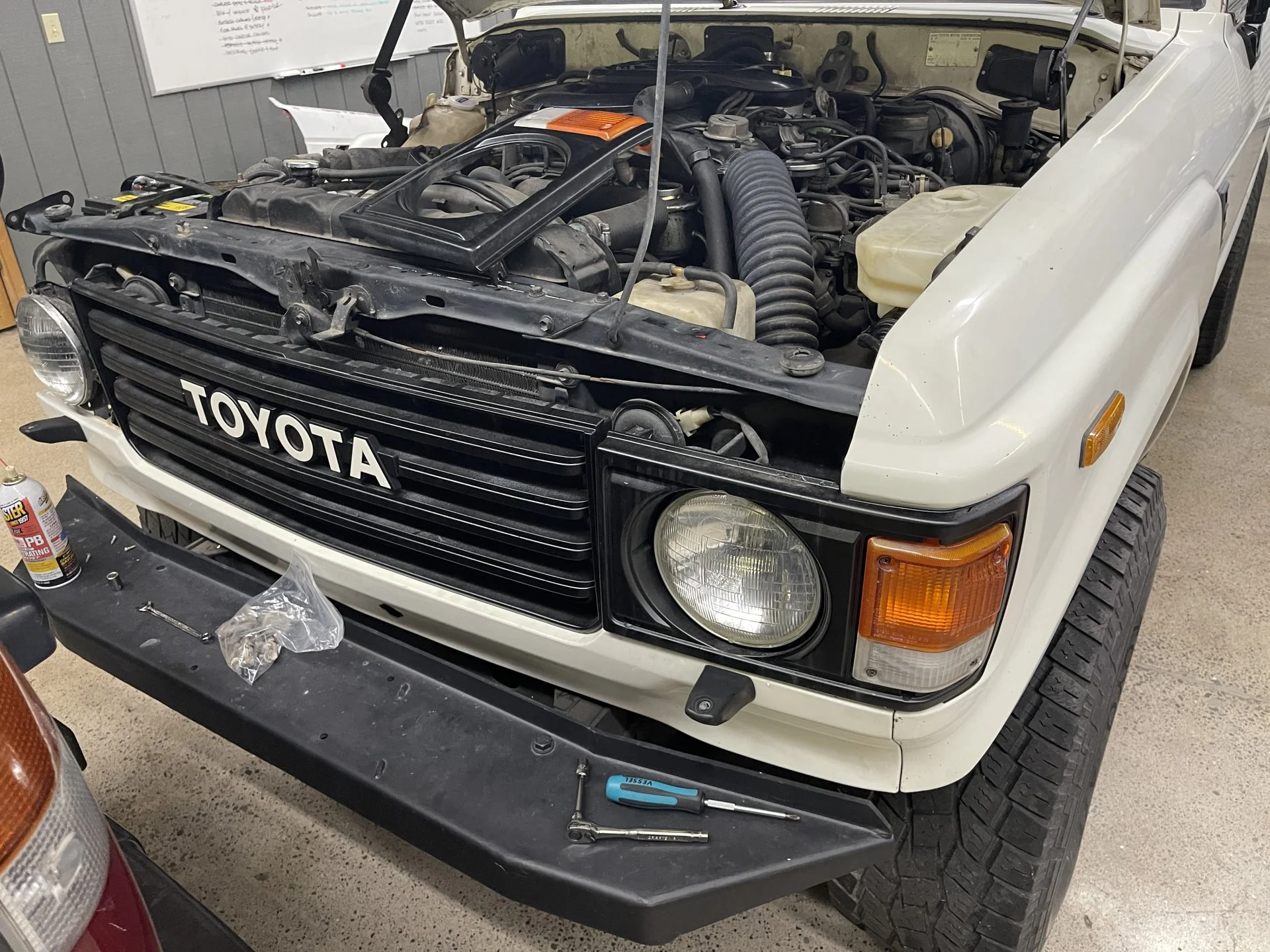

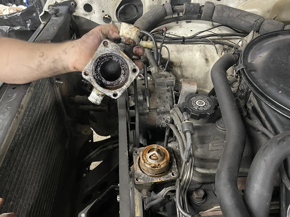

After removing the shroud it was pretty obvious that the radiator failed. I sent to out to a local radiator shop that does all the diesel trucks in the area and they said its too far gone to rebuild. Its the original radiator. Once all the hoses came off we could see the pitting and what looks like calcium deposits from not enough coolant ratio and using tap water. The last shopped that touched it as K&H back in LA when I had the head replaced and the trans and transfer put in. So looks like they cheaped out on the coolant and hose water. Oh well.

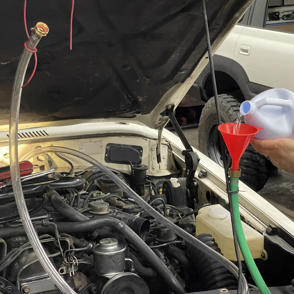

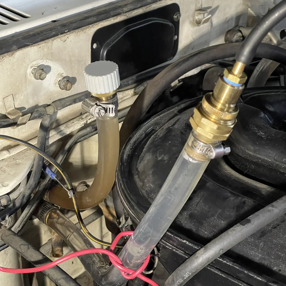

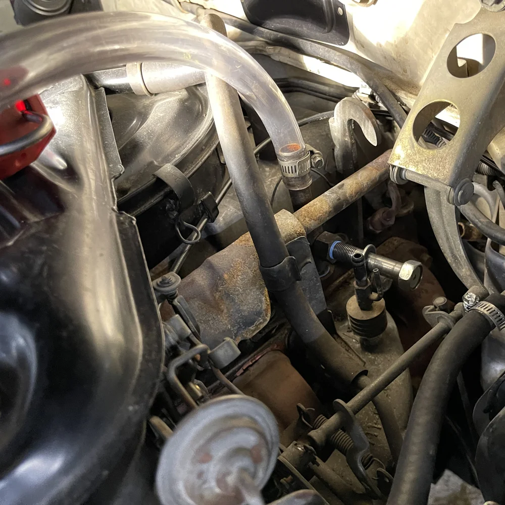

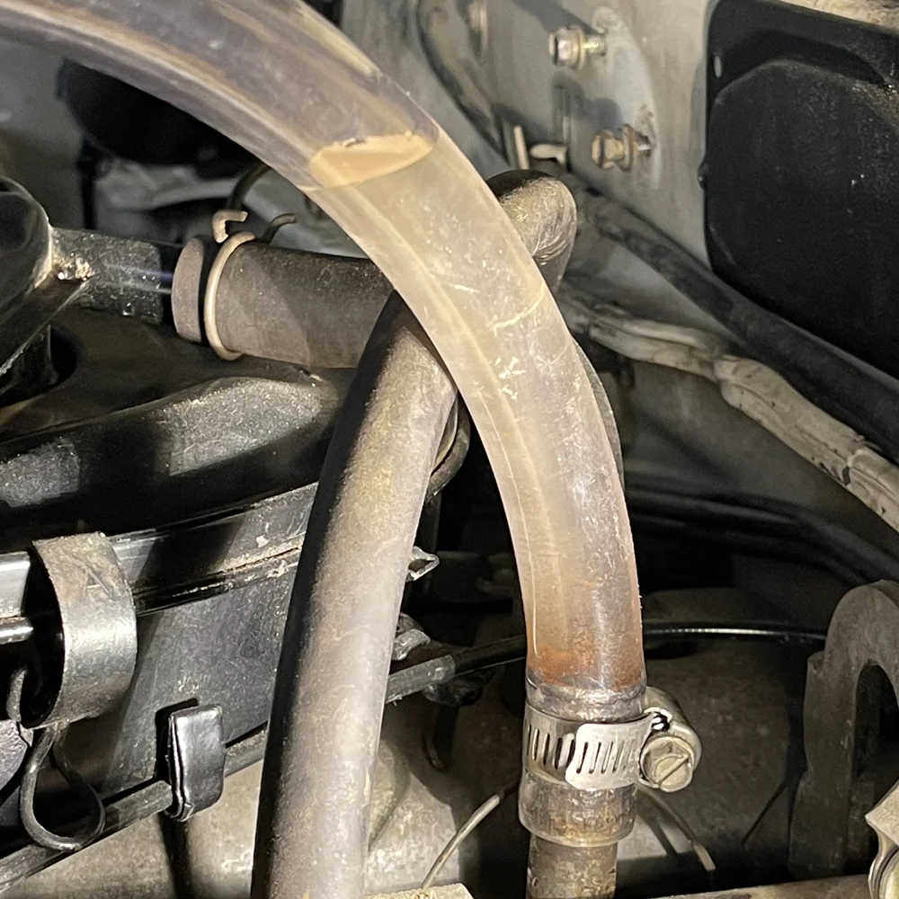

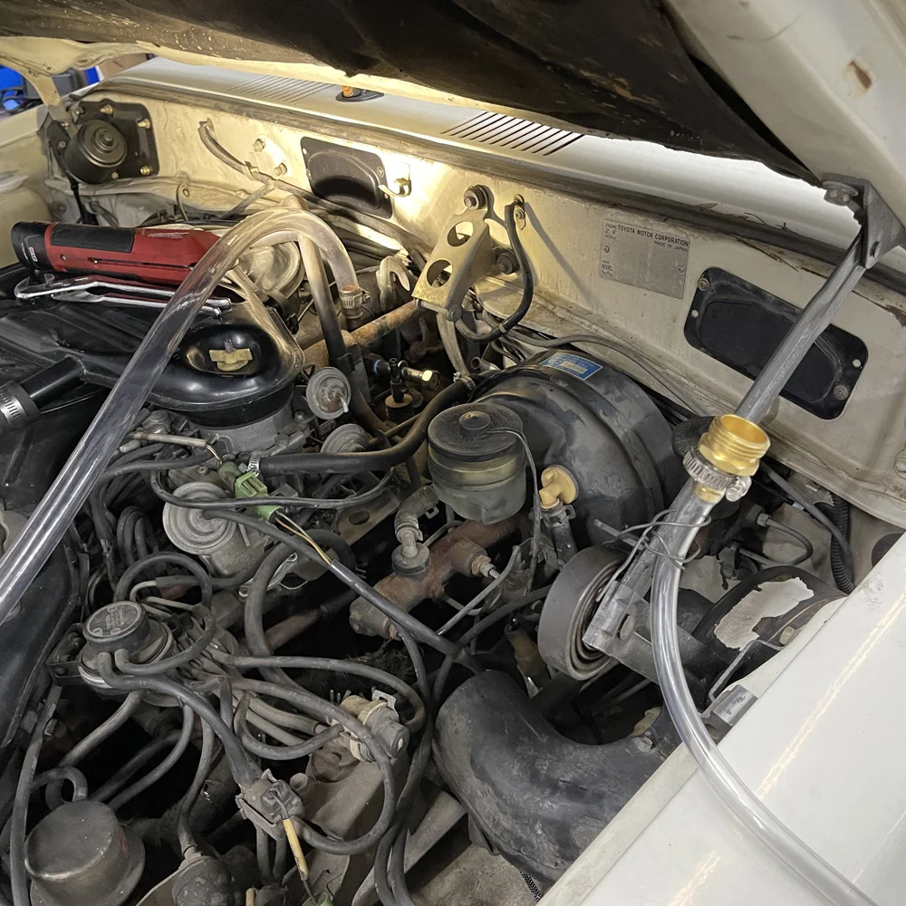

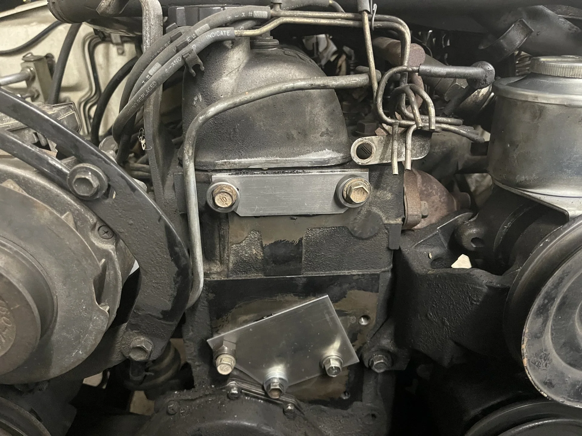

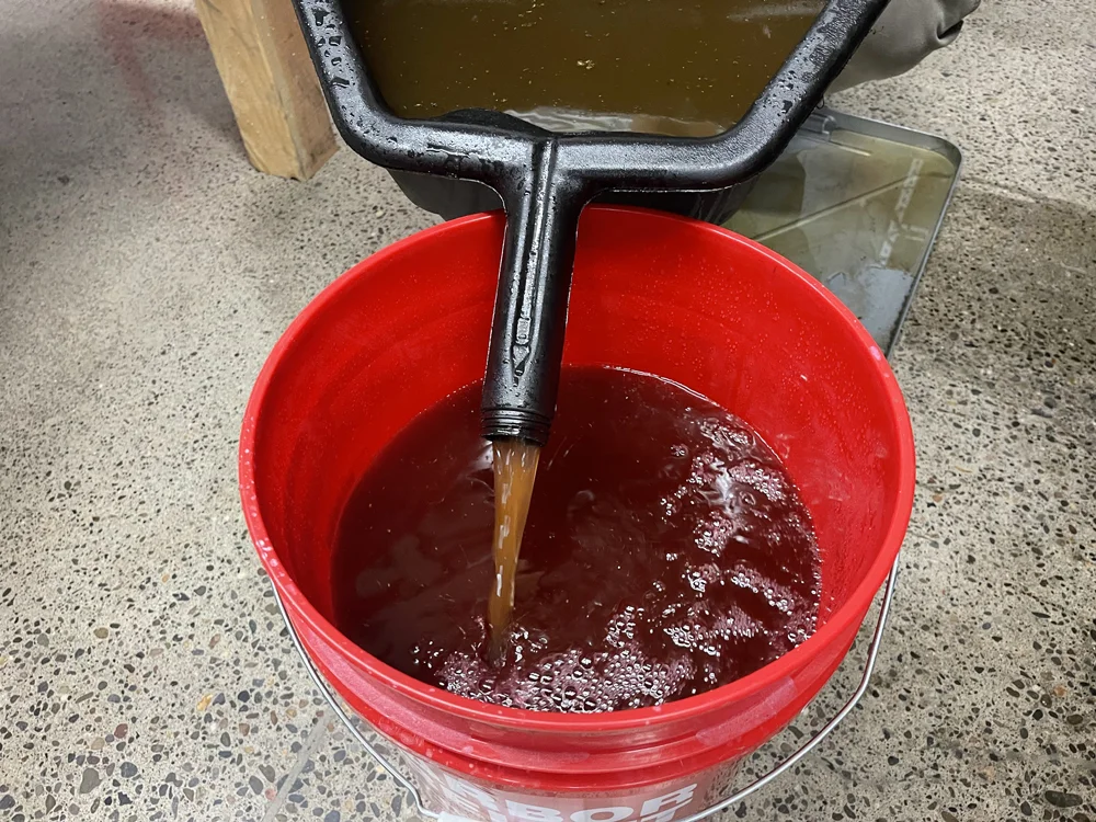

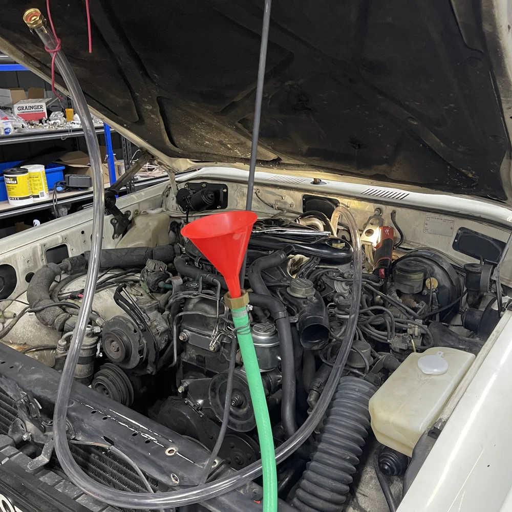

First thing is first. The use of hose water, and lack of a good coolant mixture, has contributed to rust being in the cooling system and its time to remove whatever can be removed. I don't like using all the chemical stuff found in auto parts store. Made some block off plates for the waterpump and thermostat housing openings. Only like to use vinegar (acetic acid) on engine coolant passages. Quick trip to the hardware store and we used the block drain to fill the block. Wanted to fill the vinegar from the bottom up. The top of the heater control pipe was used for burping the system. Used a MightyVac to get the air out from the cavitation in the block.
Approximately 2.5 gallons of vinegar were emptied into the block. We kept using the vacuum pump until the big bubbles were out. As the vinegar does its work it will off gas and this will pour vinegar out of the raised tube. It MUST be open to atmosphere so that it doesn't pressurize. It WILL dump a bunch of expanded gases/vinegar if you arent careful. This is going to sit in the truck for a few days then fully flushed with distilled repeatedly.
Did the same with the heater core. Only difference is the vinegar will only be in there overnight. Brass doesn't rust but rust will accumulate since its a low point in the system and only gets usage a few months out of the year.

Interesting method. For coolant flushes I've done, I've just removed the thermostat, drained the system, filled with regular water+muratic acid, then ran the engine up close to temp (with the heater core valve closed or bypassed). After that, a drain, second flush with water (engine running), then drain again and add 50/50 coolant.
What did the water running out look like with the vinegar?
