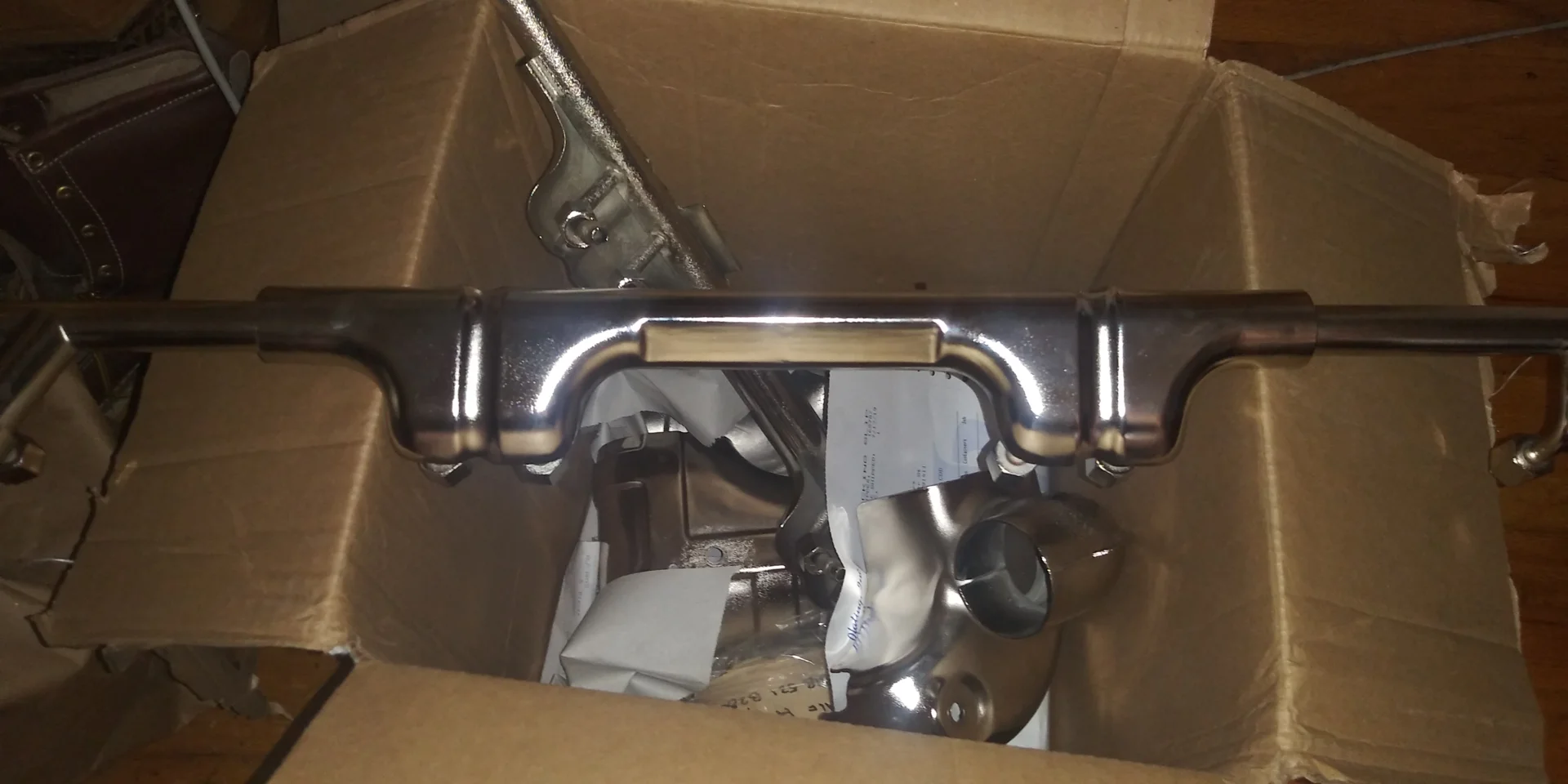

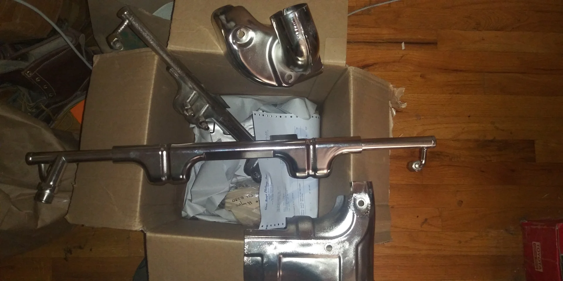

This place may be able to fix your air rail, as well as plate it with Nickle for high-temp durability. One of those rails below was buggered like yours and they fixed it for $30, then plated. It's on the truck now. I also had them re-braze and replace the end caps on the rail as those are known to rust out before the rest of the assembly, particularly the one at the firewall end.
