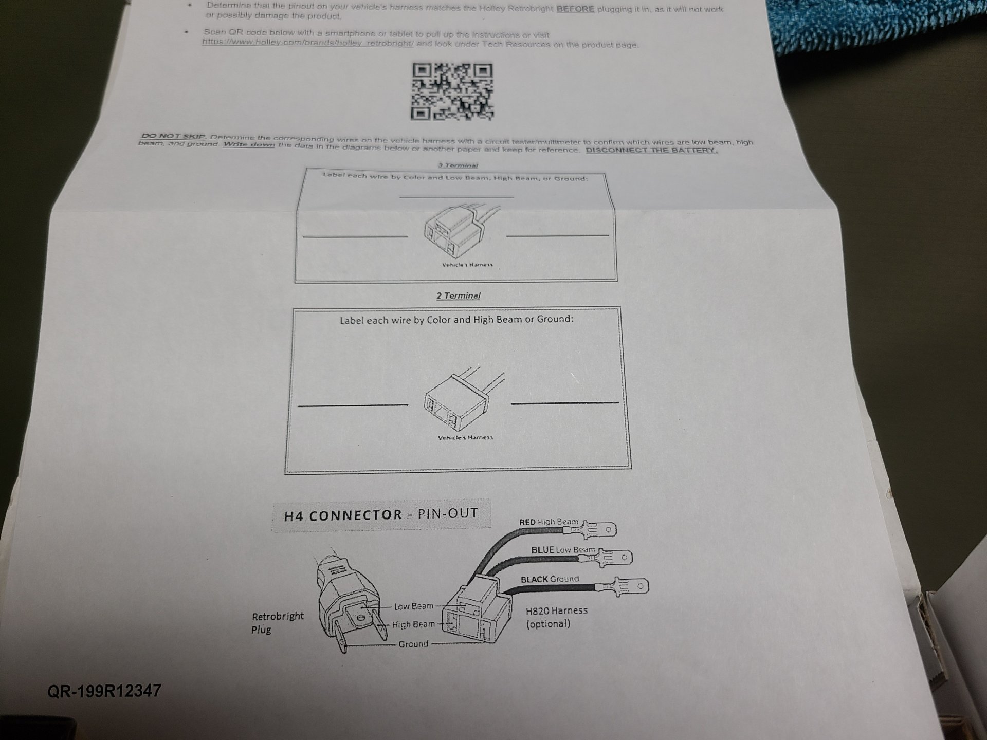

We just got our Holley squares in for a 62.....waited a long time for them to get here. We'll try to get them in next week. Not sure how the wiring will be but not overly concerned. These will be able to run as 4 low beams and 4 high beams which is pretty cool.
View attachment 3046497View attachment 3046498
Any update on this? Are you still planning on making a thread?
Haven't started back on that truck....I'll for sure do a thread once we get it into the shop. I'll link it on here. Maybe next week we'll have a look at them.
