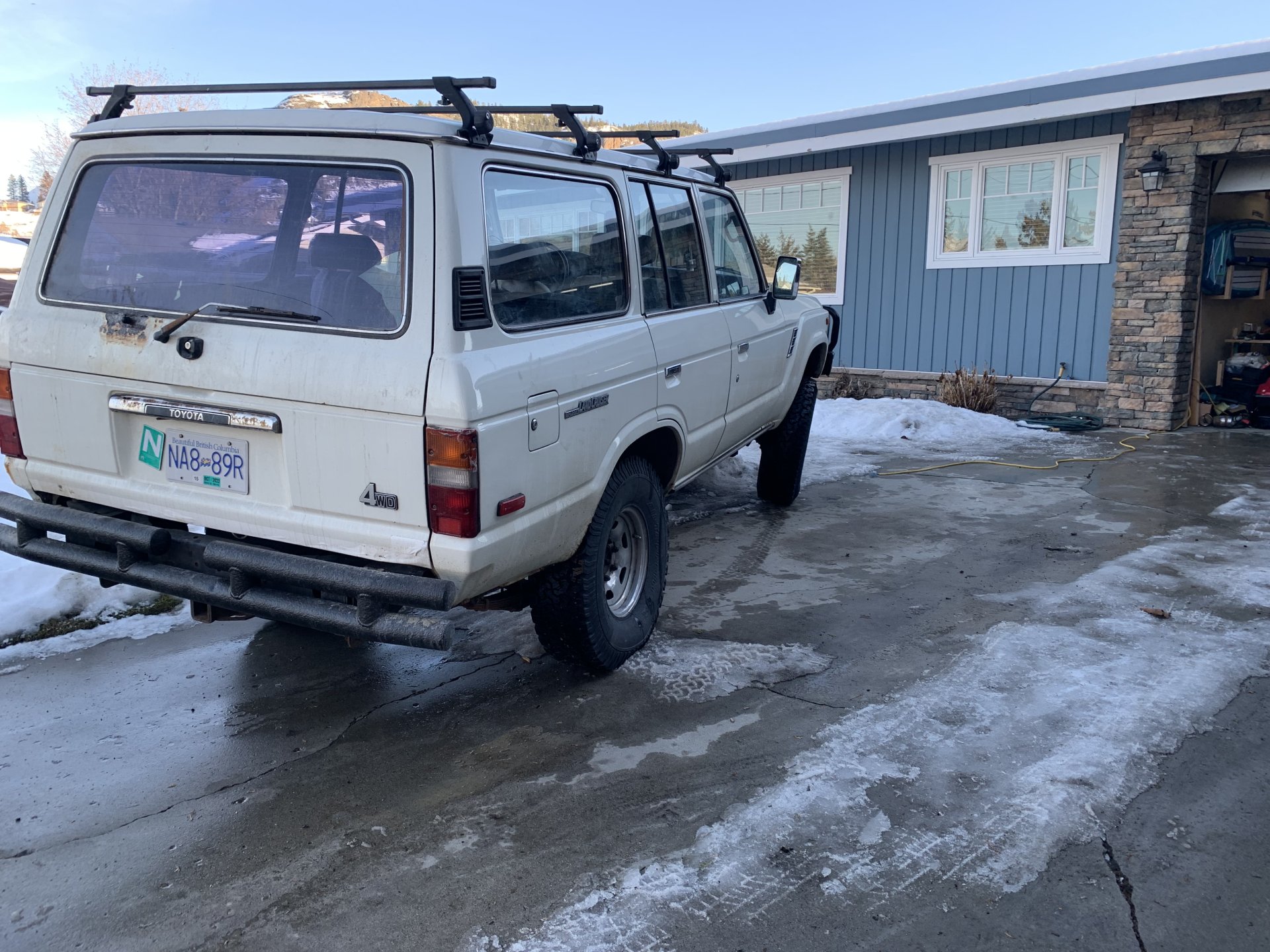

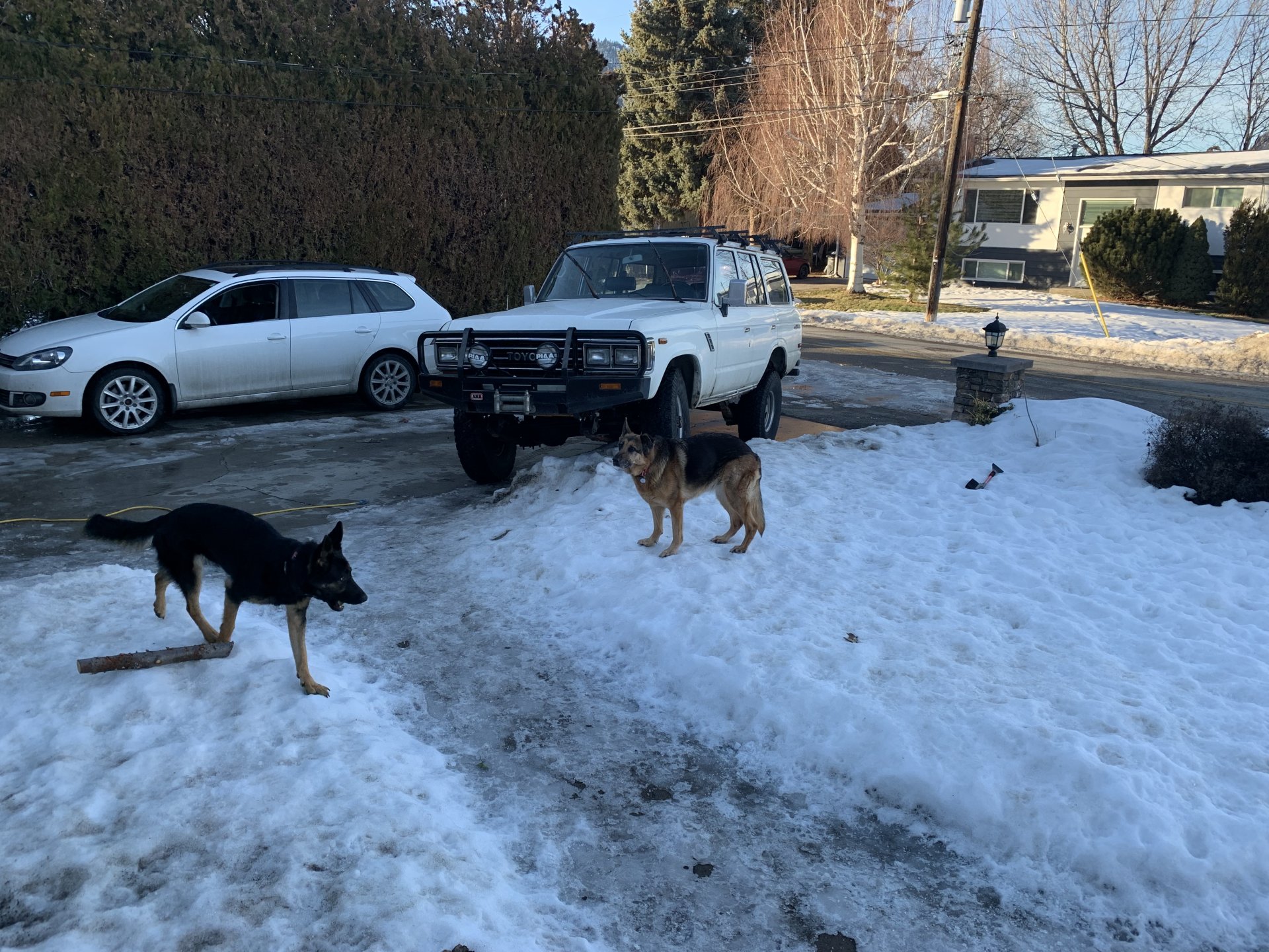

If I were you I would embrace the rugged looks of the FJ 62. However don’t go overkill! Throw on a ARB bumper and some aftermarket auxiliary lights. Roof rack doesn’t hurt…. Here is mine!

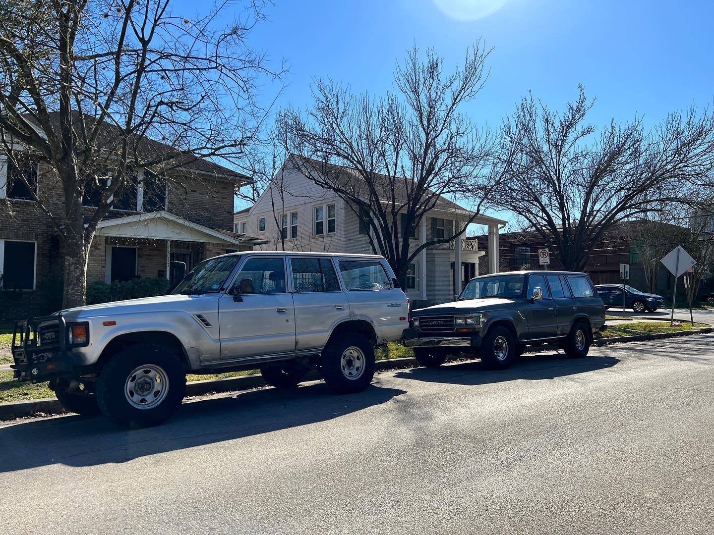

I’m in houston and I’ve got a semi built up 60 and a stock 62. You should drive the 60 before you decide what you want to do.

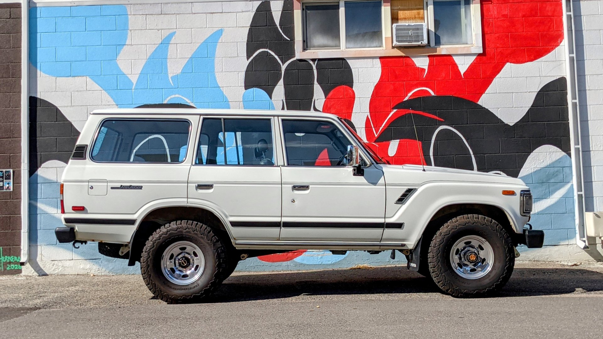

Mine on 33s with the stock height OME suspension
I really like this. I didnt know you could run 33s on stock height
I’m on 33s on my A440F…. It gets around pretty good.

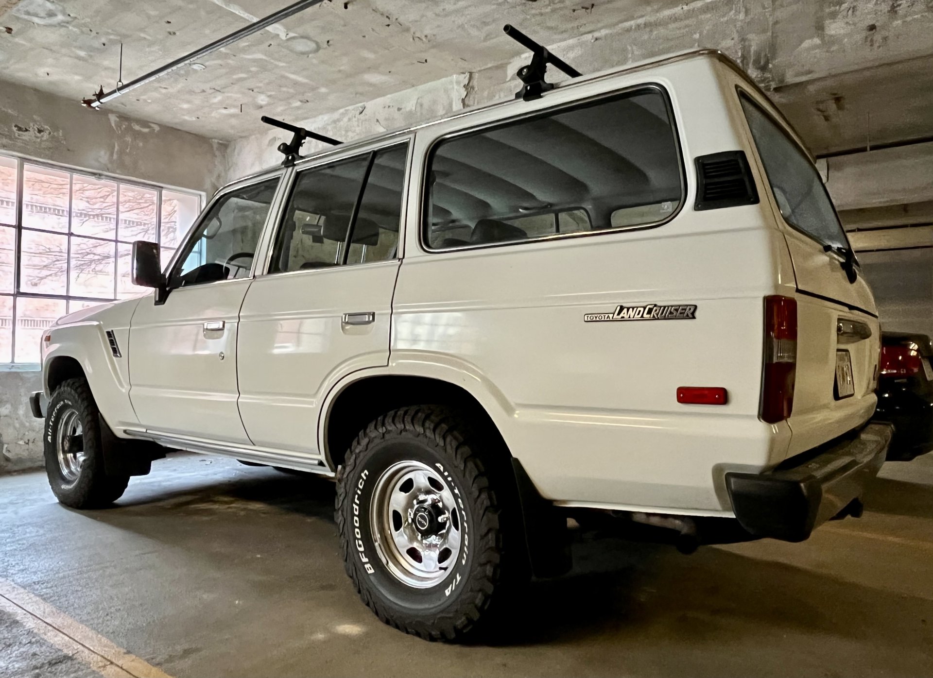

Put 31”s on it, maybe add a roof rack, but don’t do anything else other than baseline it and drive it.
Too many people throw a ton of sh-it on their rig then never do anything but drive it around town. They (the LCs and their owners) look ridiculous.
I bought a 1990 62, removed the after market wheels and huge old 33” tires, replaced them with OEM chrome wheels and 31” tires, refreshed a ton of mechanical parts and some other minor interior stuff with OEM, added some roof cross bars, and that’s about as far as I want to go. Keeping her 99% stock.
