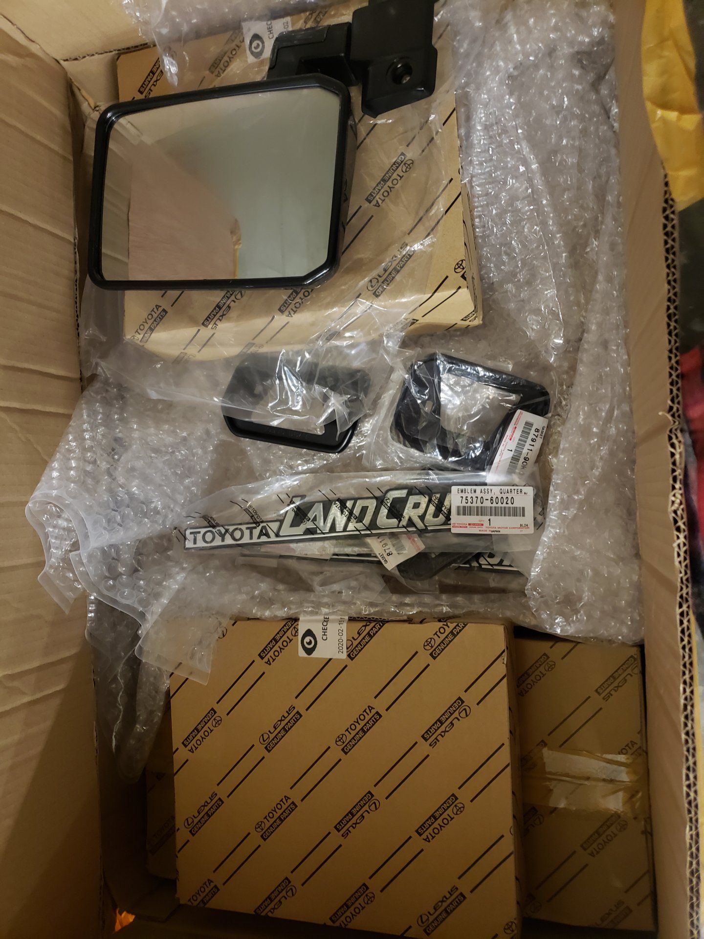

A few more goodies- quarter badges and 70 series mirrors for Chunk.
Also 3 more sets of the H4 upgraded headlight assemblies. Should have enough for all the round headlight trucks now.

Hey Pat are those black manual mirrors? care to share the part numbers? Are they same dimension wise as the 62 mirrors?
The mirror bases are not quite the same as the 62, the angle where it meets the door is sharper. I have seen them on a 6X before and they still look good. That said, I may try to mod them a little to make them fit tighter.
Here are the part numbers-
8791060142 (RH)
8794060372 (LH)
I like the look of them so I thought I would go for it. I have a set of 62 mirrors, a set of the 60 Euro mirrors, and now these so I have to choose but I think I like the 70 series mirrors the best.

what about 70 mirrors on 62 bases, is that a feasible swap?
They bolt right up, there is a tiny gap between the gasket and the mirror right on the door crease. I am going to mod mine in hopes of eliminating it but really it is no big deal.
I'll stick one on Chunk when I get home and take a picture so you can see how it looks.
So there is a bit of a gap with the mirror unmodified on there. It looks ok but I am going to mod up the mirror and make it more betterer. The gasket looks like it will conform in its present state.
