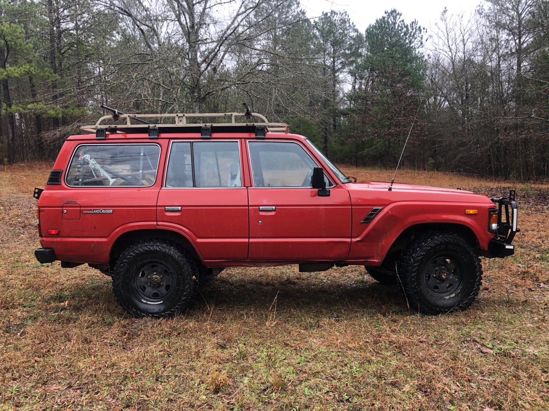

@Godwin, you put so many real use miles on your 60 series trucks you would definitely know how they work. I've seen your red 60 when we were at the Swine Soiree but would you mind posting a picture of it here so it is easy reference? Thanks

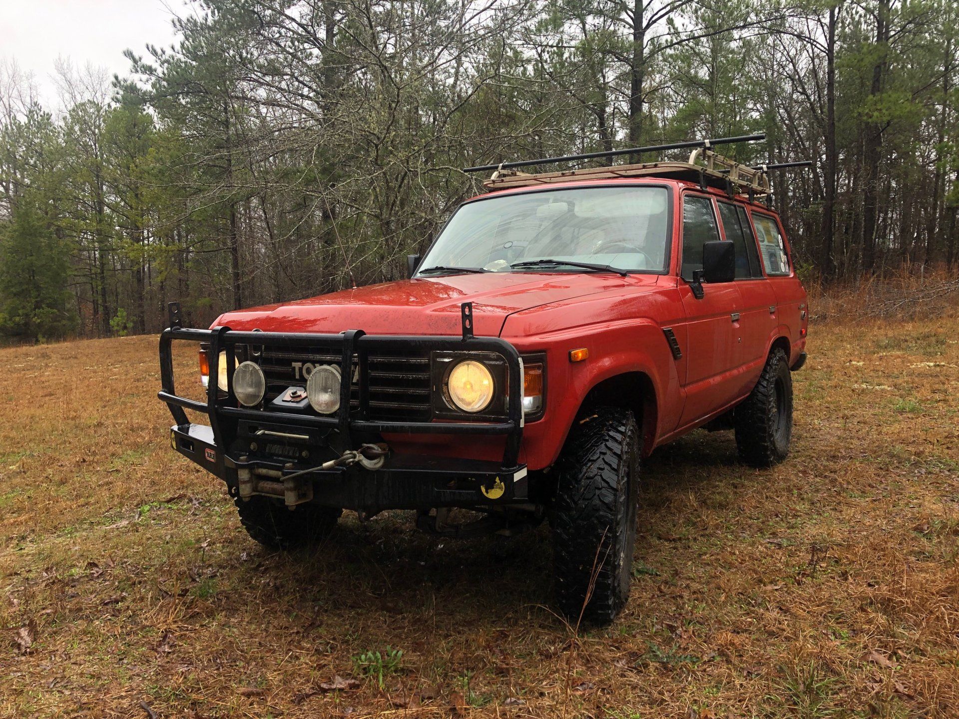

1986 faded red, 2F, H55F, OME heavy, ARB with 12K Warn winch, 70 series wheels with 255/85/16 Yokohama G0003. About 450xxx on the odometer, but on 2nd 2F and 3rd transmission. Rear axle is 80 series with e-locker, front axle is FJ62 with Tundra brakes. Body has a few dings, scrapes, and dents from where and how I drive.
Lol that’s pretty true. My mileage is still bad by todays standards, but my average since rebuild is 19.2mpg and that’s mostly winter so in land cruiser world, it’s awesome.
i Bet you will see similar with the 12HT.
I also like those 70 series mirrors. I have smaller ones for the 70 series And they are ok, but I would rather have the bigger ones.

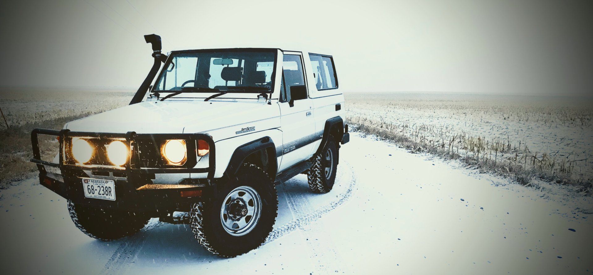

Luckily I have 80 series steel 16" wheels for my HZJ73 via @joekatana . Those are getting 35's. That'll free up the 70 series 16 inchers for Chunk. Tall skinny will look proper on it.
