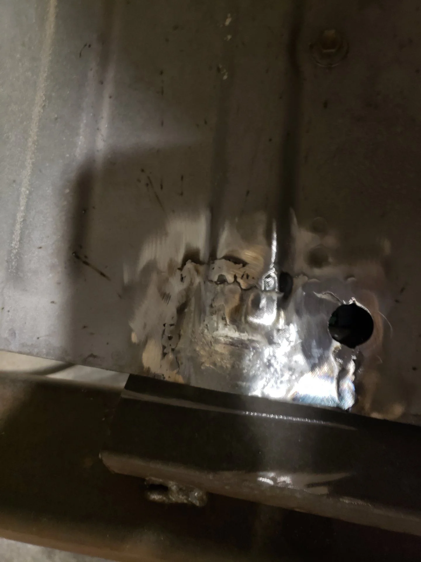

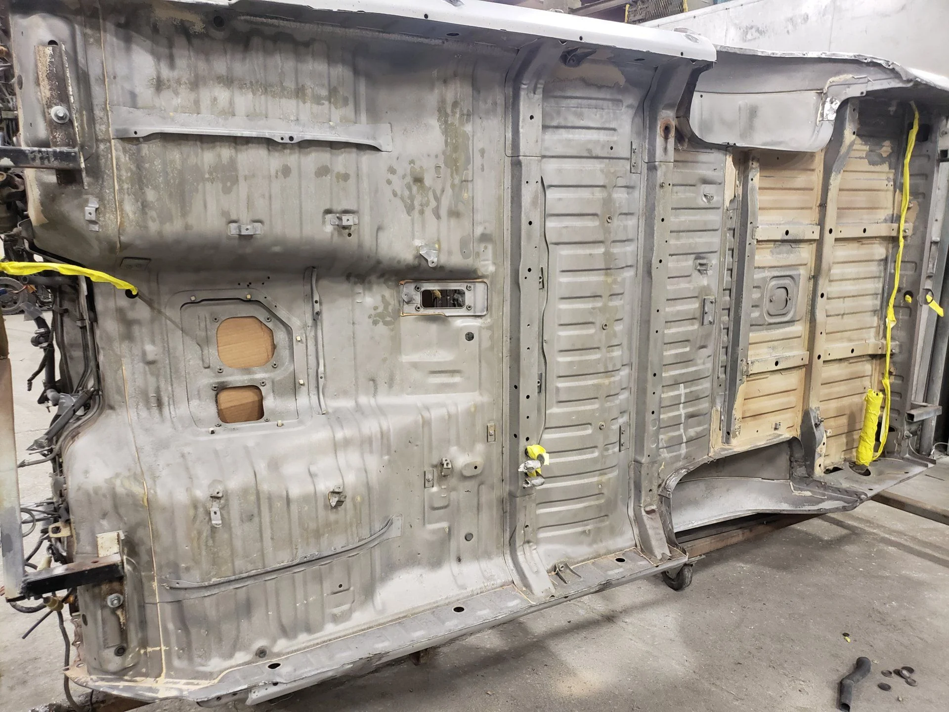

I finished all of the patchwork. I had hoped to put epoxy primer on the bottom of it but ran out of time. As soon as that is done Chunk will head for the home shop for the bodywork.

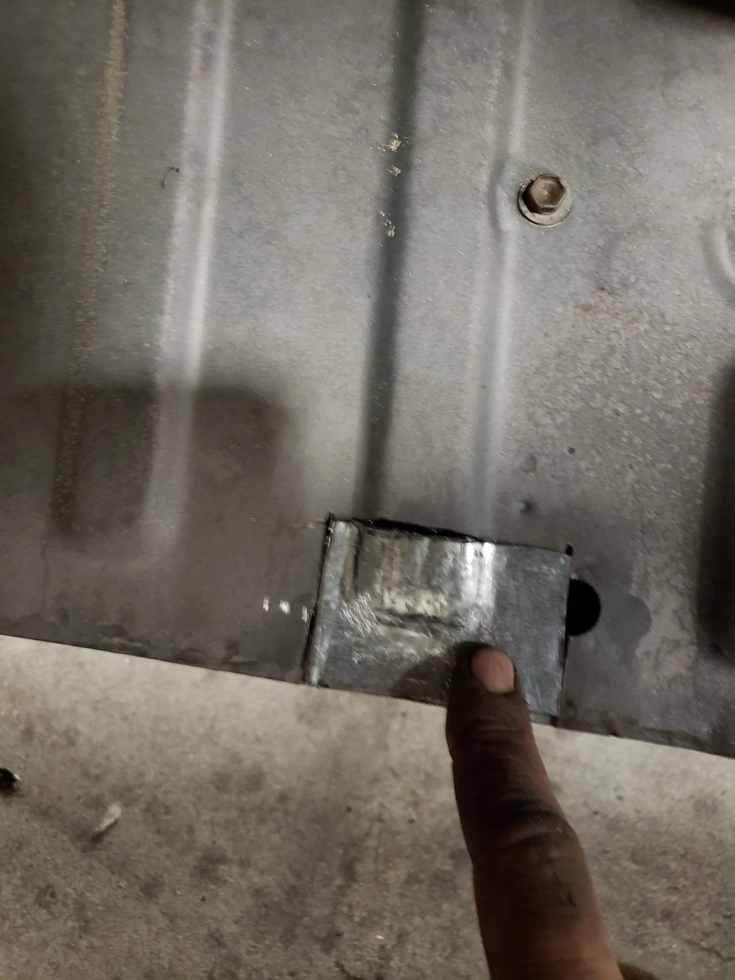

Making this little patch was kinda fun. A little time with a hammer and dolly.

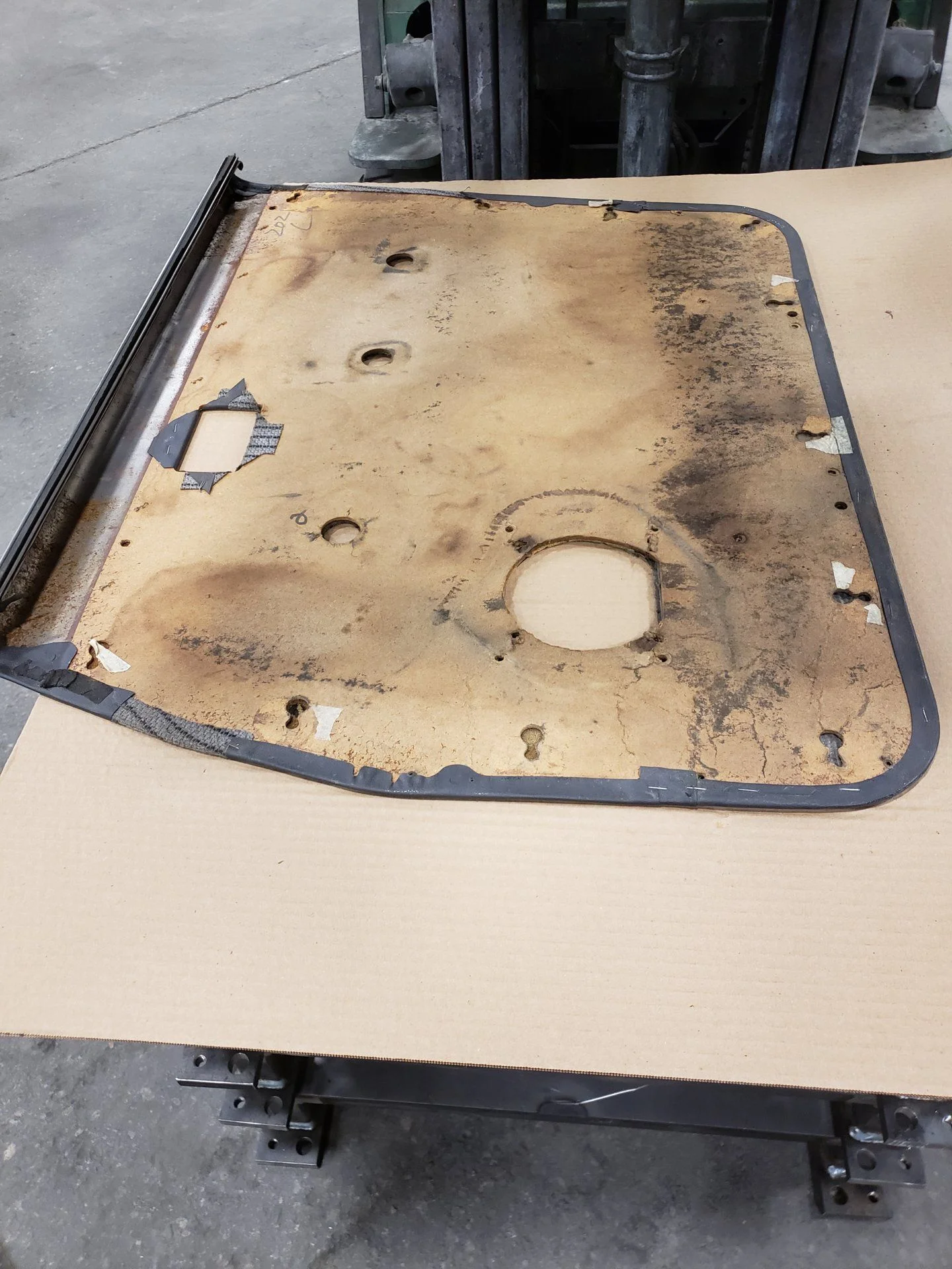

I also did a little experiment with fixing the warped door panels. The plastic was missing so they got wet and warped up pretty good. I used a spay bottle to soak the back of the panel to get the board almost soggy. Then I sandwiched the panel between some heavy tables at my shop and put them in the oven at 190° for about 1/2 hour, then shut it off and left it in there for a couple more hours at around 100°. I took a sneak peak/picture but am leaving it sandwiched til tomorrow. I'm going to need to reinforce it later as the backer board is pretty cracked up from flexing. Some sort of glue layer I'm thinking
Came out nice and flat
Prepped the bottom of the truck and shot a coat of epoxy primer on. Next step is to get the body home to start prepping for paint, while the frame/driveline gets ready for paint/powder coating at my shop.

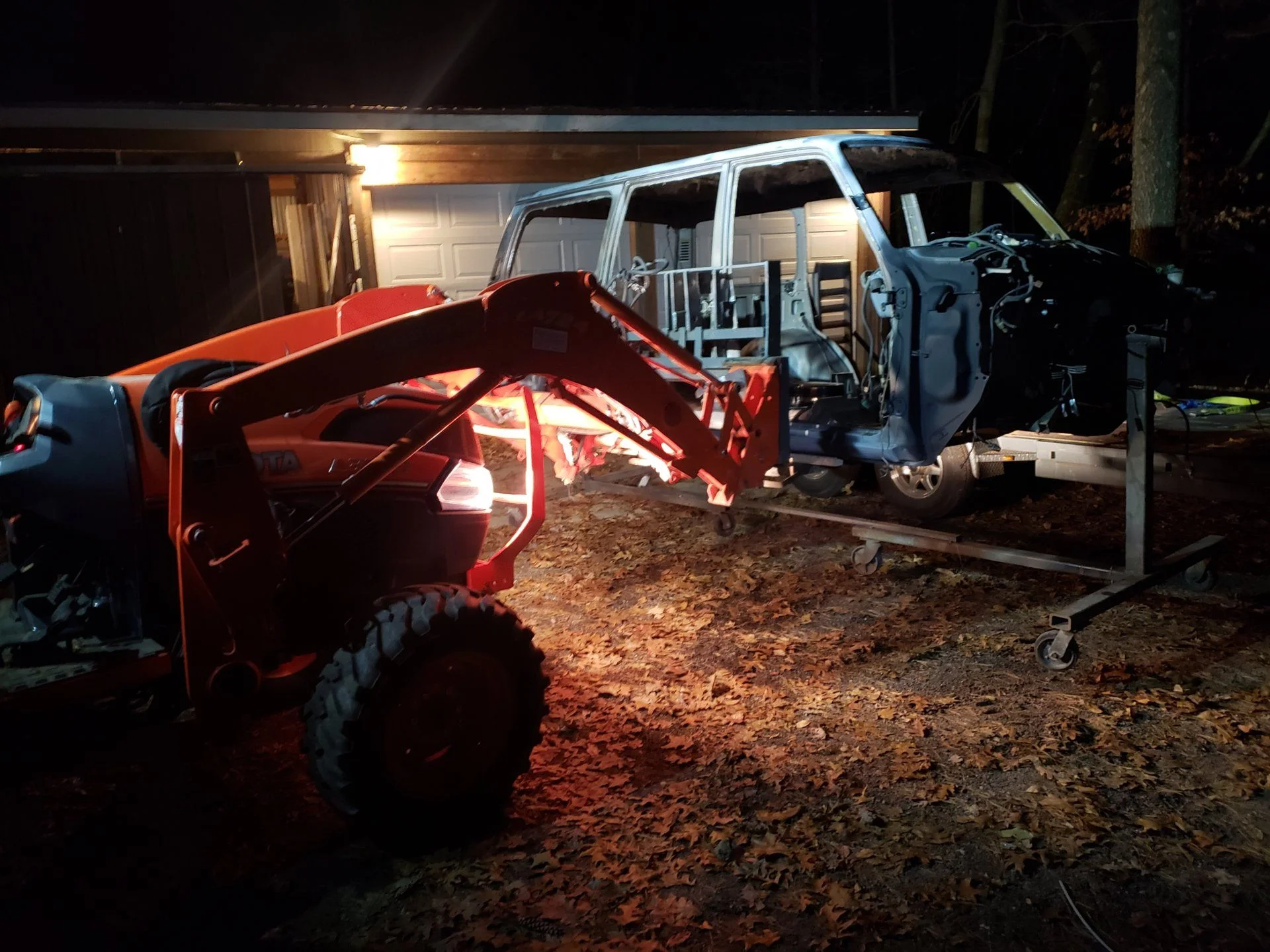

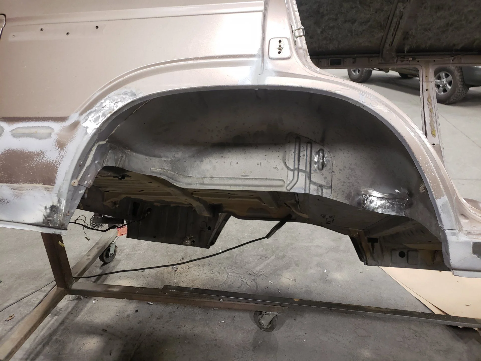

I hauled the body shell home after work and got it off of the trailer around 9:00. My tractor barely picked it, but did. Now on to bodywork and paint prep.

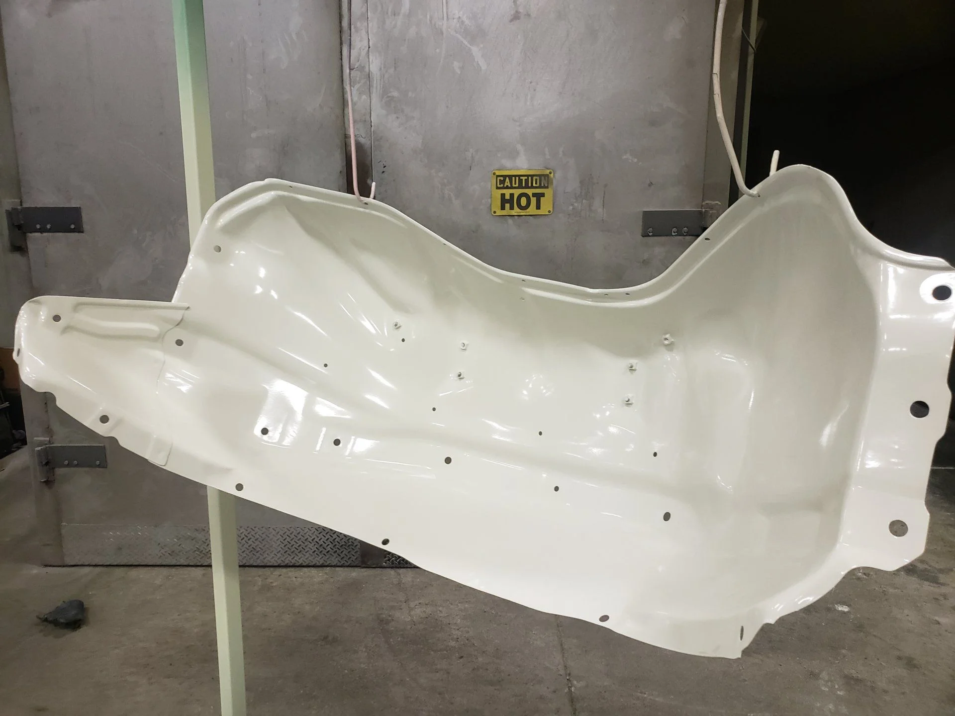

I didn't like the look of the RAL 9002 on its own as it really needed a touch more cream-off white to it. RAL 9001 is too creamy but mixed in at about 30% it make the color super close to my paint sample. This should work well for the inner fenders, rad support and other things like that without noticing the mixed colors.
I did one inner fender as a test. Epoxy/zinc powder primer with a double layer of the topcoat.
Envious you can powder coat a semi if you wanted. Hehe.

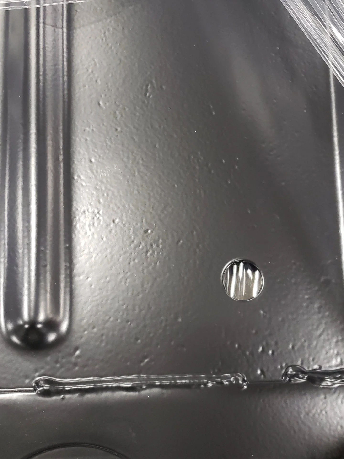

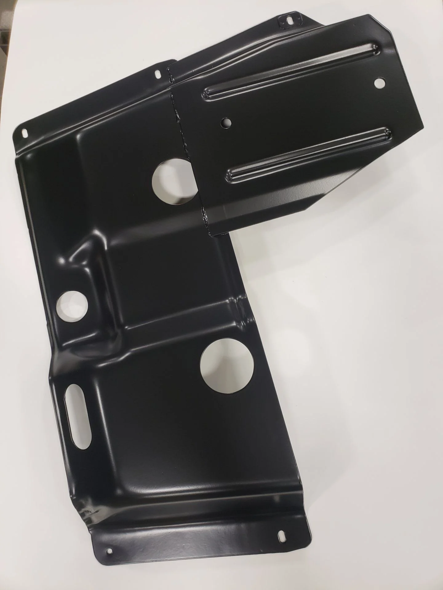

I powder coated some 80 roof rack parts this morning and switched to satin black for a test for gloss and finish on Chunk's skid plate. You can see in the close up of the inside of the skid plate what even a little pitting looks like and I am going to try to make it nicer than that.
On the outside I coated it once, sanded it flat, then hit it again. Not going crazy but just using a DA sander and 150 grit to flatten it out before recoating. Worked pretty good. This is what the frame will get.

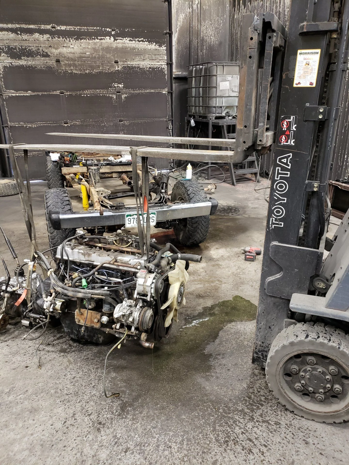

Old 2f/4speed out. Thanks for hauling Chunk around since 1987.
