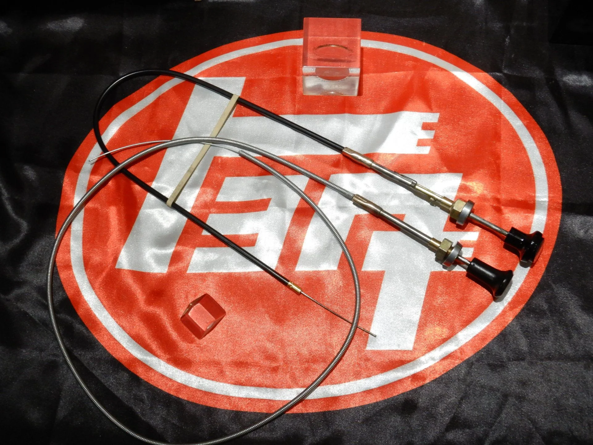

Choke cable variations

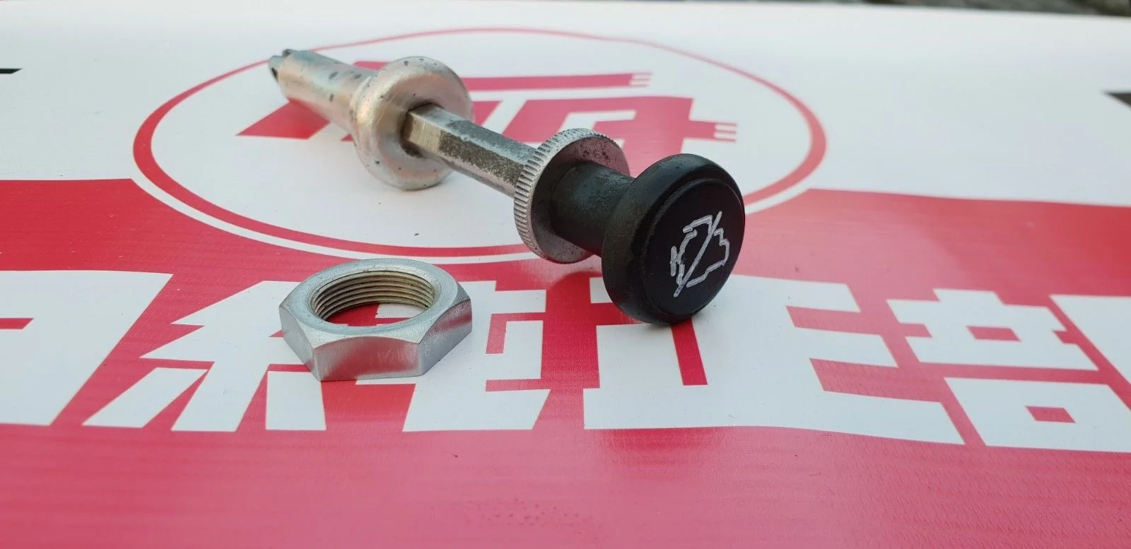

FJ55 had the 2 drops version at one point early on .................o_Oo_Oo_O
Looks like THREE to me. ;)

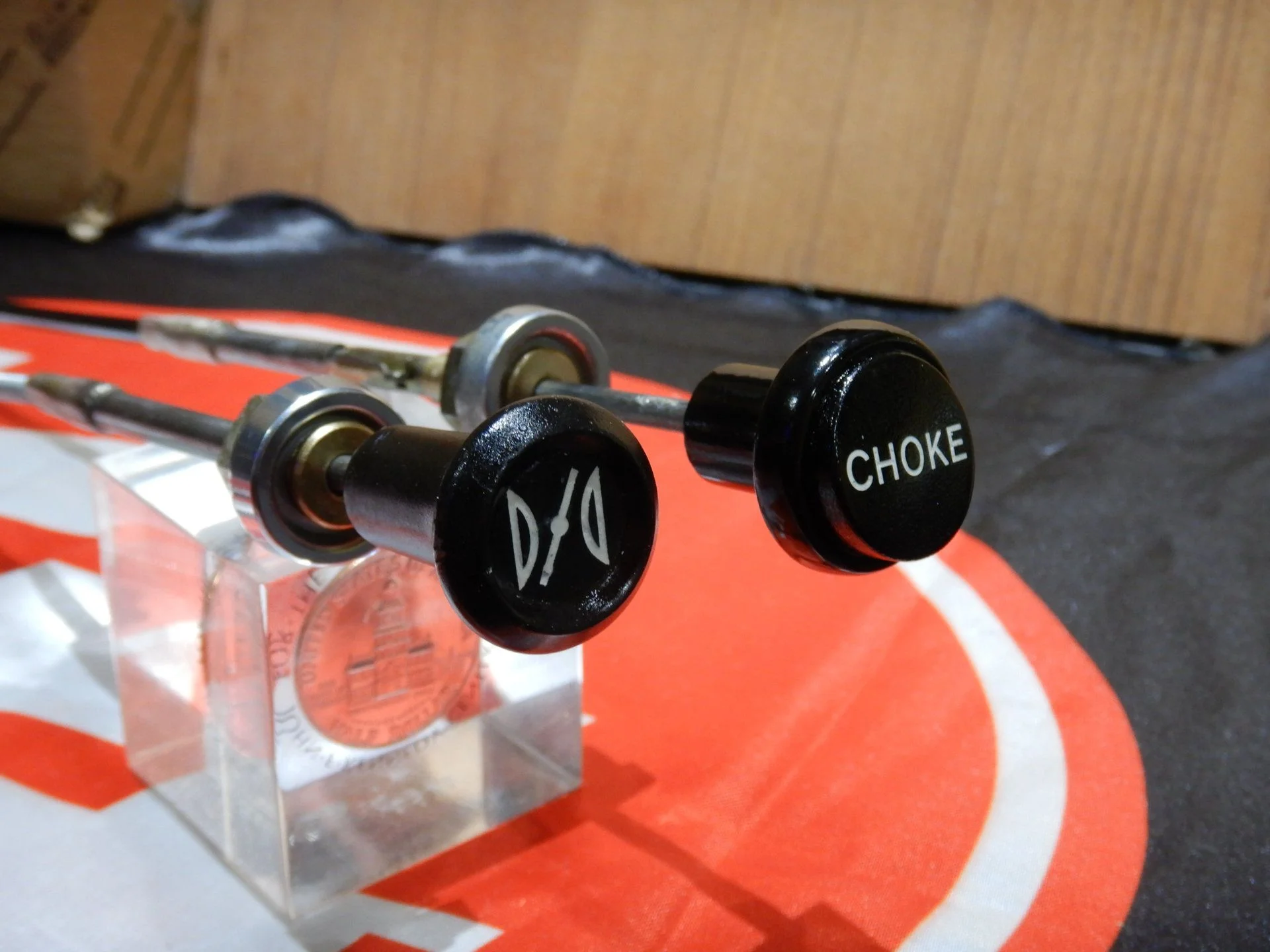

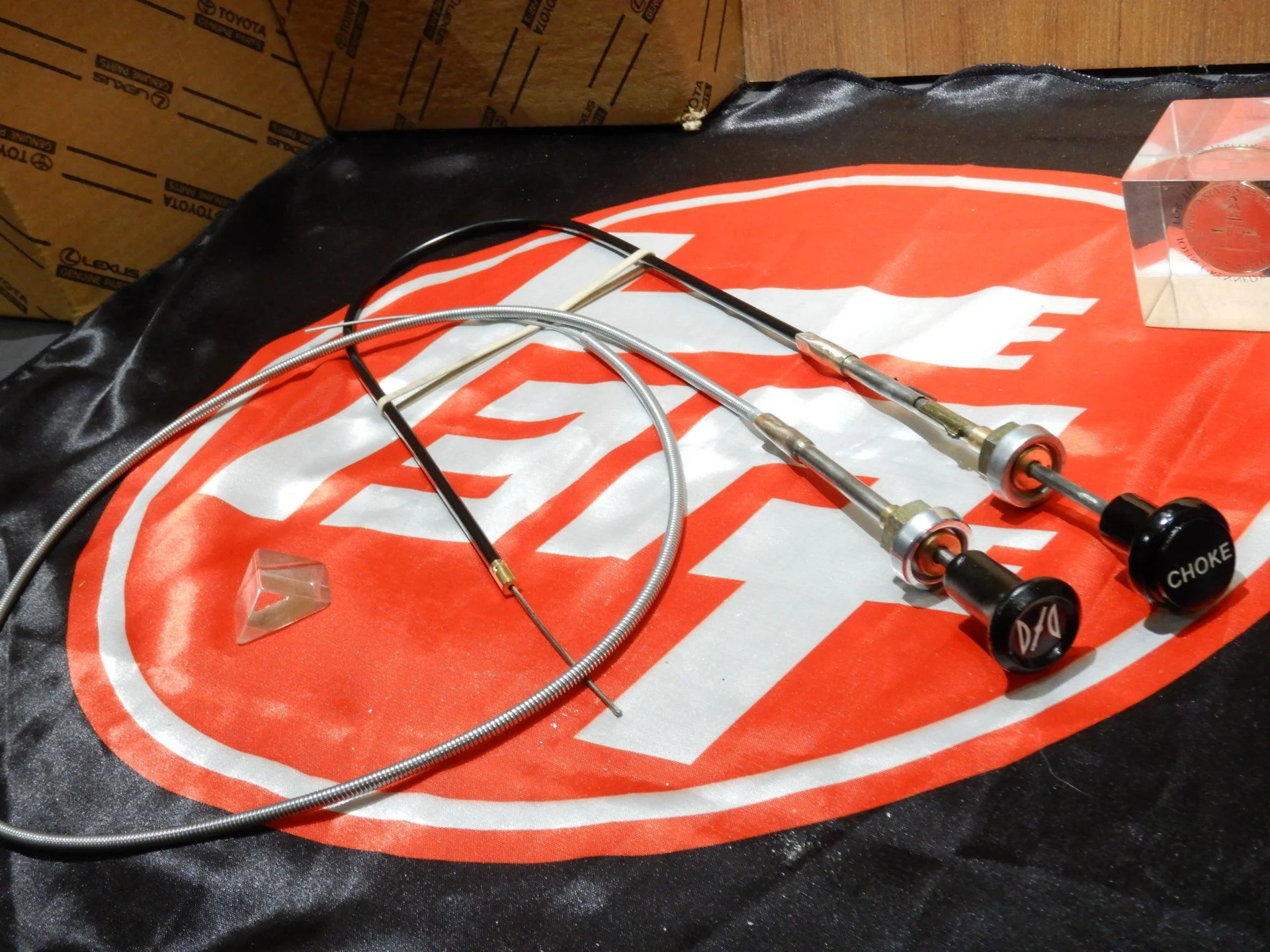

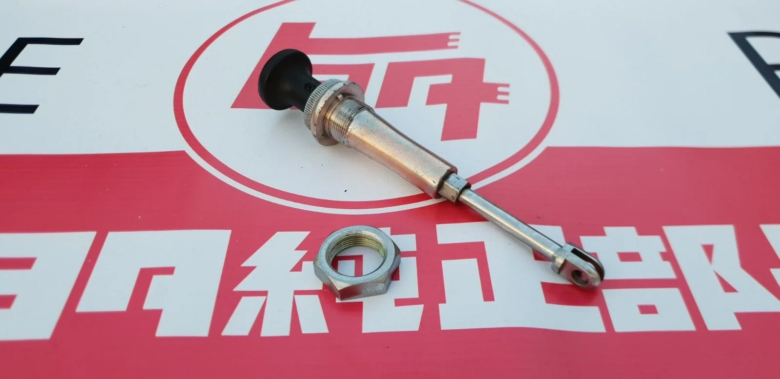

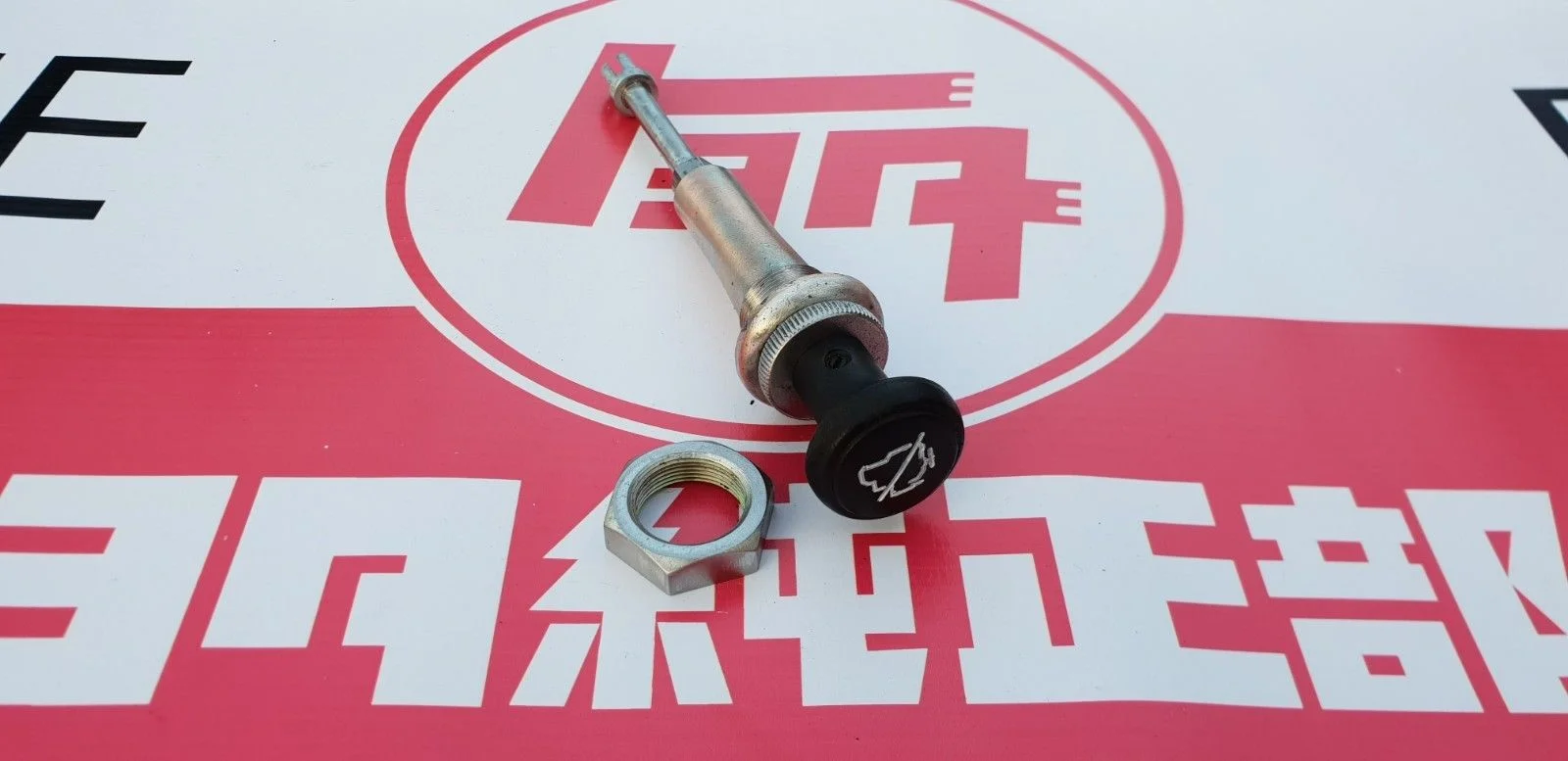

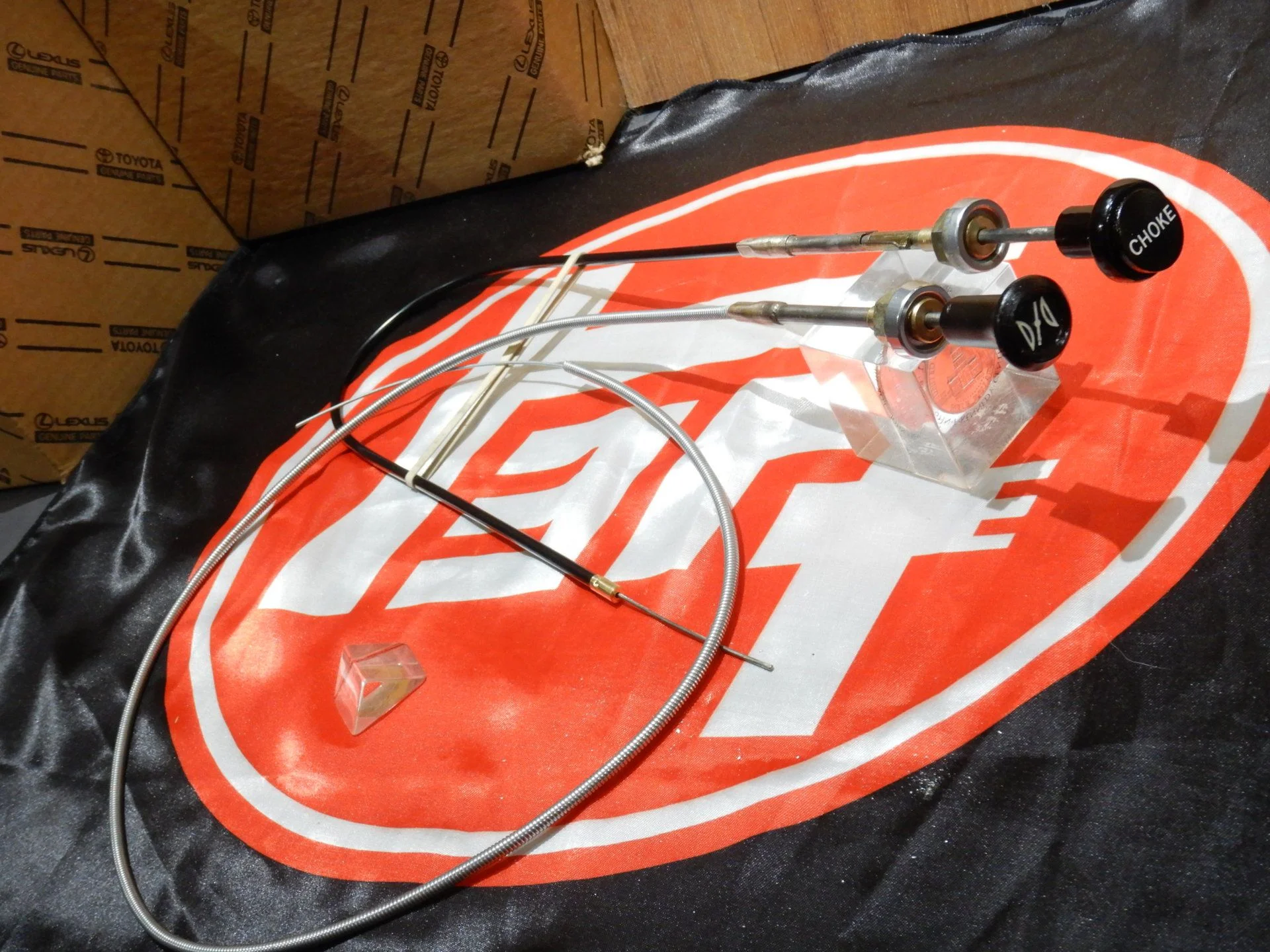

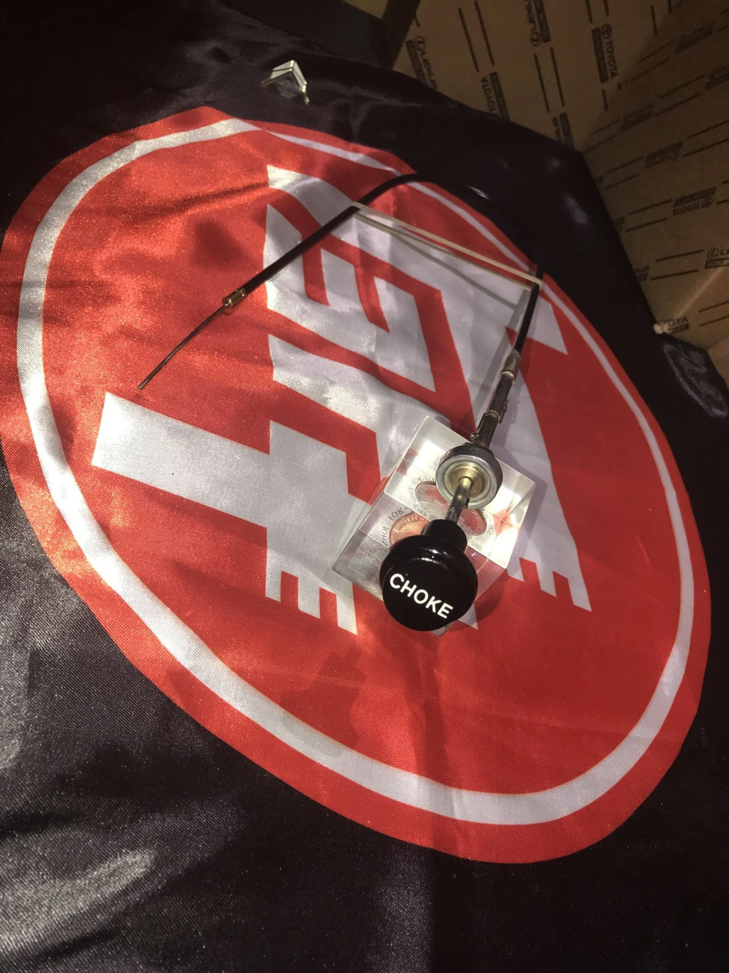

@65swb45
- 1969 FJ# ? choke cable
- 1976 2F Fj40 choke cable
- Both Fully restored over course of 3 work days
- all usual Restore techniques applied and used
- Everything done The
Traditional Toyota Way , By hand , By Me with Both Care & Concern to Period Correct Details using Original & Advanced Materials and JDM Workmanship Techniques

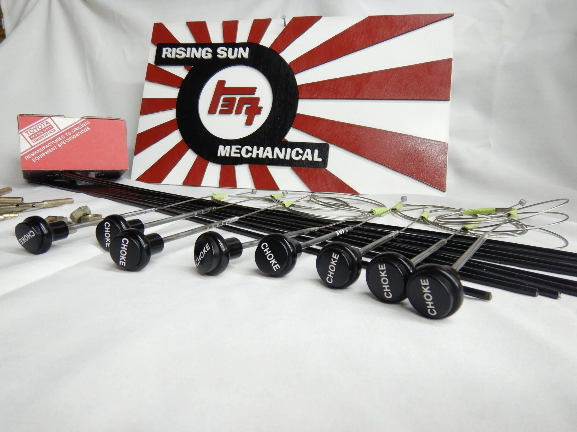

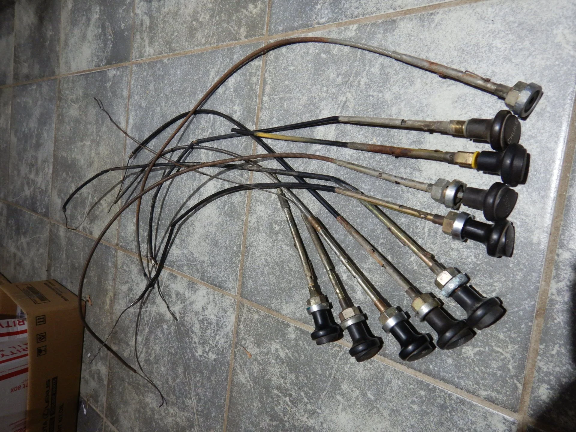

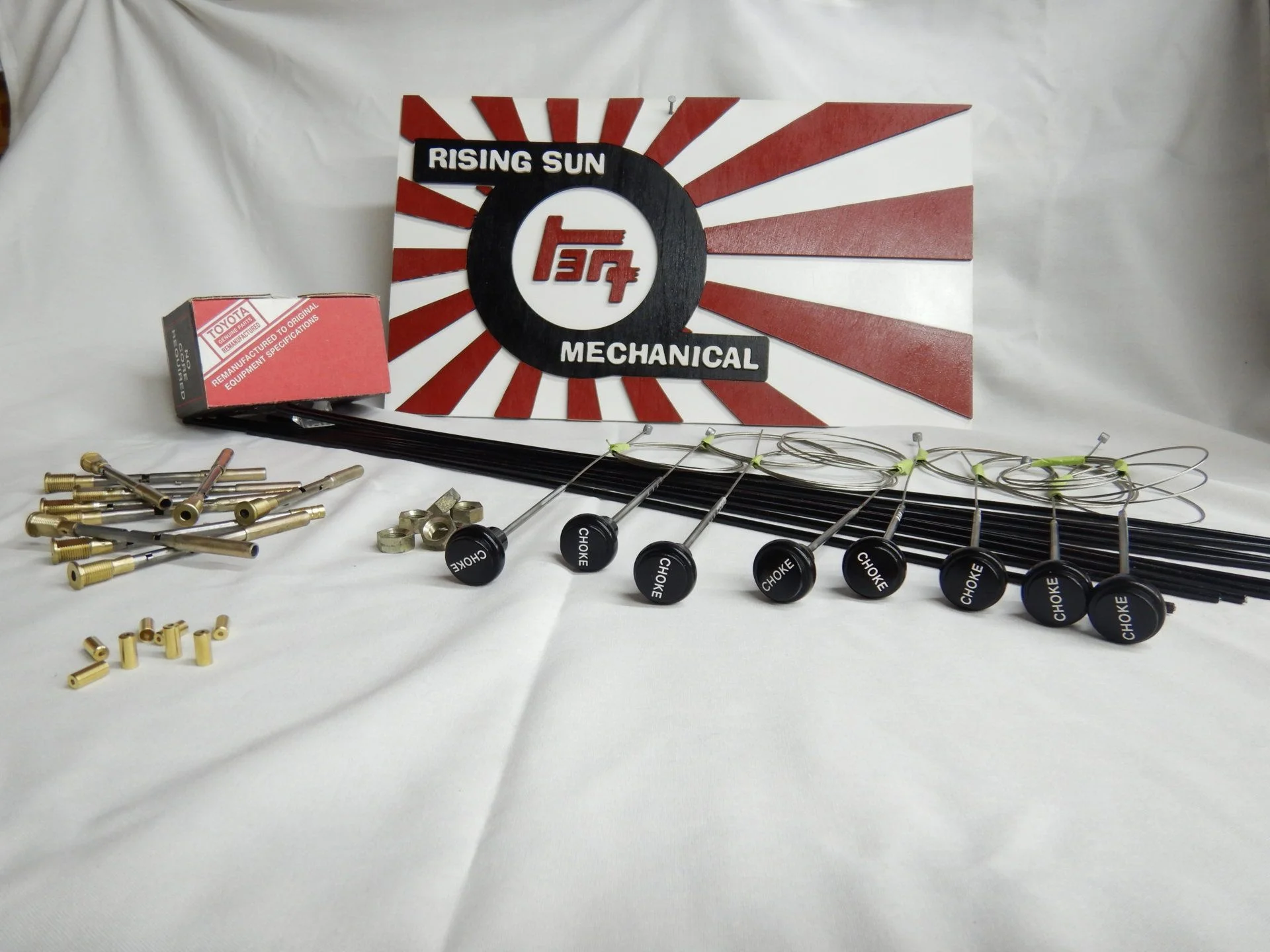

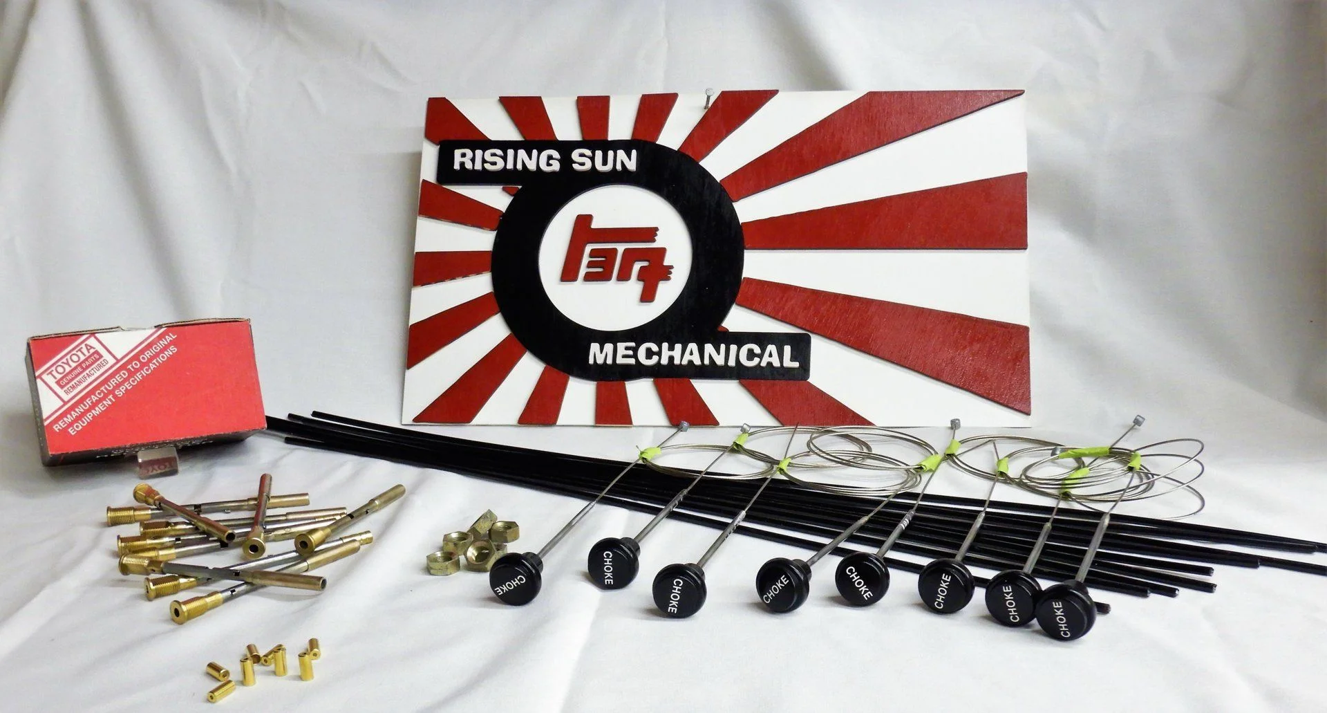

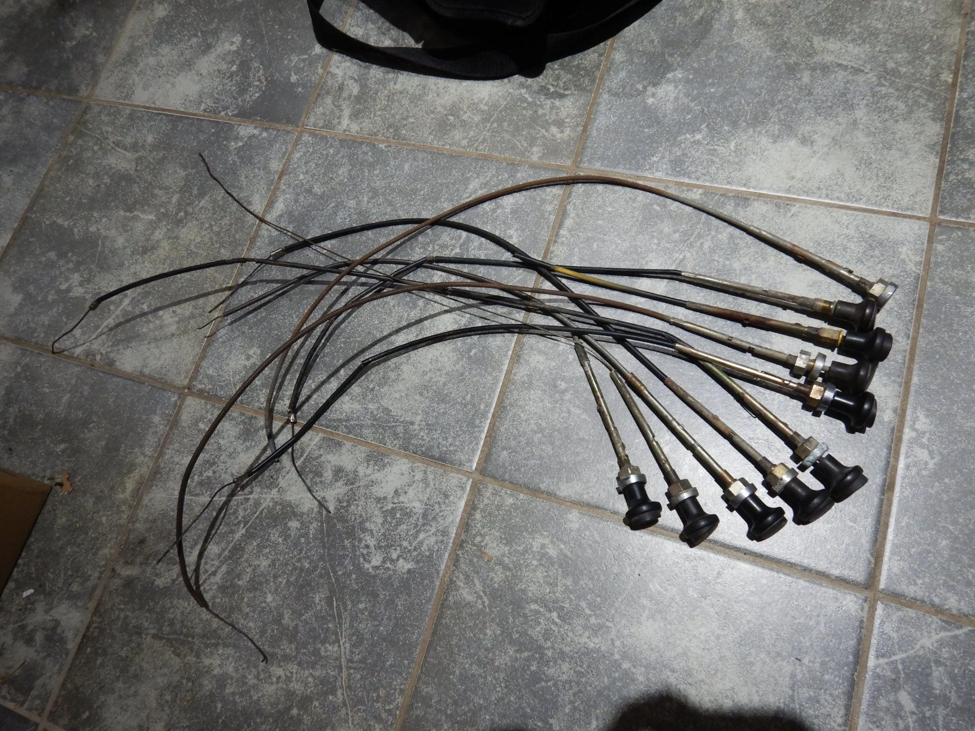

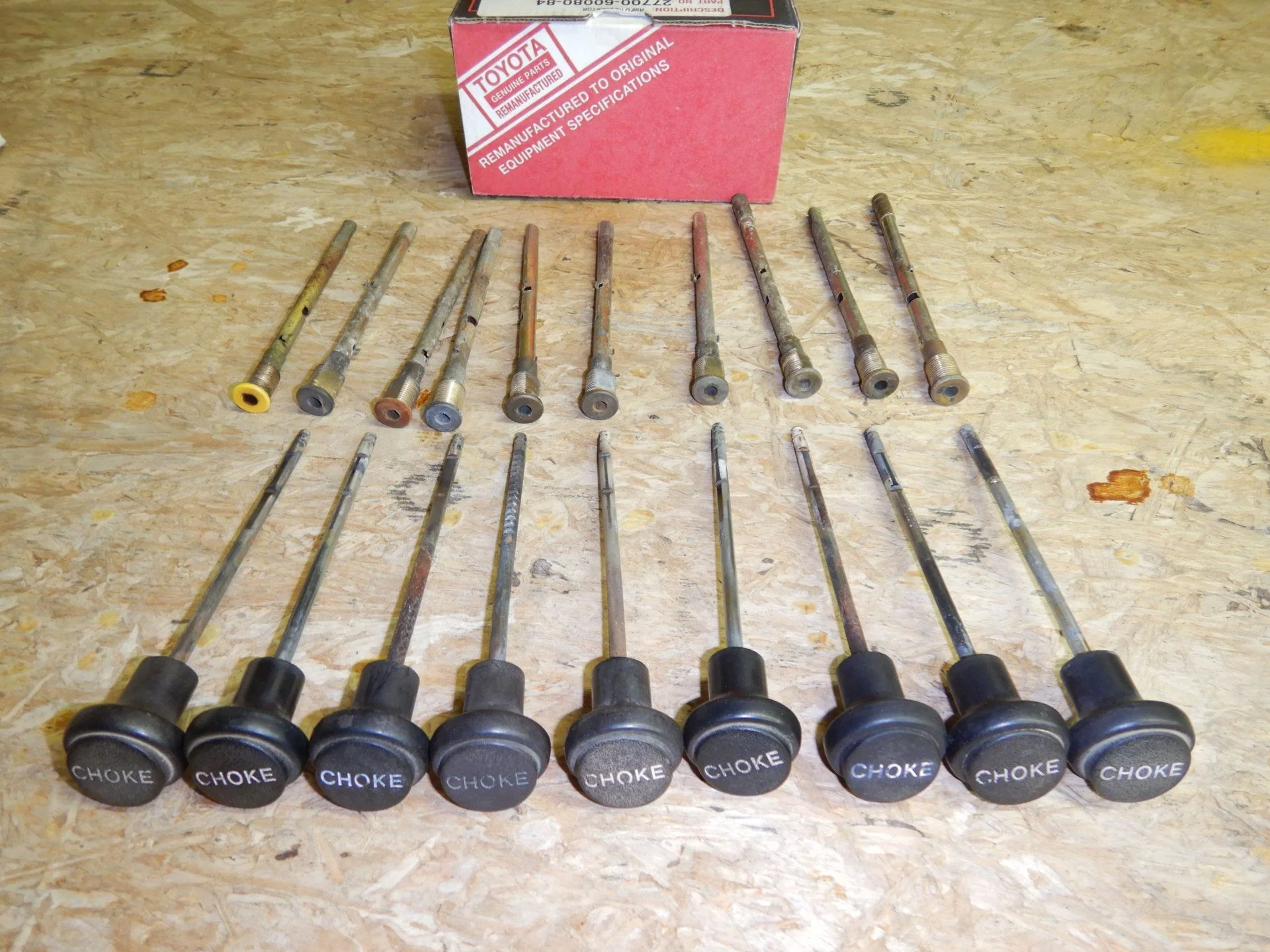

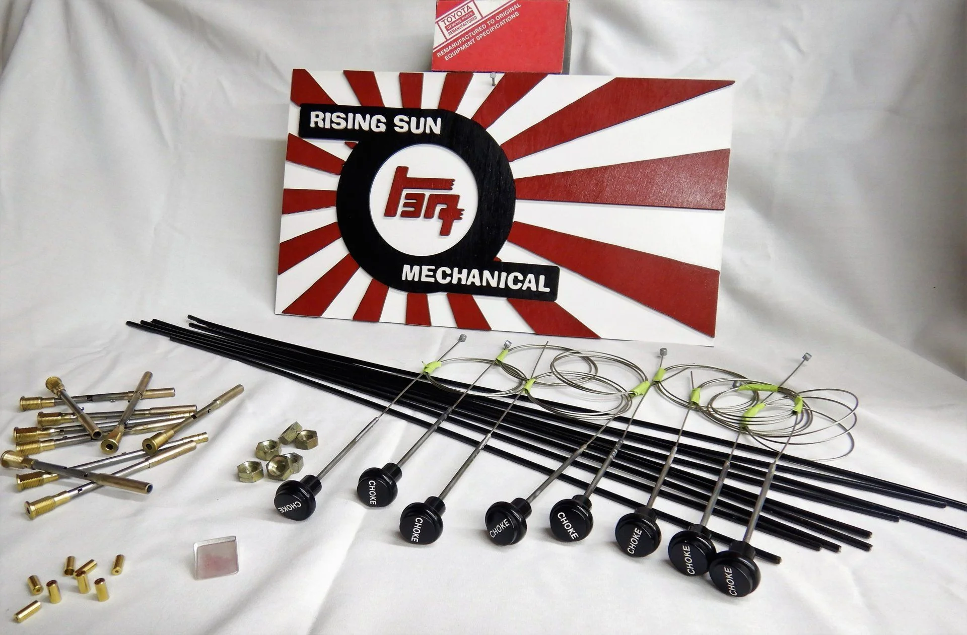

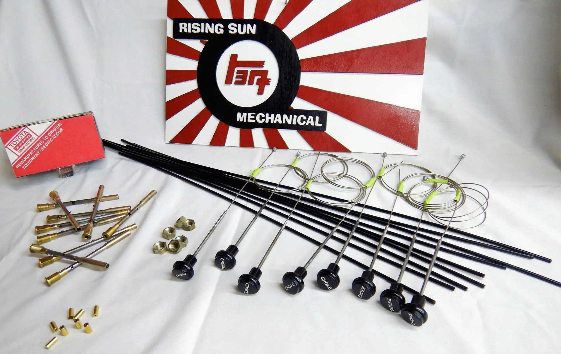

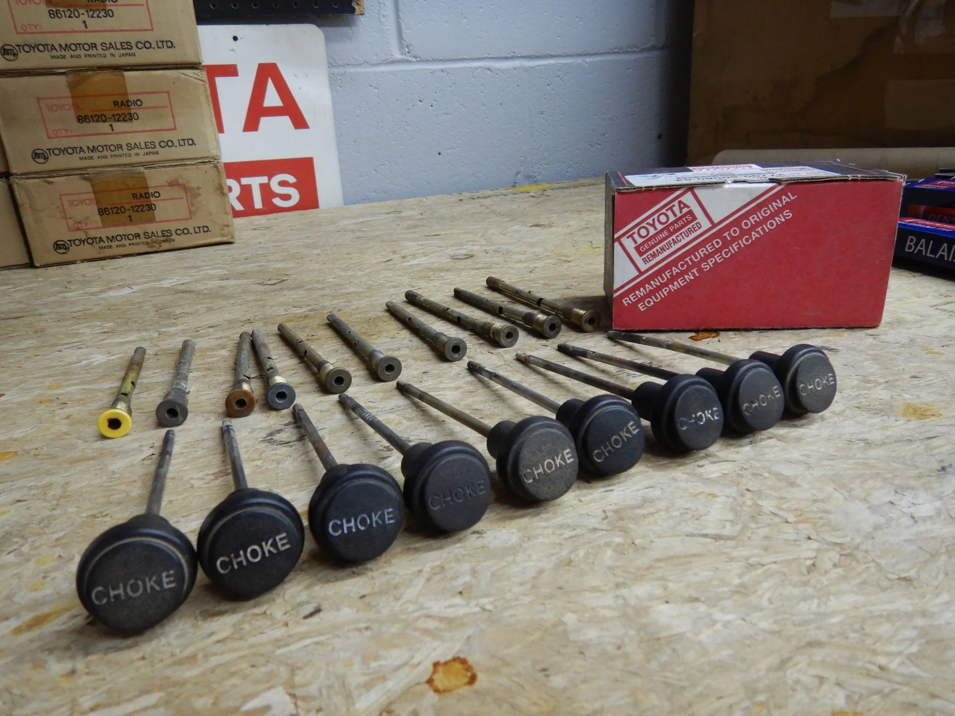

Another Batch of Late 70's - Early 1980's 2F Based Choke Cable's , I tried Taking On x10 @ a time in efforts to help keep things
at The Rising Sun Mechanical " Skunk-Works " running Efficient as possible

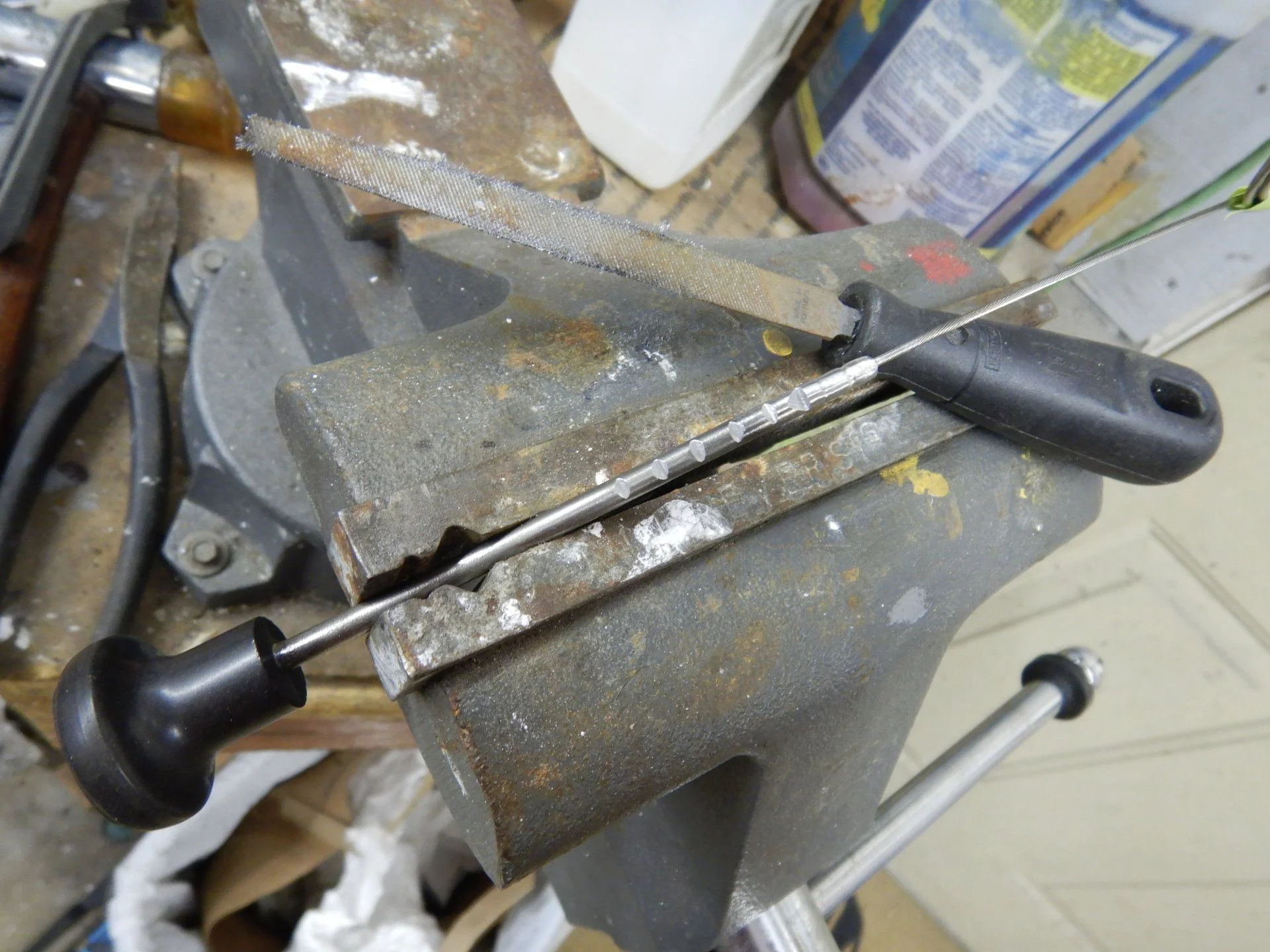

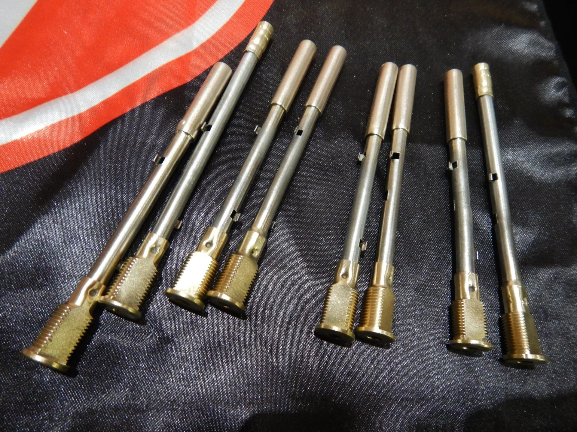

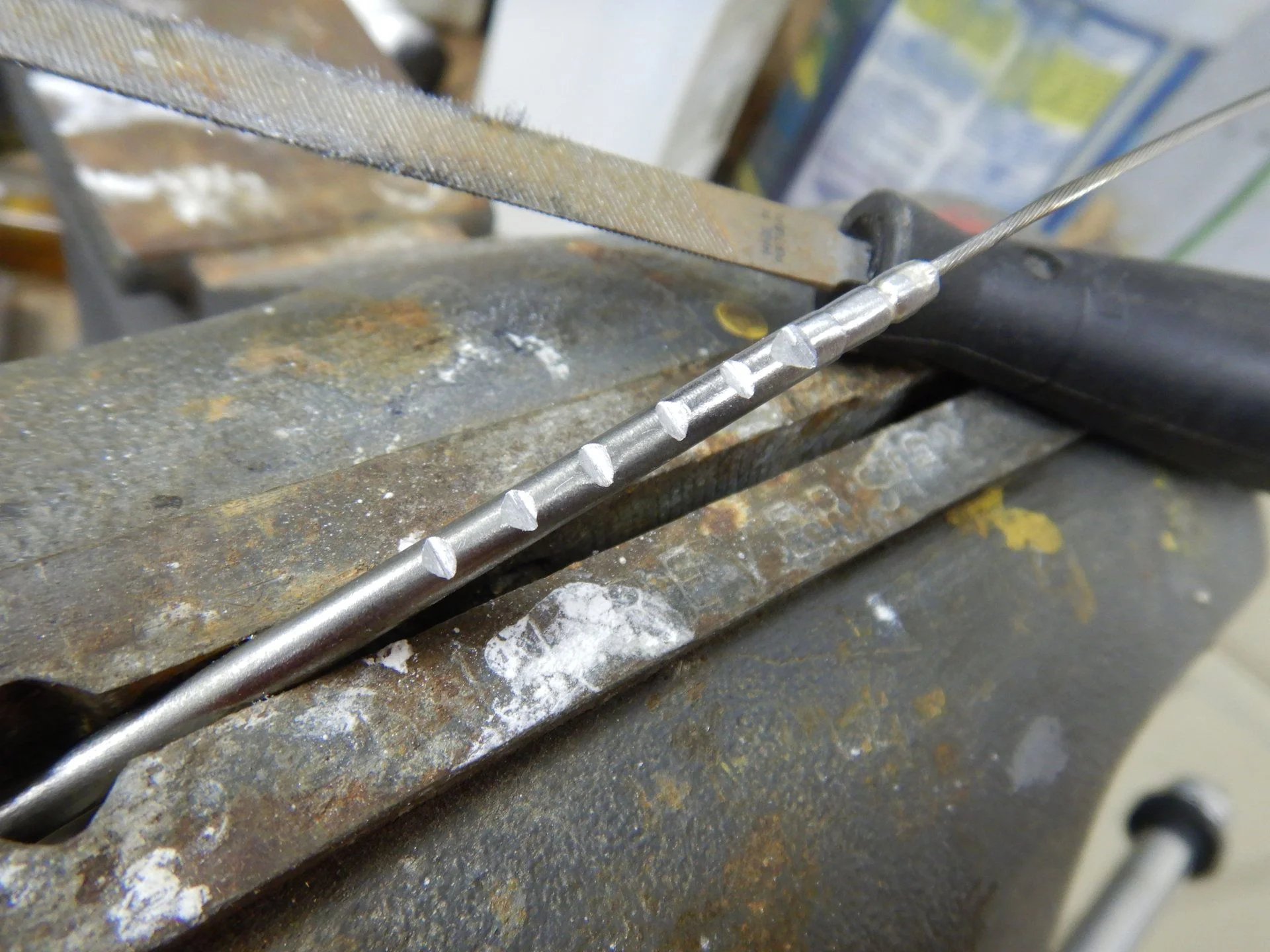

- I Hand-Dressed Additional De-tent Stops as usual for a More Metered Precise Precision of the Choke & Warm Up Cycle by the
New Owner of My Cable's ,
- This , in addition to Saving Fuel , Cutting Emissions, will Reduce Harmful International Engine Deposits for the Life of the Engine
or Choke Cable ( witch ever comes first ) when the Choke Is Left on For Too long Because of a Un-Planned Cell phone call distraction ,
or Nagging Significant Other 🤣

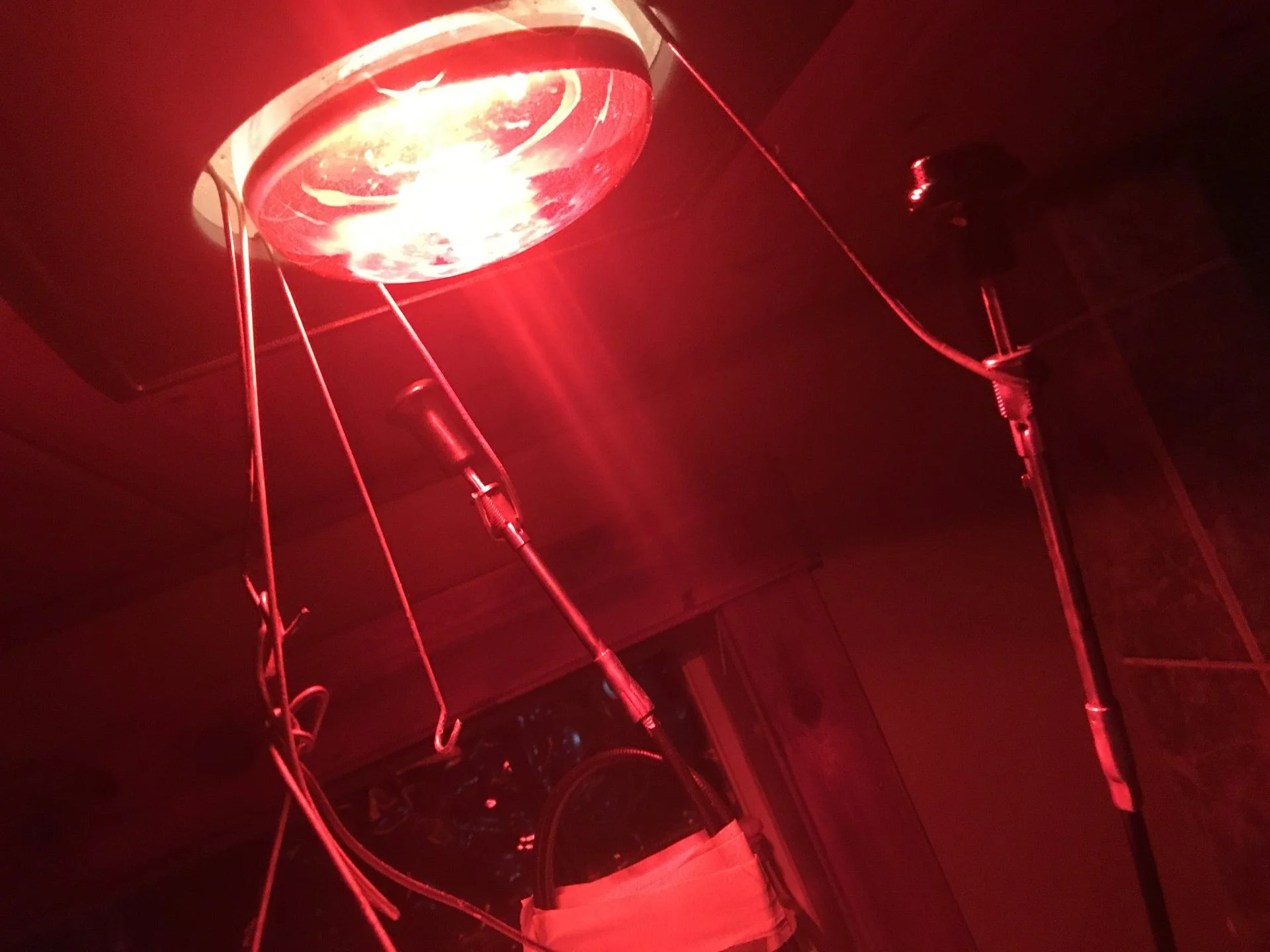

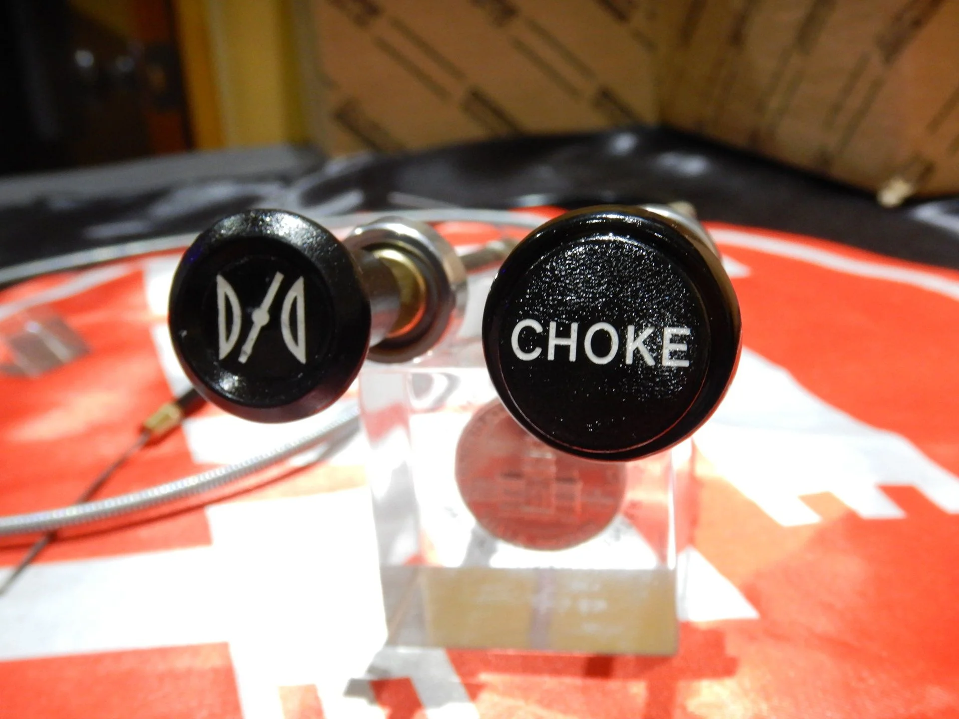

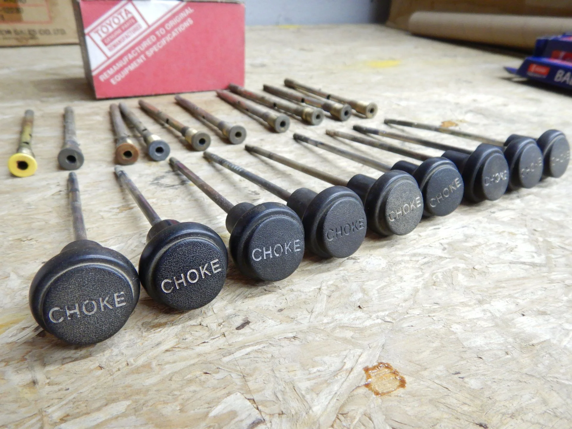

- I now apply 4 individual coats of White Pigment in the The Text Font Logo area , this Really brings the White Pigment to the surface
flush with the Black knob face and actually makes it ever so slightly Bolder in appearance . i think this is a KILLER-KOOL side effect
, while keeping true with the Period Correctr font style itself .

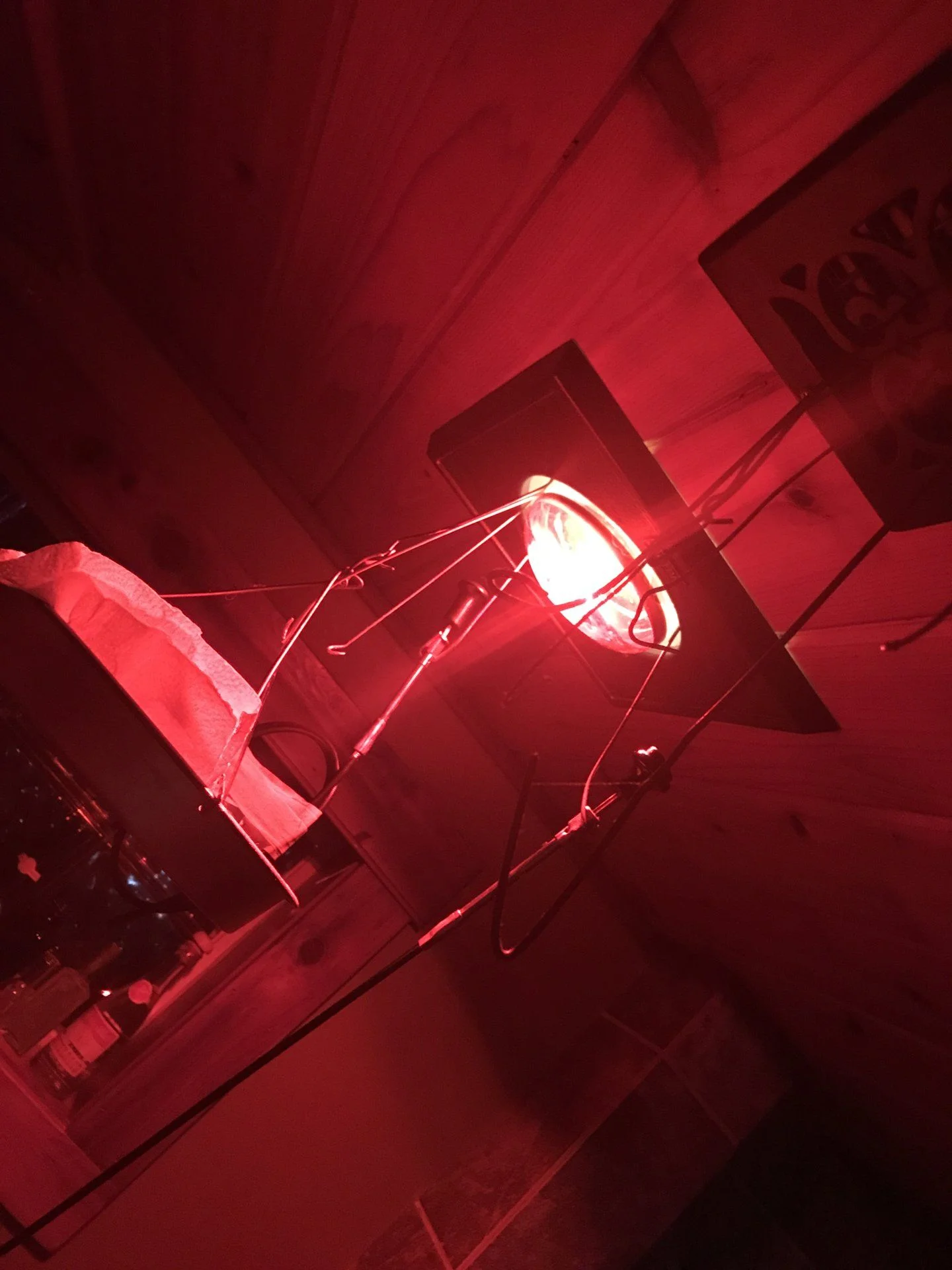

- Practically speaking , the additional white pigment forms a more Heavy Duty Bond to all 3 sides of the original , Text/ Font Groove
Marine Grade Low Luster 2-part Clear Being Long-Term Low-Temp Baked on ..............................

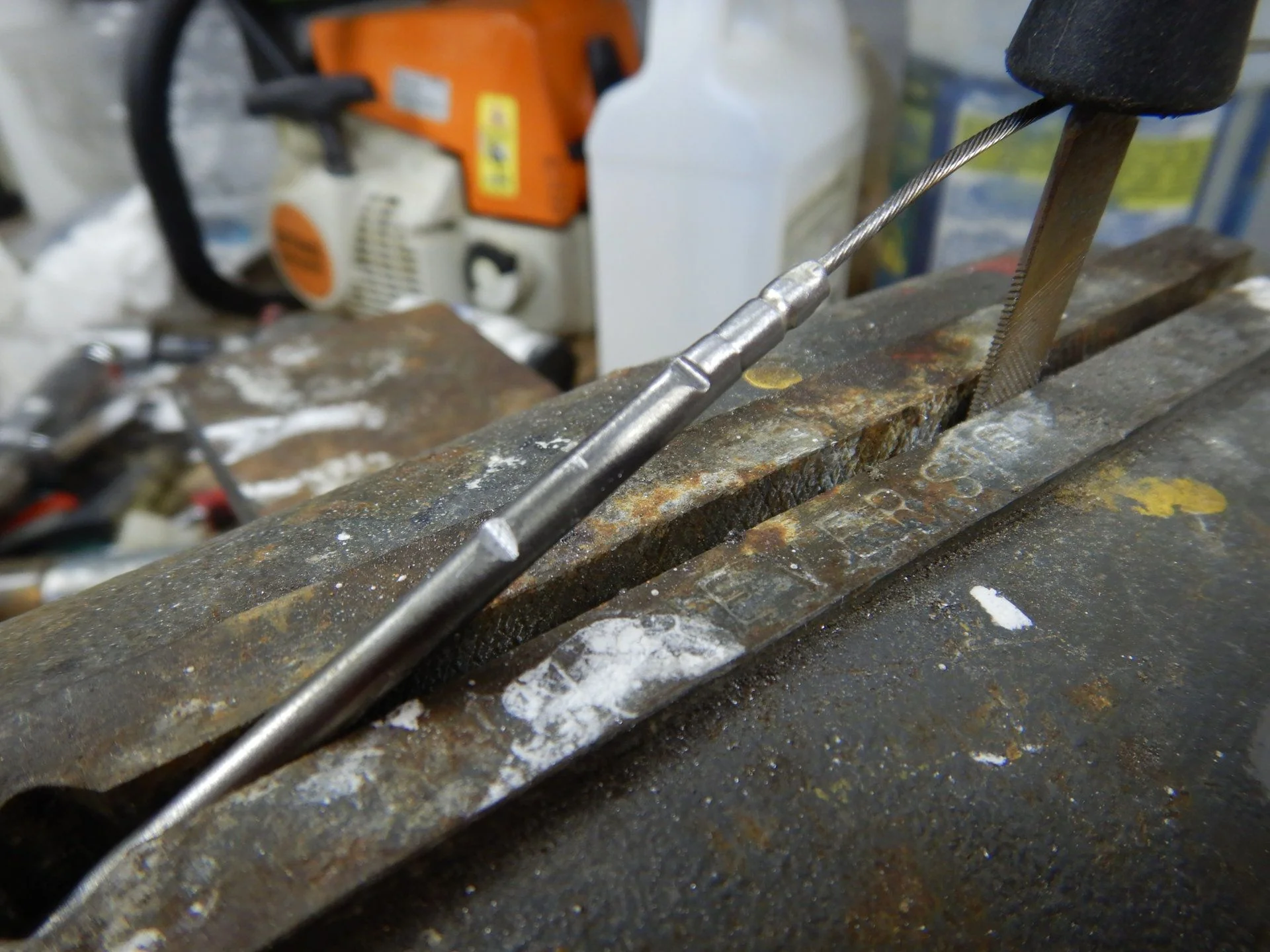

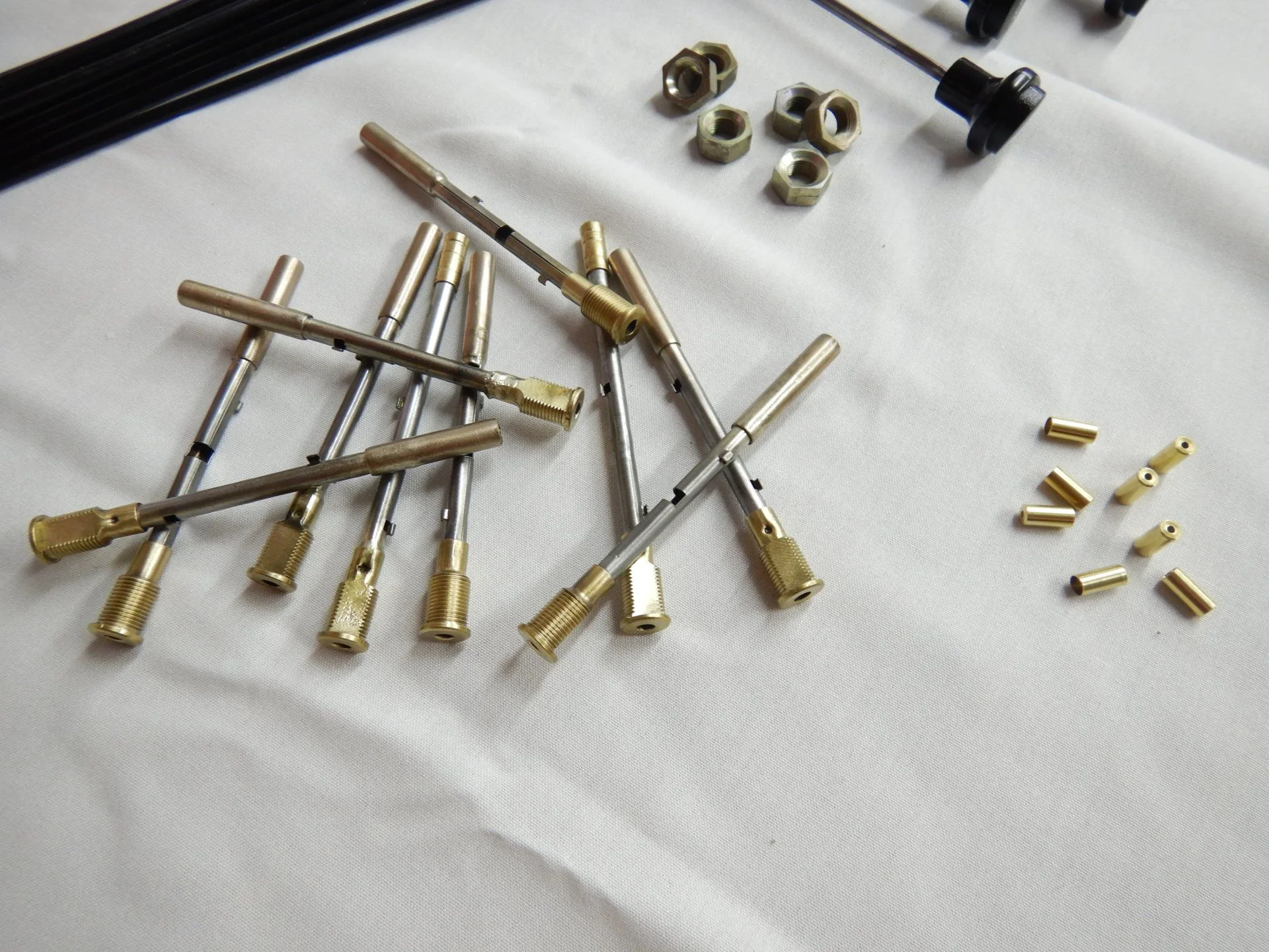

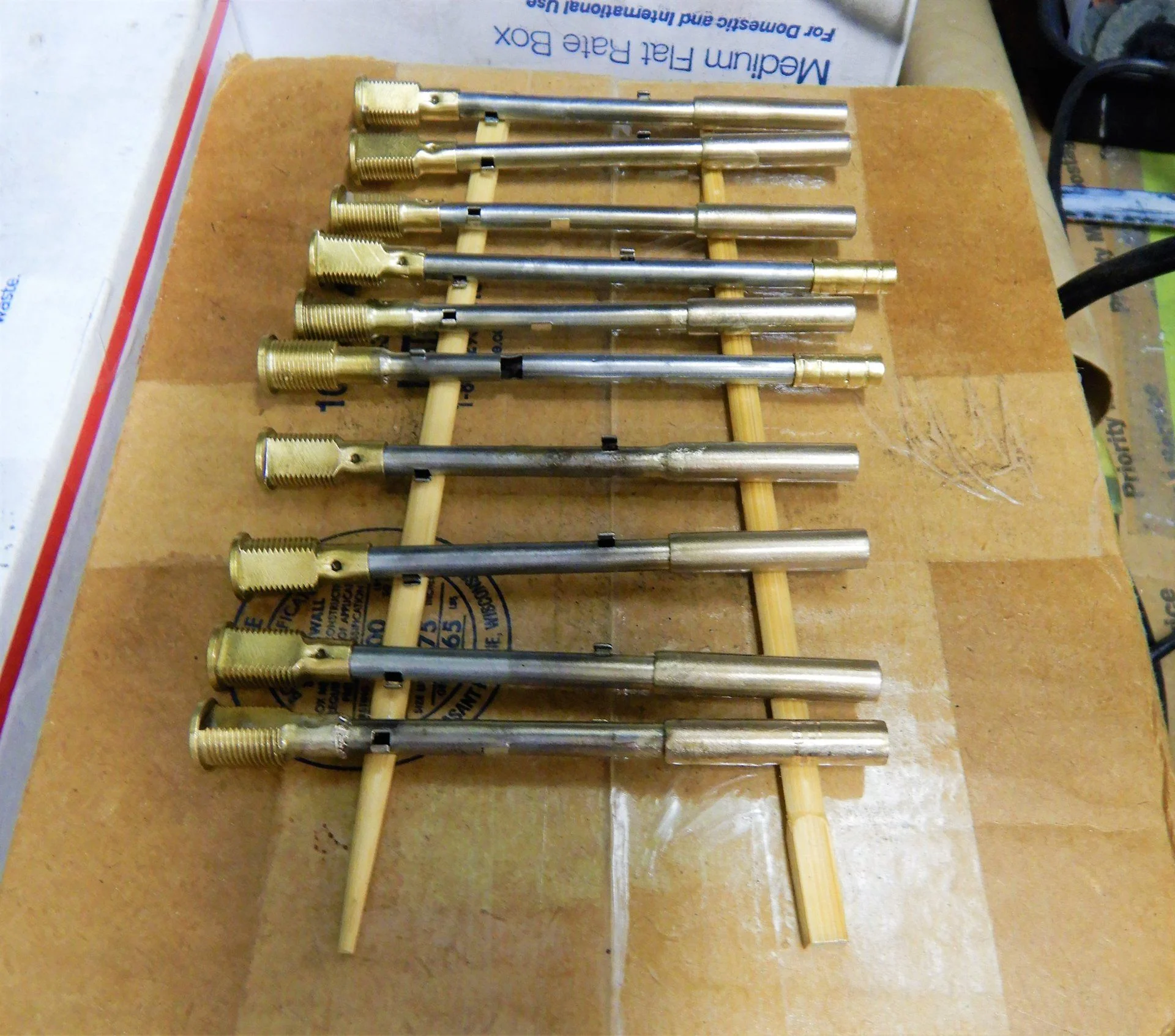

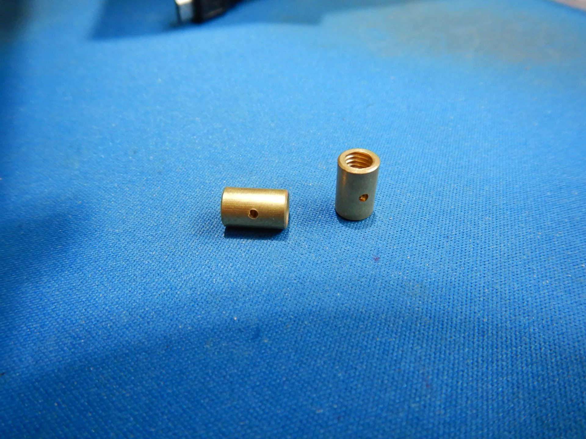

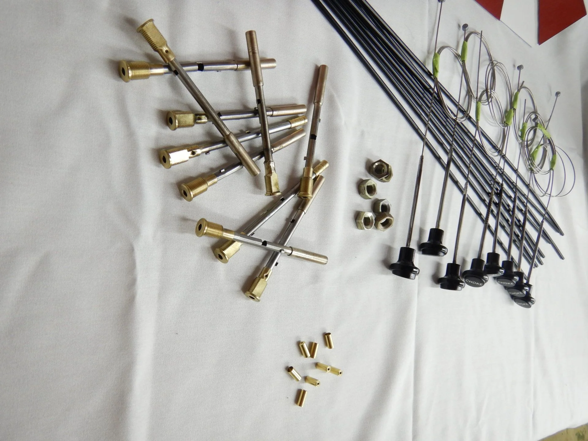

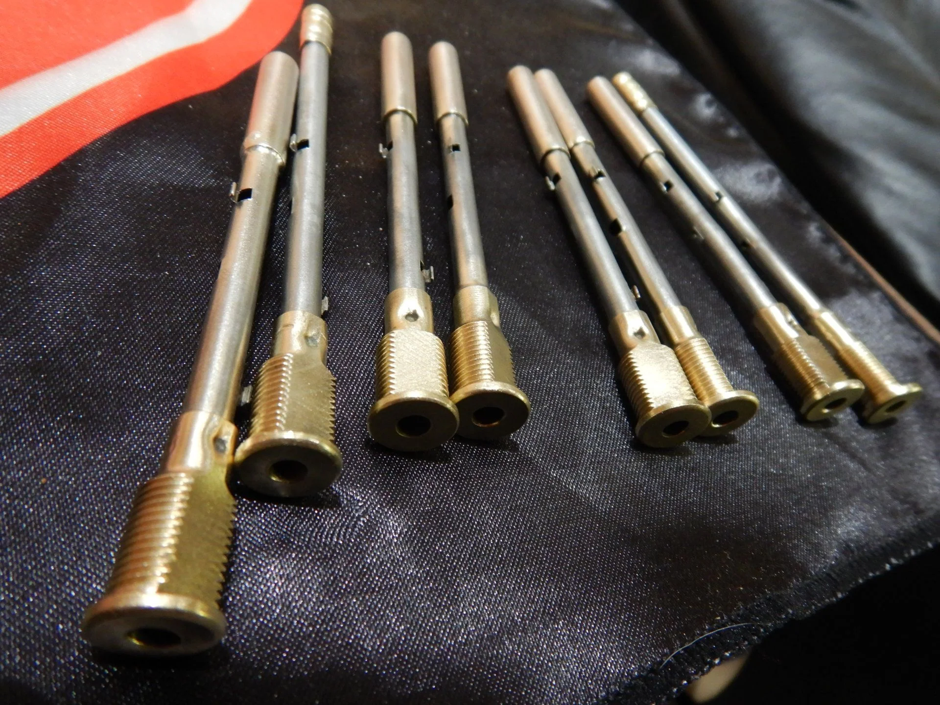

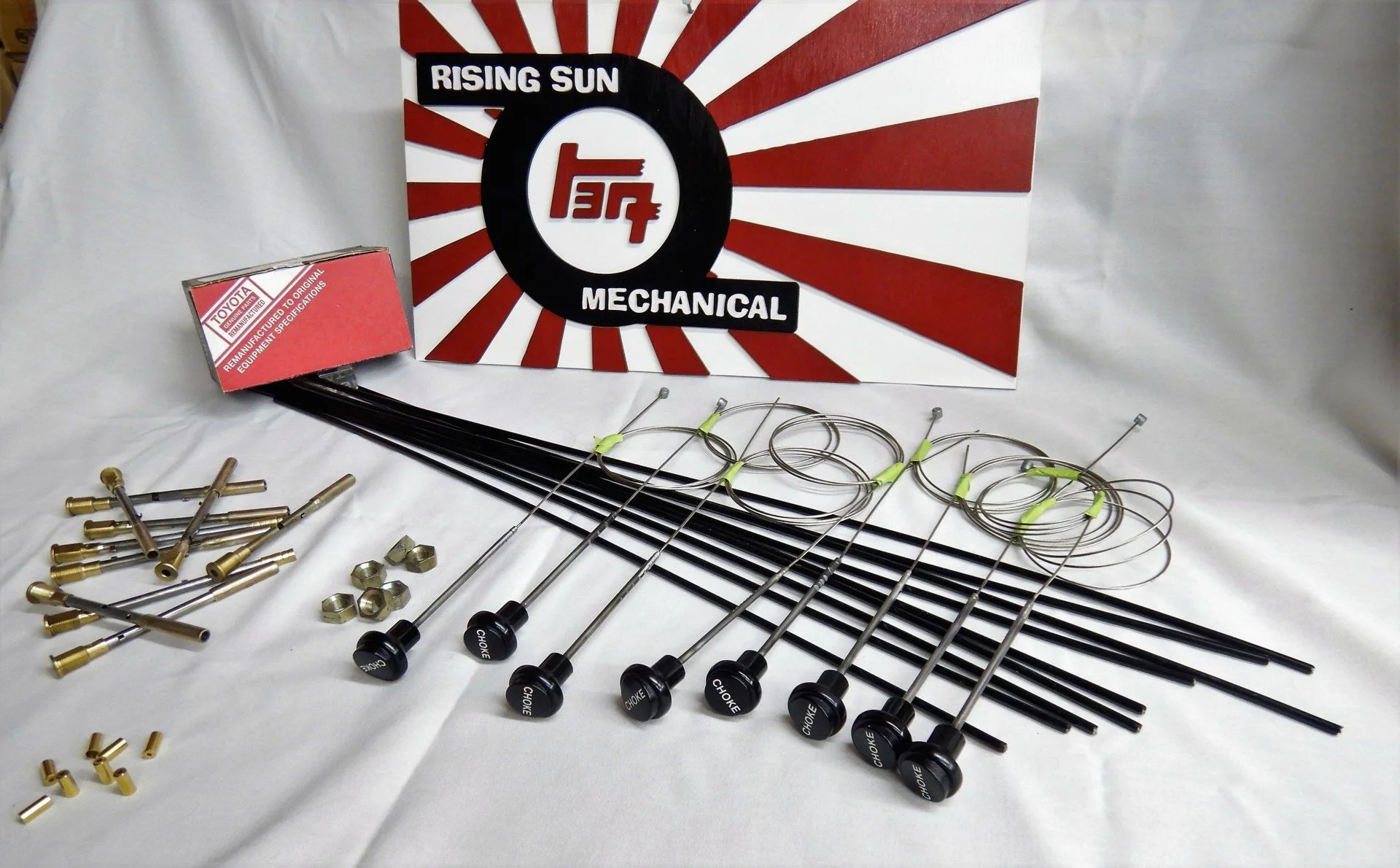

Several of the Cables in this Batch will have 8/80-Later Solid Brass Barrel Stops installed to Properly Mechanically Communicate
with Both @Racer65 / CityRacerllc.com 's New OEM TOYOTA AISIAN & FUGI Made in Japan Carburetor Options available
- the New Solid Brass Barrel Stops will be installed with " 100% Pure TROY Weight Silver "
- this provides the strongest possible engineered bond i am aware of between My Stainless Steel Strand Wire Cable and the Yellow brass stop ..............
Doing Things the Traditional TOYOTA Way , By Hand , with Pride , and Care to Period Correct Attention To Details such as
even New De-Tent Spacing .,...........
also , Re-Dressing the Originals back to Factory Spec's :)

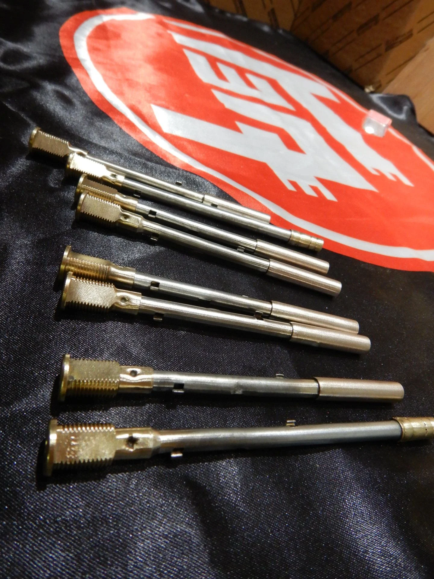

- Fresh & Sharp Restored Guide-Tubes Ready for a Clear session under the Low - Temp Heat
