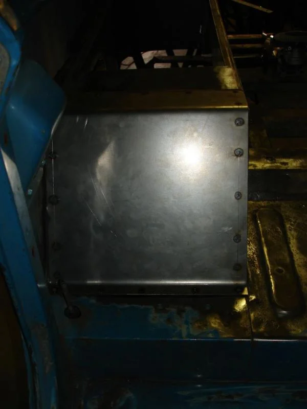

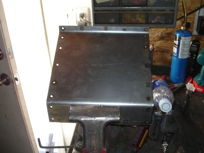

It fits...
Tacked in with plug welds....

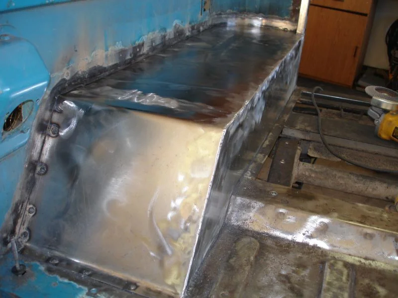

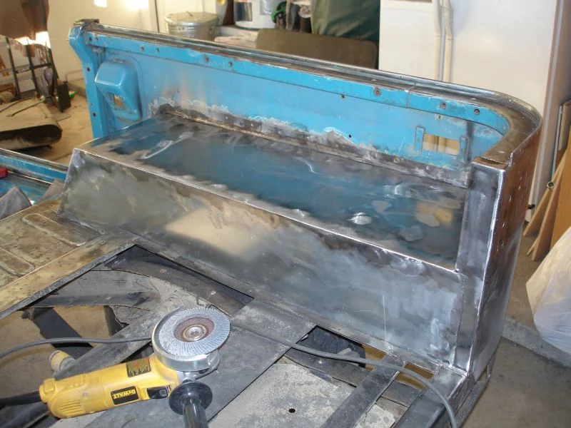

FINISH!
There of course are some low spots that will be filled with bondo...Its not worth it to me to keep chasing those and risk the overall integrity of the steel by grinding the fawk out of it, so in learning from my past mistakes...fill it is.

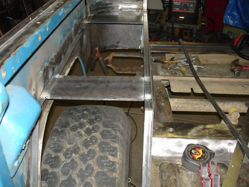

Coming along...
