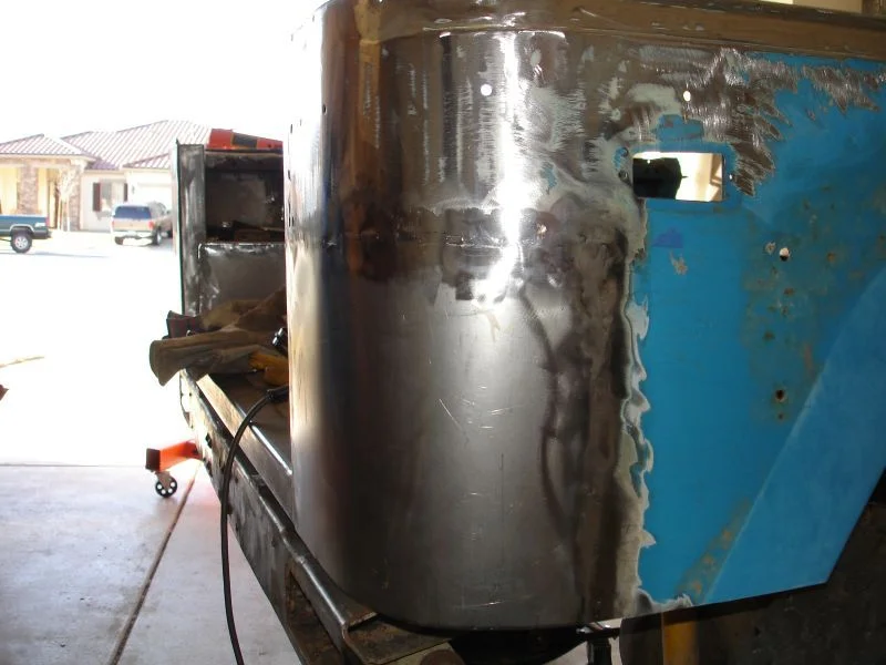

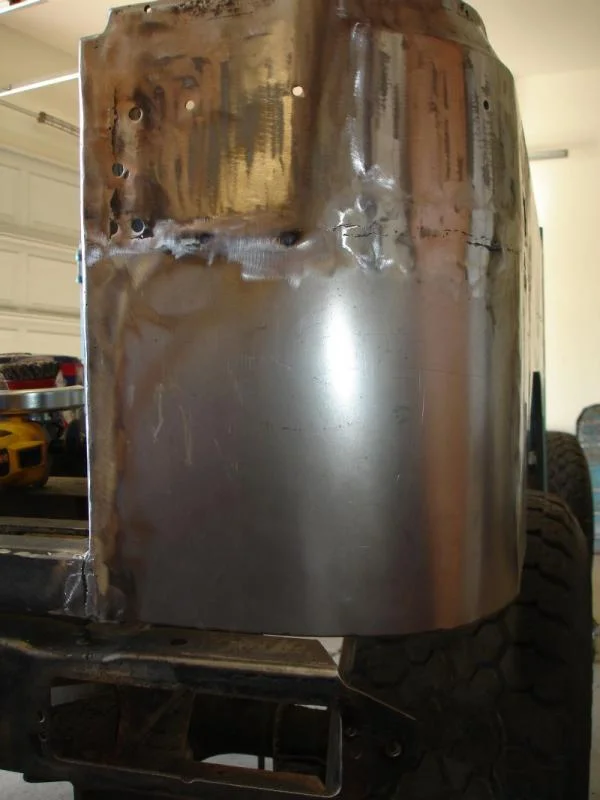

More body work!
Donno an easy way to fill in the holes.
If anyone has an idea. I could just weld em in, but it will be a BEOTCH!
Thought about just doing a backing plate and plug welding em in then grinding off the excess...
get a chunk of brass (or aluminium can work too) and hold it on the back side of the holes and then fill them with weld. Don't know how much fun it will be vertically. I haven't done alot of it but have done some. I have a big old chunk of thrust bearing out of a ships diesel engine that i use.
AAAAAAH...right!
Because the metals wont fuse! nice idea gents!
May have to try it on one to see how it works.
Thanks!
