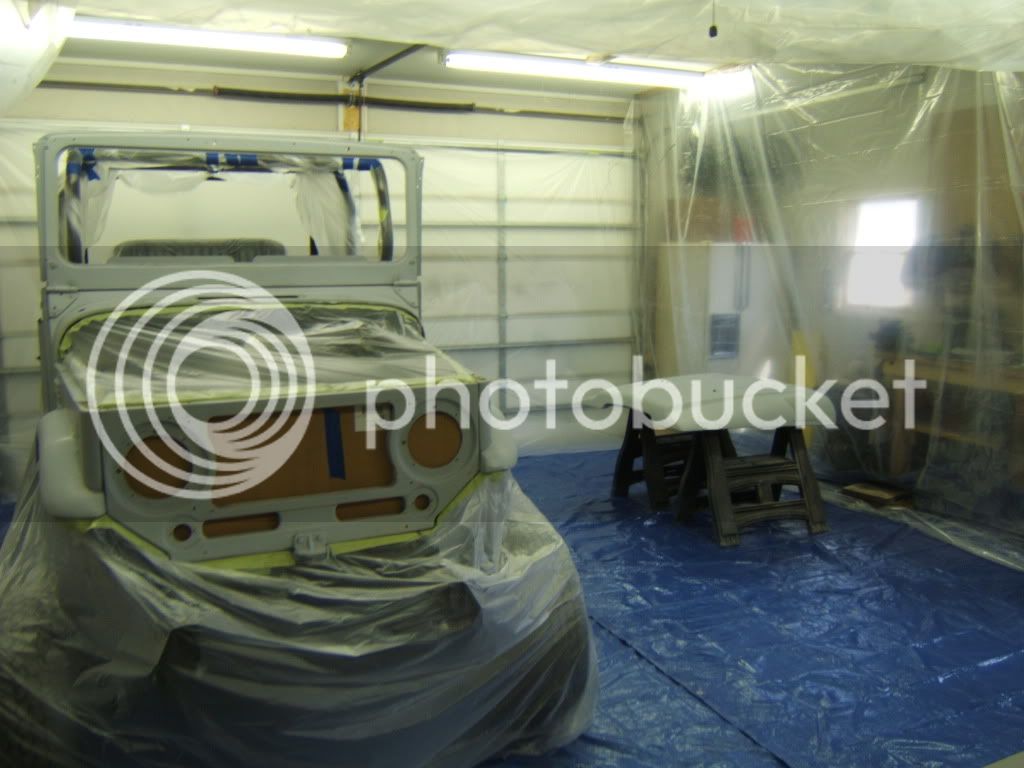

Not real sure how your garage is laid out but when I did mine I made sure and include the garage door rails inside the booth so I could open it up a little to air out. I just used some 2x4's and a box of 3mm plastic had about 20.00 in it and a couple tarps for the floor that single stage is sticky stuff if you don't want it painted cover it that **** is nasty. Can't wait to see it with some color:bounce::bounce2:

So, you did not leave the shop door open for the paint process?
I was kind wondering about that. Totally planning on ground cover. Also, working in surgery, I have access to disposable coveralls, shoe covers and gloves. :)
I had it open a little ways. I have a small box fan about 16" tall or so so I placed it in the middle and covered the rest with plastic so I had a make shift vent fan, then I left my plastic door flap open some so I had a draft through. I will see if I have a pic somewhere. It was nothing fancy at all but it worked not very much dust in the paint and when it was done it all went into the trash. I drank more money in beer in the painting process then the price of booth material.
Here are some pics. Just noticed this was taken before I redid the plastic over the door
Go down to Home Desperate and get a bunch of 1X2s. Since garage floors are sloped to run off water you may have to make several lengths of kickers. Use two 1X2s per location, measure what length you need floor to ceiling, screw the two together to be about 1/4" or so, longer. Use duct tape to attach the plastic to the upper end of the kicker, set the upper end against the ceiling and gently kick the lower end into place. Be careful how much pressure you put against the sheetrock, you don't want added ventilation.

I'm gonna check out the 1x2's, but I'm gonna build it under the garage door rails.

In lieu of building a booth, my :princess: actually suggested to make the booth in the ONE CAR bay. I looked at it, and it would actually work out BETTER that way, so Ill be just stapling the crap to the walls. Got a lot of crap to move around to make this happen. Still donno where Im gonna put this stuff for the process....:hhmm:
