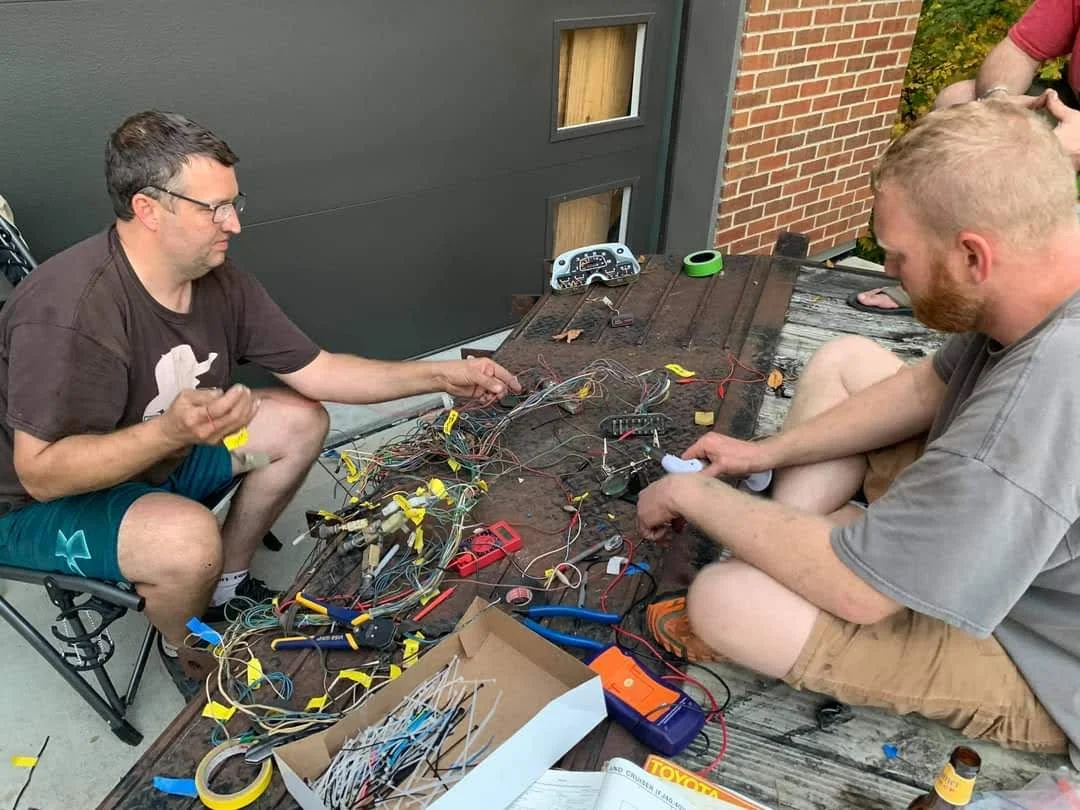

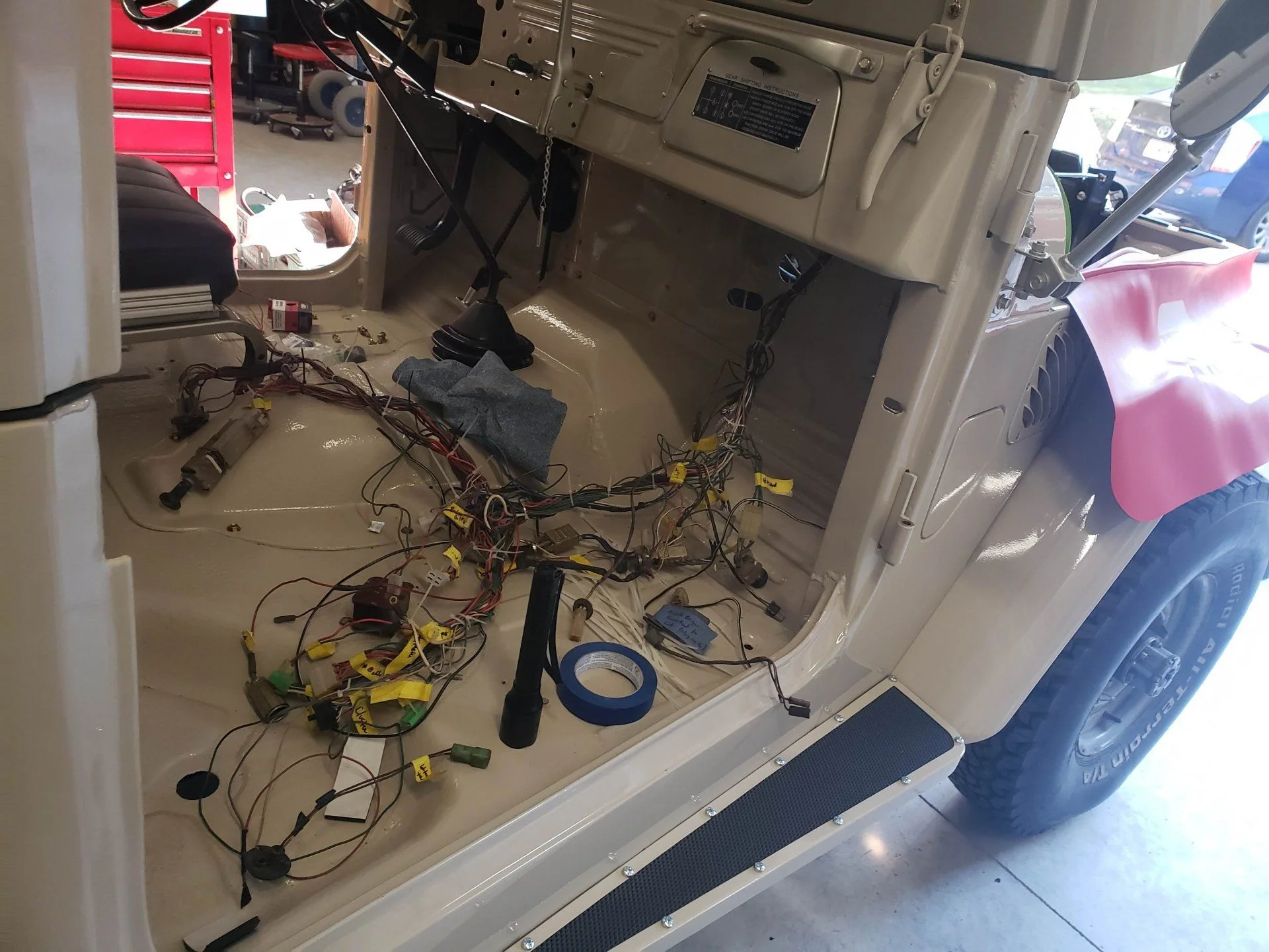

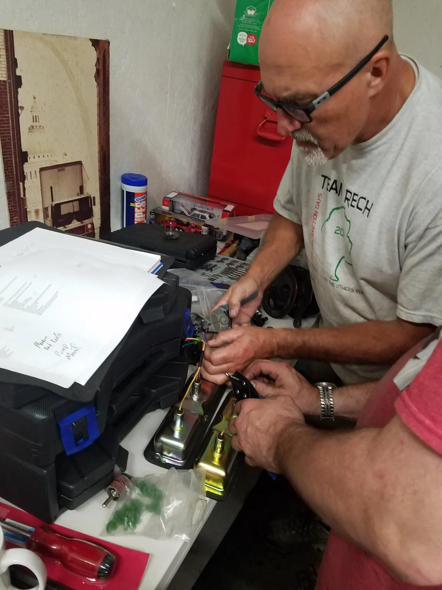

This takes us to the part of the story where we begin to wire this sucker.. 78 drivetrain in a 64 truck. 78 column and partial firewall graft. I want to keep the old school look but some newer tech.. Plan is older style heater and blower, newer column that functions with newer ignition system, Old school switches for lights, wipers but add hazards. It really seemed easier to just use a 78 ish harness that we had part of. SO.. Wires, wires and more wires.. Tracing out everything that Alan and I prob cut off this harness from a truck we probably pulled out of a ditch somewhere years ago. My dog was the smartest, she just found a cool spot under the trailer we were working on and took a nap..

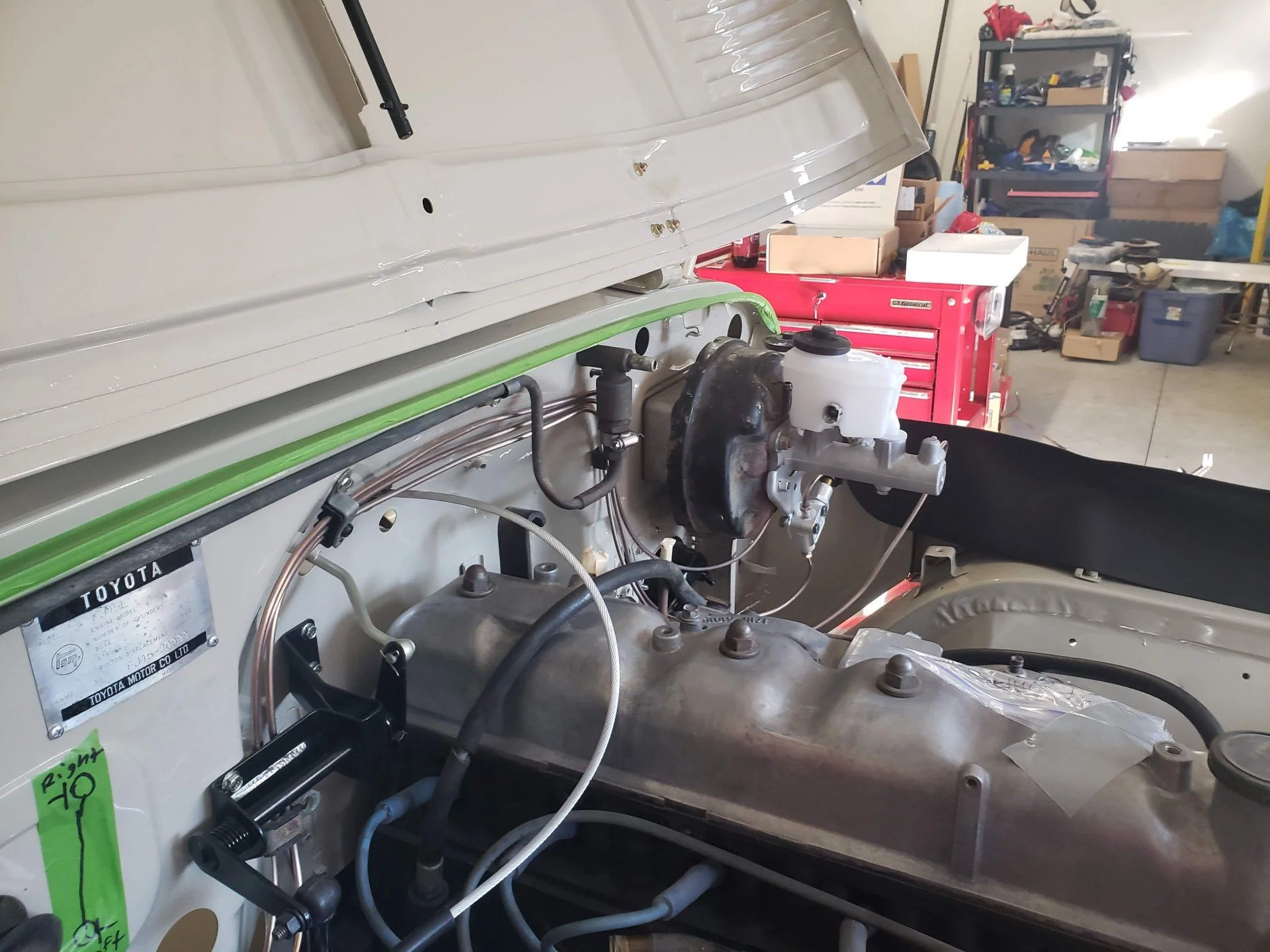

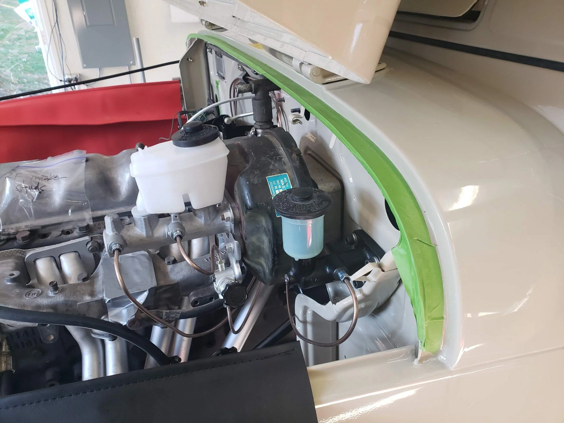

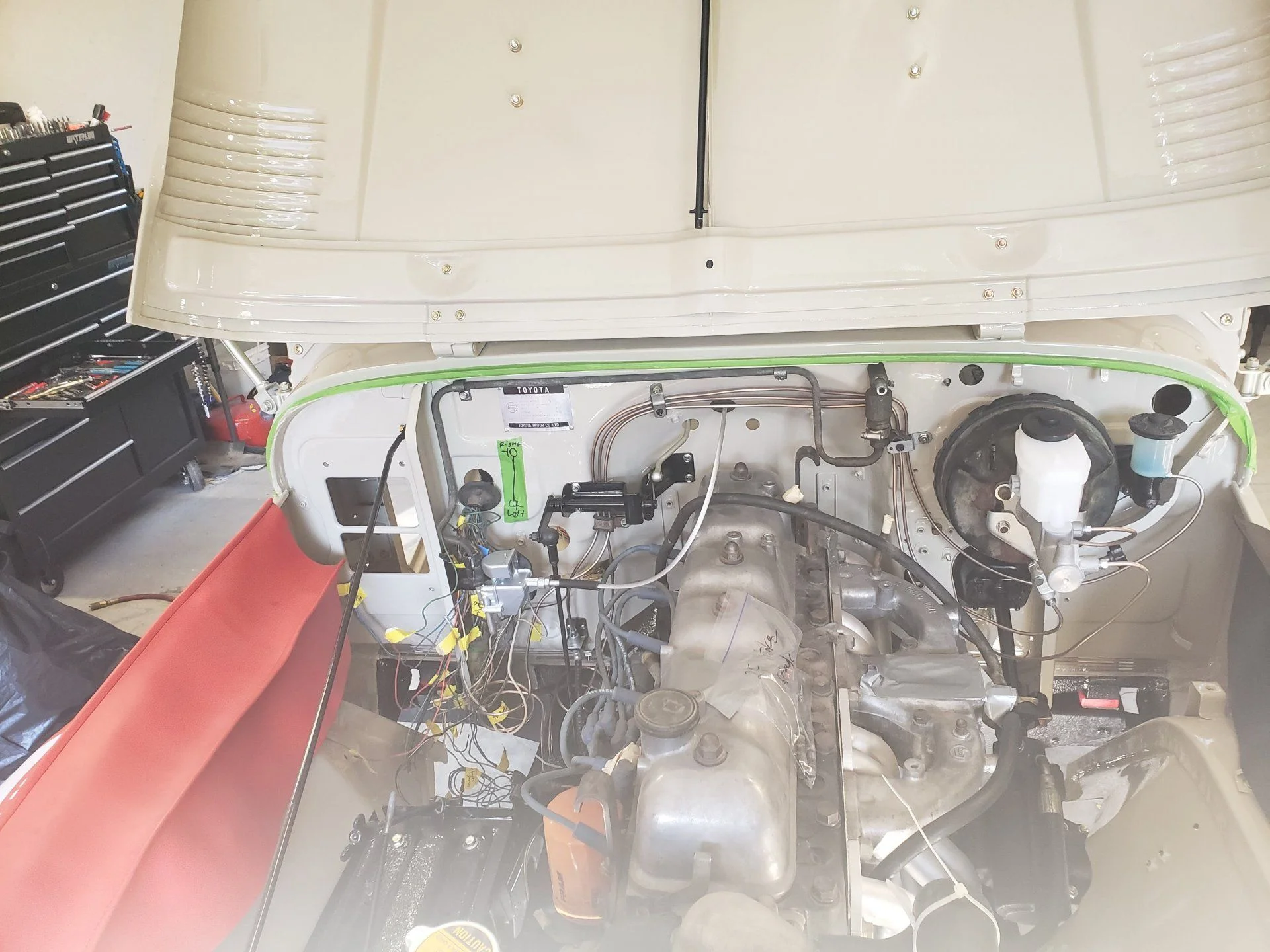

little more of the brake running, prop valve mount etc. Some of the brake line mounts came off other toyotas in the junkyard. Some are stainless mounts i used on my 45 and had extras. Whole truck was plumbed front to back, each axle, and the clutch.
A tech note... the proportioning valve is metric double bubble threaded; however, you have to an extra long threaded fitting. Luckily, I had just done this last year, so had a couple extra in the kit.

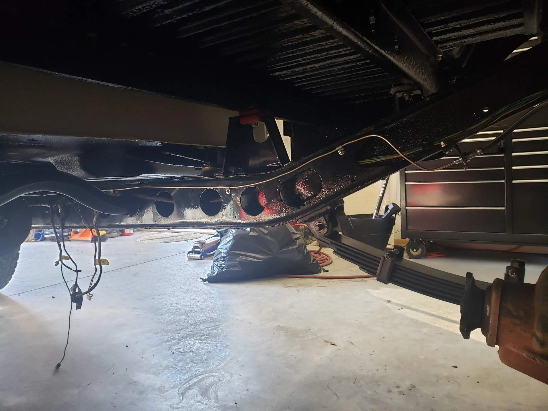

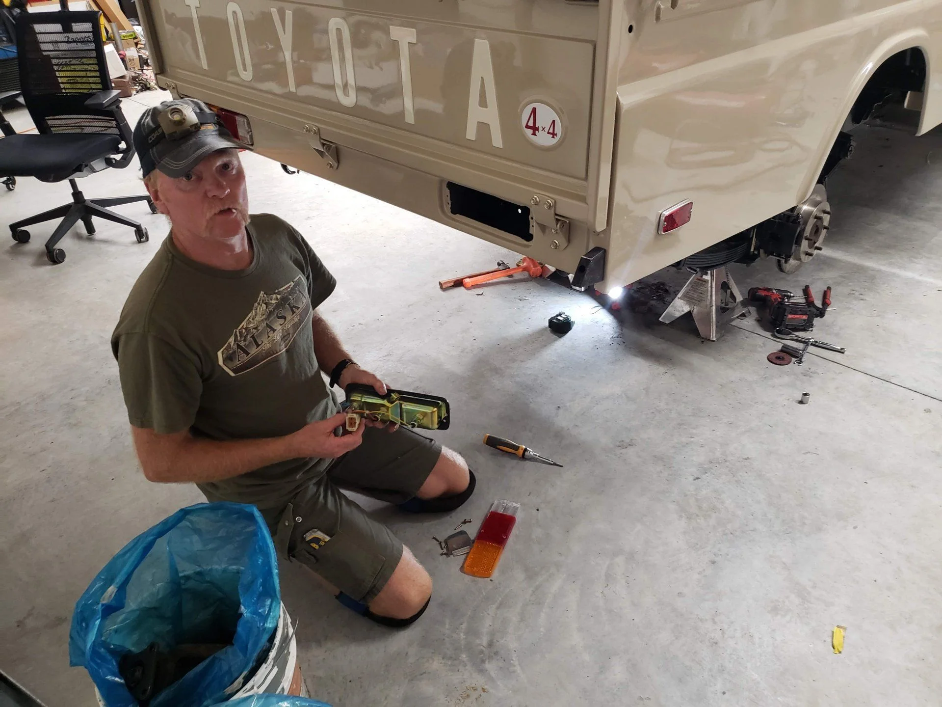

Later in the evening we just decided to go ahead and see if we could run the rear wiring section. This truck has later tail lights grafted into it. FJ40 taillights which add reverse and make finding a replacement lens easier. Lengthen and rewire the rear lights, add an extra ground wire to the mix. I will insure there is a 4pin trailer socket in the back as well for Alan's M416.

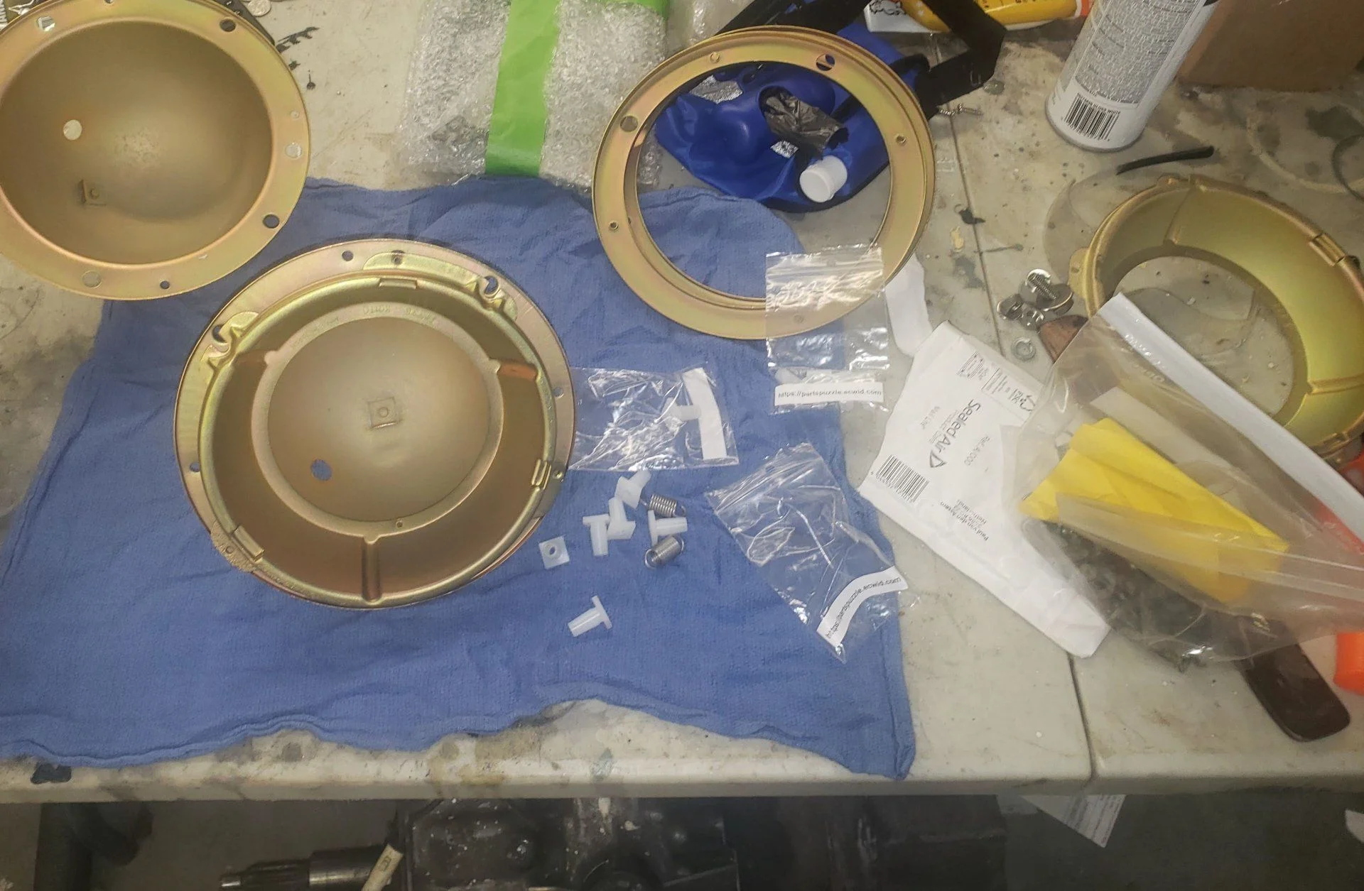

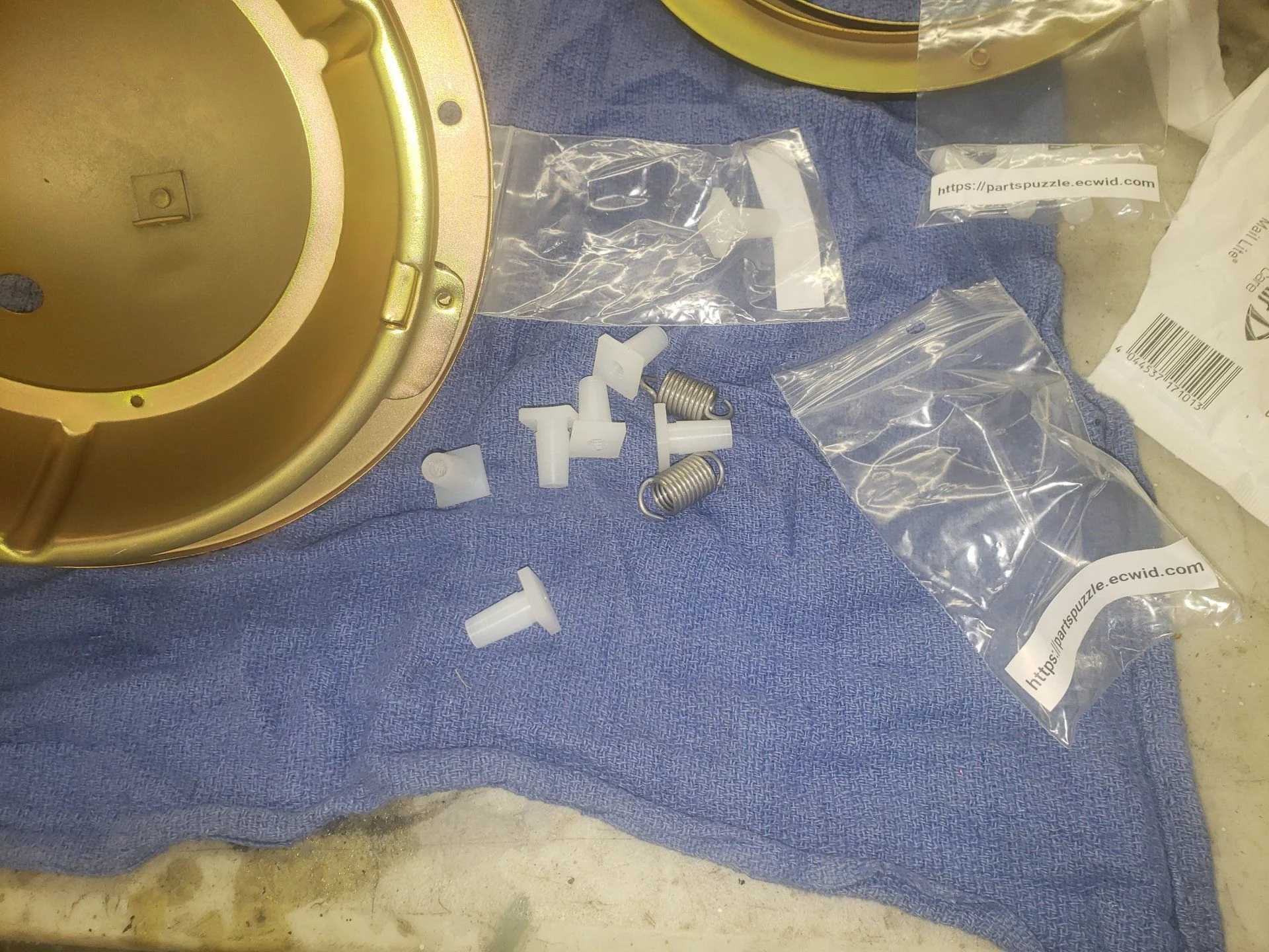

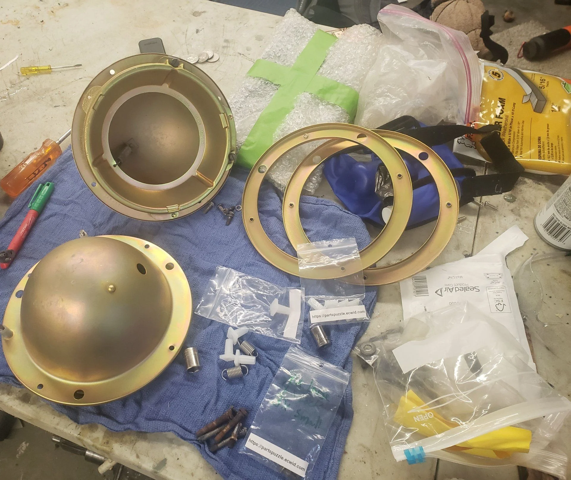

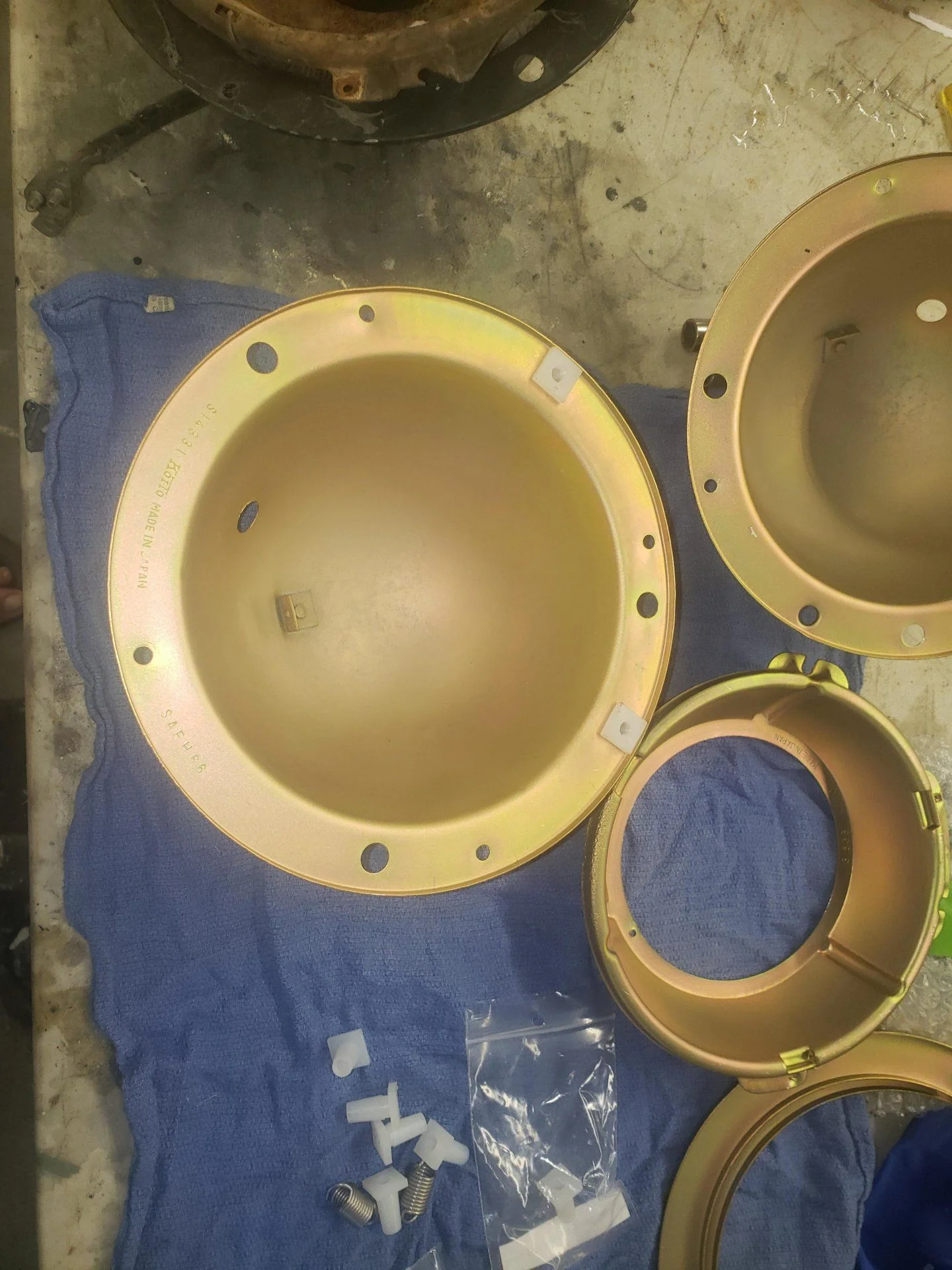

Now, did anyone wonder what all got plated? The adjusters for the headlights take a round plastic retainer for the older buckets. I couldn't find them anywhere. A guy in the Netherlands reproduces them. Ordered enough for 3 sets of headlights. Started assembling Chef's headlight buckets while I watched a little football Sunday afternoon. Need to polish up the trim ring and get a few new screws but basically assembled. I can assemble on my next run out.
Was questioning the parts that you used as I saw them advertised on the Bay. I will use them now that I see you have used them on your 45. Going to plate mine as you did, looks great, BTW did you get the screws from also?
I didn't get the screws from them. I wire wheeled what i had added a little antiseize and am going to run em.. In hindsight i should have taken my adjuster screws to the platers or found new. They are a little special but i imagine most toyotas would have the same screw. they have a fixed spot for the bucket to ride in while it is adjusted. I did get one set of springs from them but that was only because i couldn't order 3 sets of just the plastic inserts. they did arrive in approx a week!
TNX for the quick reply with an explanation, I guess I will take my screws to the plater also and find some others as needed. I have 2 projects and an extra front that to be complete needs a light set up.

Chef's project has a hand me down. Look close and I used one seafoam green ring and one yellow. The other yellow might need to be plated. The screws that secure the back to the buckets and go thru the bib are m5x.9 avail at bellmetric. I am pointing it out with my screwdriver. The replacements came out of the bag at the bottom.

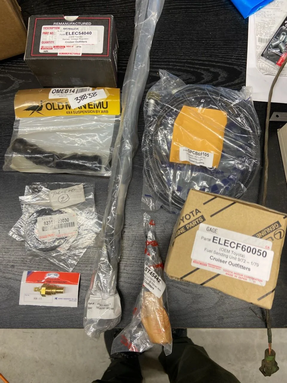

gathering parts to have everything talk gets a bit difficult. Didn't seem to have a FJ45 hard coolant line to go thru the firewall and need a heater coolant valve still. Part of the puzzle to route coolant thru the firewall to the in cab heater arrived from Old Air. I used a larger version of the same thing on my firewall, i knew where to order it and i know it should work. Newer fuel sending unit arrived to speak to the newer gauge cluster. And some other bits to get us going from Kurt. we needed a new Tie Rod, new drag link at the pitman arm, New voltage regulator, new temp sender to speak to the cluster. Some replacement shock bushings to go on Alan's FJ40 as well.

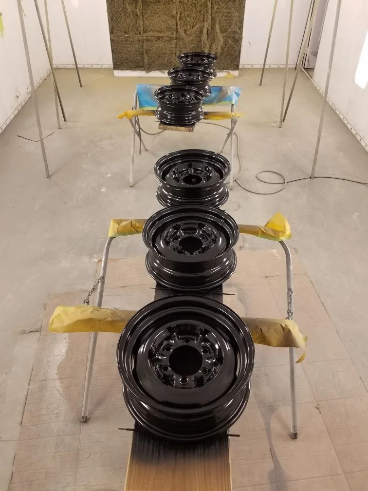

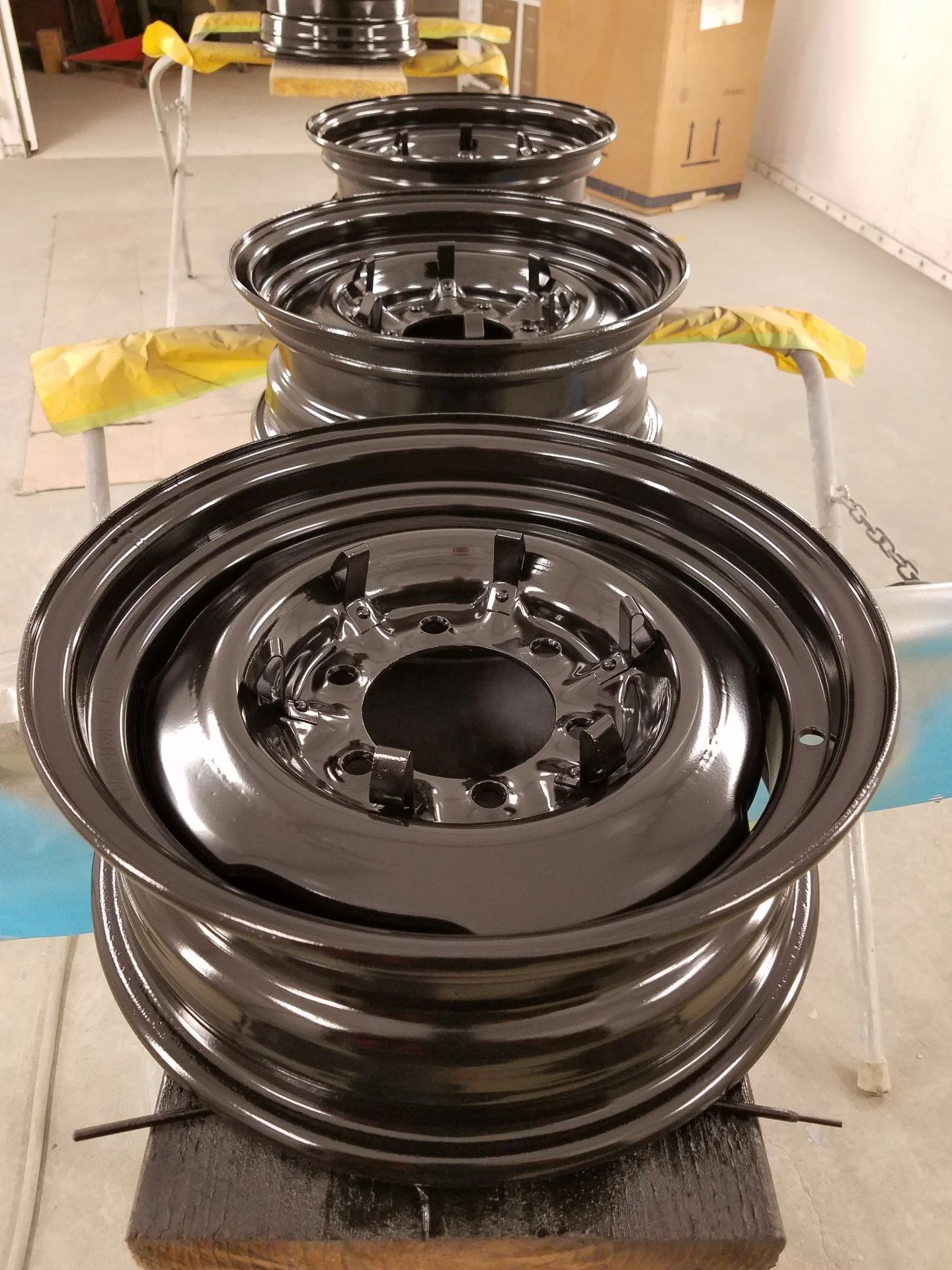

Wheels are in paint. Need a few days to cure then new tires can go on next week.
