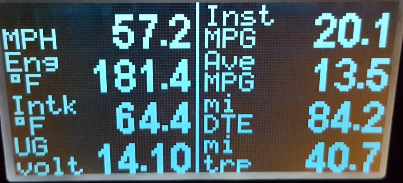

People wanted old school calcs..
Here is a 13.6 mph well actually 13.5 if go out 3 decimals

III) double-check your ScanGauge with manual calculations - fill the tank up until the (same) pump shuts off, drive the course, then refuel, noting how much fuel was dispensed. Divide Miles driven by Fuel Gallons, and see if there's a measurement system error between this and your ScanGauge. At least you'll know if it's accurate.
